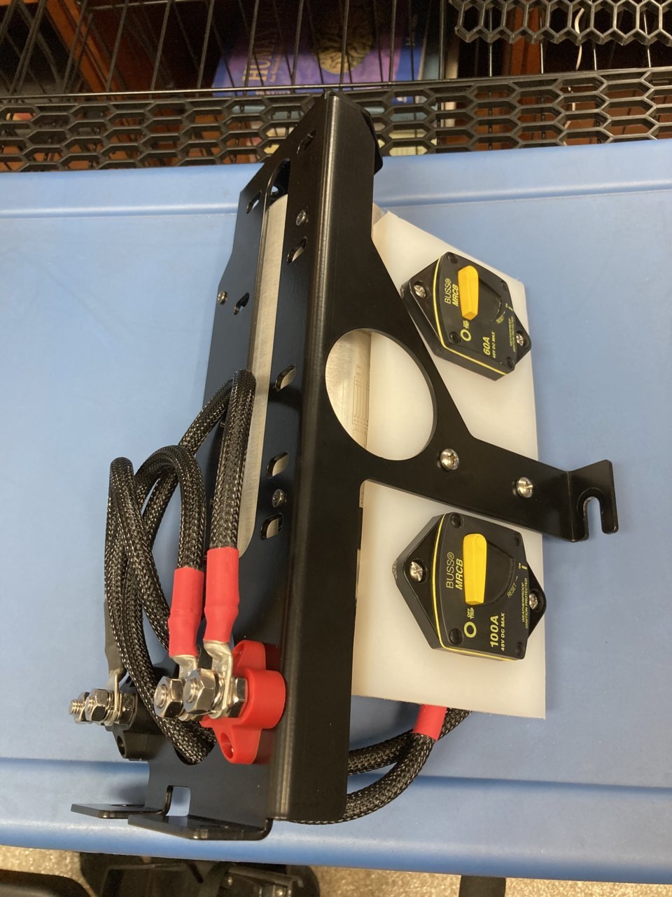

    Yeah I still need to do more prep too. I have nearly all of the parts for the amp power but need to finish executing the plan. It’s a 225 amp mrbf fuse to 55 (compressor) and 100 (audio) amp blue sea circuit breakers in the 2nd battery spot on a GTFO bracket with marine ABs then the 100 will feed a JL fuse distribution in the cab for 4 channel and sub amps under the seat. I have signal and speaker wire all set but I’ve been lagging on preparing the high current. So I blame myself for the lack of progress :). Fun to have good stuff to look forward to.
    ^^ Iteration 1. I’ve since changed to black and redone the aux posts to a pass through to hide wires.

    Definitely. I’m always looking for projects. Question on your breaker. Are you using a breaker instead of a fuse for the amplifiers? Any pros/cons to that? I thought about getting an aux fuse box setup as well, so that would help things look a little cleaner.

    I'm over-thinking / over-building it but here's how I have it justified in my head:
    • MRBF 225amp bus fuse to protect the 1/0 cable to the aux location. That's a one-and-done connection which I don't intend to mess with ever. The fuse only protects the wire from a short to ground in the event of a fire.
    • Compressor circuit breaker seemed preferable to a fuse. Because if you need air for some reason and you pop it due to overzealous momentary current draw, better to have a reset than hope you have a spare fuse. Also because at 55 amps fuses aren't super cheap and particularly for the waterproofness. But the one additional planned benefit is you gain an off switch for futzing with the wire without disconnecting the battery. That is a big bonus since I don't yet own a compressor and it's reasonably likely I'll be futzing with stuff.
    • So, given that I figured might as well do a combined 100 amp breaker for the audio system. Because anything more than that is beyond what I consider reasonable for this vehicle. Maybe if I upgrade the alternator and go totally nuts I'll open the door for more power. For now that 100 amp breaker is mostly just an off switch (like the above) so I can completely disable the amps for troubleshooting, maintenance, replacement, etc.
    • The fuse distribution block will take 4 gauge in and feed 4 gauge out to each amp (short runs). Which is kind of silly, 8 gauge would be perfectly fine for a short run, but I like the look of 4 gague. It's one way to avoid feeding two 4 gauge cables from the engine bay into the cab. Because that's the biggest pain of the whole thing, deciding if I'm drilling the firewall or re-using an existing boot. Upside is the passenger side location has more room to work with. I'm also looking at the various gaskets on the underside of the cab but wary of using one for fear of water intrusion.
    So, each amp actually has 3 layers of protection, the 225 amp bus fuse at the battery, a 100 amp breaker, and then the 50 or 40 amp maxi fuse in the distribution block.
    I think my ideal setup might be 3 breakers on that GTFO mount, one for each amp and one for the compressor, but if I do that option I have to run 2x 4 gauge into the cab and that's the real PIA part. I might still consider that. Also, there isn't a ton of space for 3 breakers on the bracket face. The way I managed to do it, I can still slap a compressor on top if I want to, though my plan for the compressor is to stash it in the bedside cubby.
    From past experience I only ever had one fuse trip on me and I believe it rattled loose rather than burning out. I was quite surprised by that. A circuit breaker is really nice if you're out on the road and changing a fuse is harder, but I pre-bought 5 of each maxi fuse in 40 and 50 amp ratings. Though I'd be totally fine with a 50 amp fuse for the 400w 4 channel amp.
    The biggest dilemma is placement of the ground block and power distribution / fuse block. Ideally they would be semi accessible but out of the way. With the under-seat locations already pretty busy with seat heater connectors and amps, I haven't located a great spot for those blocks. Doing everything on the rear wall would simplify things but I think I'd rather have that space 100% dedicated to the sub box because it's already a bit of a squeeze.
    I'm sure the above qualifies as ridiculous and unnecessary to any rational human :)

    Haha! Nah. I completely understand. It it’s safe and it makes sense, it’s up to the user. Better to have too much protection than not enough; that’s for sure!
    Thanks for the explanation of what you have going on!
