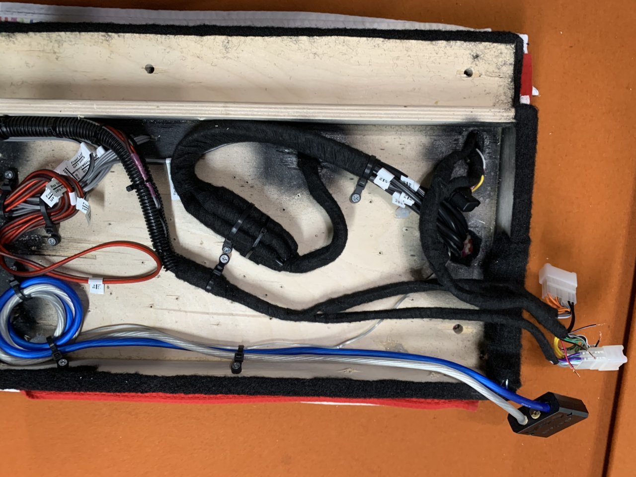

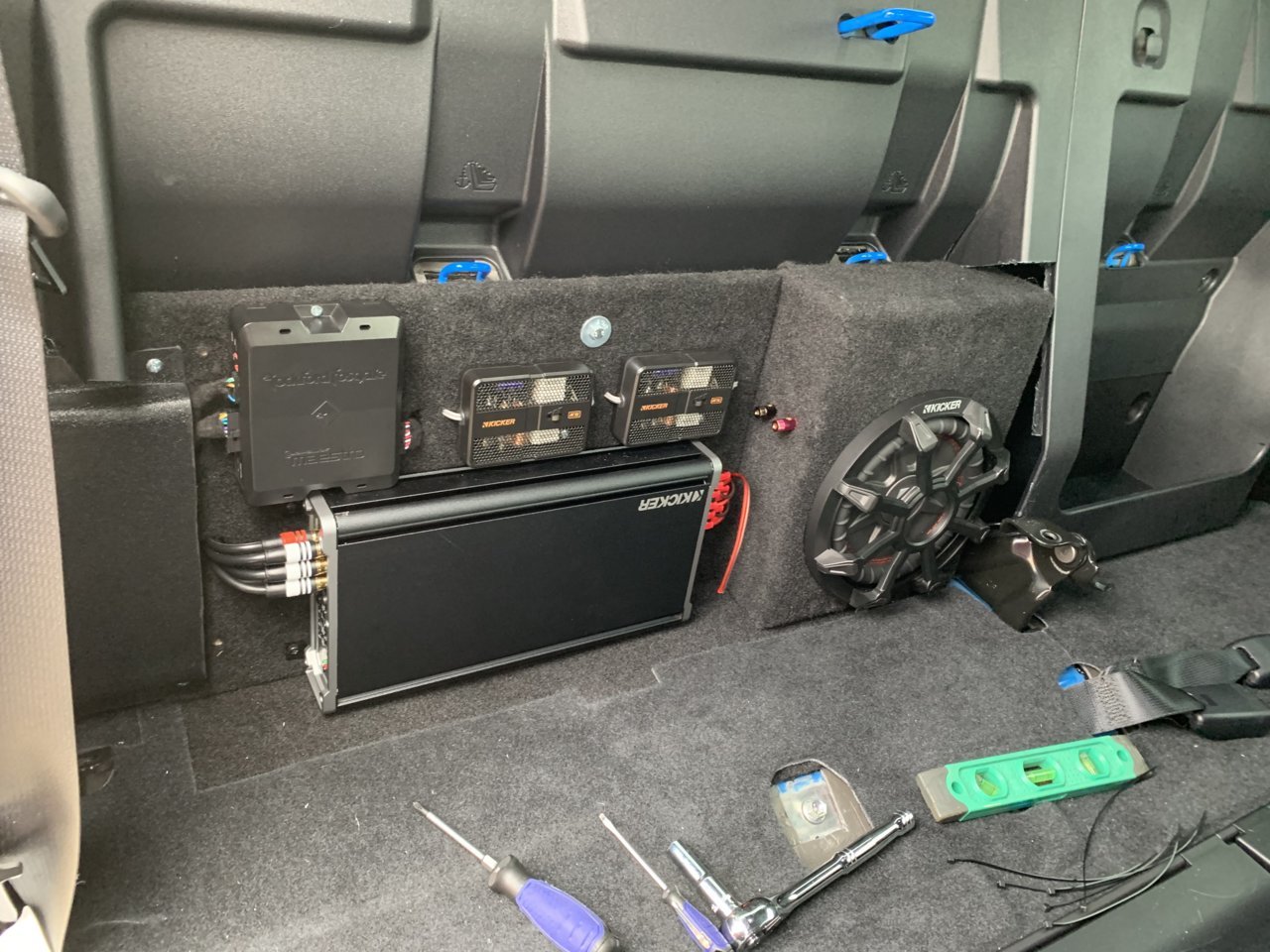

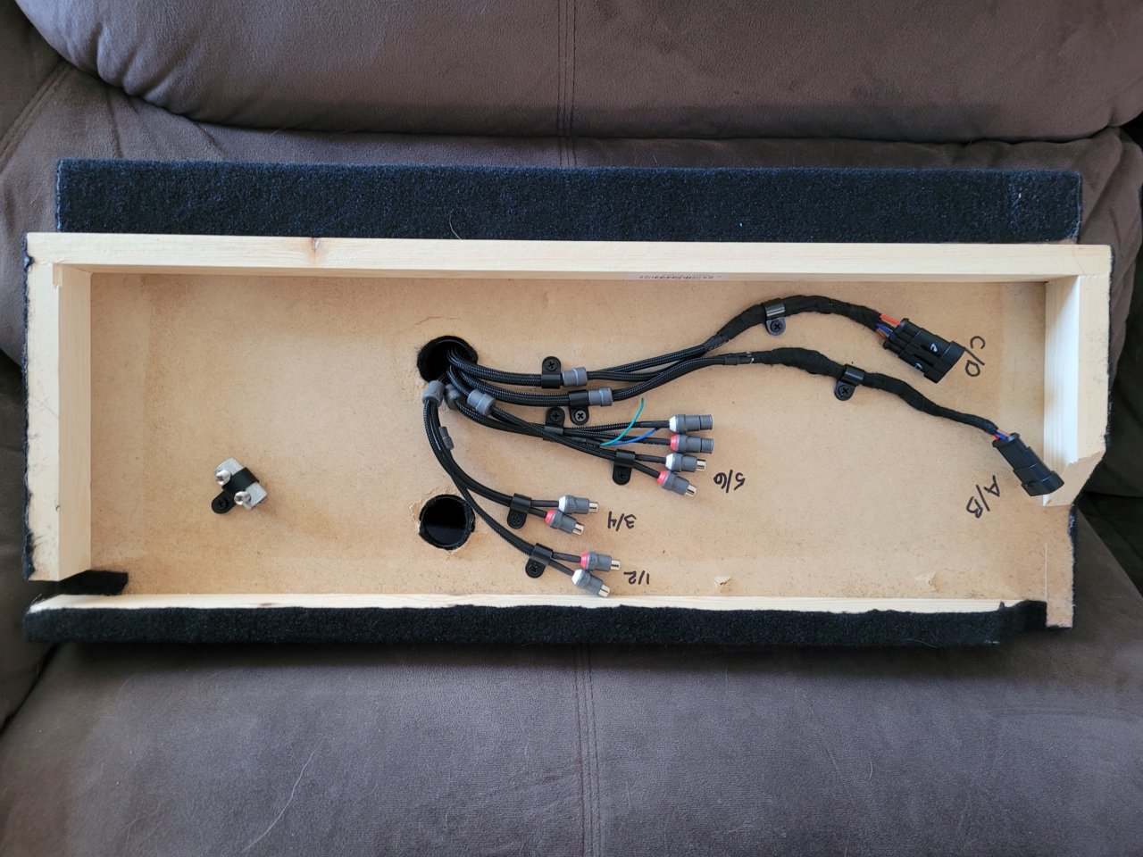

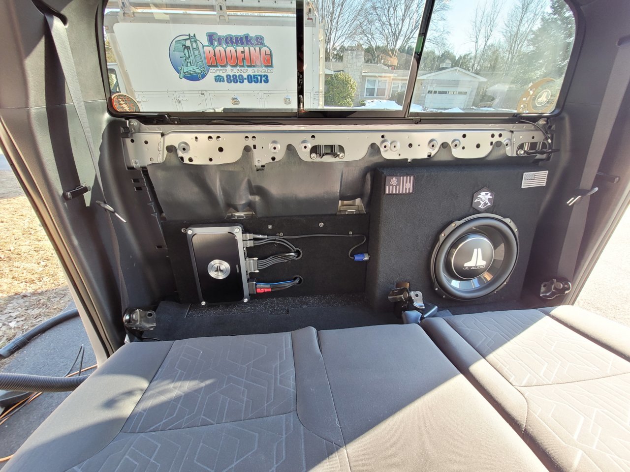

    Carpeting really isn’t that bad. There’s a ton of videos out there for tips and tricks. You just use 3m adhesive to do it and then a sharp blade to cut with. I did the seams by overlapping and then cutting both sections at once. Then they line up perfectly. Also, put all the seams at the bottom and back and any screw ups are hidden anyways.
    Below is a picture of what I did. First time doing carpet. The backside looks horrendous, but no one will know except me. Plus, I didn’t carpet the whole backside of the amp rack because I wanted to be able to screw down my wires and stuff.
    Diregard the trim I screwed up by the sub box. I’m an idiot. Lol. I’ll probably try to find a replacement trim piece and redo it at some point. Even if I don’t, I never open that side anyways, so I’ll never see it again more than likely. C671B340-8B94-4939-BBD4-2474D5E096A6.jpg
    Here’s the backside. Yeah, I know. Haha. Like I said, it won’t ever be seen so it doesn’t really matter

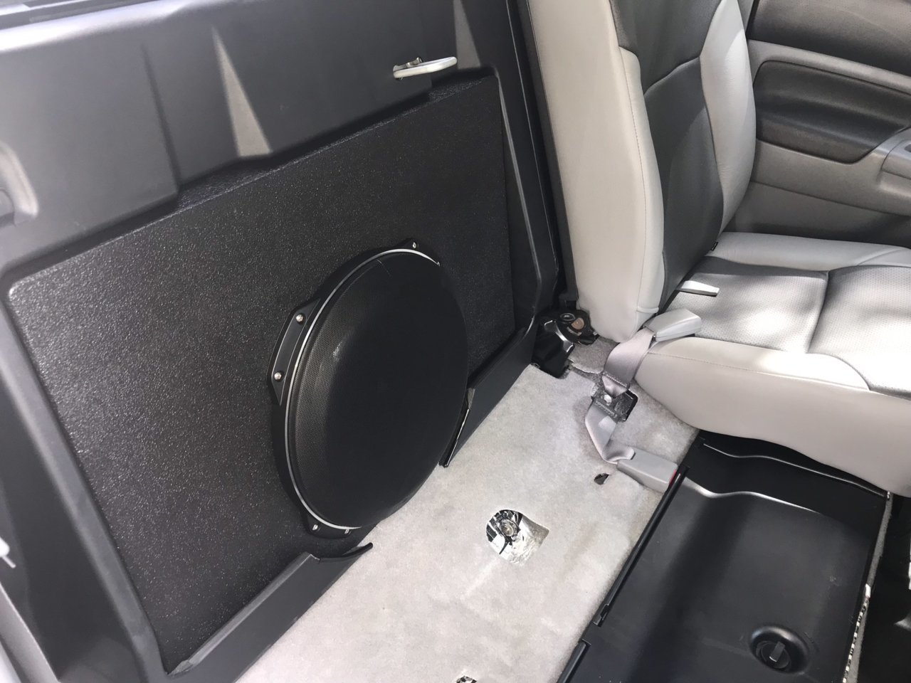

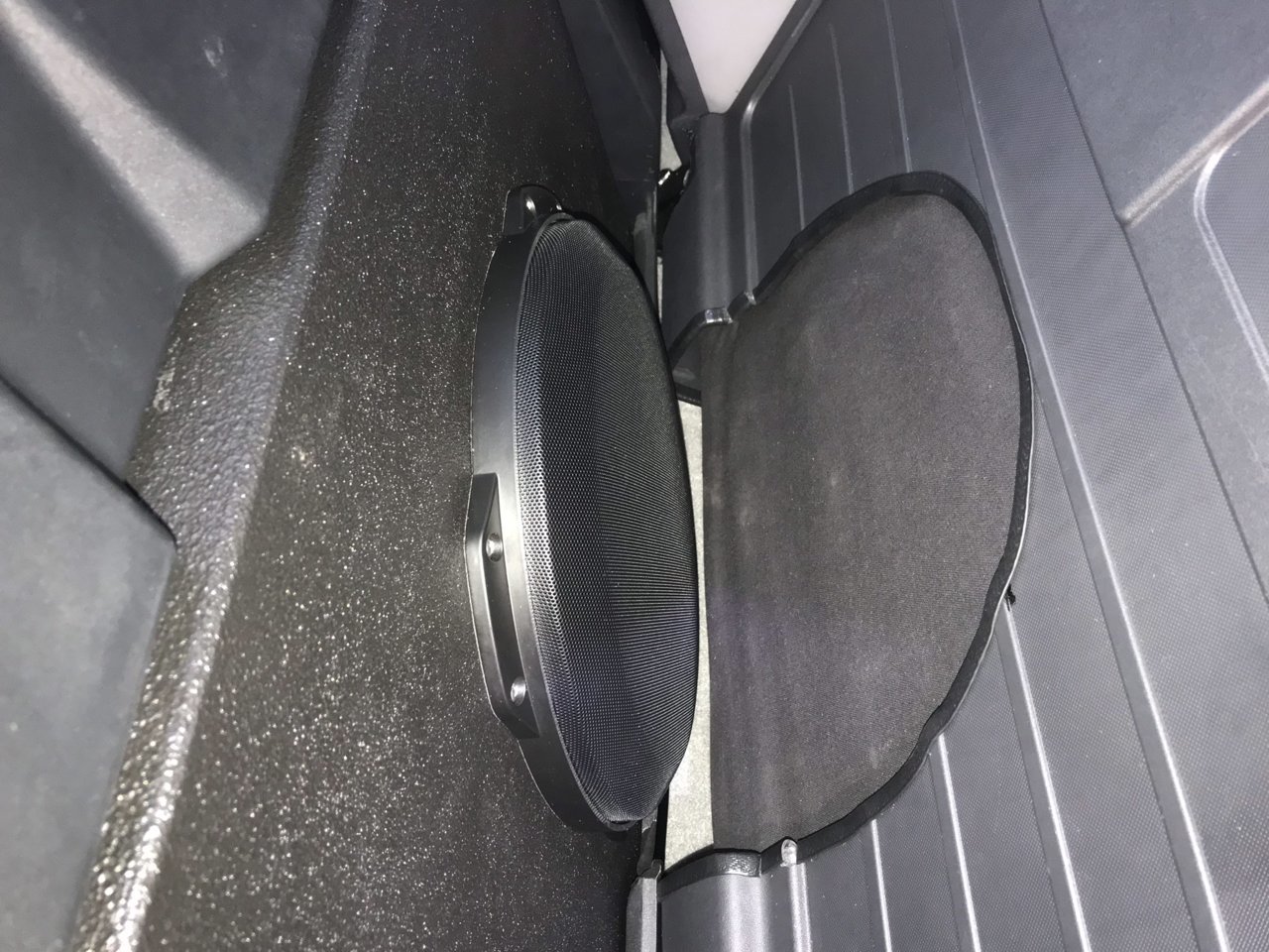

    Nothing crazy. 2 Kicker CompRT 12’s in a down blow box in my 02 ext cab. Highly under powered running a Kicker KXA800.5 to the subs at 2ohms and powering my mods/highs. Now I need to get off my ass and make it pretty. Lol

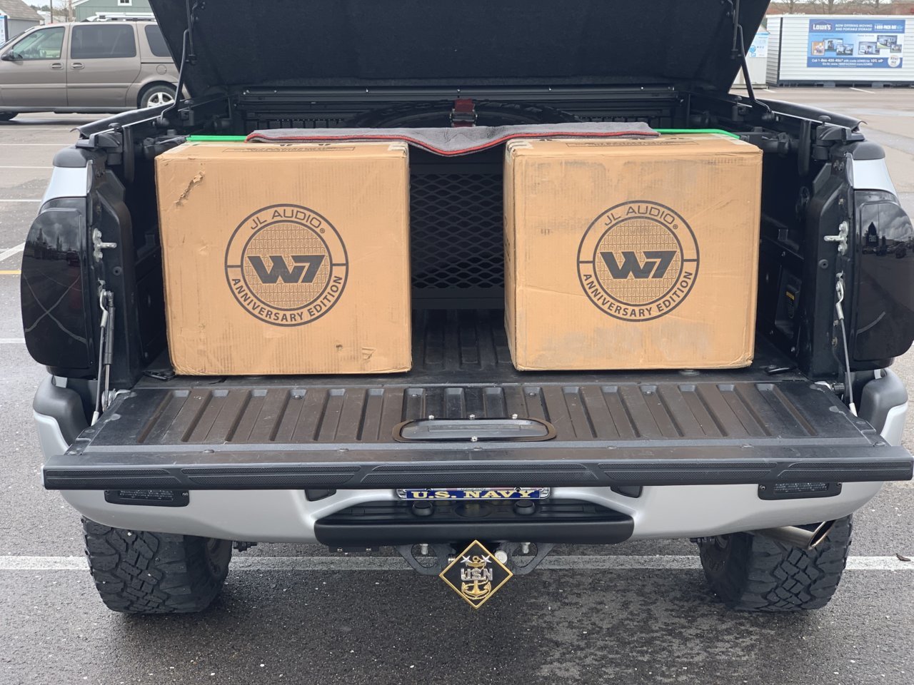

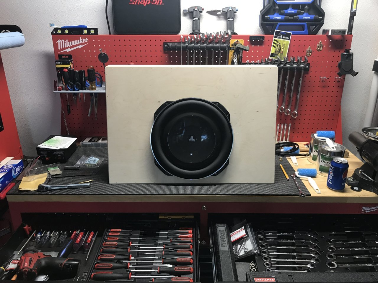

    My setup right now is one JL Audio 13TW5v2 with birch Mr Marv sealed box. Hits pretty hard and tight. Pretty happy with the setup. Not bad with ZERO room behind the back seats of a Taco...
    BUT! I need heavier, super tight bass, that can hit pretty low...
