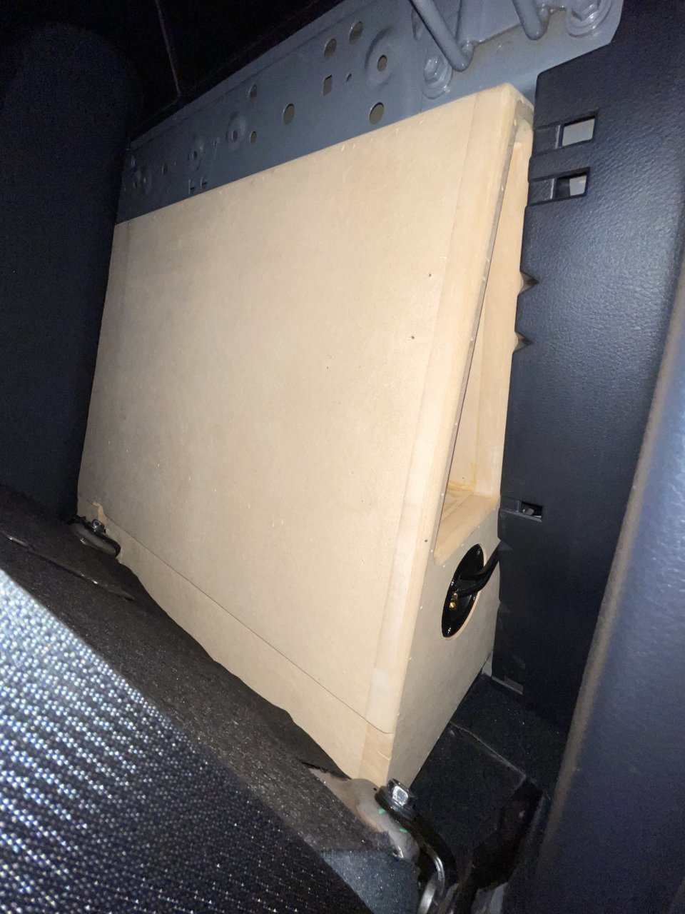

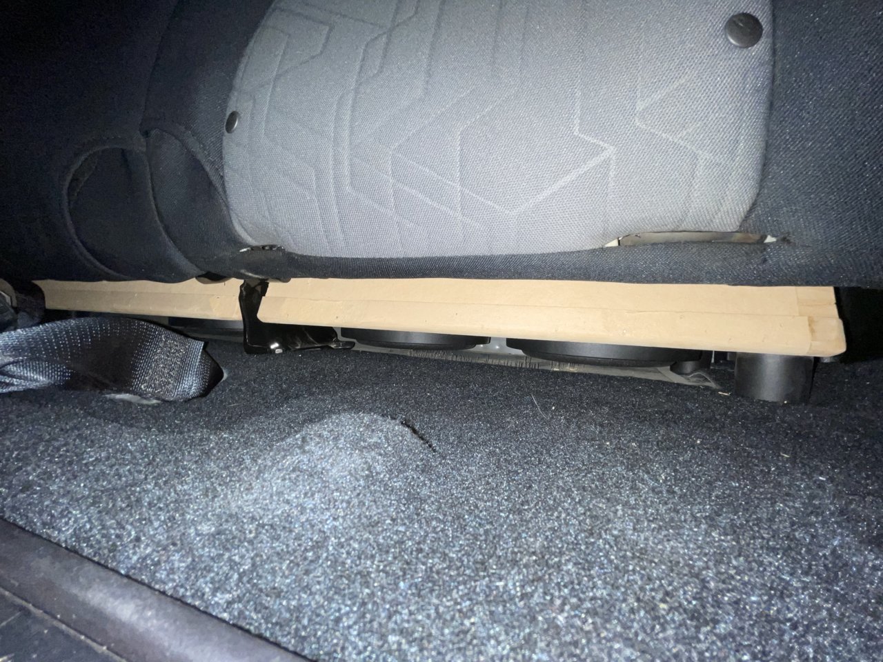

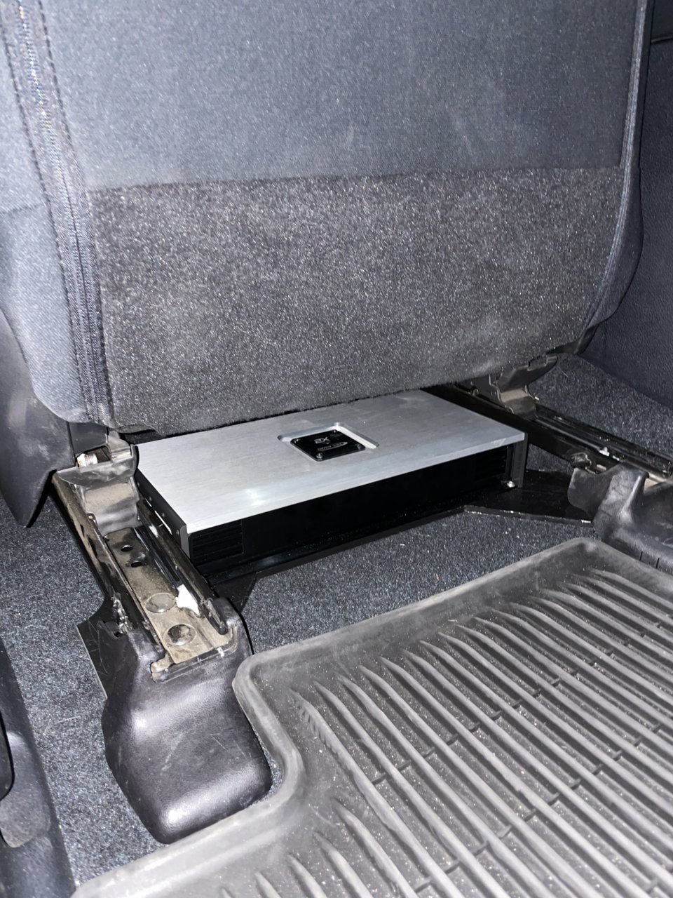

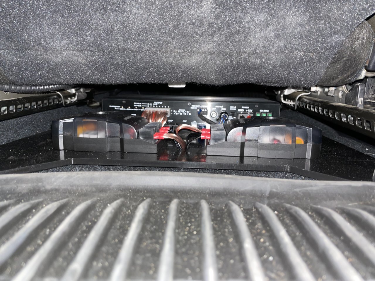

    Finally got my system in and switched from my previous plan.
    3 Audio dynamics 6.5” Dual 2 ohm subs wired to 1.33 ohms in ported box behind seat firing downward.
    Arc audio X2 1100.1
    Arc audio PS8-50 8 channel DSP
    Memphis MCX60C components for front
    Memphis MCX60 coaxial rear
    Sound deadening
    Down the line will add a mid range to get full use of the 8 channels once I upgrade my factory head unit.

    Here are a few photos

    What did you use for an amp rack

    ABS plastic bolted to the seats

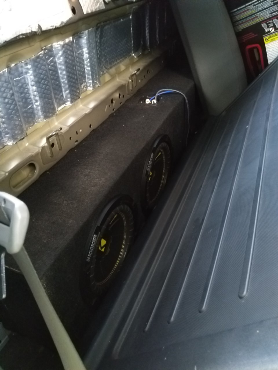

    Here's how the latest box ended up. 48" (L) x 6" (D) x 9.75" (H) with a notch for the seatbelt and stuffed with poly-fill.
    Running two SVC Comp-Cs at 2 ohms on the fifth channel of a Kicker CXA600.5, which is probably giving them about 350 watts RMS. They certainly don't play super low, but hit much harder and stay more composed than the single 8" Comp R on the same amp/wattage. The single sub in a roughly .5 sealed enclosure would fall apart when pushed...so not sure if the Comp R doesn't live up to rated power or I was just expecting too much from one 8" driver (probably the latter).
    Either way, two lesser model 8" subs seems better in this case than one nicer model.
    I removed the storage bin under the rear seats and put the amp there, but it's a little big. Thinking of replacing with some of the small Taramps amps.

    You got the sub box from mauisounds? or were you able to find a local shop who can fabricate one?

    Yep , Maui sounds. Found him on YouTube. Haven’t found a box that hits as hard as this one on YouTube. These 6.5s are slamming

    It’s a cool design. Makes good use of space. A few extra inches and we would have more options.

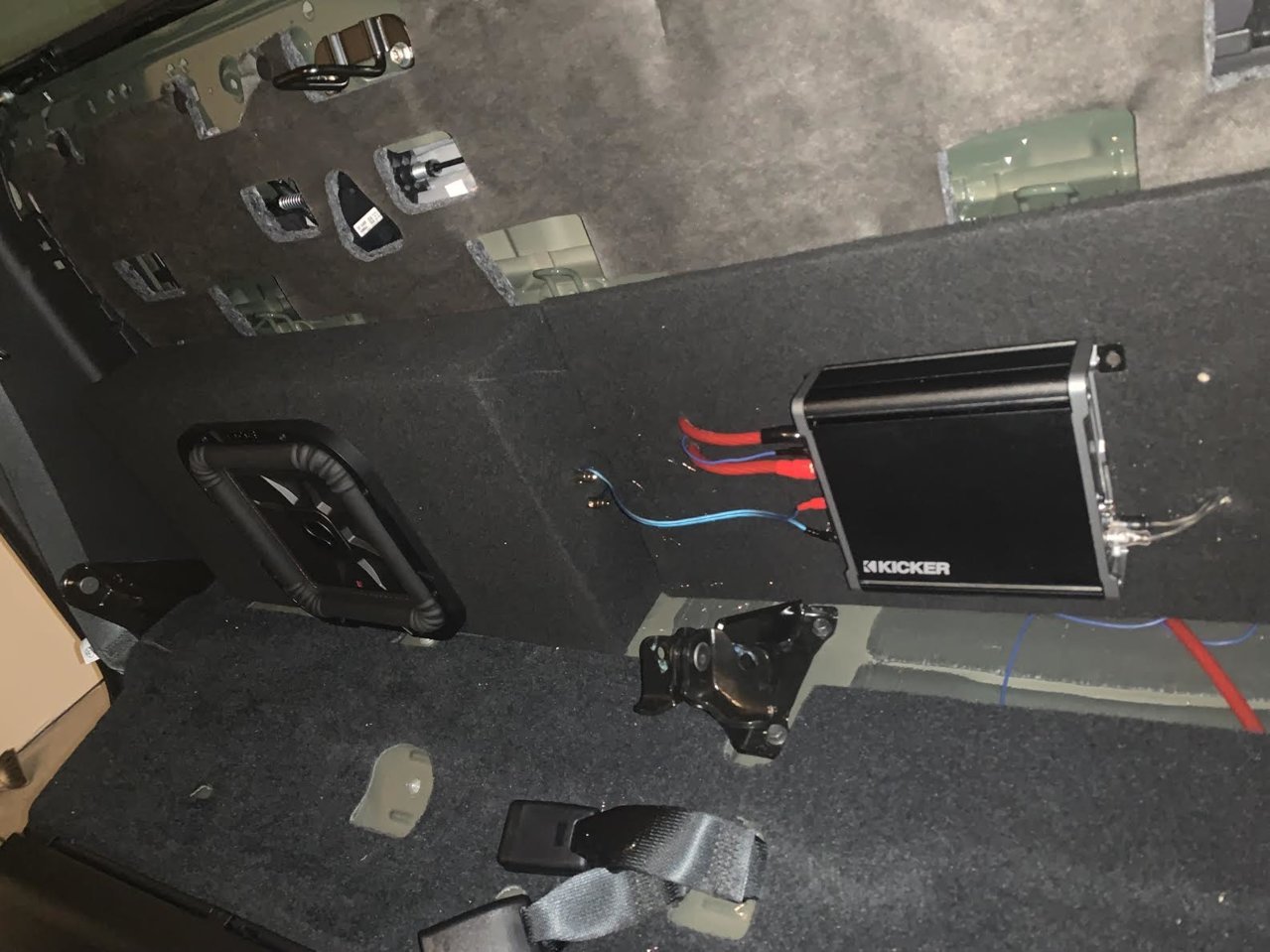

    Two kicker l7 shallow 10’s and an old school zx750

    Sweet setup! Please share more about your setup and your impressions. Thanks!

    I’ve got kicker ks component 6x9s up front and ks 3 way 6.5 in the back. Im using a kicker key 200.4 to drive the fronts. There is approx 1.4 usable cubic feet in the box so its not the min requirements. Its loud enough for cruising with the windows down doing 70 and still has some room to go up. The subs surprisingly have a nice low in the sealed enclosure, if i could have made it a bit bigger I think I could have pushed them a little more but its enough to shake the mirrors which is what I wanted.
