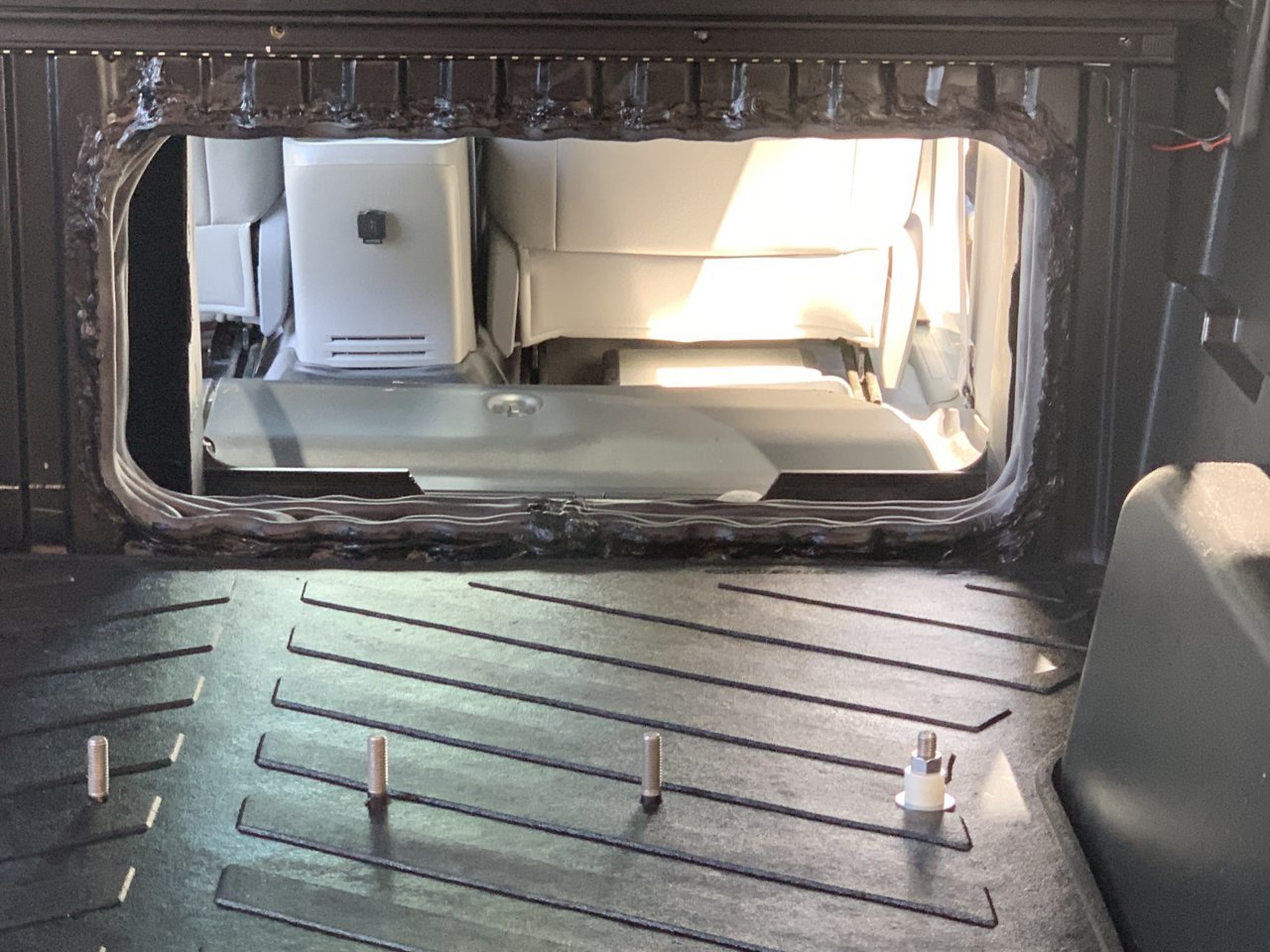

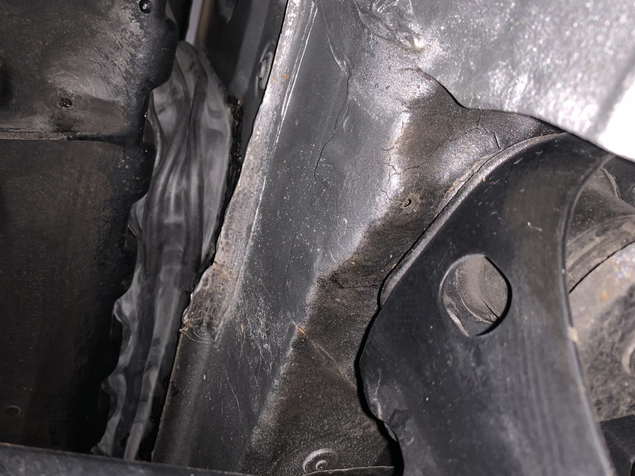

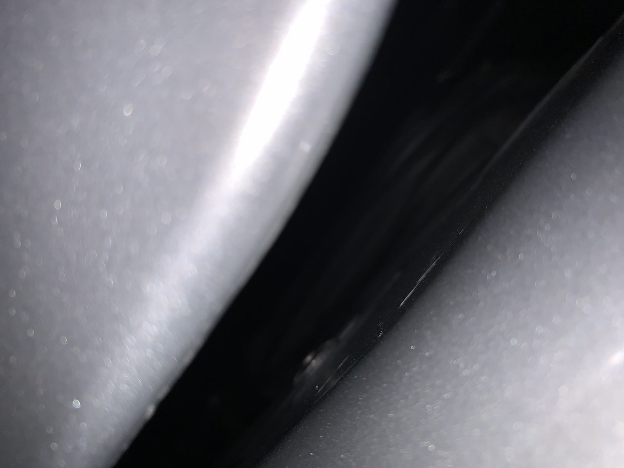

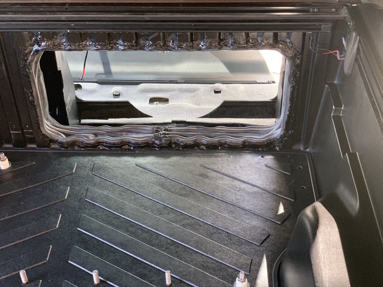

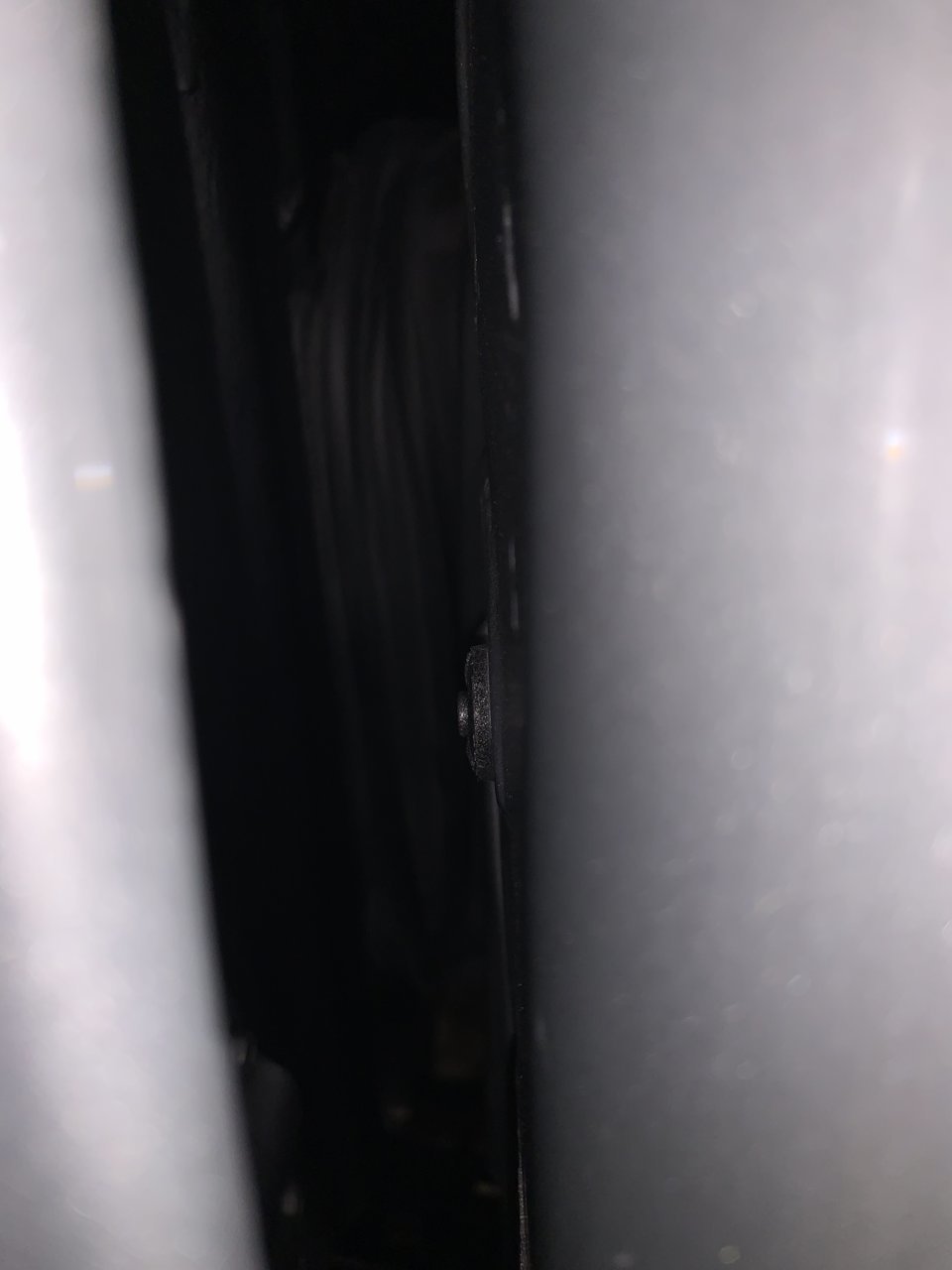

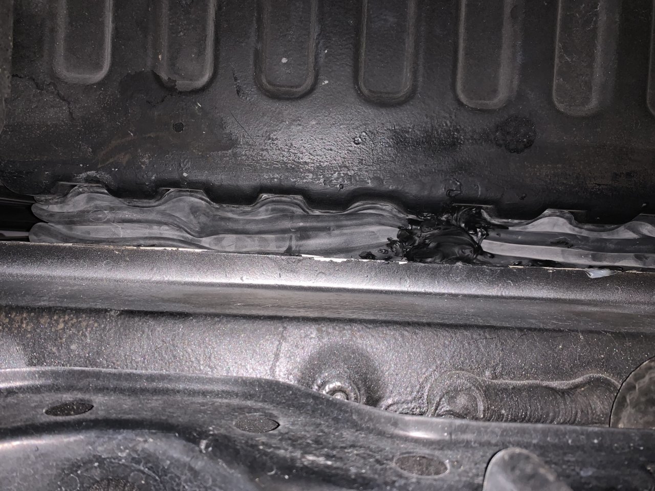

    And pics of the space between cab and bed?

    I’ll take some pics tonight when I get home.

    A611101F-38AA-4596-93F2-799310345DB3.jpg 6F5BEC2B-1A80-4161-B67F-76968E5D504B.jpg 060501D2-4AA7-4253-84EF-673F1B35D521.jpg 4EA50252-708A-45FE-8724-36FF3D5486AF.jpg 4B7E7FE6-AD91-468E-ABBE-571BAF2B5A13.jpg 119959D7-1442-4FE5-B489-7D4D85507F85.jpg

    Crazy

    What about it?

    I guess you are planning on keeping your truck very long term then with the big cab hole. I don't think I could ever do it. I seem to trade up every 5 years

    I’m the original owner. I purchased the truck, brand new, with 3 miles on the odometer, on October 19, 2005. So, yes - I will never, no matter what, will get rid on my Taco.
    I own three other vehicles.
    Like I said, it’s not for everyone. I couldn’t be happier with the results. :thumbsup:

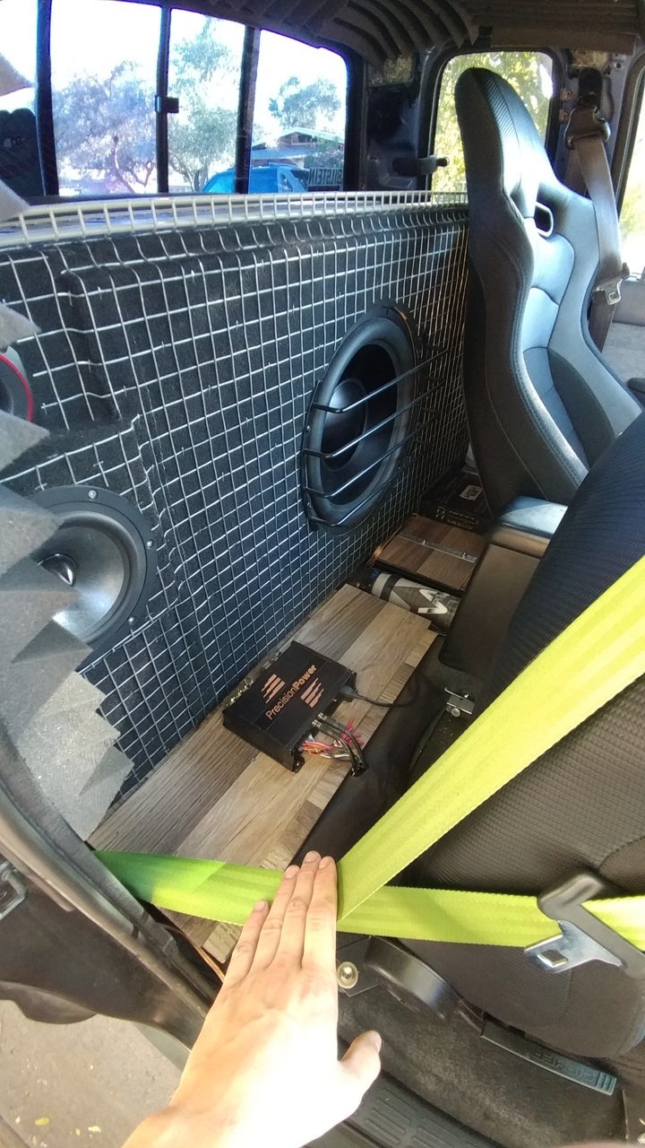

    15" dayton, tuned to around 15Hz. Box built by me, originally modeled in Bassbox, crossmember braced internally - rigid as hell. Side channels full isolated with 2nd order Linkwitz-Riley filters. Moderate fill insulation on all 3 cavities. Was built for sound QUALITY and subsonic response. Tweeters need resistors and then filter recalibration (or get less sensitive tweeters (or just yeet everything - its not perfect))

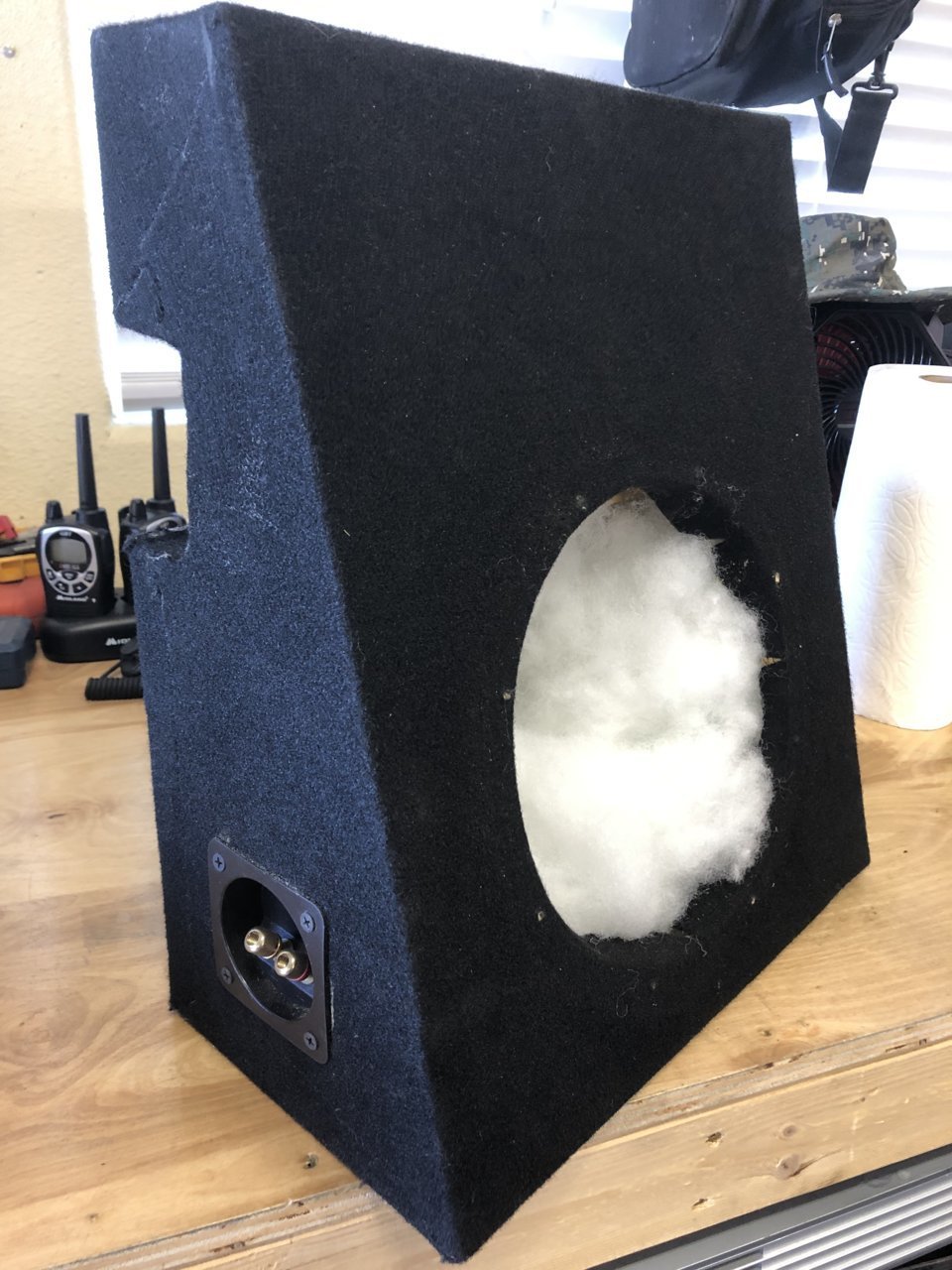

    Anyone have tips for what needs to be taken out of the rear driver side cubby are for a Tacoma box to fit?
    Scored a new box from a fellow member and it doesn’t seem to have enough ‘space’ for the seat to maintain full range of motion when folding up/down. Before I start hammering/cutting out parts of the back panel. Wondering if anyone has a tip or two
