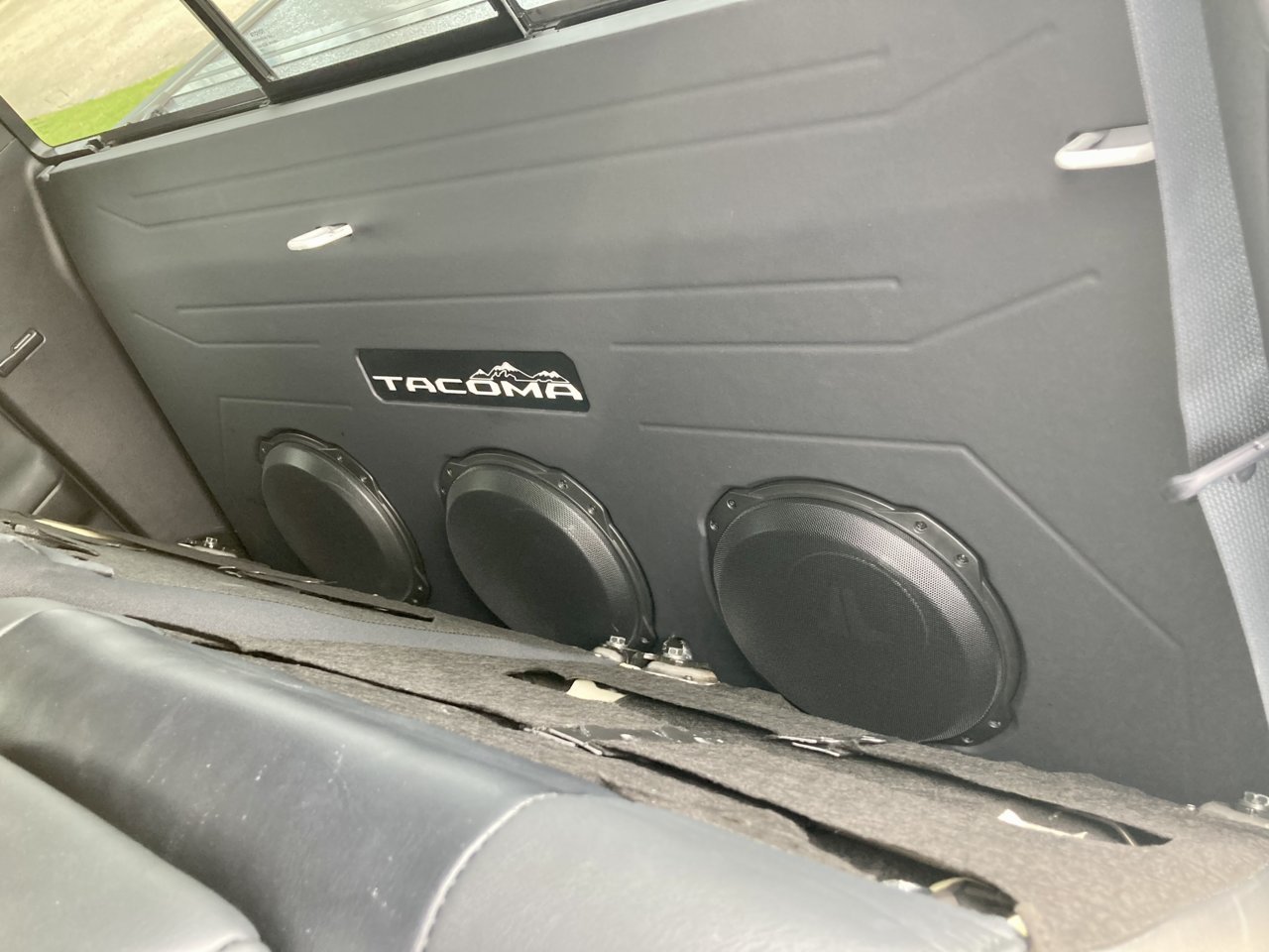

    34754F54-639B-416E-A6EB-18C26D50913F.jpg CCDDECF4-E86F-4E92-871D-494919A12C0F.jpg FACB0F58-AFCE-4FF2-A2E4-B8CEE163885F.jpg 703231E3-2B0F-4FE9-BD17-DA5896F3CA75.jpg 3E5E8387-9087-40C9-82F7-925B338620DD.jpg D20E8019-EAFC-401C-8067-3C8F3E35976E.jpg 972FD9BB-9A93-4144-904C-4D2571E0BE06.jpg DDB72EED-8FBF-4BBF-9C7A-24024FB7F311.jpg 3E1E9388-2240-4ED1-B5D9-EA0E494B90E9.jpg 15ACB97B-F1AF-4019-98A4-1590E8CF5BFD.jpg B370F4B0-3E5B-4D47-819F-D87F6E0393C5.jpg 8B028D7C-C33C-4303-A3FD-2F54E2BF98C7.jpg This is the best set up I have found without doing a blow through and if I didn’t need my bed space for work I would have done the blow through to begin with since there is no space in these trucks. Previously had 2 JL W6 subs in ported inclosure in a Titan XD and it would make your eyes crooked. Tried the JL stealth box and ground shaker ported with a 12. Not enough for me but sounded good. Ended up finding this box out of California for 3 JL TW3 10” subs sealed and tried it even though It was expensive but you can retain the factory look of your truck and I already had my amps and one TW3 sub. Sound proofed entire truck and ran Focal 6 3/4 components front and back. Running them with JL HD 600 and the 3 subs with JL HD 1200. Did the big 3 upgrade and the power seems perfect. This set up sounds really good and still has insane bass.

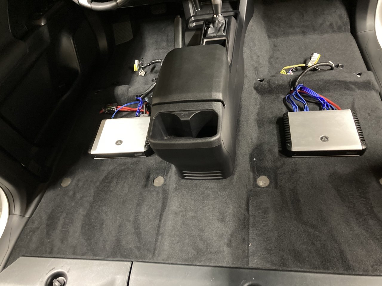

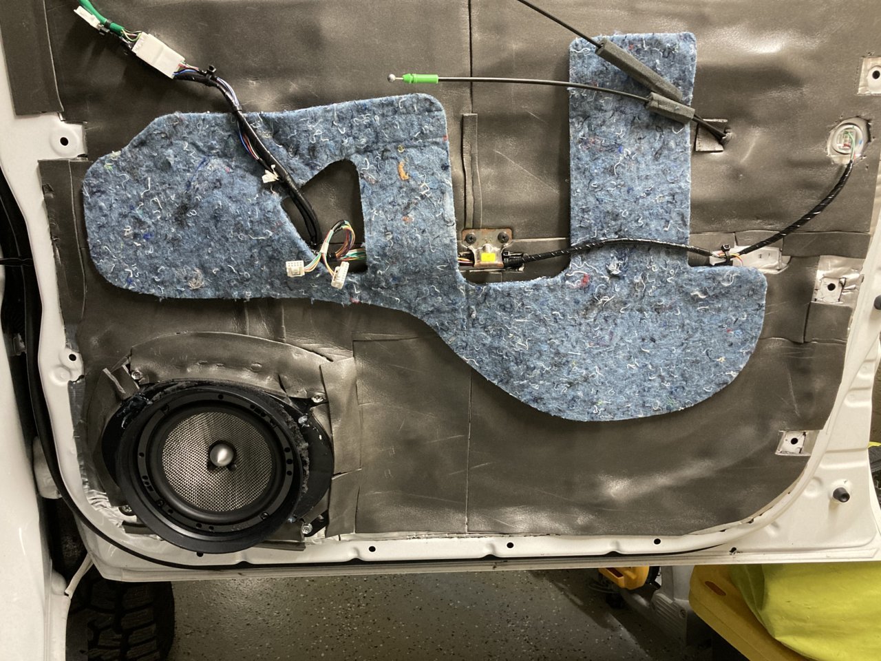

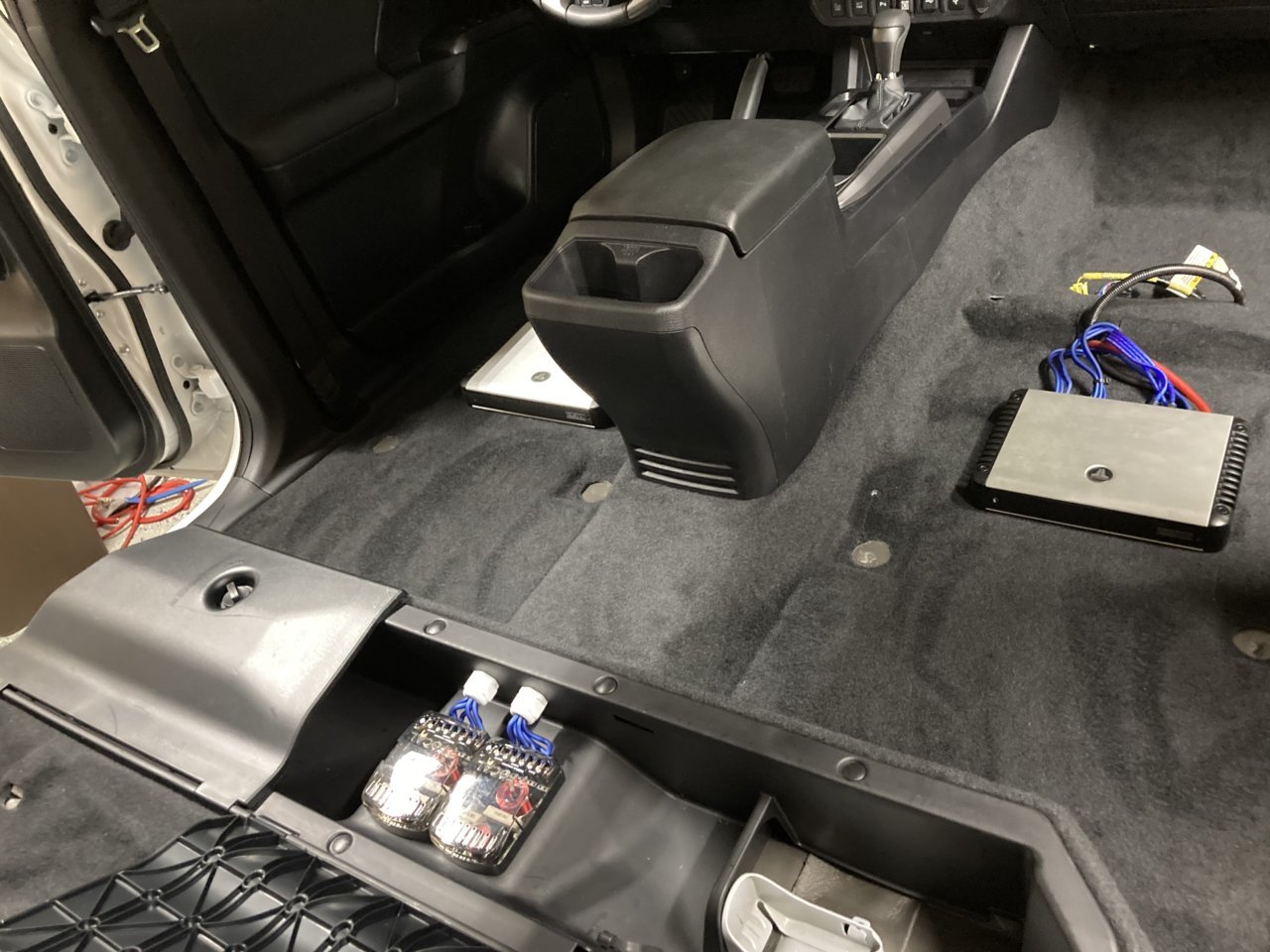

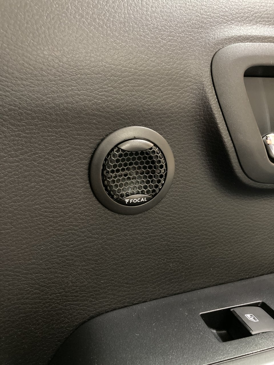

    94C607E2-9F66-49FD-A0E5-DFB55E7F8F2E.jpg B83C83FF-7D03-4C65-A02B-64C6AE899614.jpg 07C18B86-AC37-473E-8653-B4944B35649B.jpg 69A550AE-803D-41A3-A4DF-49F1DBBC628A.jpg C04DFC83-36FF-4751-B050-46DD0F7DD867.jpg Finished up the sub install. I went with the Rockford Fosgate Power 1000 Watt class-AD 5-channel amplifier (T1000X5ad) and Rockford 12” P3 shallow mount subwoofer. The box is the Ground-Shaker single ported 12 inch from eBay.
