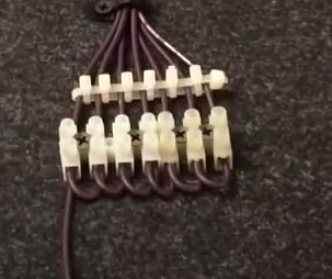

    Maybe ill just tap into the head unit.

    yep, just connect safely all remote wires you need together with the rem from HU and that will work

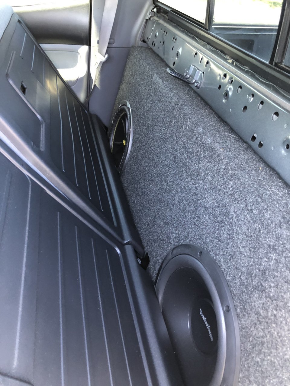

    My setup in my 2010 Tacoma I just sold is in the image. It was an ok setup, but when I originally installed it, it was incredibly underwhelming…. For reference, I had stepped down from a 1x15” and 2x12” Kicker L7 setup in a 2004 Monte Carlo. I couldn’t tell if the SQ was any good because it was too loud haha.
    I am looking at this thread for ideas on my new (to me) 2018. I’m debating between dual Memphis Mojo 6.5” vs a single 10” Kicker L7T. I’m leaning more toward the Memphis setup.
