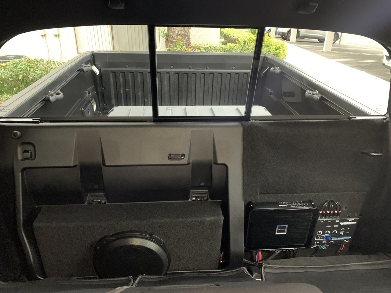

    Ive had it a few years, its a very small sealed enclosure that i have packed with Polyfill. I have it on a small 5 channel Soundstream Picasso Nano PN5.640D. It performs well, very accurate, not too loud. The sub channel is 200w. I just picked up an Alpine PDX-V9 that I will be swapping to run the system for a little more power. This Birth certificate says the sub channel came in at 528w. Im sure ill have to dial that down.

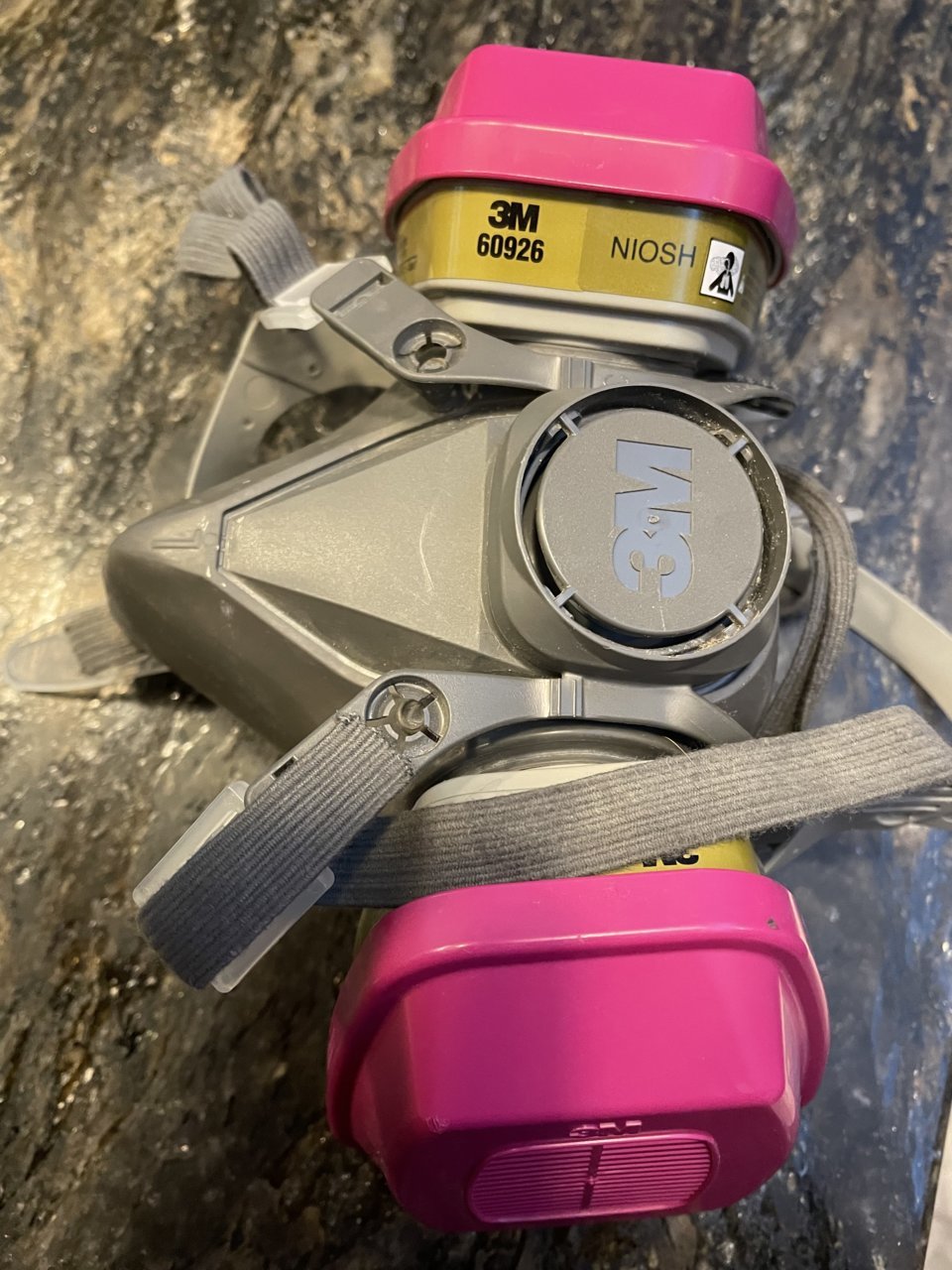

    Something that filters solvents and oils. I like the 3m half masks with the pink p100 filters (filter cartridge numbers 60923 or 60926). Amazon usually has them when the box stores are out.
