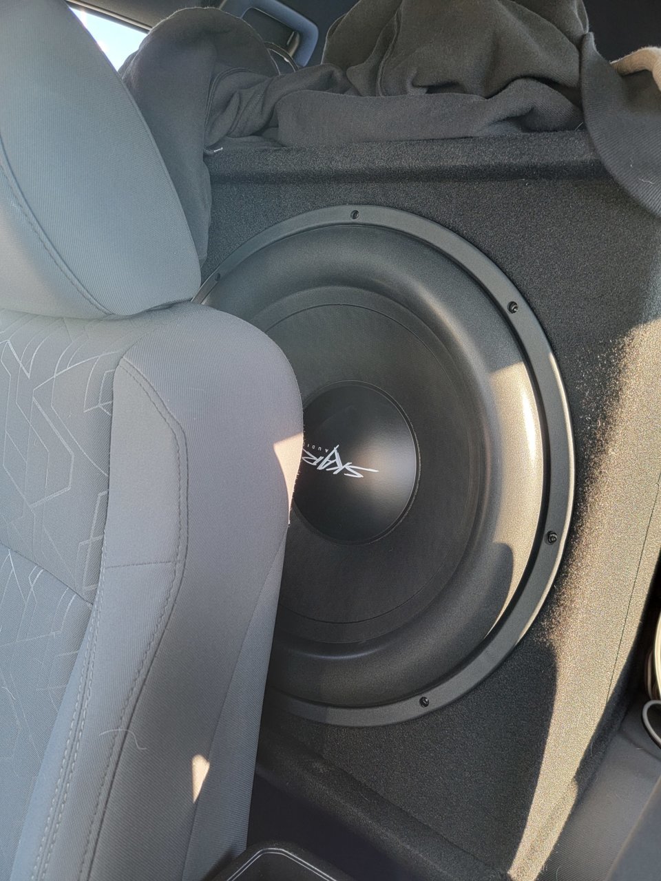

    Never had an 18" subwoofer before, so I went ahead and ordered the Skar sdr 18" sub/box bundle, it was $297 and change. It was delivered on Saturday, so far so good!20220228_091135.jpg

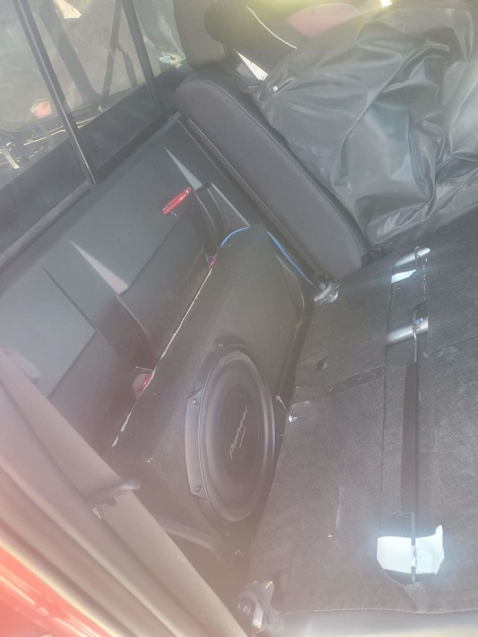

    Finally got time to build my box this weekend with help from a close friend. Sundown SD-4 12” on an Audio Control 5 channel. Still needs some tuning but overall I’m very happy with it

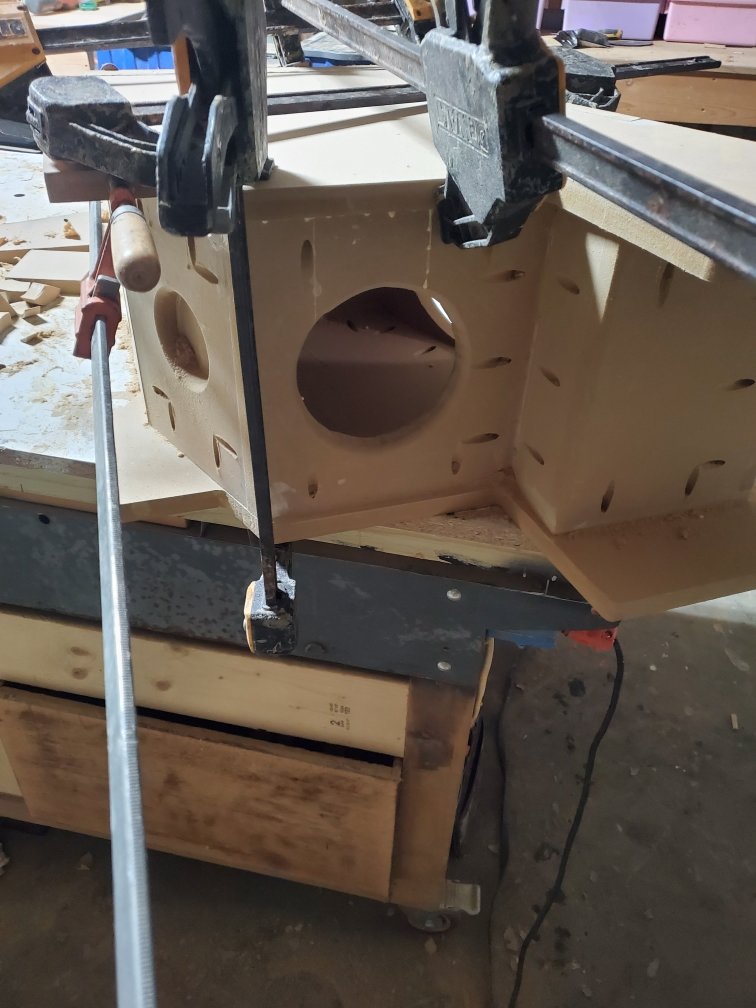

    while the weather was nice last weekend started building the passenger-side box i'll be needing. not entirely happy with how it's turning out with literally everything in the way(cheated hard with a 45 degree chamfer, and dremelled some recesses where needed), left the front off for the time being, i'm going back and forth whether i want to inset the drivers, which would add another 5/8" backer behind the front face and take up even more internal space, or just mount them on the face and deal with any excursion issues if they arise. also debating building a brace for the middle.
    with all the airspace reductions, i'm starting to consider installing an aperiodic vent, aka 'leaky box' to make up for it all, though i might just build it and hope for cabin gain to correct for the loss of airspace.
    likely could've gone bigger if i was going to run 2- 8" instead of 2- 10", but i'm stubborn... going with an SB Acoustics SW26DAC76-4, and a CSS APR10 passive radiator. it at least modeled really pretty. nearly flat down to 25hz.

    I'm having a hard time picturing what you are doing. Why all the space reduction inside the box? What are the cutout shapes supporting and/or avoiding?

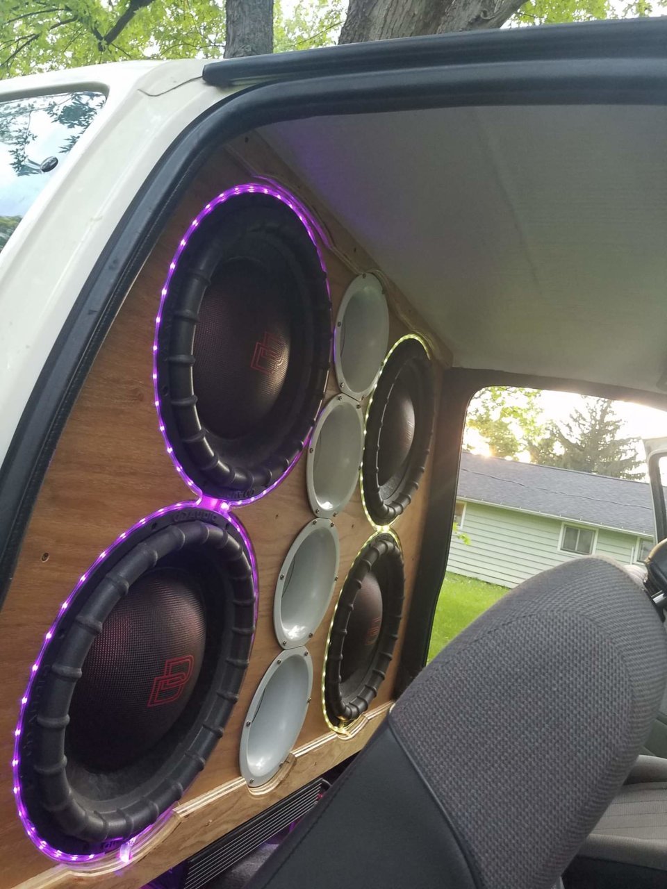

    Small lift on 33s with 4 15 inch subwoofers
    Here's my little setup
    It has 4 dd 9515s

    I did something similar in 2000 with my 1992 sr5 extended cab. But I did four 15 inch JBL gtx subwoofers and a ppi pc2150 amp. Those things were monsters. Only ran it for a week until I pulled them out for a pair of infinity beta 10s and some xtant amps.

    That’s nothing! I have a Sundown audio 12” in a .8cuft box. :rofl:
    Kidding! Man, that’s sweet! Bet it gives great back massages on long trips. o_O

    i'm attempting to install the box on the passenger side 2/3 of the back of the cab, where more obstructions are.
    the cutout/shapes is to avoid everything on the passenger side. the 2 'slots' are for the child restraint hooks that i'm not willing to alter for numerous reasons, and the angled portion is the required clearance around the rear power window motor.
    i only had 1 warm day to work on it so far, so haven't gotten further-- when it warms up on a weekend again, i'll take some pictures in the truck to better show the clearance limitations.

    Would you mind sharing the thinking behind a preference for the passenger side rather than the driver side? Because you want the driver side for storage? Some other reason?

    it really just comes down to how toyota divided the seatback. the 1/3 side just simply isn't a large enough box for what i want. ideally, i'd love to use the 1/3 side so i had more space for storage, but i need to be as close to 1cu ft box as possible, and my modeling from others box sizes indicated that i couldn't surpass about 0.5cuft on the 1/3 side.
    i did consider going 2/3's across the back starting at the drivers side, but i wouldn't be able to integrate the factory storage cubbies into that design. whereas by shifting towards the passenger side, i'm consuming only 1 storage cubby, which makes for a 100% reversible setup--i do plan to keep this truck until the frame rots out, but surprises happen, and previous builds have taught me it's always better to be able to plan to revert to stock than leave a bunch of oddball custom gear installed when going to sell/trade.
    but i'm also insistent on doing a weird and wild active/passive setup. i've always wanted to do one, just lacked the space. this trucks mostly got space, so i'm bending it to my will.
    Sdswingr and CowboyTaco like this.

    Oh, s, sorry, I had my driver and passenger sides confused.
    you really want a full foot? No mr Marv or JL stealthbox for you?
    I think that part you are doing up high is maybe wasted effort. Not a lot of space gained but lots of extra work.

    i like to run, um, more 'unique' setups :)
    i don't care for jl. nothing against them, just don't care for them.
    mr marv seems busy enough for my specific needs in a very-custom box. i don't know how much mr marv charges, but i looked up the 3/4" baltic birch plywood i'd require-- currently $160/sheet. no matter what, i'd need at least 2/3's of a sheet of that stuff, and if my labor rate is any similar, it'd be close to a $600 wood box. he does nice work, but i'm not even convinced that i'm keeping this setup for any length of time. the entire thing is an experiment. i've had this MDF laying around for over 2 decades for a custom sub box i was going to build in 2006, and 5 cars ago... it survived 1 house moving, so i'm using it somewhere ;)

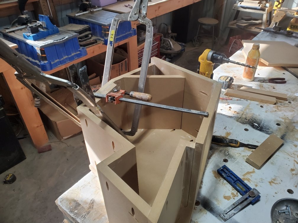

    some pictures in the truck, and the clearances i worked around.
    the window motor is centered between the child seat attachment points, so there appears to be gaps on either side of the motor, but were intentionally left open to allow an unobstructed vertical channel for any strap that'll drop down from the top of the seat to the attachment point, if i were to ever use those points:
    it's a tight fit, but i'm confident that it's the absolute largest box i can fit in the space and around the obstacles unless i were to fiberglass a box into position.

    That makes WAY more sense! I don't have the power rear window, so no motor to contend with. I appreciate the follow up.
    Oh yea, looks good!

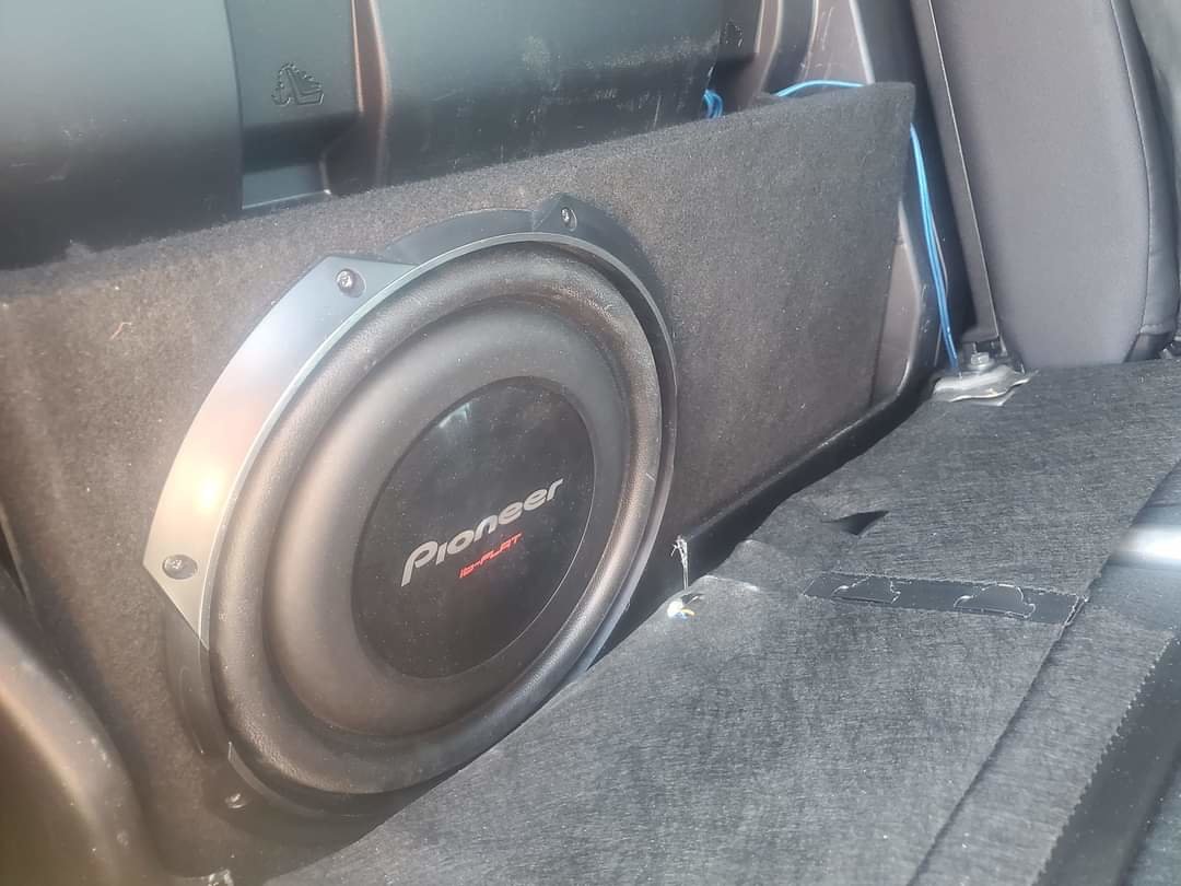

    Custom sealed box in my 2021 TRDOR for a pioneer shallow mount 12", done by a buddy of mine in Pocatello Idaho( T-Dubs Customs) Paired with a DS18 monoblock 1600w amp mounted in the driver side cubby.
    Kept the storage boxes, with minimal trimming of the lower edge. This is the shallowest 12" sub on the market, mounting depth is only 3.5", and rated for .5-1.0 in³. Removed the seat back plastic for fitment, but will be putting it back on as it fits fine with it. FB_IMG_1649359790359.jpg FB_IMG_1649359784810.jpg FB_IMG_1649359777023.jpg
