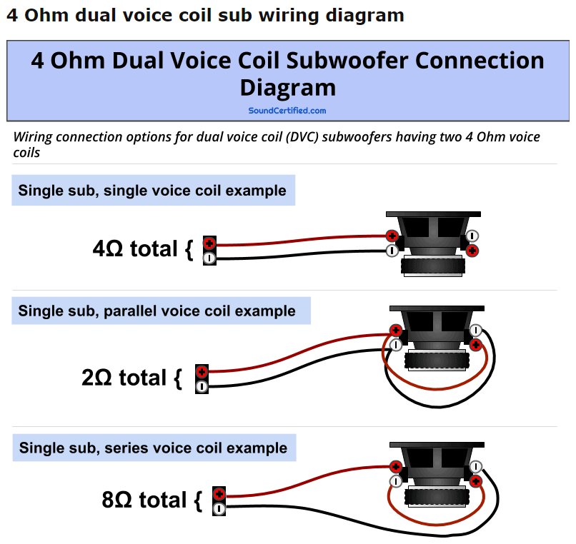

    So, I have a couple questions about the NVX gear you recommended here.
    First the sub - Its rated at 350-500w RMS at 4ohms. The amp you suggested is rated for 310w at 4ohms. Wouldn't this be a bit underpowered for the sub? Would it be better to go with the NVX NDA 103 that is capable of 390w at 4ohms? There is also the NDA104 rated at 580w at 4ohms but i think that would probably be overkill unless I were to turn it down a bit (I assume thats what the level adjustment can do? i am a complete noob to this!).
    Am i looking at this all wrong?

    The RMS rating is what it is capable of pushing(amp) or receiving(sub/speaker). If you turn the volume down to next to nothing, it isn't going to push LOTS of power. You generally want an RMS rating on the amp that is below the RMS rating on the sub. Of course, you can try to match them, but they don't always line up.
    In my exerience, there usually isn't a range of RMS rating. So I would say that sub is either rated at 2 different ohms, or it can handle 500W RMS. I don't think there is such thing as a minimum RMS rating (i.e. the 350).

    Ah okay - that makes sense and I think that 'range' may be throwing me off. Perhaps it is 350W at 4 ohms and 500W at 2 ohms?

    ok so if I am understanding correctly, I believe you saying to run the nvx in parallel rather than series, that that would have it at 2ohms vs 4 ohms, which the nda102 amp you suggested would pair perfectly with. Am i wrapping my head around this correctly?

    Ok so I believe I just answered my own question. Running the dual 4ohm voice coil NVX VSW104v2 sub in parallel would net 2ohms which the NVX NDA102 supplies 500w RMS at. Running in series would actually give me 8ohms which is not at all what we are looking for.

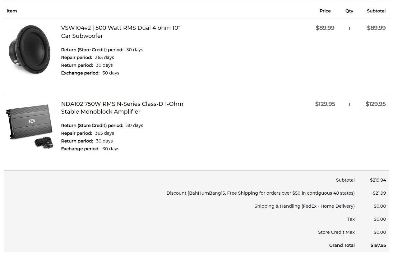

    Just placed the order direct from NVX for the sub and amp! Scored a promo code that knocked 10% off. Free shipping an no taxes; came out $40 cheaper than Amazon and Sonic with the coupon code and no taxes! Thanks again for the recommendations, a bit of research concluded this hardware will perform exceptionally well for the price point so I am excited to see how it all turns out.

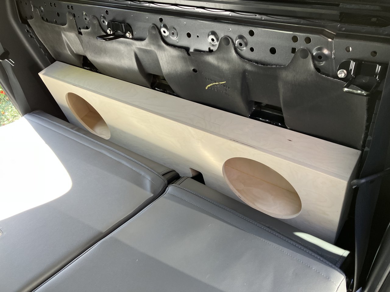

    got all the big cutting/routing/mounting out of the way today. box is assembled, preliminary sealed, and routed for the big parts at least. need to let it set for a 'week' for the glue to setup before i do final sanding and painting. probably another 2-3 saturdays to go on it.
    i ended up making some mdf donuts to thicken the mounting surface for the subs. i'm not happy with the subs sitting proud of the box. looks cheap. next part of the project, once the glue sets up on the donuts will be to pull all the screws and router out some mounting lip recesses for the subs so they sit flush with the front panel. i think i'm going to run into some clearancing issues on the back wall with the powered sub doing it, but it looks too stupid to leave this way.

    looking good! Love the attention to detail so far

    The plastic backing of the seat comes off easily and gives another good couple of inches for clearance.

    i noticed that in a few other builds. while i'm not opposed to it, i'm also unsure of where i'm going to do just yet. the initial plan was to have the seatback semi-permanently reinstalled and it would never move. security for the box, so no one can see it's there.
    but, i've really been enjoying leaving that 2/3 seat portion torn out, it makes the truck much more suited to my purposes, specifically where i need to get expensive tool bags that are physically taller than the bed to/from work, while also running by stores for 30+ minutes to grab material. i've got an expectation that my tools will still be there when i get back(lol), so it's been a lot easier to toss them in the locked truck than to try to conceal them in the bed somehow.
    so the alternate plan now is to attempt to keep the plastic backing in case i need to use it to store tools, though i'm also playing with the idea of a hinged flat platform where the seat base would normally be, with some sort of undetermined quick-release system to alternate between the platform and seat bottom configurations.
