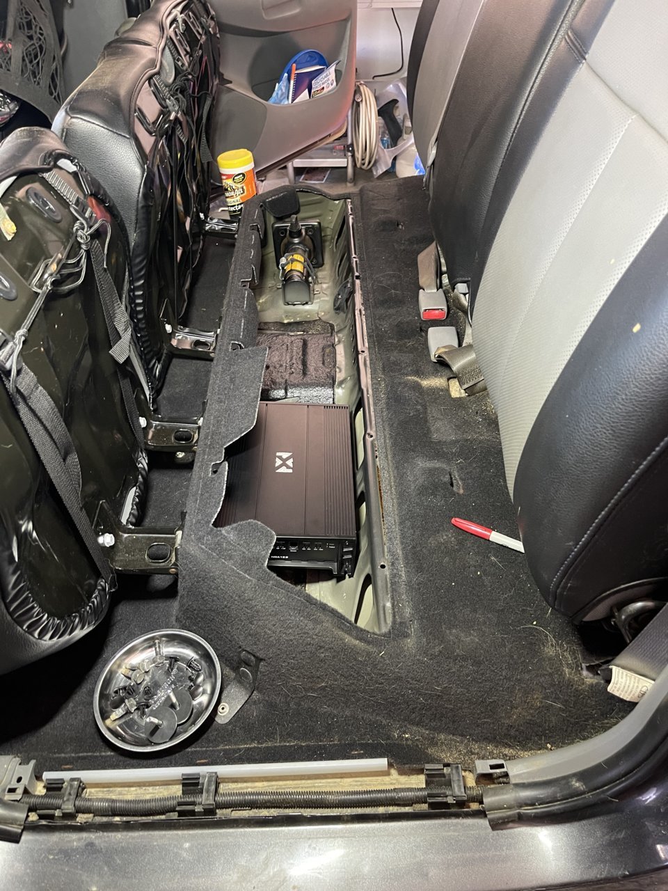

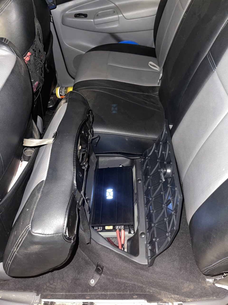

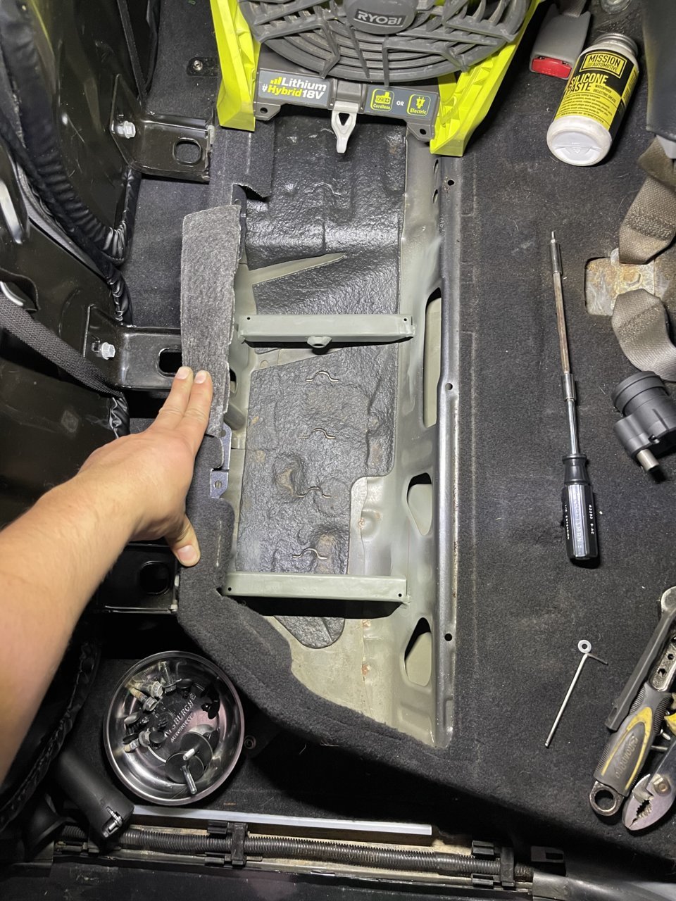

    So I got the sub and amp installed a few days ago. Really happy with the turnout. Used a box specific to behind the drivers rear set to house the sub. Had to remove the seat backing and obviously that cubby back there to get it to fit. Installed the amp under the rear passenger seat in the cubby area. Had to weld a couple of 1” square tubes to mount it flat. Drilled and tapped some holes for the ground and to fasten the amp. Trimmed the cubby and added some edge trim. Really happy with how it all came out. Super clean. Impressive sound for the $$. Sub and amp were $197.95 and box was $188.90, so I’m in this a total of $378.85 plus my time. I already had wire and the square tube so didn’t need to worry about that cost. thanks again @soundman98 for the suggestions.
    Mocking up amp
    Welded in brackets
    Amp mounted and wired up
    Cubby installed
    F61E9118-4EF3-48F5-AFEB-EB2F402128DF.jpg CC8FF998-75E6-4ABB-A947-2BED4DE7C9D1.jpg
    Sub installed

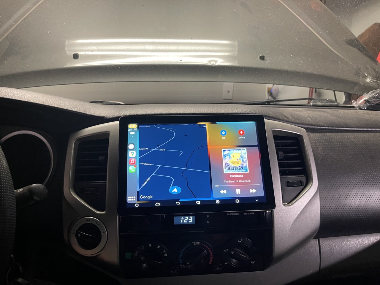

    That looks great! I've looked into that head unit before, and I think the number of pre-amp outputs is what stopped me. I currently have 2 running to my 4 channel amp for front and rear speakers, and another pair that is run to where I plan to install the mono amp for the sub. So I need (maybe want) a total of 3 and IIRC, that one had either 1 or 2.

    That's interesting. I have two Joying HUs, a 9" in my Taco and a 10.25" in my other car. Both have three sets of RCA outputs: FR, RR and SW. The problem on the Joyings is the line level output is garbage in that the signal is low (way less than 2V) and are noisy. The other weird thing is that the HU's EQ seems to have no effect on the SW signal. I'm considering installing an Audio Control LC6i and using the speaker level outputs from the head unit. Regardless, these Android head units are great bang for the buck and can be configured to your liking. There's an ongoing thread here: https://www.tacomaworld.com/threads/3rd-gen-audio-build-android-3-way-components-3-amps-wow.576729/

    preout number and hu settings used to be a concern for me as well--i ran a car audio specific carpc for a number of years just because the available head units at the time didn't have the level of adjustability i wanted until getting into audison bitone territory, or about $1500-2k for just the components... but the last 'semi-permanent-temporary' install, i added a dayton dsp408 just to see what/how it worked.
    no install i do from now on is going to go without a dsp--does everything the carpc did without boot-up times, crashes, hard drive issues, or needing to be windows IT guru. way too easy and consistent to make any and all adjustments i could ever want. IMO, best $160 i could've spent next to sound deadening.

    I’ll need to come back on here and talk to you about DSP’s in the future. I started looking into them when I found out about the low voltage output the Joying supplies but given my timeframe I didn’t have the time/desire to dig any further…
