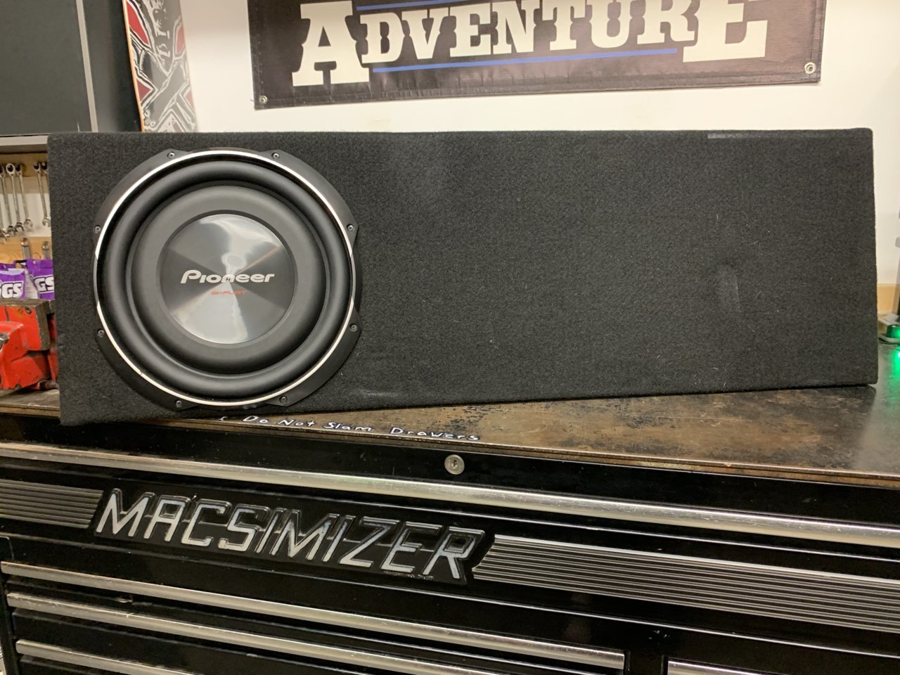

    Hoping to repurpose the tundra box and sub to the taco with some modifications 7A1F46B7-5DD1-45AB-B34A-87A44259408B.jpg

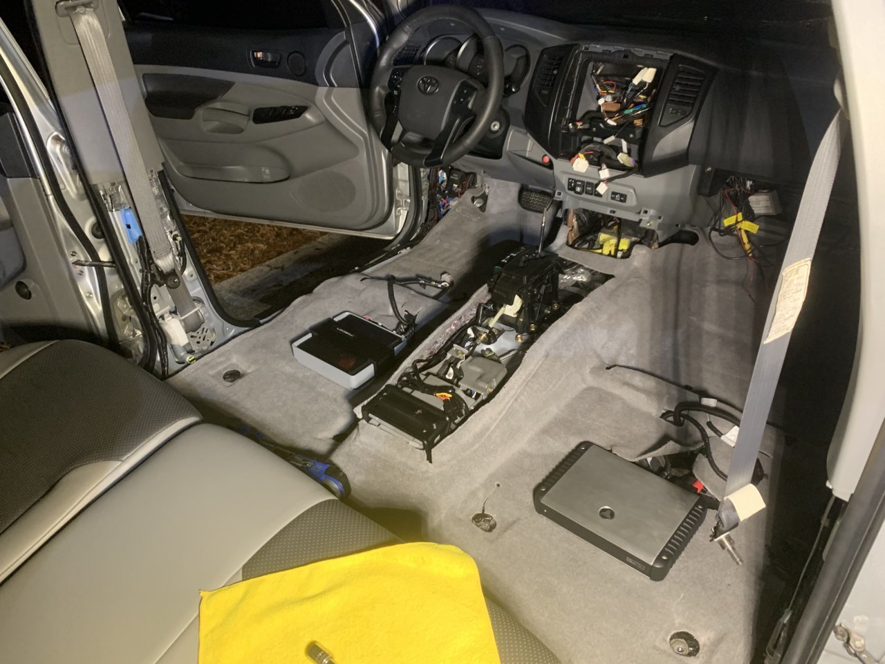

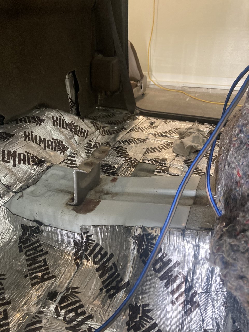

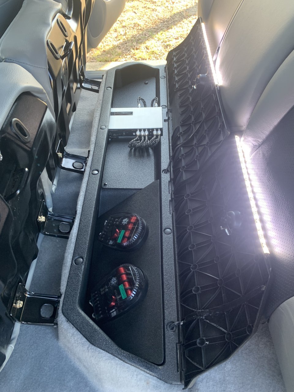

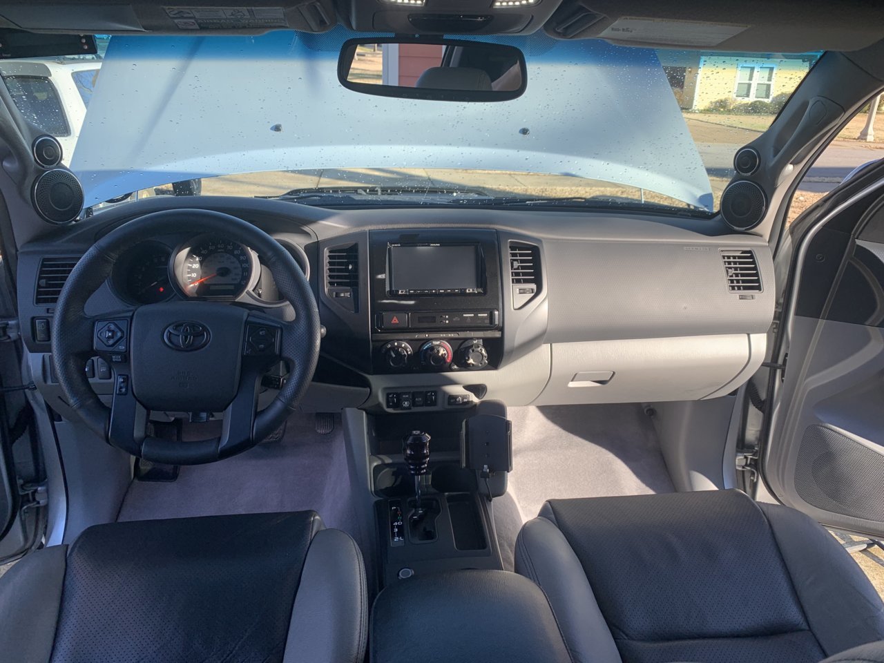

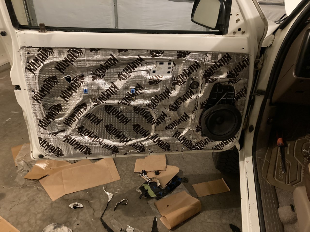

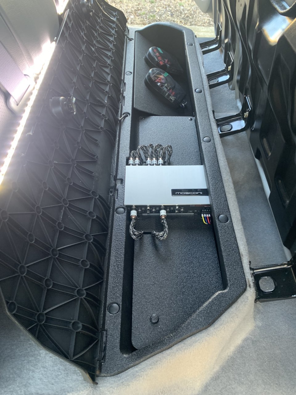

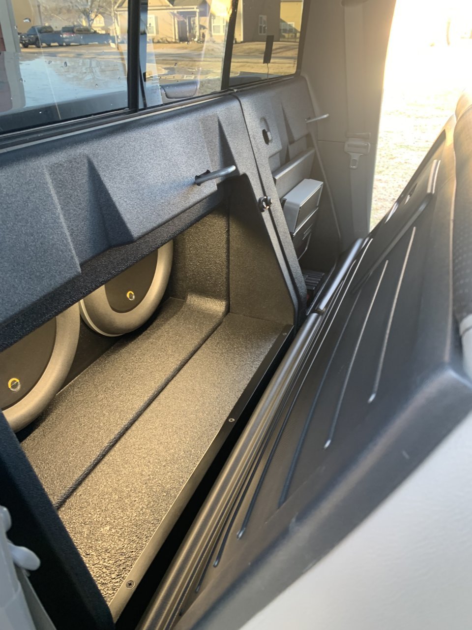

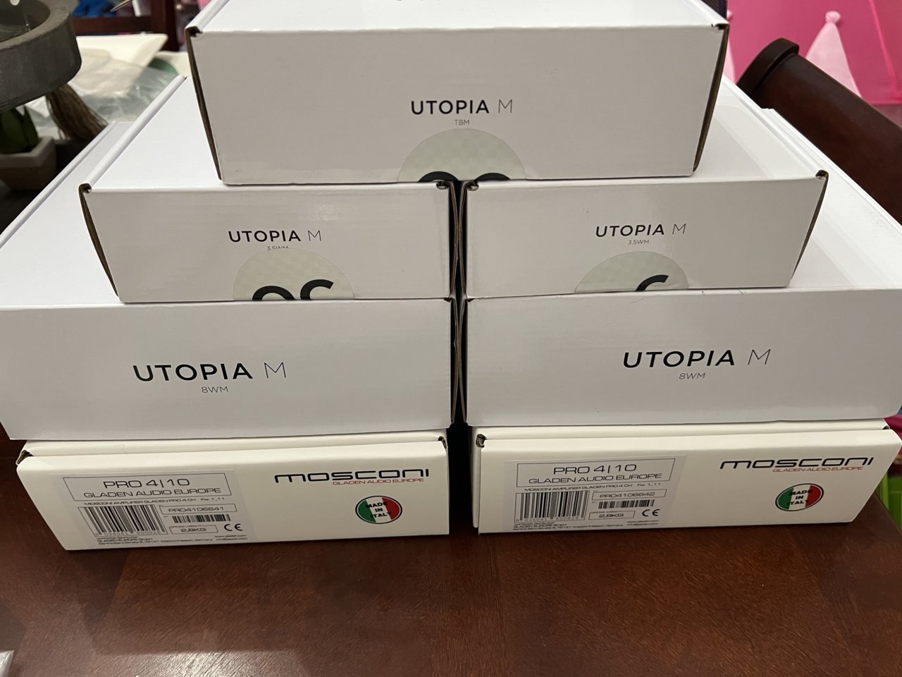

    Time for V3.0
    Gonna take a little while, for what I have planned but I’ll keep doing little by little.:headbang:
    The Front Stage is where the biggest change is happening, going from JL Audio C7 components to Focal Utopia M Series. Second AGM battery setup for all 5 amps. Bridging the 4 Mosconi PRO 4/10s, but the whole project will take me a while.
    The back of the Taco will pretty much look the same.
    2B101DC5-640D-434F-8684-594307BD5345.jpg AB420BE6-C6F8-41FC-8E2D-8FFEC7DB3259.jpg F9845D19-A893-406D-B423-ADB1527AA1E4.jpg 6B5FAC97-B751-4178-AACD-D39DB532DEDC.jpg C96DA2EF-C228-49B5-AA26-FF408F2CC735.jpg 61B1C1EF-3D60-41BB-8B04-9765E0156023.jpg 07AEE536-9B9D-4613-A96B-1475B3F1050E.jpg

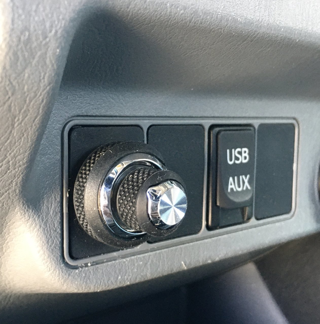

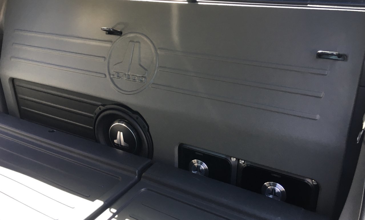

    JL Audio : Amps, Sub & Knob
    Alpine : OEM speaker replacement

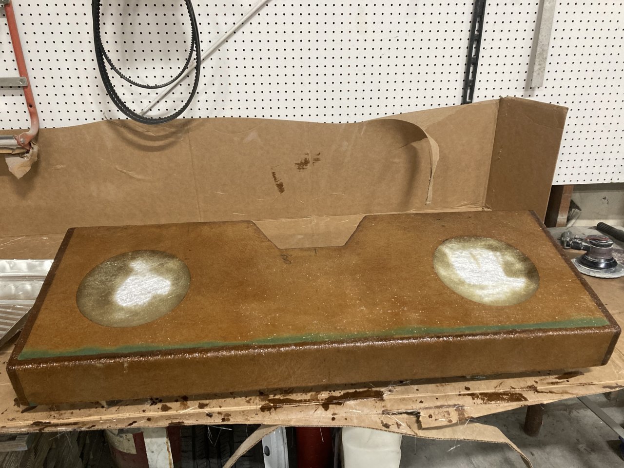

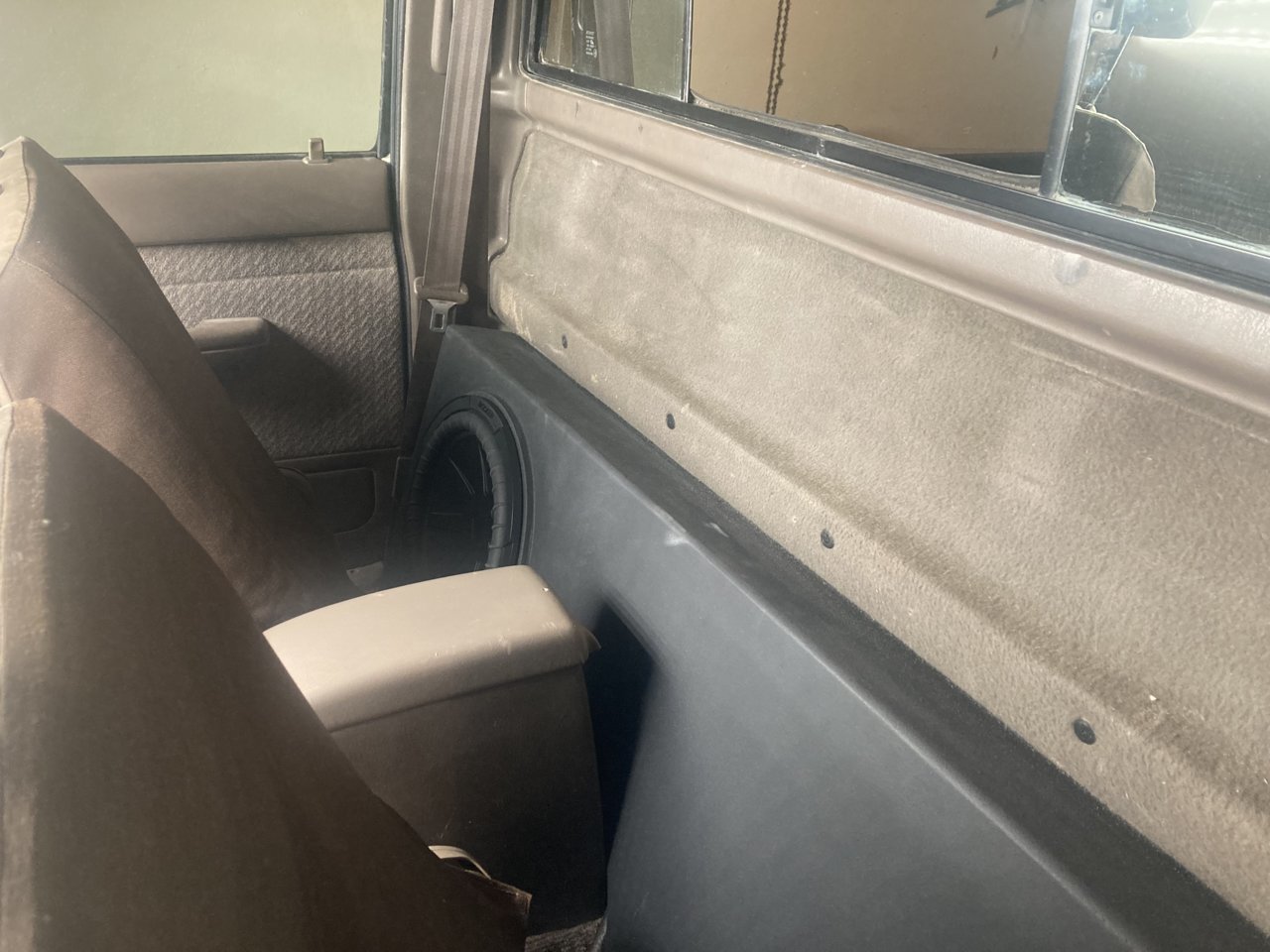

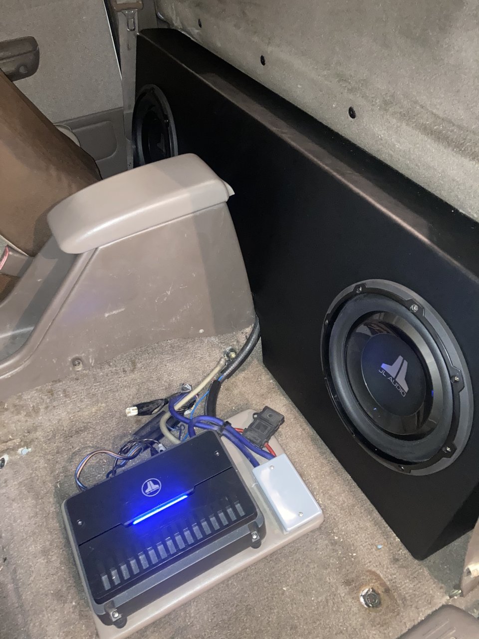

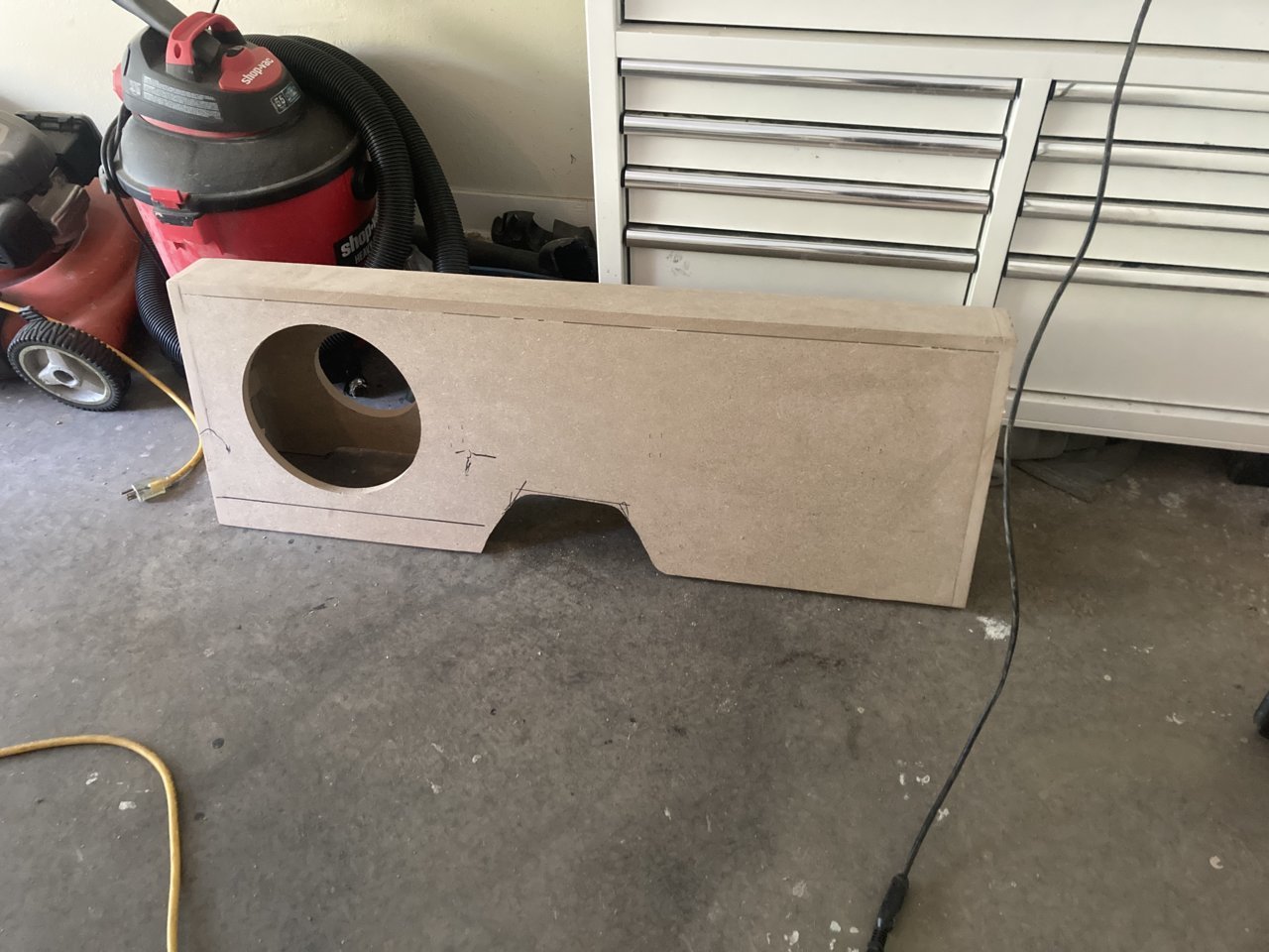

    986EC7E9-23E1-4EDD-BD22-9B170A9EBE07.jpg Working on a single 12 comp r box and a duel focal 12 box. The duel 10 box has .65 cube air space per chamber perfect for the W1 jl’s. The comp r 10’s want .8 cube but sounds pretty good in the .63.
    I got the 12 box up to 1.27 cube and it is louder and sounds better then any of the 10’s I’ve tried. Focal just came out with a .53 cube 12 inch sealed box sub with a top mount depth of 5 3/8 inch. So I’m going to try them next. With the kicker 12 I lost one click on the passenger seat

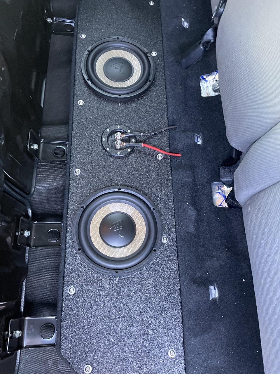

    Added two focal shallow 8’s

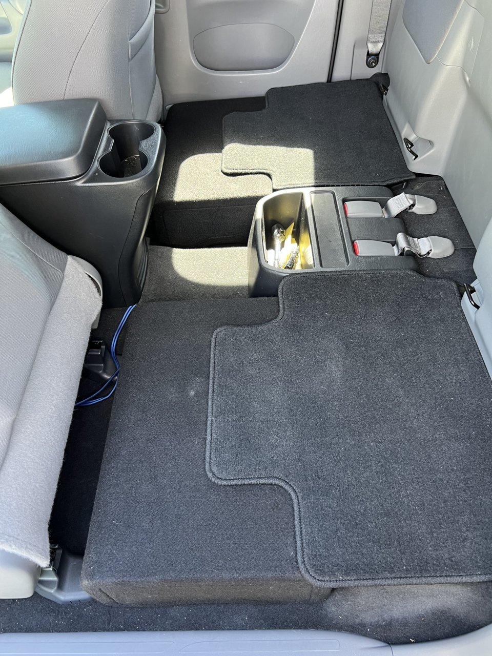

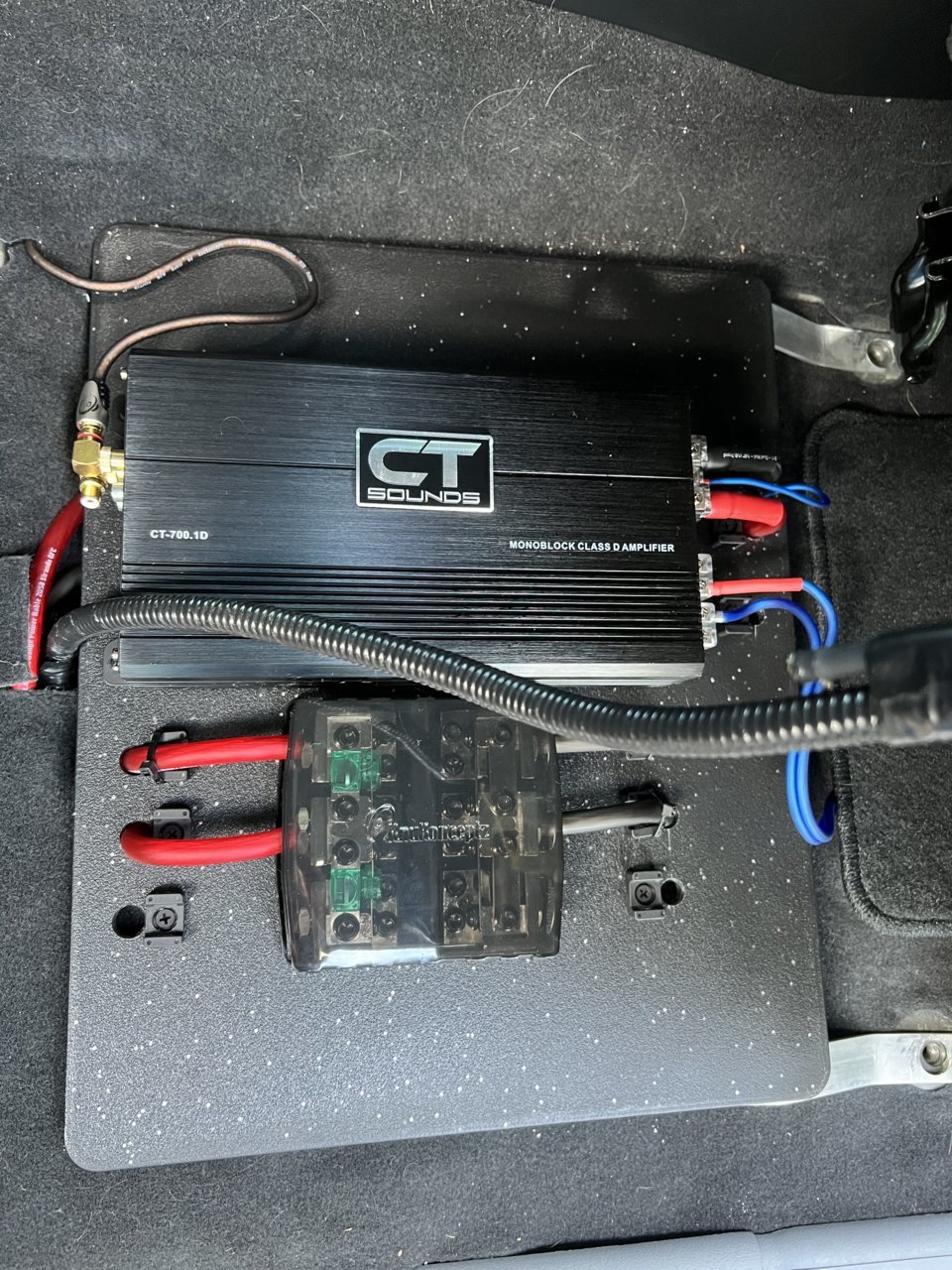

    For 2nd gen access cab owners wanting some stealth subs, the Kicker
    48CVTDF102 10” down-firing loaded enclosures fit perfectly in the rear “seat” footwells. Very impressed with them. Had plans to use these as a temporary solution until a custom enclosure / storage platform was built, but after initial testing there’s no need to do anything else. Will still make a platform some day, these Kickers are the same height as the storage bins so that’ll be easy.
    These two 2-Ohm enclosures are wired to a 700W@1-Ohm CT Sounds monoblock amp, which is likely putting more than 700W. For anybody looking for a quick and easy amp rack, this one is a plastic cutting board from Target, perfect fit with no trimming required.

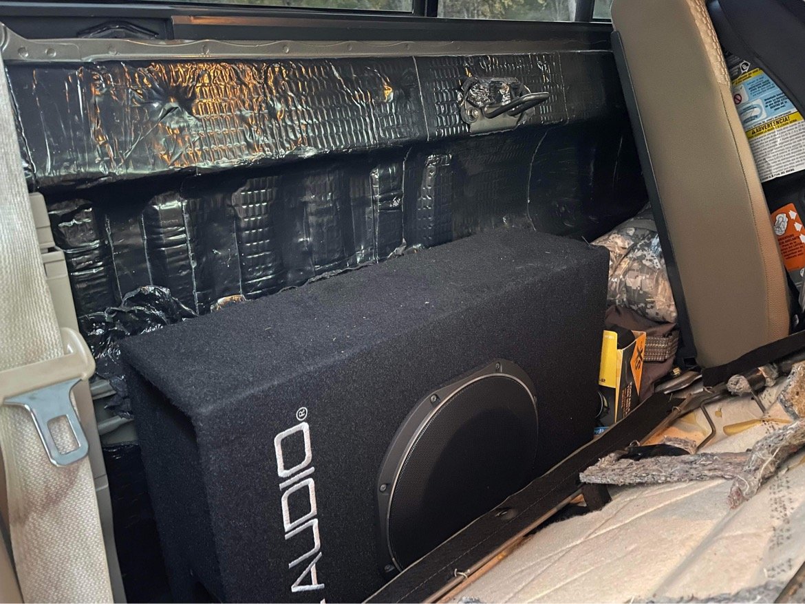

    I had to do a little creative trimming to the seatback support but otherwise it was drop-in-ish LOL.
    Sub: JL Audio 12TW1 microsub ported enclosure
    Amp: Sundown Audio SAE 1000D (under the driver’s seat)

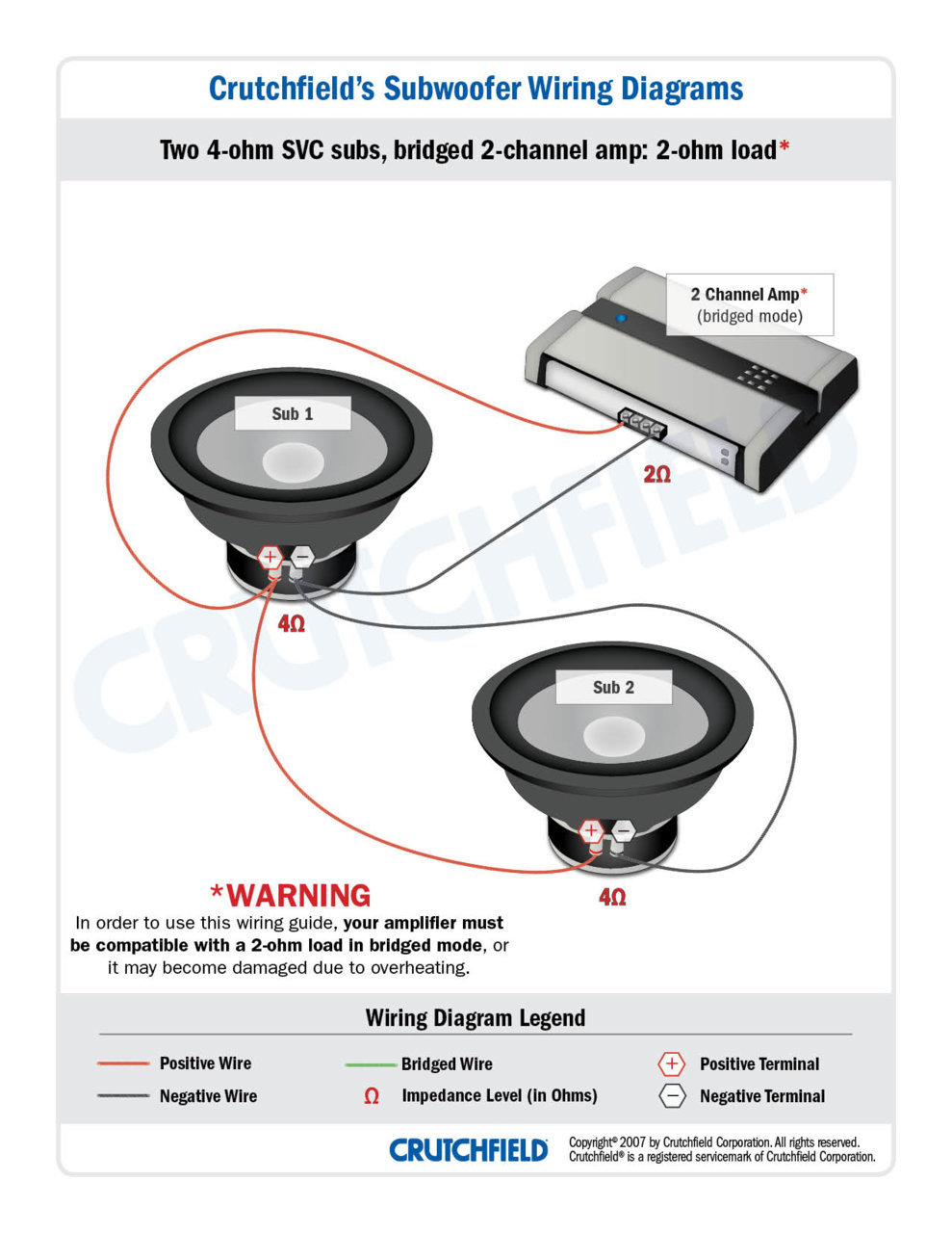

    I went through the same dilemma of wanting a full size sub, but settled on a shallow mount due to space restrictions. I'm running the JL Stealthbox with a Kicker 500.1 and it's very clean with the dsp and plenty for me, but you'll probably want more bass.
    I haven't heard either the JL I linked or the ds18's, but the frequency range specs on both are very similar. Also, those JL's don't need a ton of power (rated 75-300w rms) to slam. If you did 2 of them and bridged them to down to 2 ohm at 500-600rms I think that'd be plenty for a Tacoma. I think 500w each would be too much for those JL's. (My JL Stealthbox is getting 300w rms from the key 500.1)
