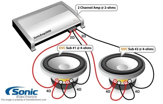

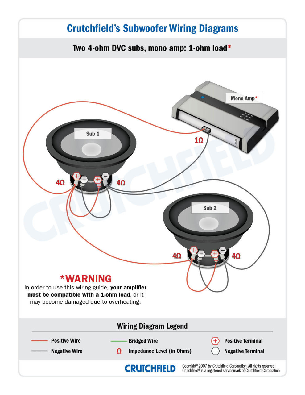

    What's the budget? You could bridge them down to 1 ohm...
    Cheapest I could find...
    For the RF12's:
    https://www.crutchfield.com/p_20646CX81T/Kicker-46CXA800-1T.html?tp=35834 $255 800w @ 1 ohm
    https://www.crutchfield.com/p_575P3S412/Rockford-Fosgate-P3SD4-12.html
    For the Alpines:
    https://www.crutchfield.com/p_20646CX12T/Kicker-46CXA1200-1T.html?tp=35834 $340 1200w @ 1ohm
    https://www.crutchfield.com/p_500SW10D4/Alpine-S-W10D4.html

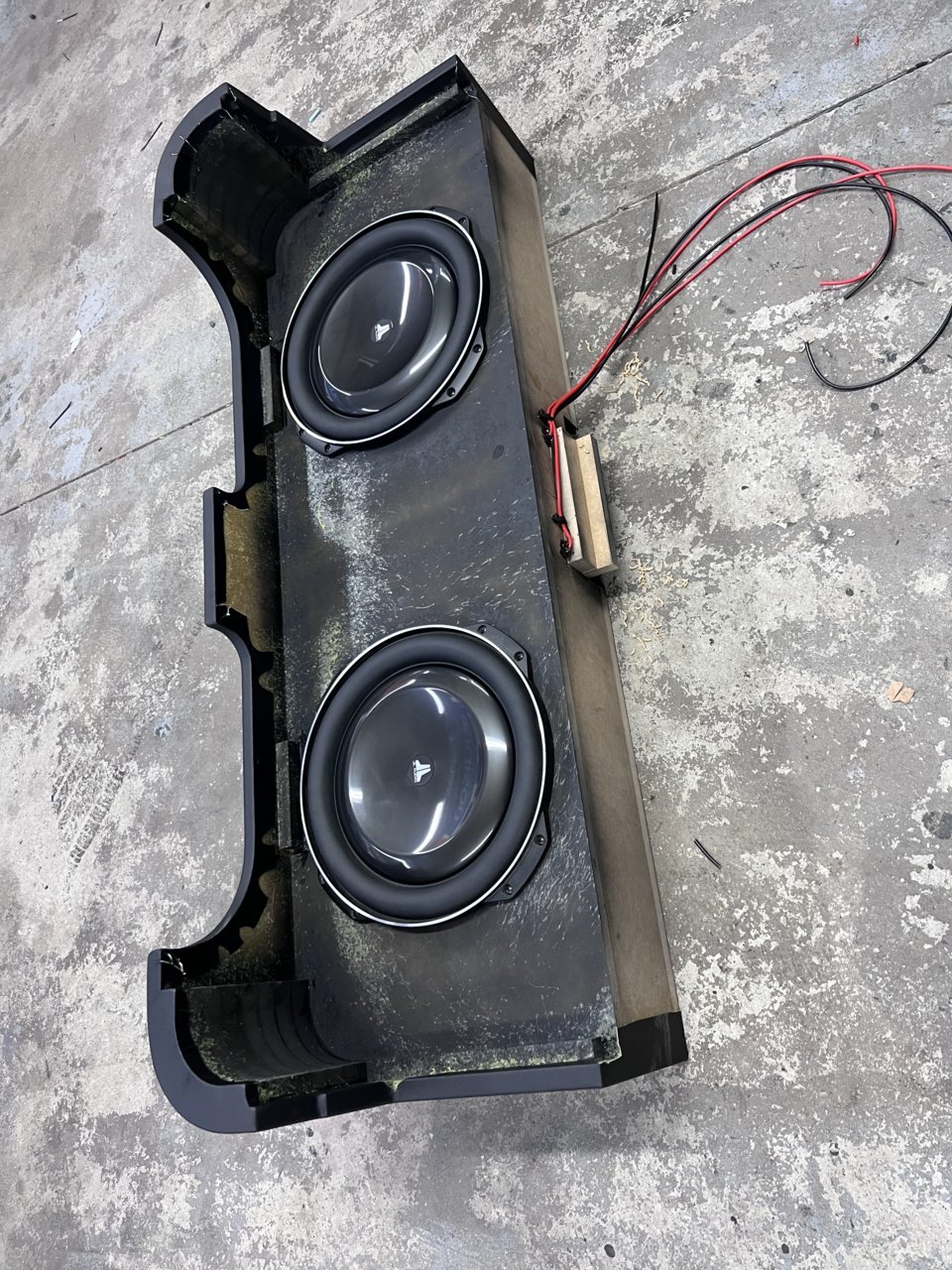

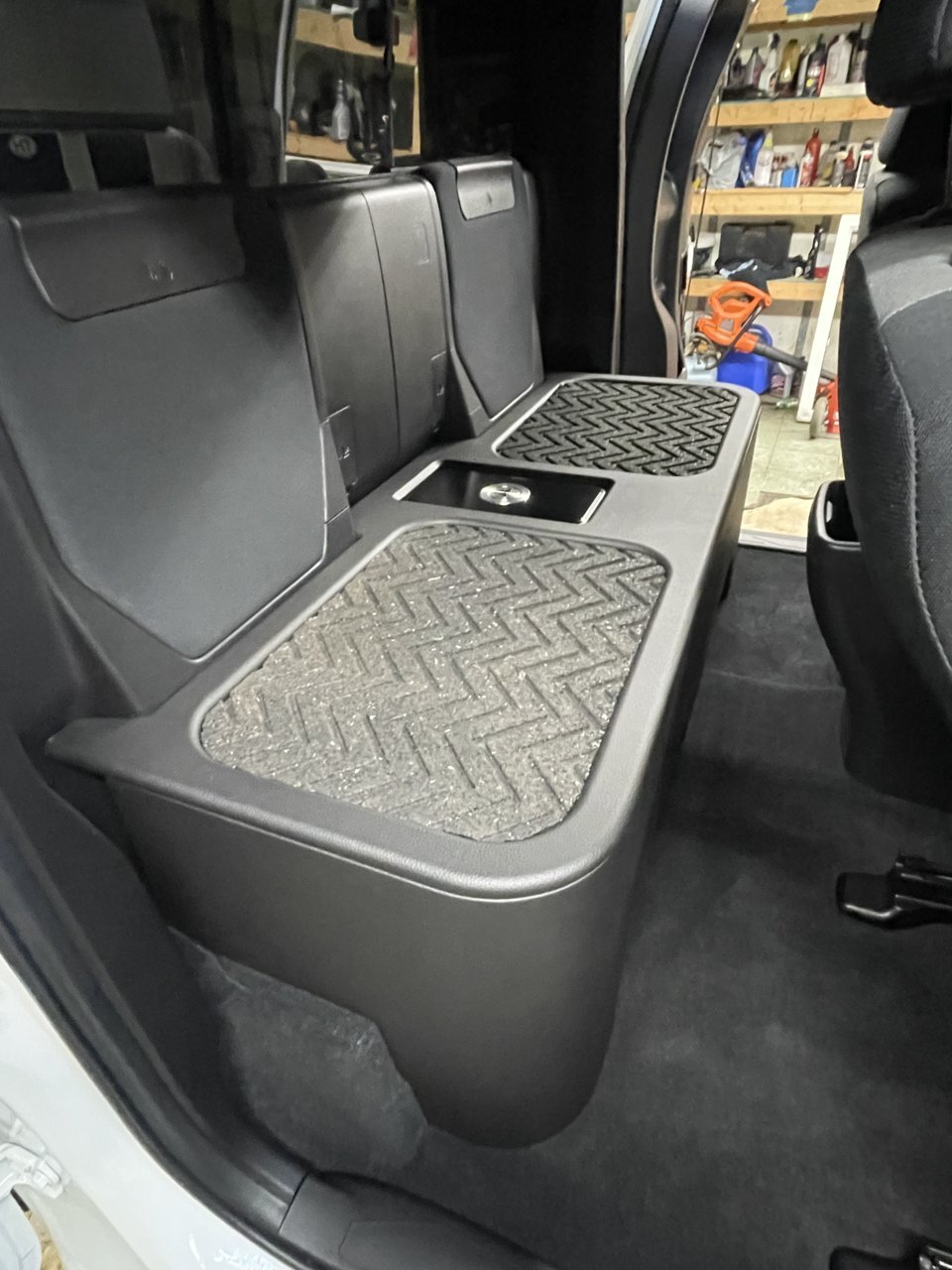

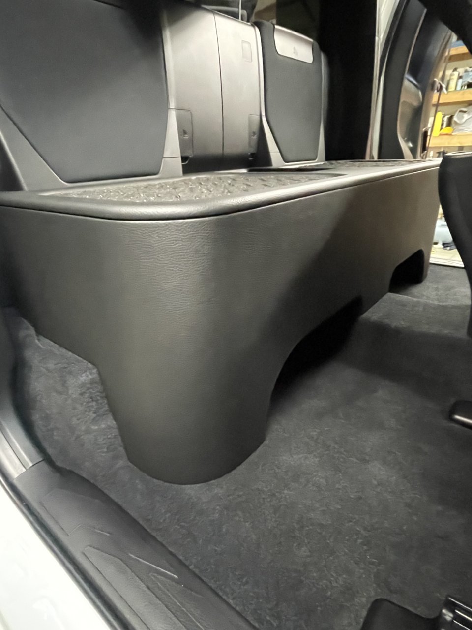

    4EB58A30-9E03-434E-8FB4-B8EC93B8A201.jpg F2F507D1-BA1B-4C32-A930-3B808796435C.jpg 34CB9183-6957-4AE8-8C13-2AB7F8782CED.jpg
    13.5 jl shallow mounts.
    2022 access cab

    Started with one sub behind the rear seat on my 07. Added a 2nd one z year or more later. Move them over to my 2022, so I already had the subs and the amp arc X2 1000watt. That jl runs the front door speakers. I’m a firm believer in do it right the first time and only pay for it once

    May I ask who made the box and how much? This is exactly what I have been looking for. Your set up looks great !!!

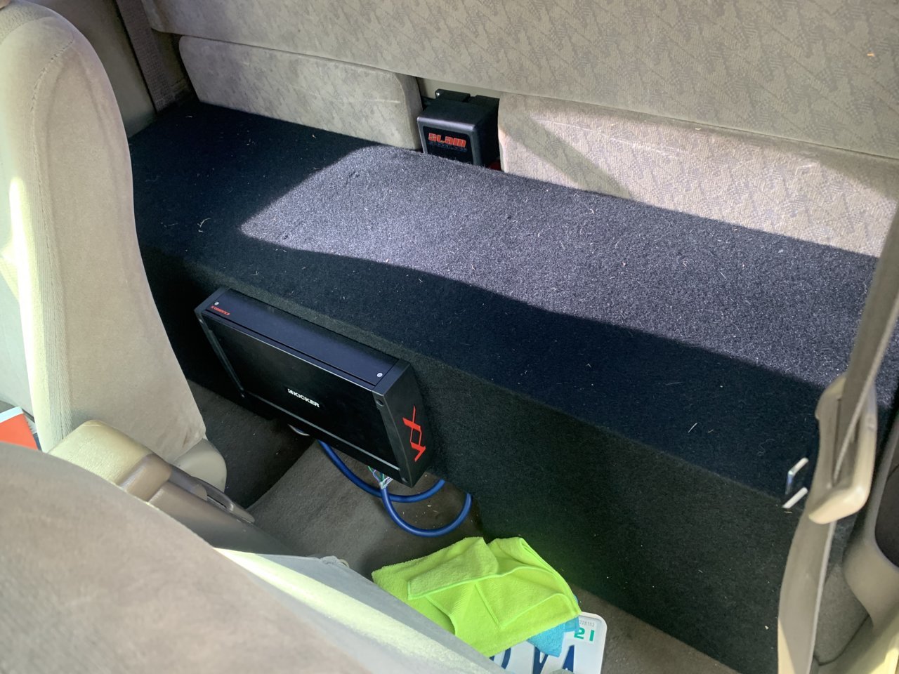

    Pre built box but it works well in my truck with the Comp Q. Maybe someday when I’m not lazy I’ll build a custom box lol!

    This is legit, did you build?

    That is super clean.....ive got a JL W7-3....8in sub....love that thing trying to find a way to put it into my new 2022 access cab taco .....i would love a set of those shallow mount JL's......im wondering if i could possibly pull something like that off with my W7.....im pretty handy with woodworking tools ....had it in my reg cab 2006 Taco....it really rocked the cab along with my 250/1 JL amp.....
    Did you have to uninstall the storage compartments in the floor or does that bench straddles over them???
