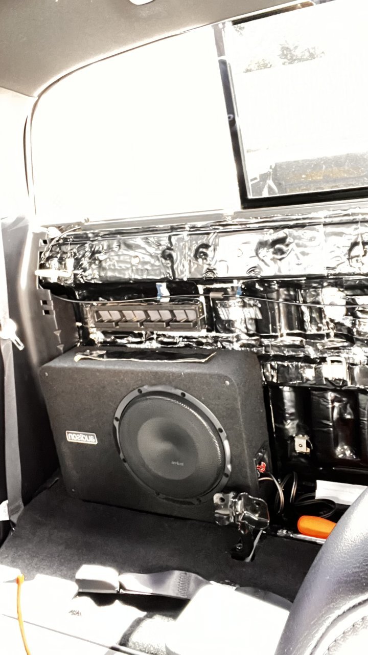

    no trimming needed and the subwoofer stays at the location when turning. I installed the small amp under the driver seat. I have factory head unit.

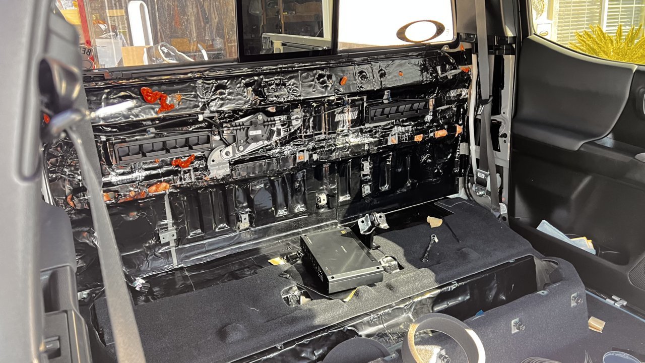

    Weekend project completed!!!! very satisfied with the clean loud sound despite no DSP processor; the cleanliness of the 5 channel Kenwood in conjunction with hertz components,hertz coaxials and 10 inch Audison sub. I tried the 10 inch TW1JL Audio from my other truck but the Audison was a better fit and like the tight bass sound from it. The plus it’s that I was able to keep trimming of the left panel very minimum although the right panel did not fit I didn’t wanted to destroy it so I’ll be customizing/improvising a different cover.
    Other than that I’m impressed with the clean sound and no rattles whatsoever after installing the deadening material. This task was probably the most time consuming but well worth it. It also reduced a great amount of road noise

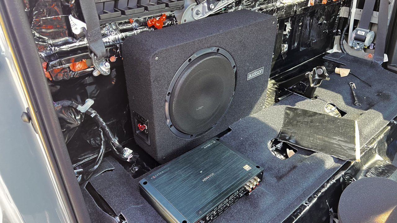

    Here are the components, hopefully I don’t miss something but let me know if you have questions I can get more detailed pictures.
    PAC Amp Pro (under Factory Radio) straight plug and play
    Hertz Mille Pro 165 2 way components (front stage)modified the triangle plates on top of the front door to fit the tweeters.
    This will be a project in its own to re-mount with fiber glass just to correct staging
    Hertz Mille coaxiales (Rear)
    Audison 10 inch sub driver side rear deck

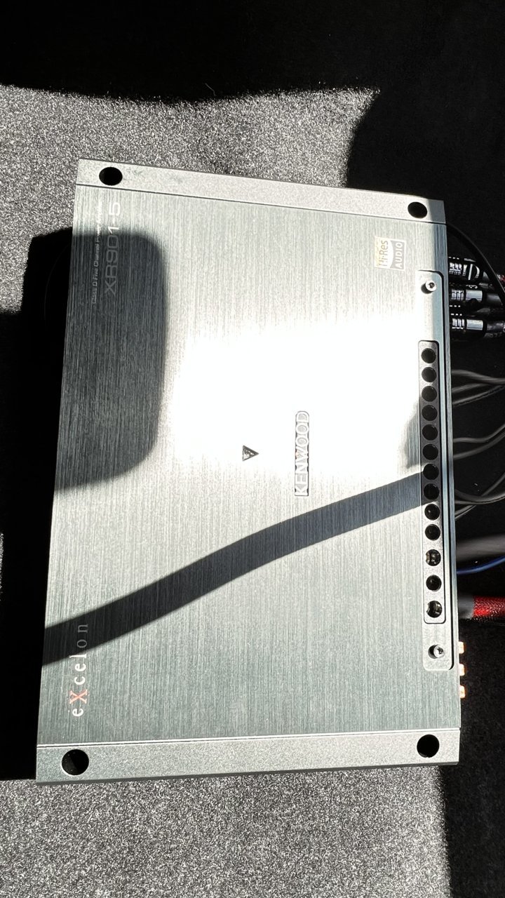

    5 Chanel Kenwood Excelon Reference (under passenger seat)

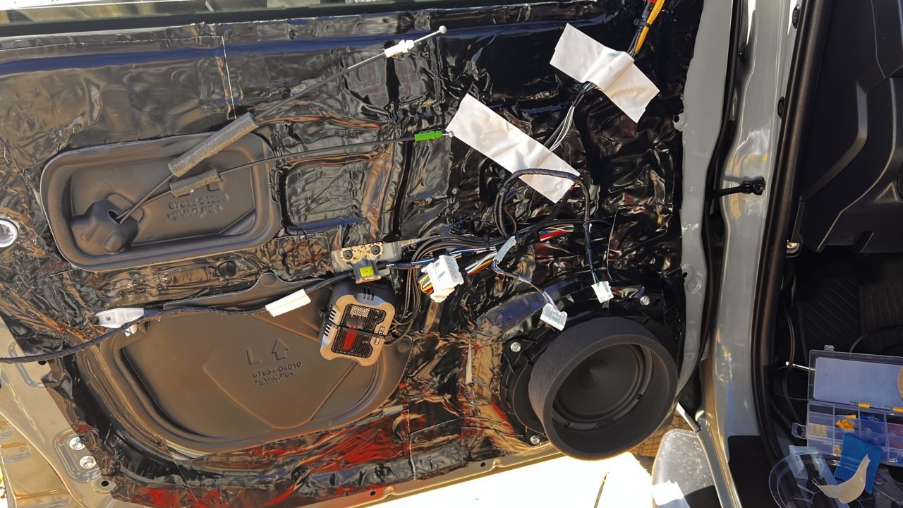

    Metra deadening materials 4 doors, rear deck ( didn’t do the ceiling nor the whole floor due to time limitation)
    New wiring by Metra 16 gauge for all speakers and 12 gauge for sub. amp install kit 4 gauge, Metra RCAs
    Maintained the original sub for lack of not knowing what to do for now and the front dashboard 2 inch mid range speakers. Planning to replace with the 2.5 inch Audison Prima and run them with the factory amp
