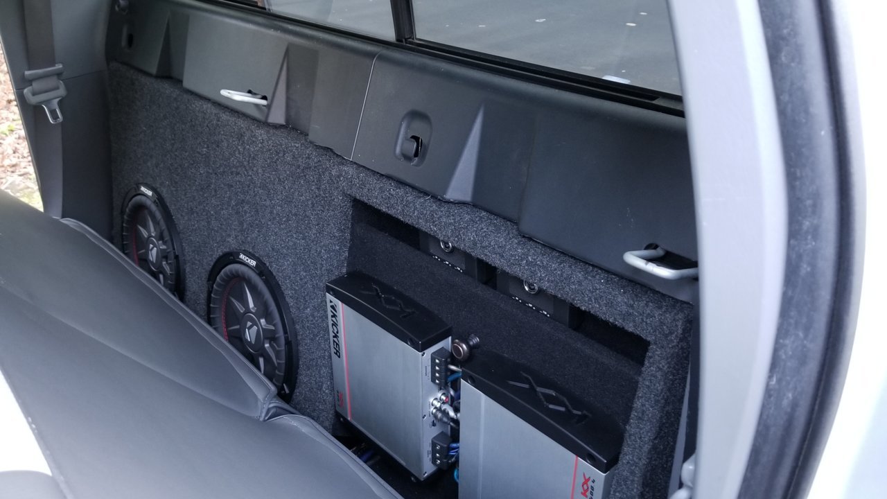

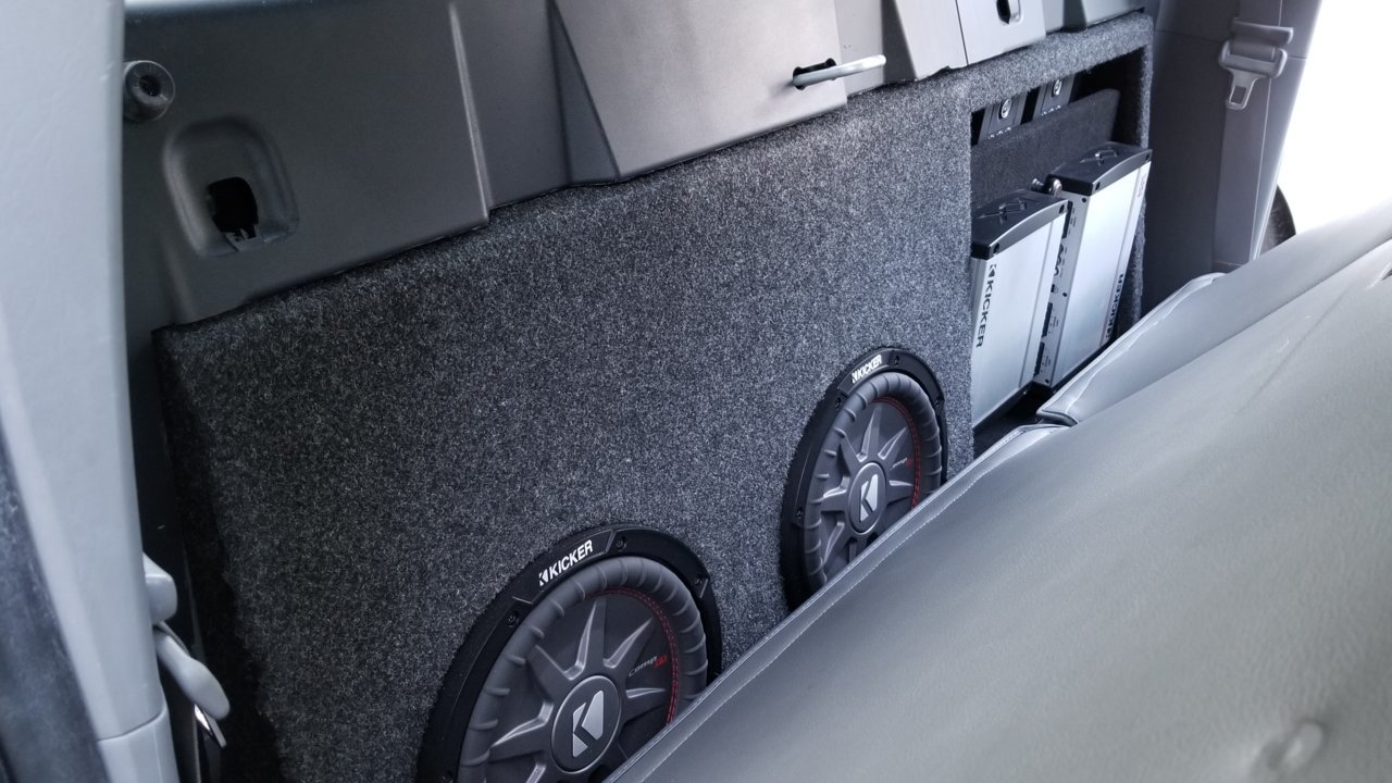

    DIY box with a pair of 10" Kicker dual voice coil subs wired in series/parallel for a 2 ohm load on a Kicker 800 watt amp. She wont win any competitions but will damn sure rattle the windows when necessary.20190807_192311.jpg

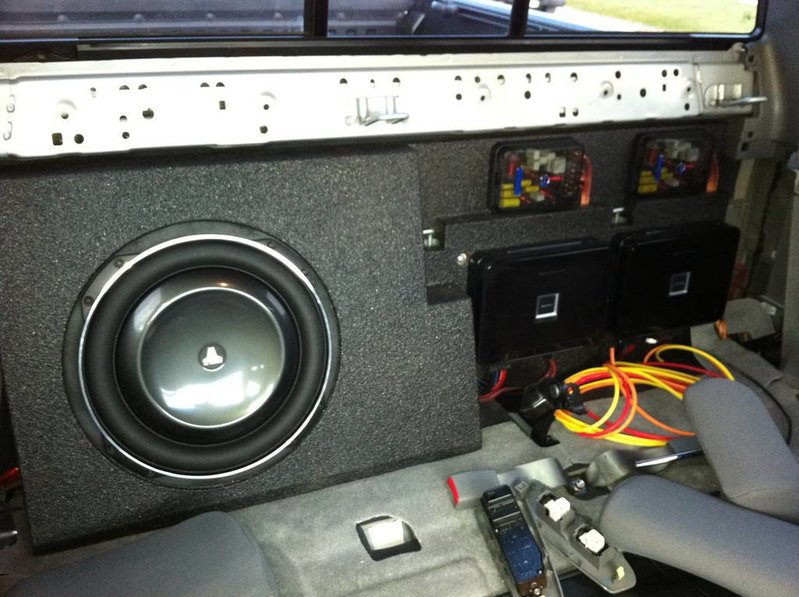

    Midway through install but it works well. Shallow mount JL 10TW1-4 fed by 500W off an HD 900/5. Mr Marv made the sealed enclosure to the sub's specs.

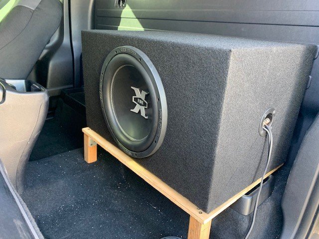

    Not the most practical, but it slaps :headbang:sub.jpg

    It must get down, how much watts you pushing?

    The sub is rated at 500 watts rms w/1500 watts max. It's hooked up to a X-FIRE AUDIO 600 watt amp.

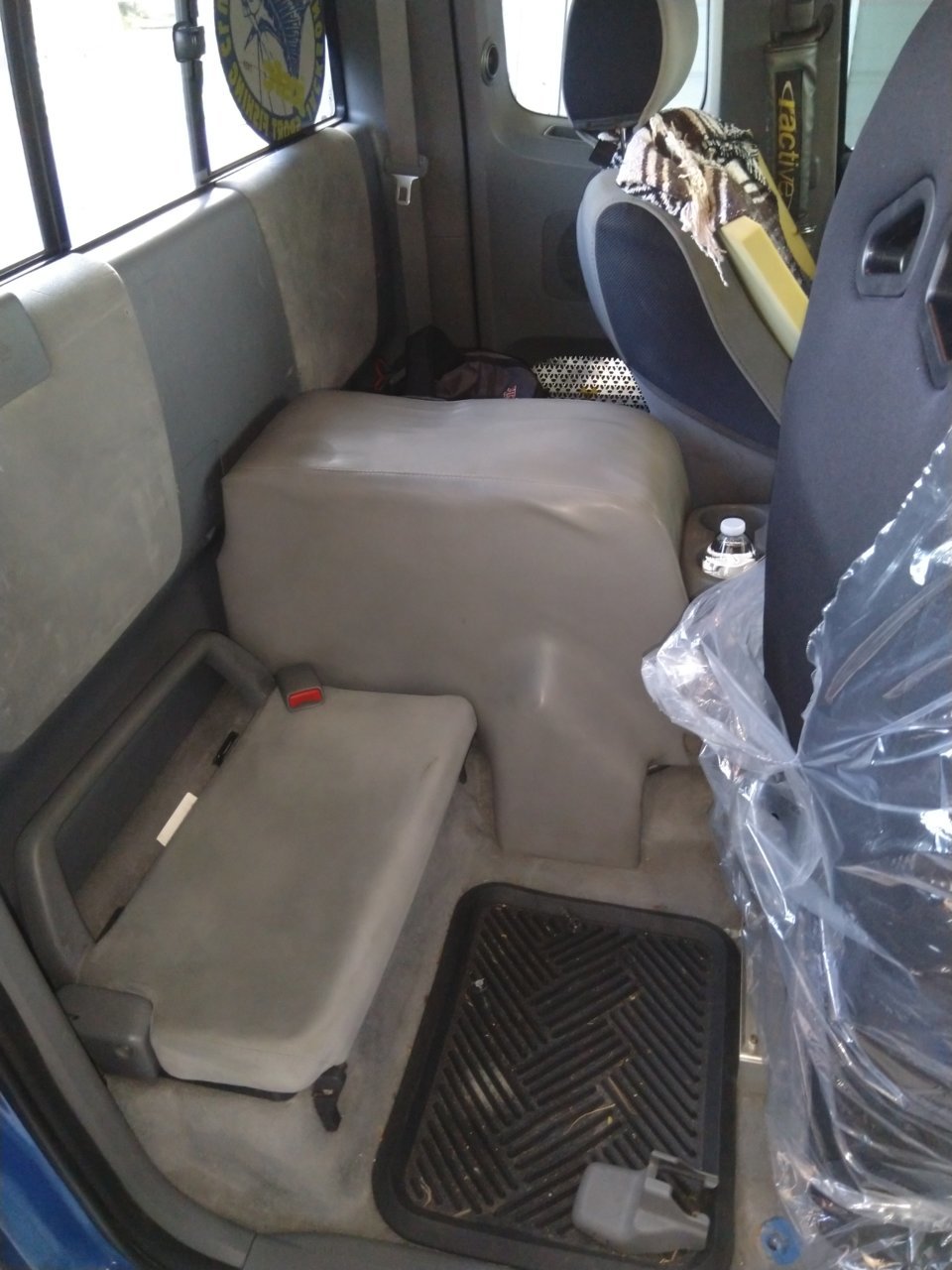

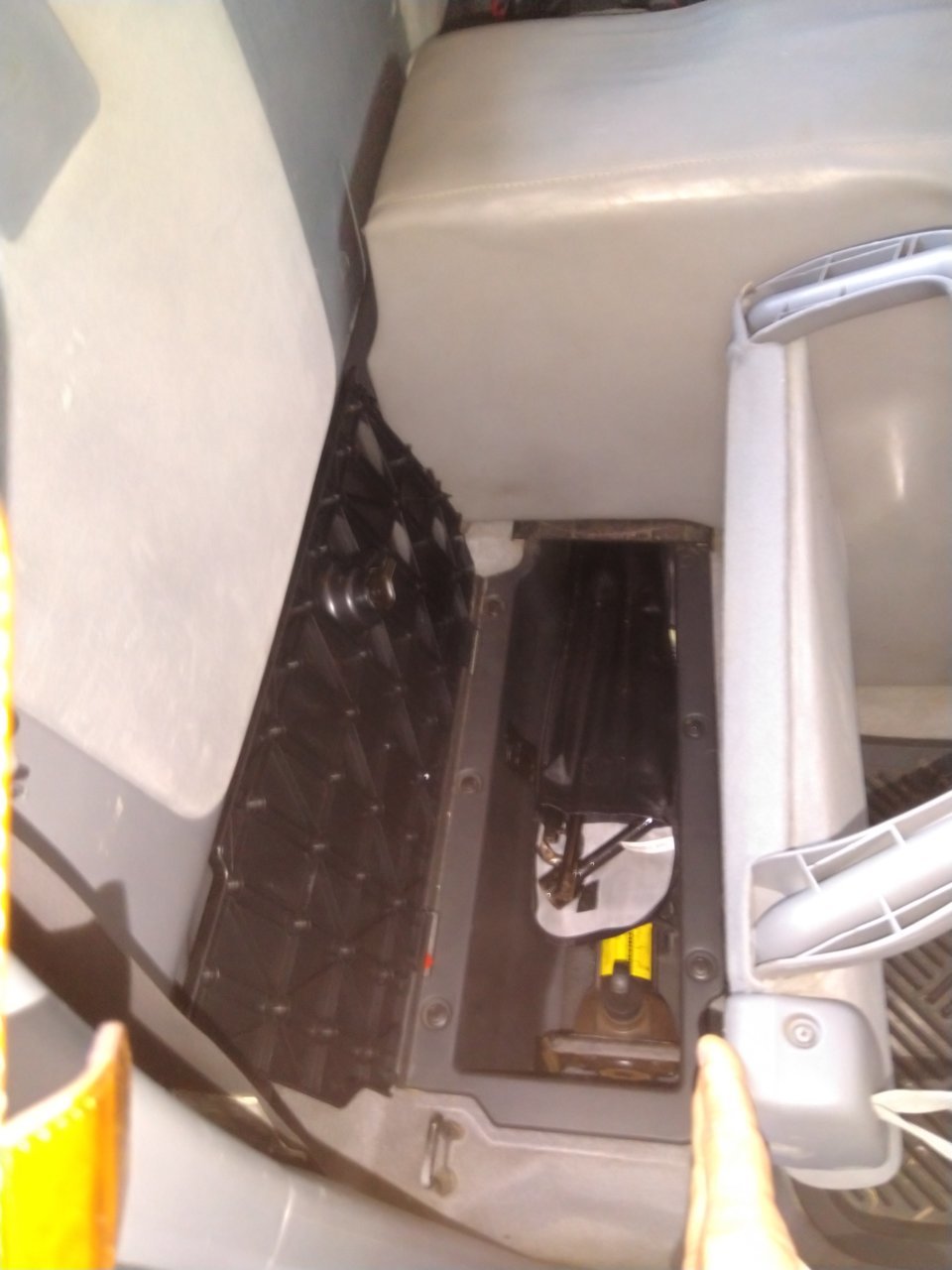

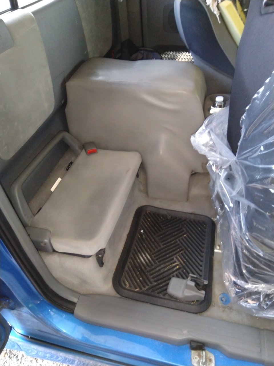

    12 inch kicker sub rear seats modified to still open with the box. 19 speakers throughout the x-runner. Factory seats recline fully I'm not sure the new racing seats will with the side flare.

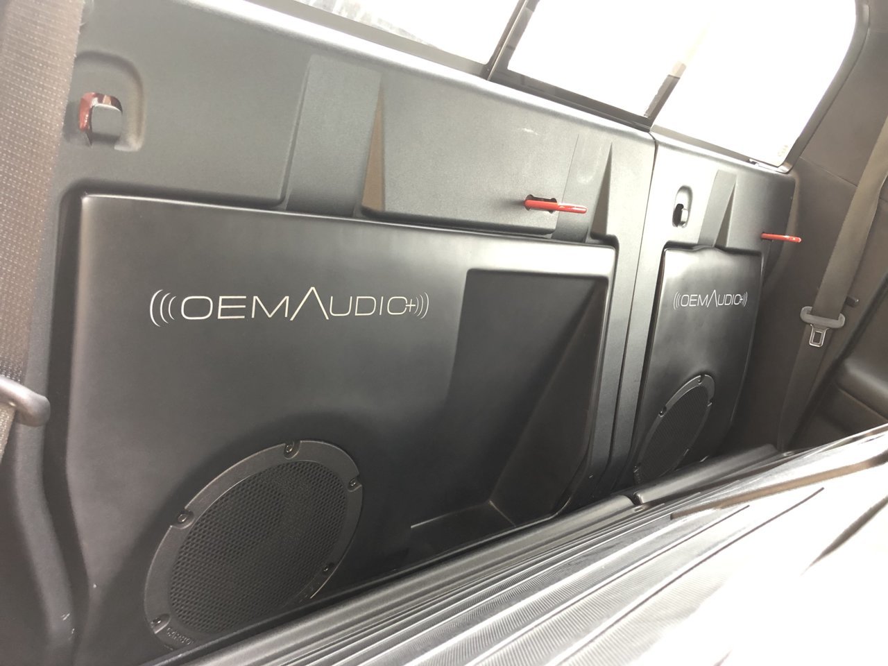

    Dual OEM Audio + with dual amps

    nice but i think OEM Audio is way overpriced.

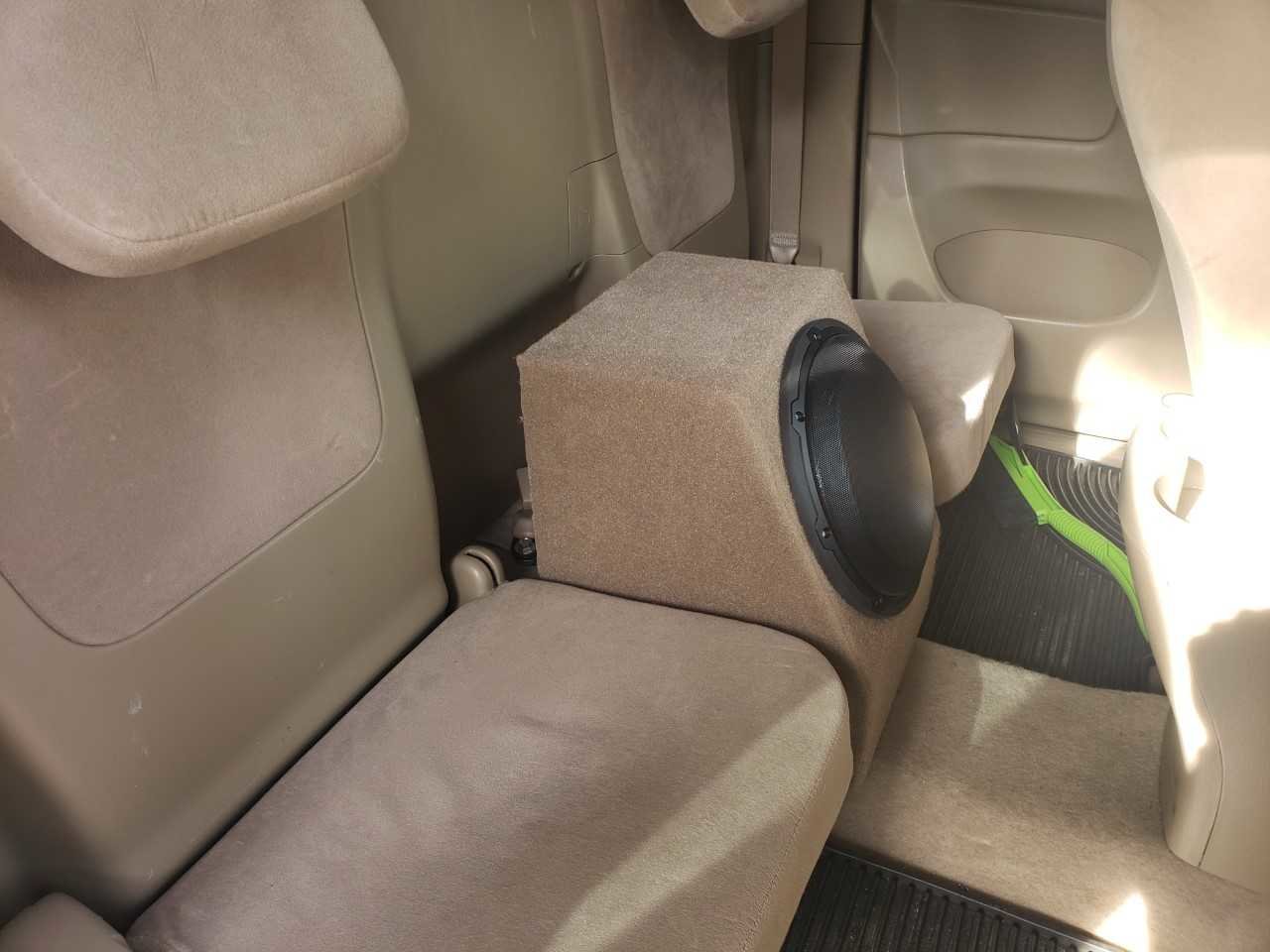

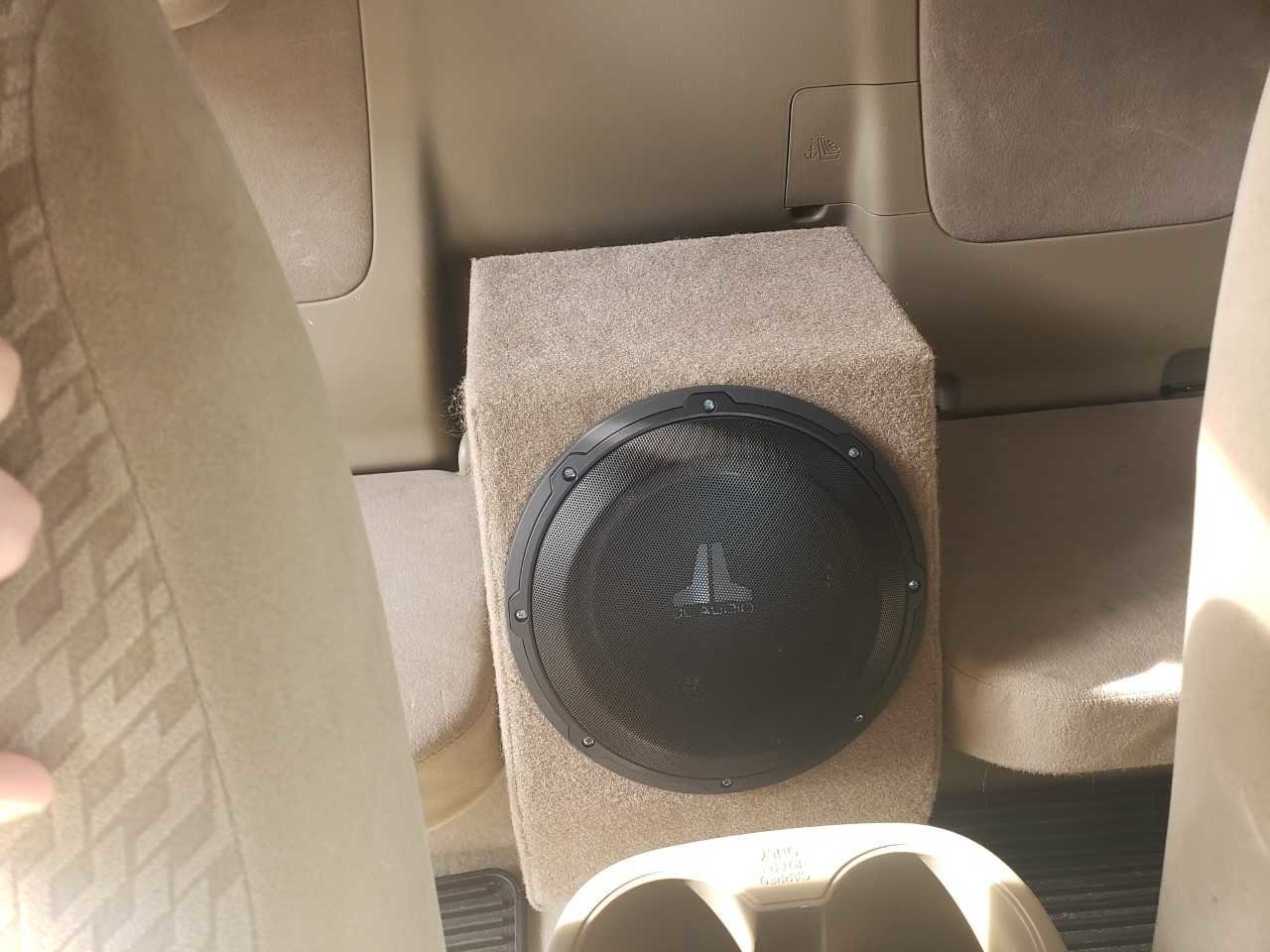

    Nice sub. I like the whole theme you got going on. How does it sound? Is that box big enough for the subs specs?

    Thanks. Sounds really good. i'm happy with it. I took a risk ordering the tan carpet from ebay cuz none of my local audio shops stock tan carpet. Its slightly darker than my trucks interior but barely

    Looks fine. Is that a custom built box?

    It is, yeah. It was made for me by @Mr Marv. Its made of birch and takes the place of the rear center console thing. Bolts up to the stock mounting points
    Edit: To answer your question earlier, yeah the box was made custom according to JL's recommended enclosure specs for that sub. It's a JL 10W1V3- 2 ohm. It's designed to be used in a pretty small box
