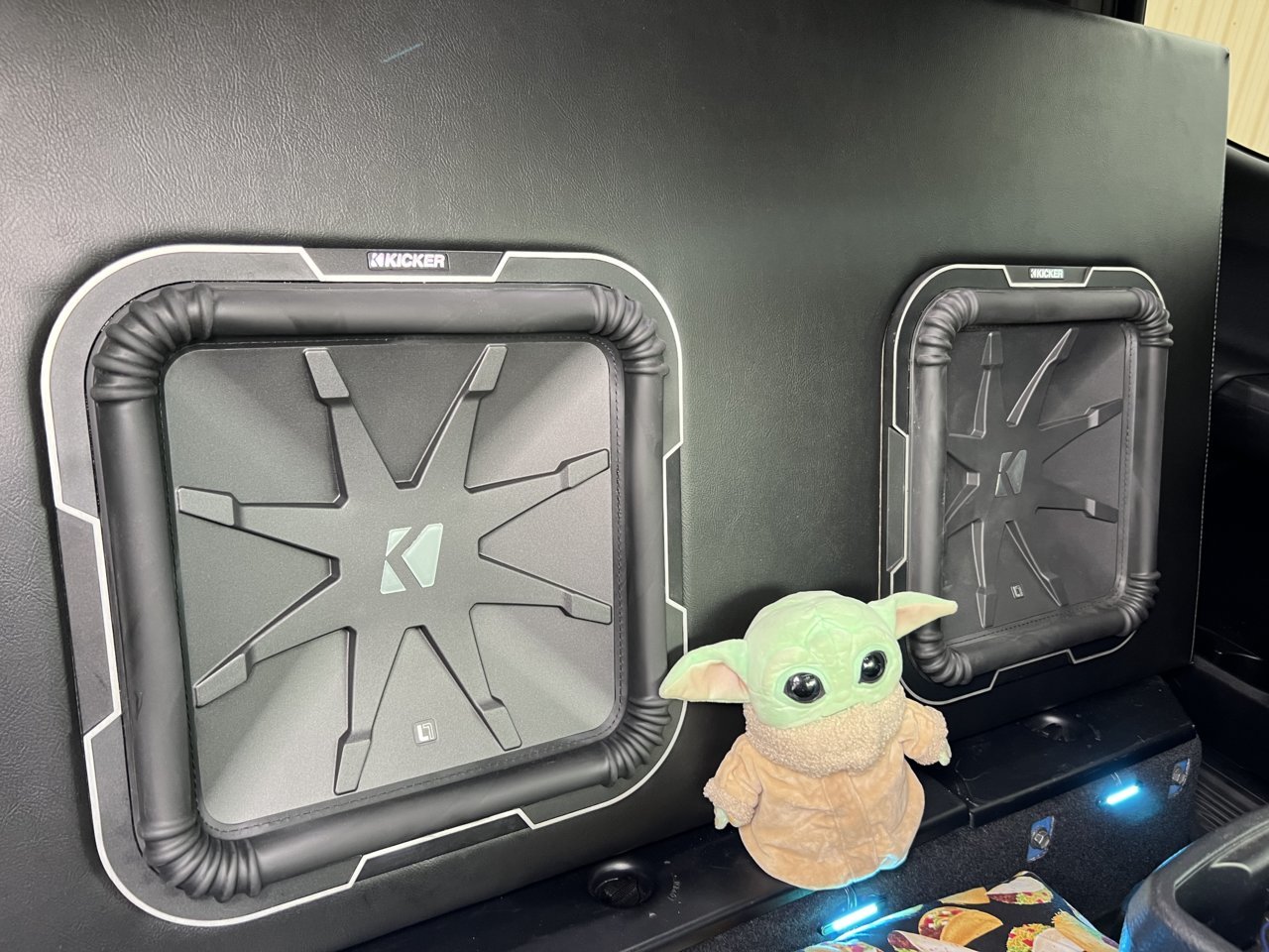

    i am hard

    Wiring skills A++++

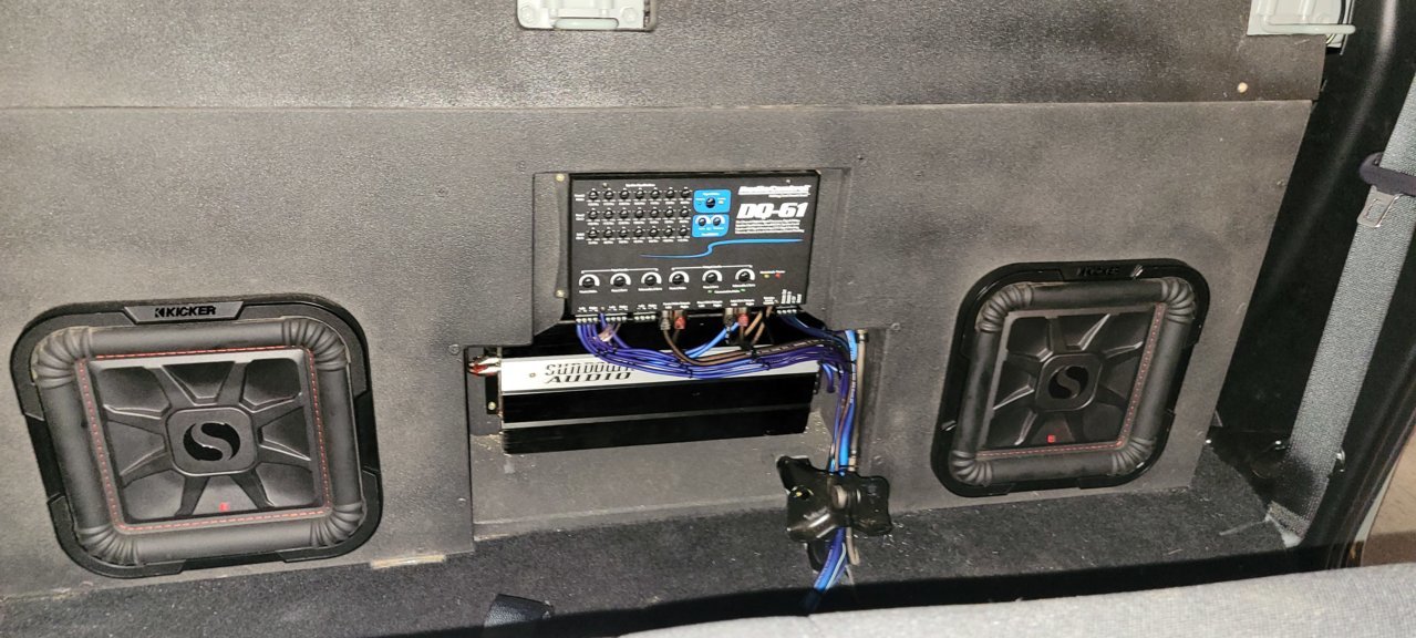

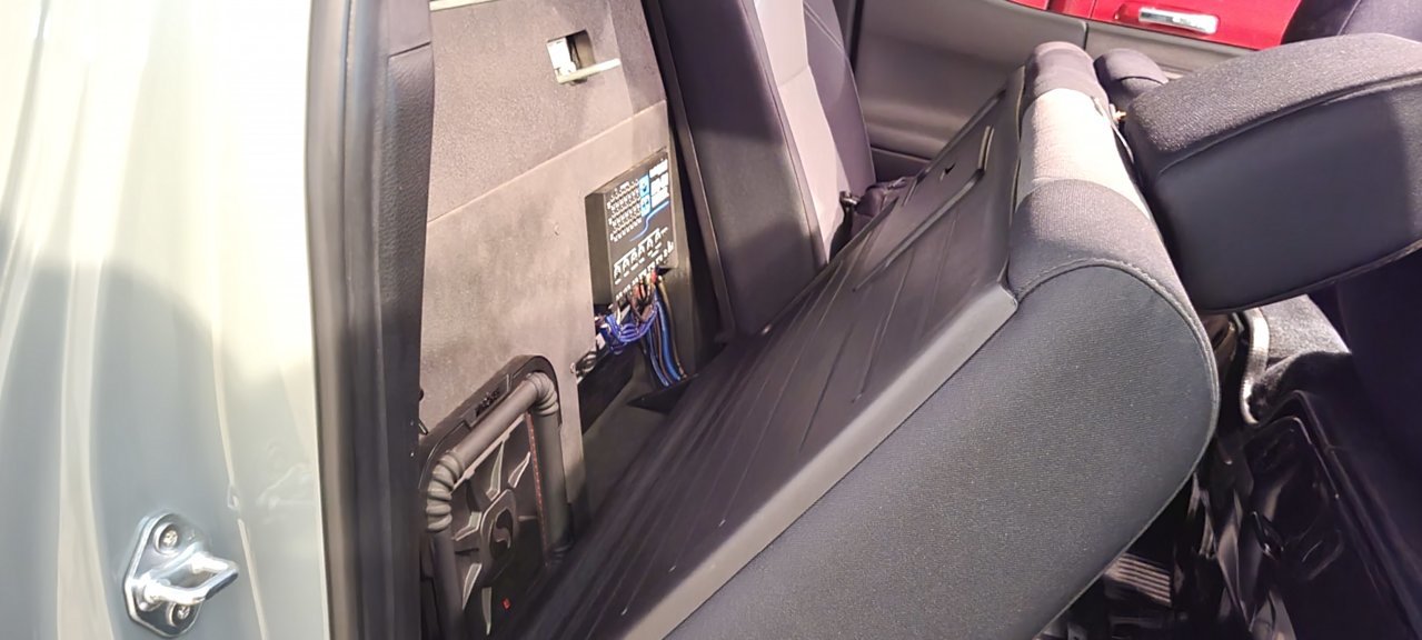

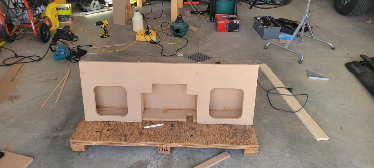

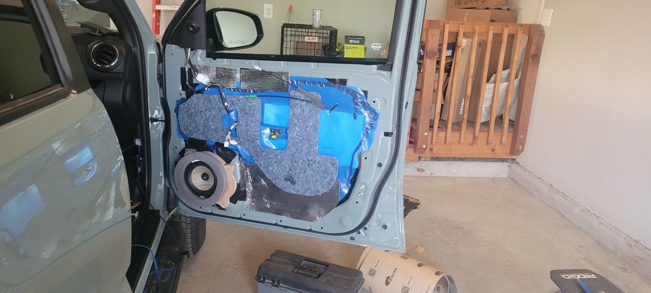

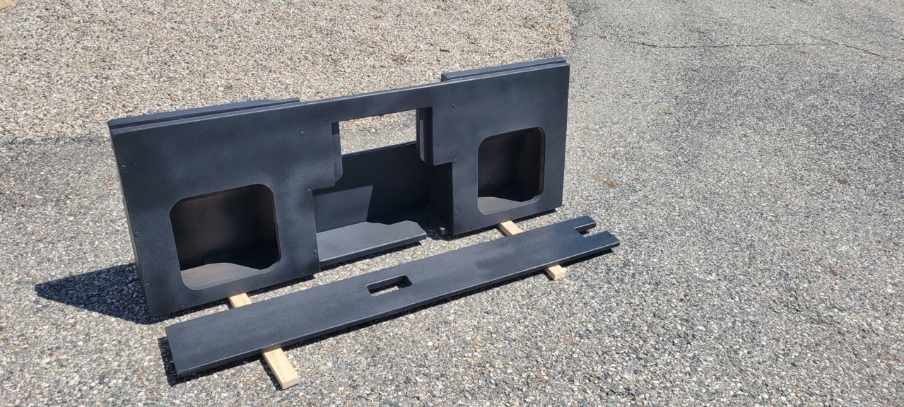

    Build on 2023 TRD OR keeping the stock headunit. Went with dual sealed Kicker L7t's powered by a Sundown SAE 1000D in a custom box behind rear seat. For speakers, installed component Focal Flax FXE biamp 6.5's in basic custom mdf adapters. Relocated the tweeters to the sail panels. These are powered by the JL JD400 amplifier and using all 4 channels in 2 channel input mode for the biamp crossovers. Left rear speakers empty. Using the audiocontrol DQ-61 to control the signal and delay. Overall I like this product a lot for the application, but in the long run a DM-608 would likely have been better. The focal flax with the included crossovers and the basic audiocontrol time alignment and eq settings work very well together for a reasonable price and easily works with stock headunit.
    The bed liner finish worked well and is durable and not too scratchy with a not too glossy finish. I used Duplicolor brand after not liking one coat of rustoleum.
    used about 60sqft of butyl and 30sqft of closed cell foam to do doors, part of floors, rear wall, and several other interior panels.

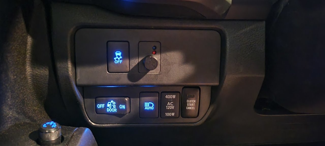

    Mounted the audiocontrol knob flush on a factory switch with some minor modification.

    Very clean install, nice job! I'd like to upgrade to the focal flax 3 ways and put the mid in the dash and tweeter in the same spot on the door.
    Lunaryota[QUOTED] likes this.

    Thanks for the feedback! That is definitely a good idea, likely down the road will go 3 way active with the F3E and a different DSP and amp, maybe the dm-608 or Focal. Considered 3 way a long time going into this build, but overall saved about 1000 on gear for a similar 3 way active setup, and easy enough to upgrade. Mostly for this reason, decided to keep it simple with the 2-way bi-amp and see how much is left to be desired for sound stage.

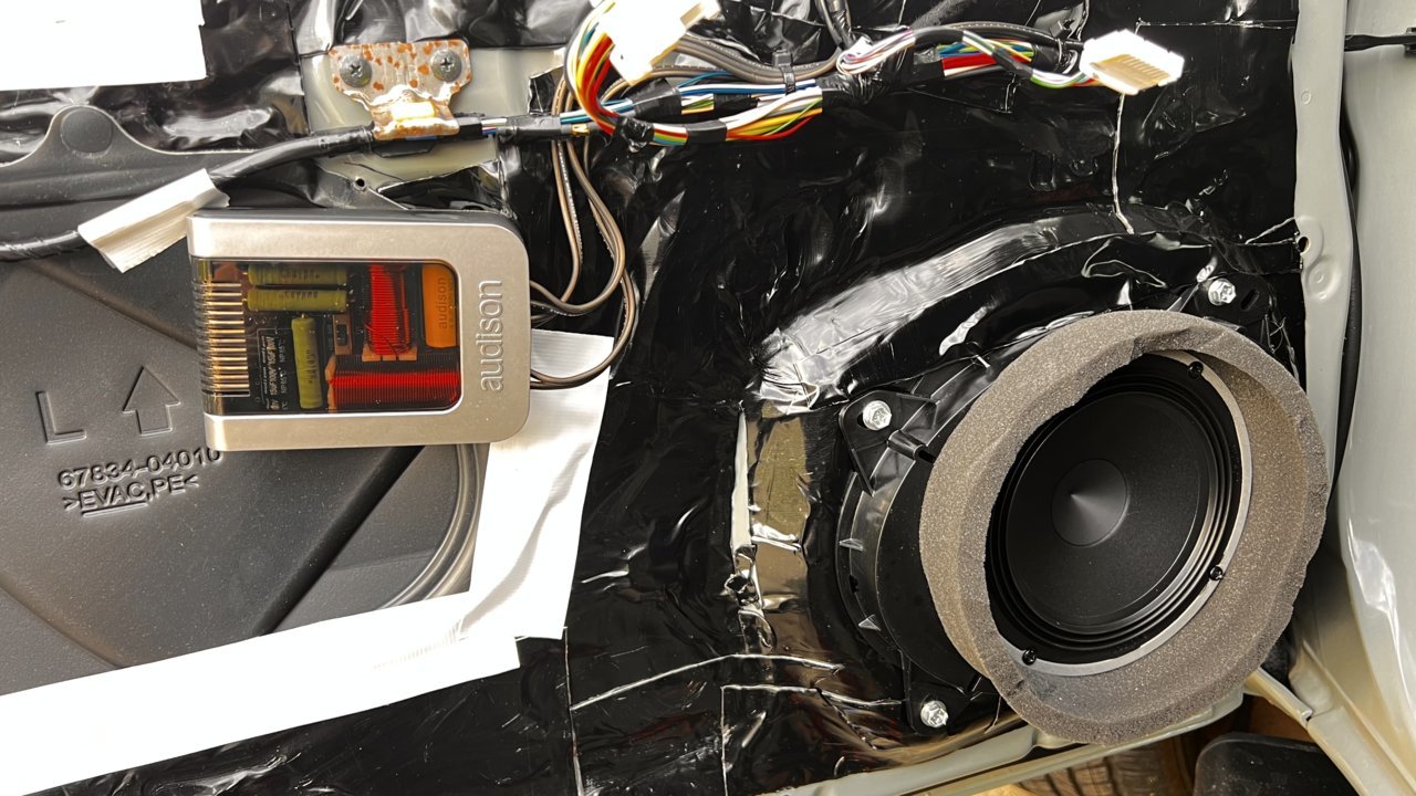

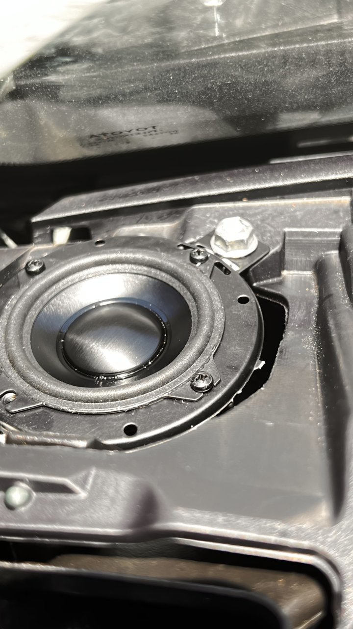

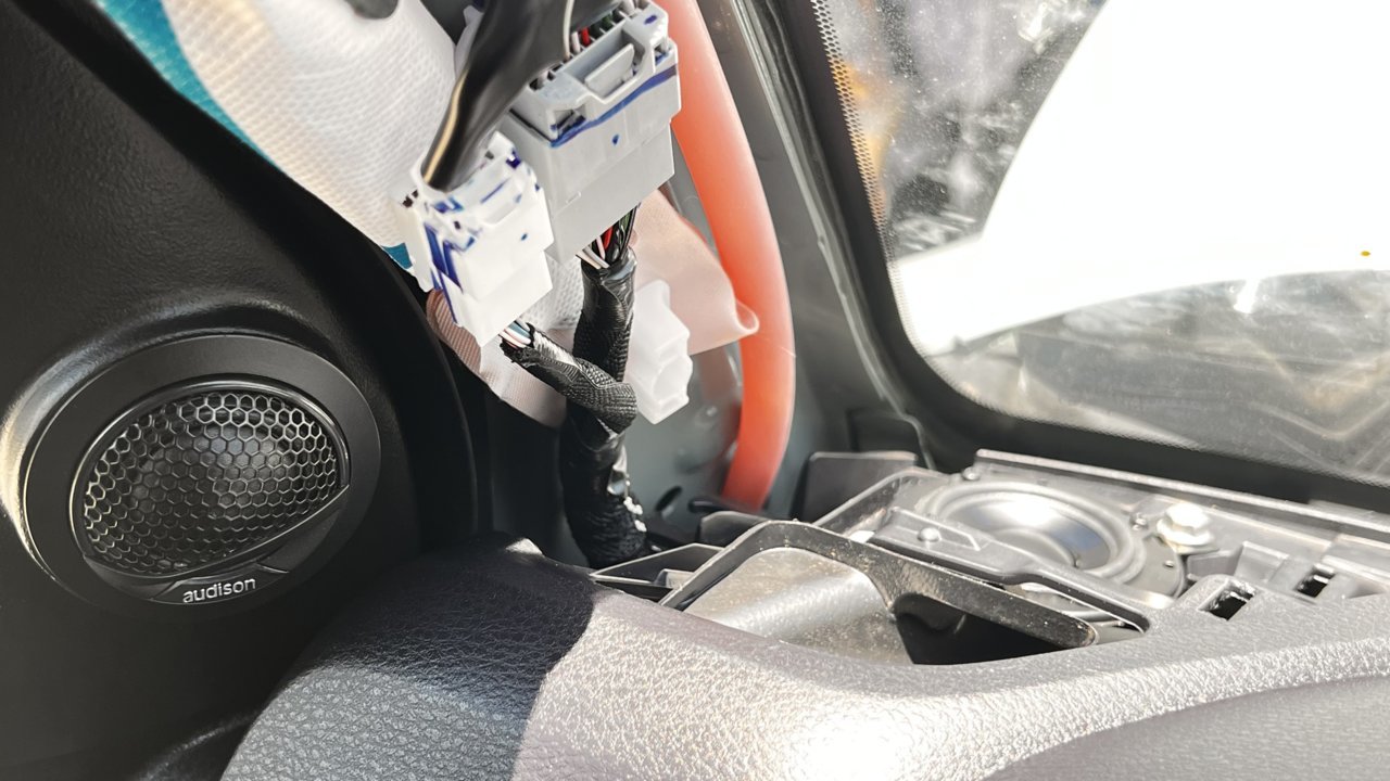

    That look like a great set up I’m actually heading out to install the Audison AVK 6.5 components with custom alate tweeter pods that I made myself and Audison Prima 2inch speakers in the dashboard locations

    Where did you point these at? Opposite headrest?

    Opposite headrest indeed, I find it I bit more interesting/tasteful listening to high notes away rather than closer up my ear.
    In fact I just finished adding the audison 2 inch speakers on the dashboard altogether they sound more cohesive
