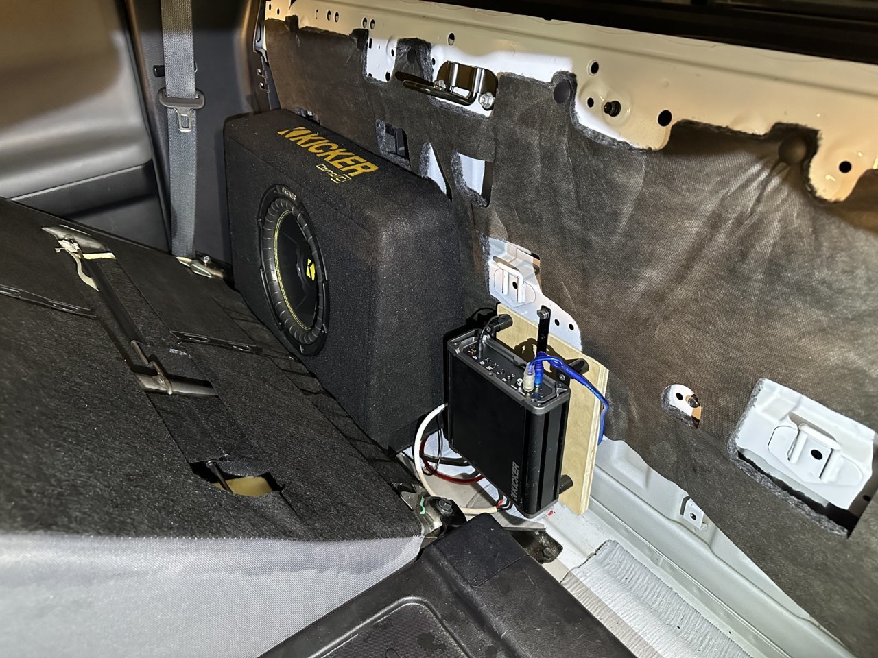

    I just installed the Kicker CompC ported 10 (the 2 ohm model, 44TCWC102) and the Kicker CXA400.1T amp. It sounds really good so far; I'm surprised how loud it gets and how hard it hits to be such a small box. It fits with the plastic bin removed and the plastic seat back panel removed, although I think it'll still fit with the seat back panel installed.
    Edit: both the plastic storage cubby and the seat back plastic panel must be removed for the seat to close.

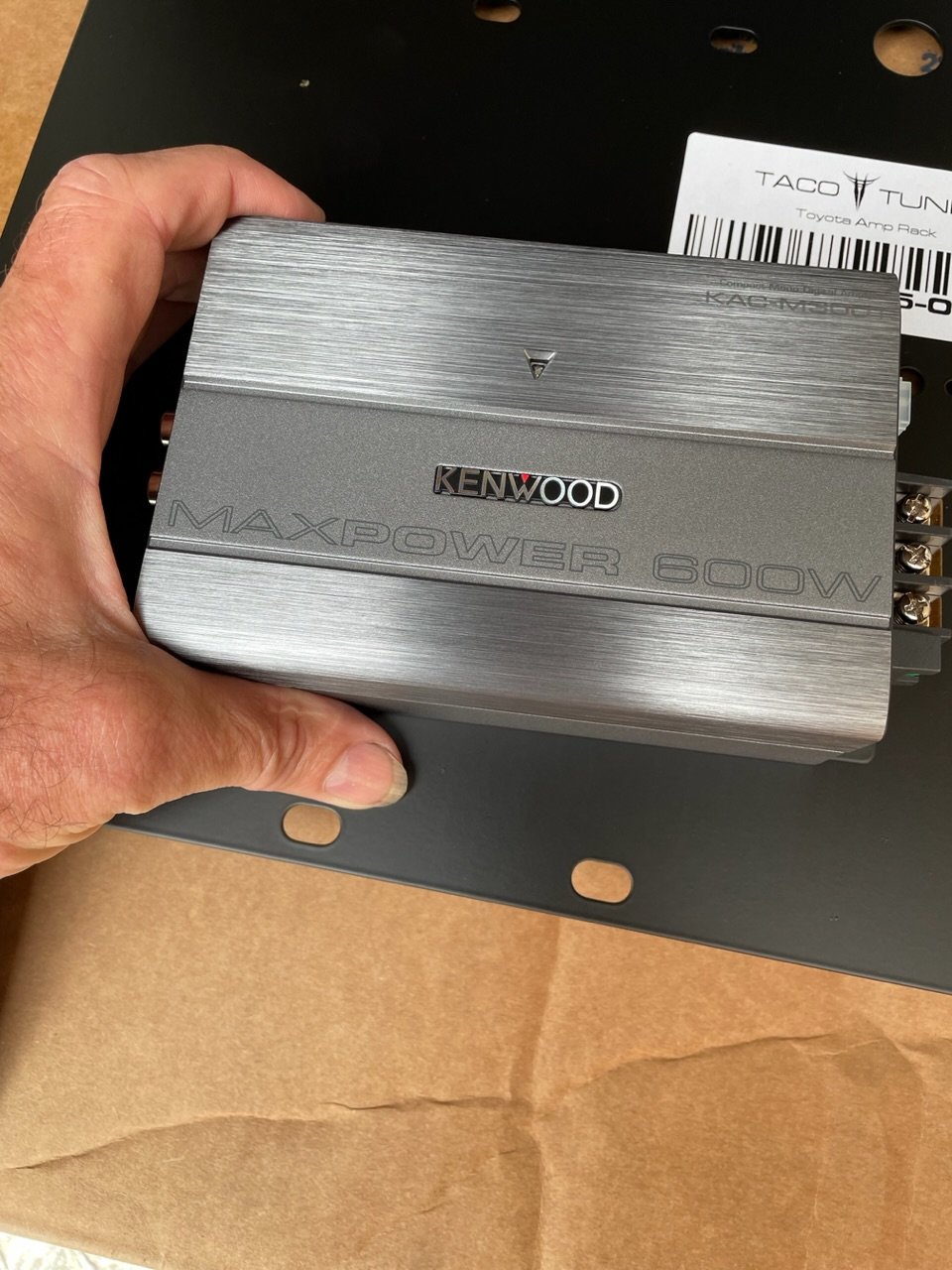

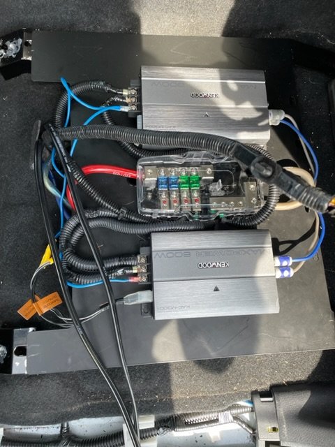

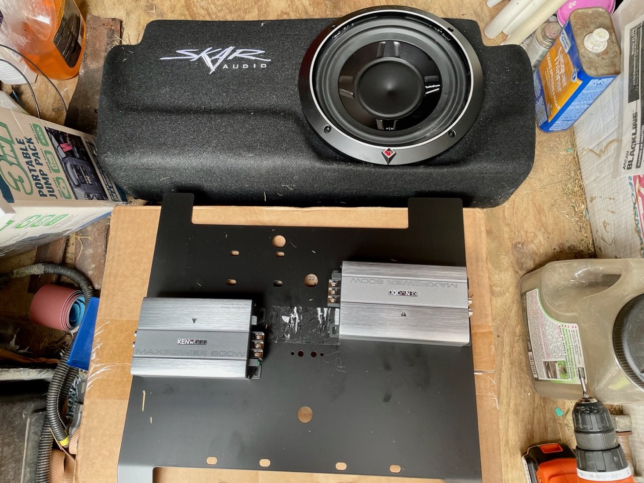

    This is what I’m doing for a subwoofer set up , skar audio box with 10 “ shallow mount Rockford . And this Kenwood 300 to push it. IMG_0354.jpgIMG_0357.jpg

    Thank you for posting this. This is why I watch this thread. No bs simple install. Thanks for posting I will probably copy this set up.

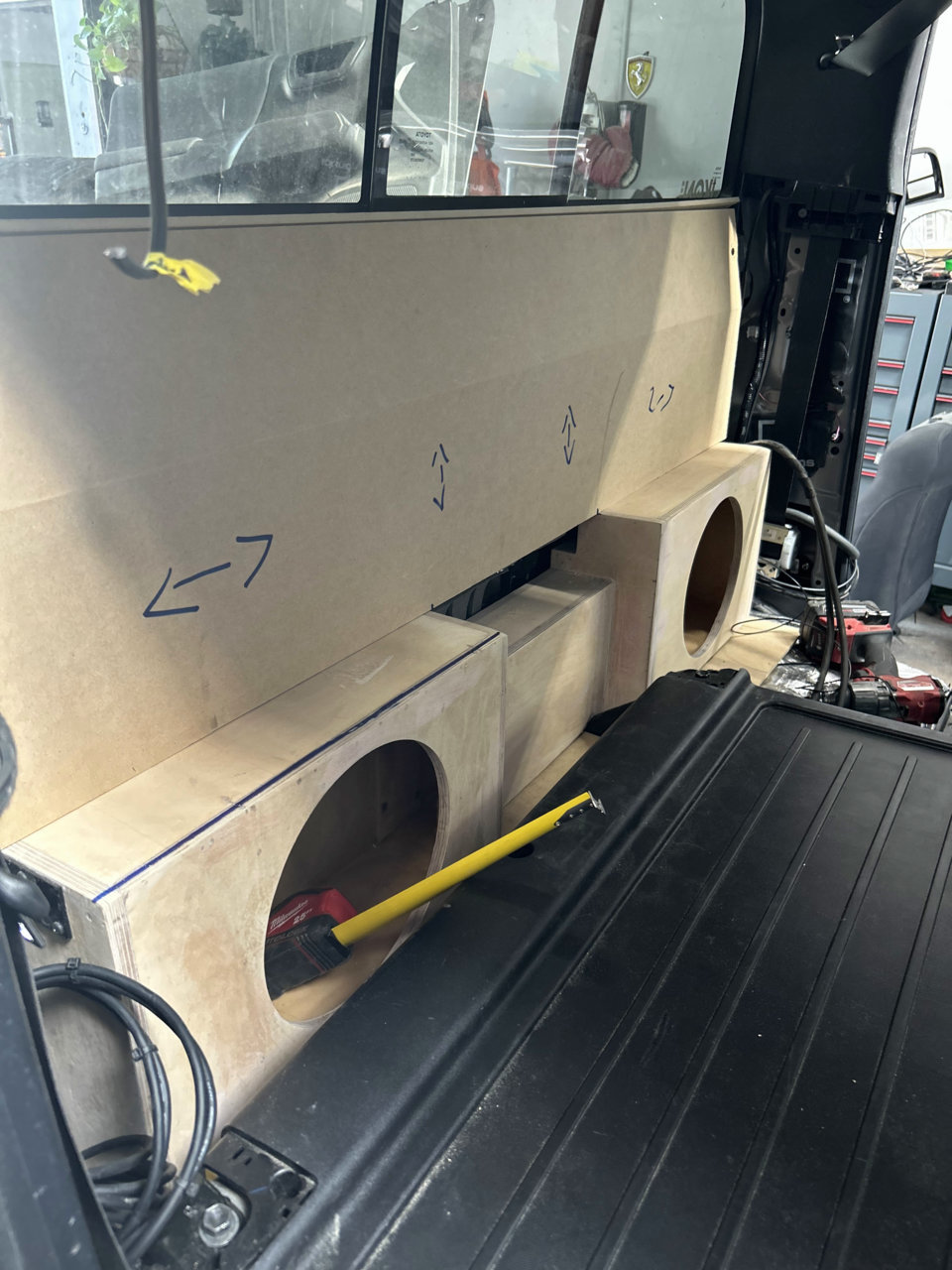

    Here is the beginning of the custom build I have 2 Helix K10s

    did the amp fit without modifying under the seat at all

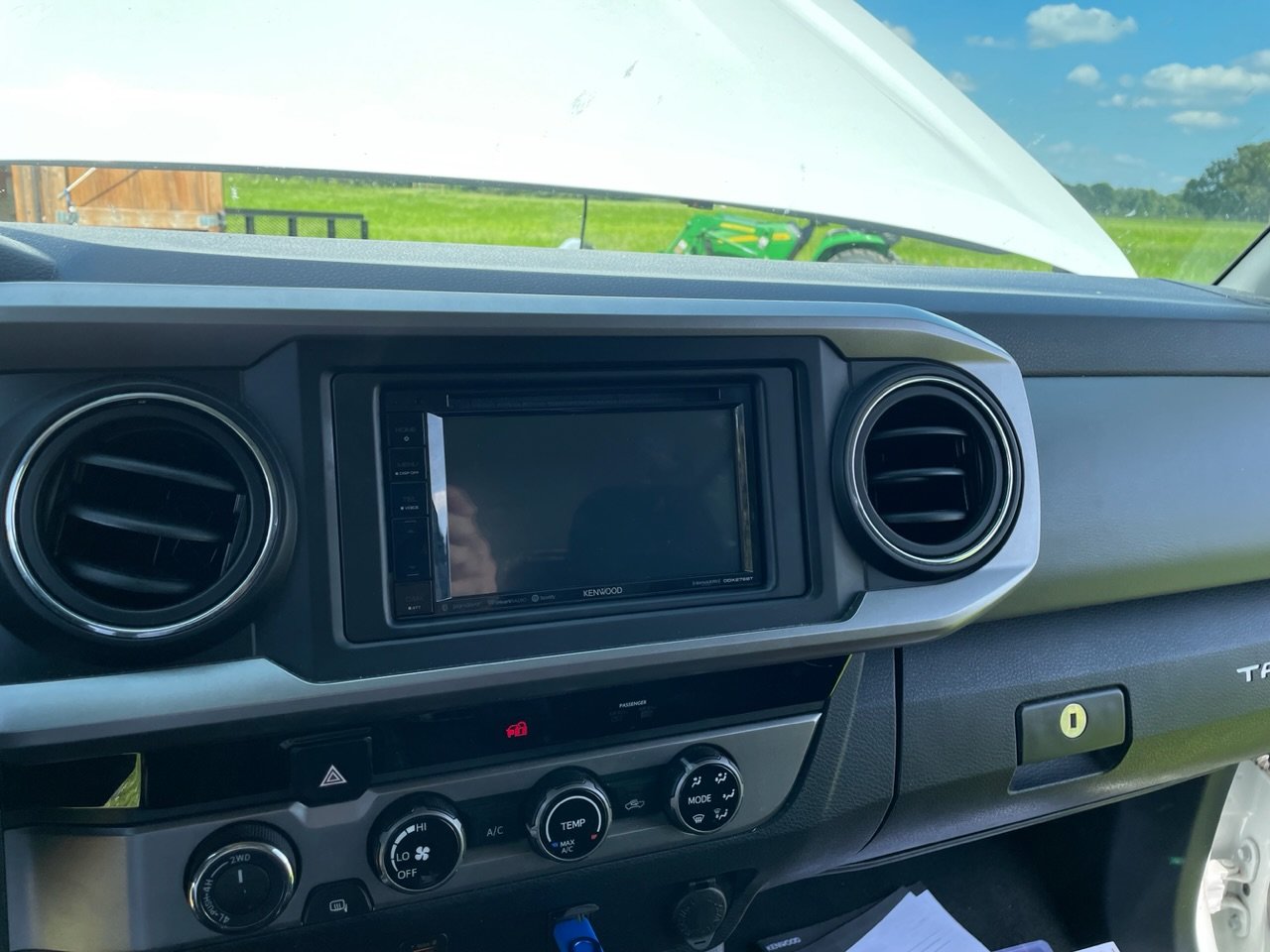

    How did it come out? What did you use for a LOC or did you use an aftermarket radio?

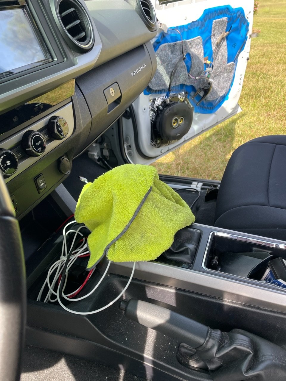

    I went with an aftermarket Kenwood head unit , so far I’m pretty pleased with it. I also removed the plastic backing on the back seat. I’m still in the getting everything broke in phase I just added some kicker 6x9’s in the front doors before I start cranking it up. IMG_0329.jpgIMG_0375.jpg
