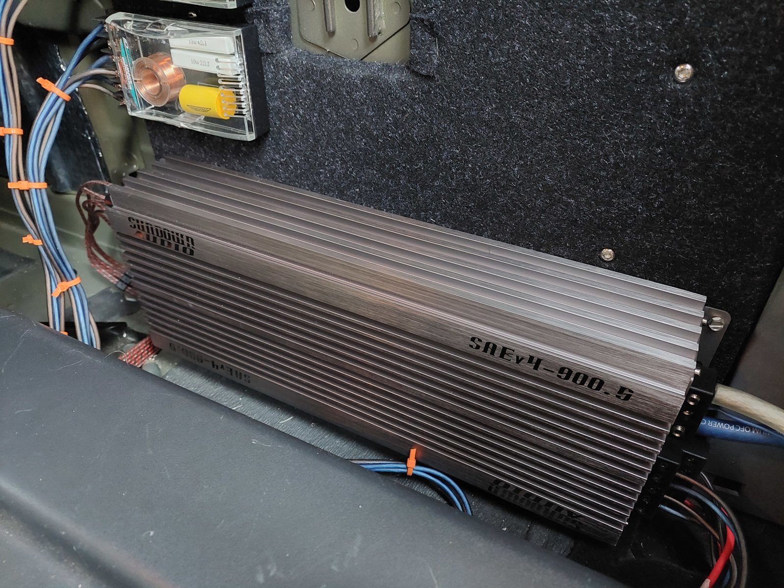

    Amp is in. Created a simple rack out of the leftover birch plywood that used the existing threaded holes from the old storage bins. Rock solid. Carpet simply wrapped around the edges and stapled into place.
    Should be able to get the subwoofer installed tomorrow once Amazon bothers to deliver my jigsaw.

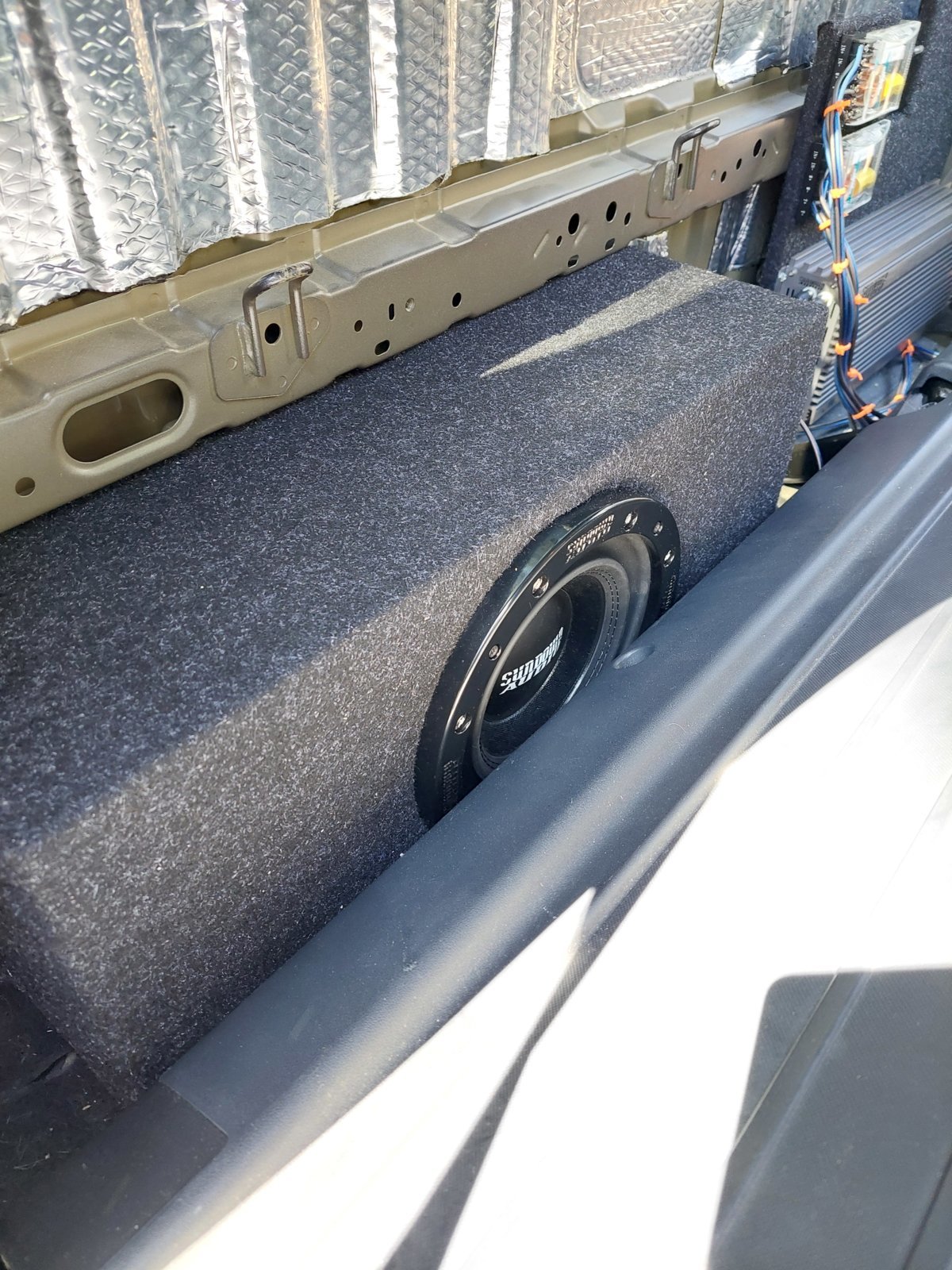

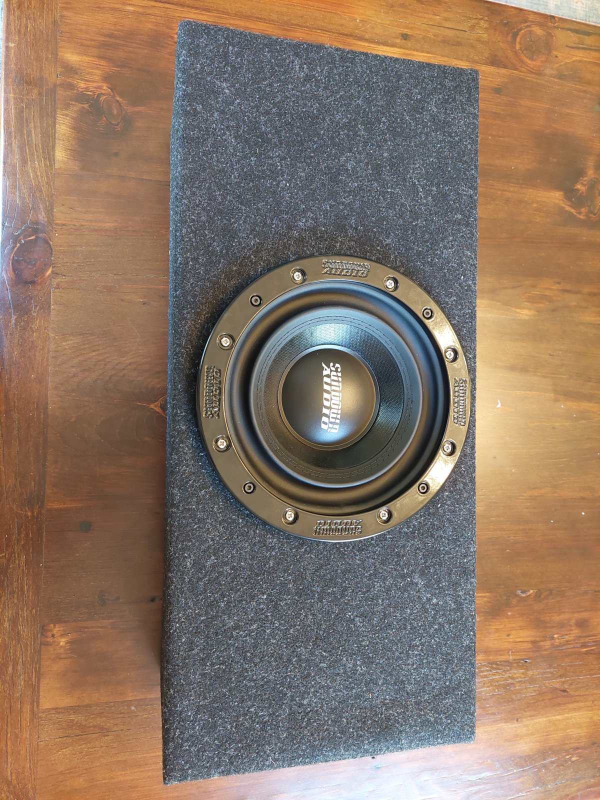

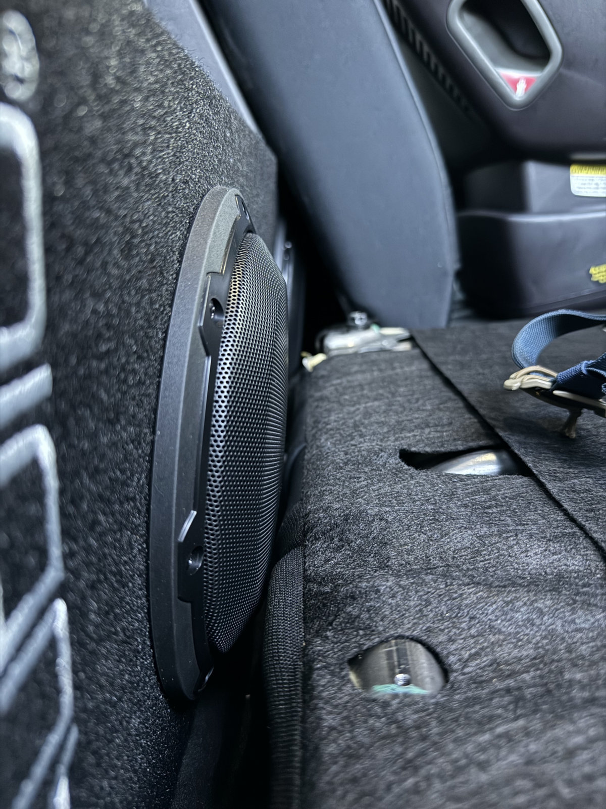

    Sub is mounted and box is carpeted. Subwoofer ring barely touches the back of the seat, so we'll see if that causes any problems in the long run. Now it's time to tune...

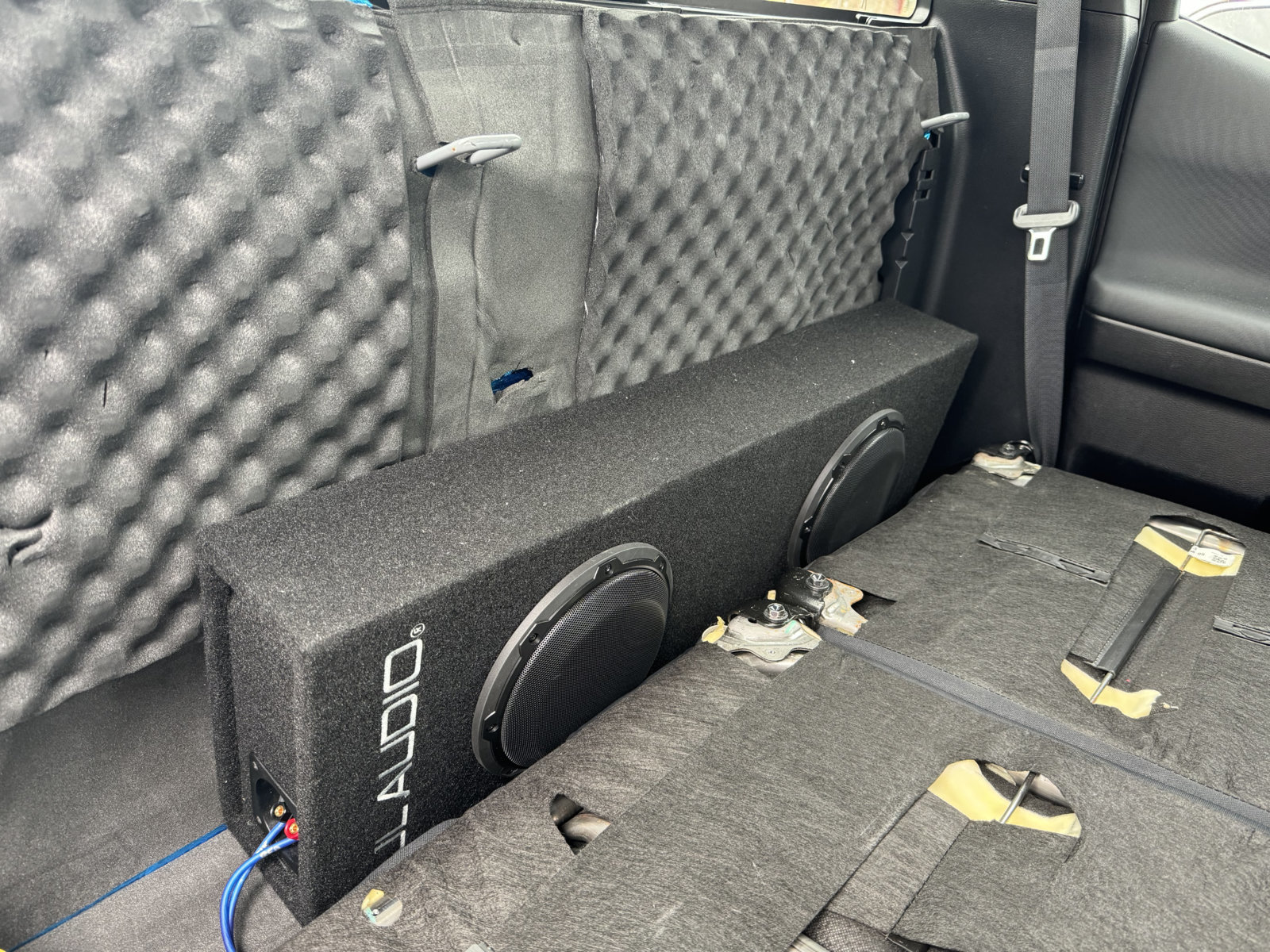

    2 8” W3 in JL’s ported box. Pretty happy with the output on these for 8’s. Curious to see how a sealed 10” running off the same power sounds like in comparison. I wavered between a sealed 10 and 2 ported 8s for a while. Finally just went with the 8’s. Running it off a JL XDM1000/5 at 600 watts rms.

    That’s impressive, must sound amazing. I think 8” subs are the way to go!

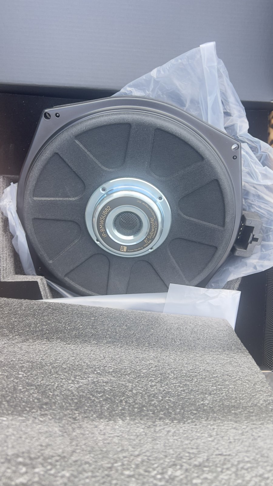

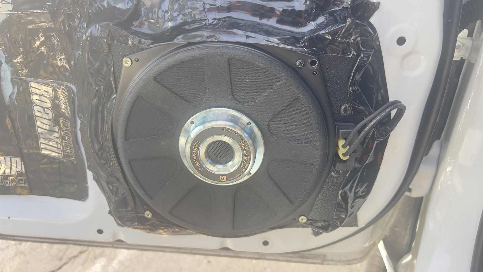

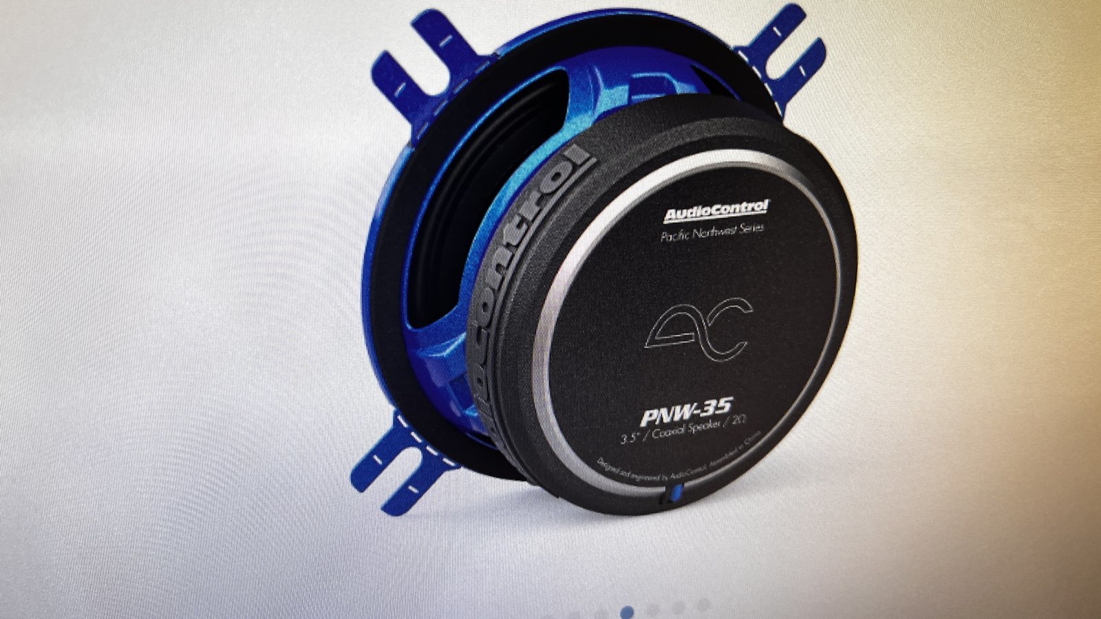

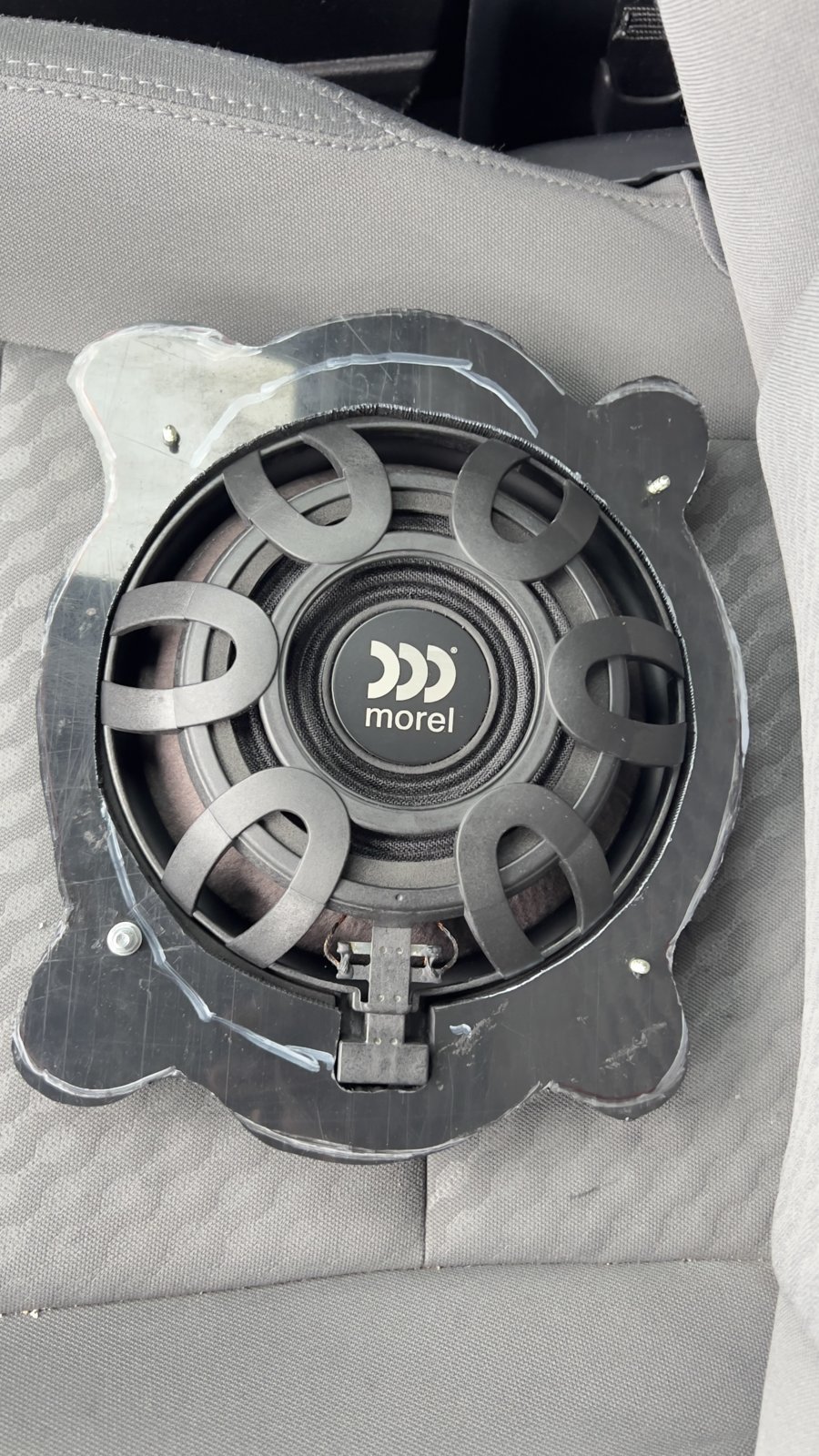

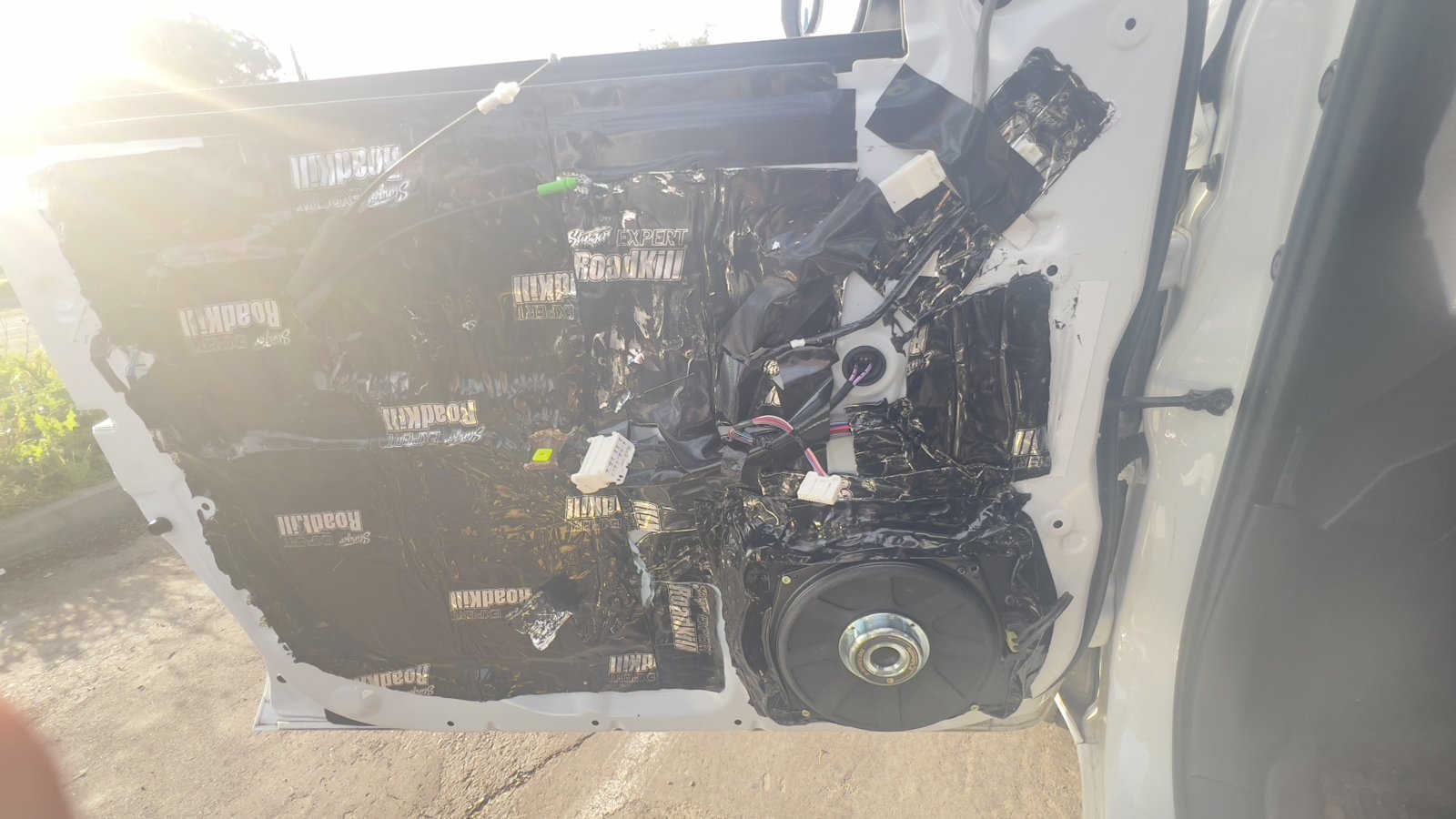

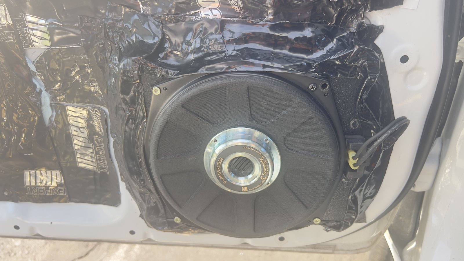

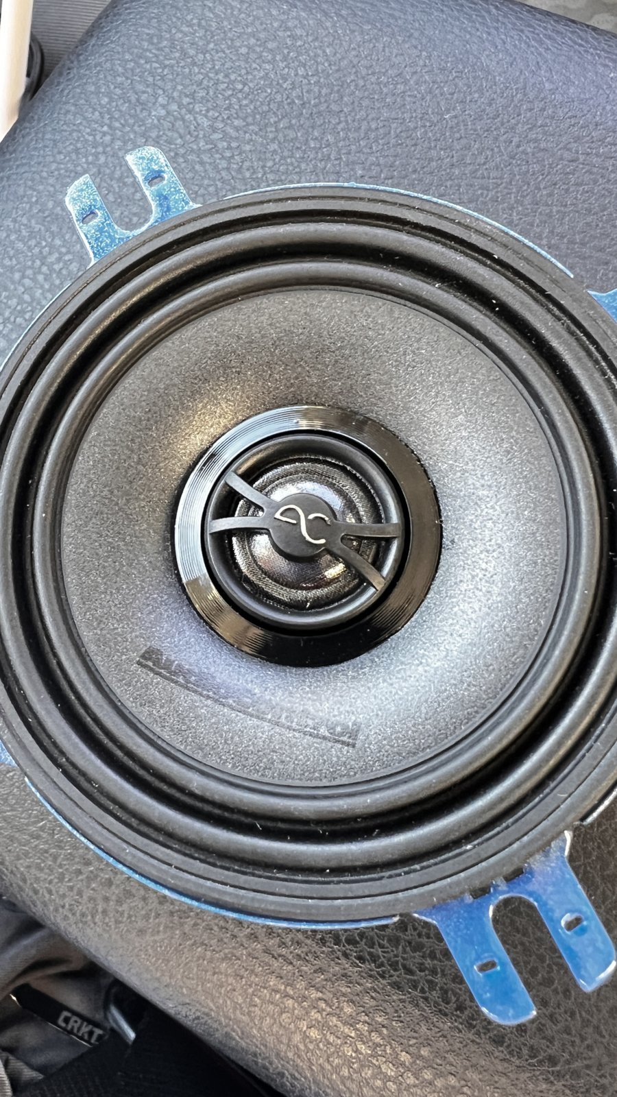

    Well I pulled the plug and here they are the newly installed in my front doors Morel IPBMW82SUB AS MID BASS IN MY FRONT DOORS

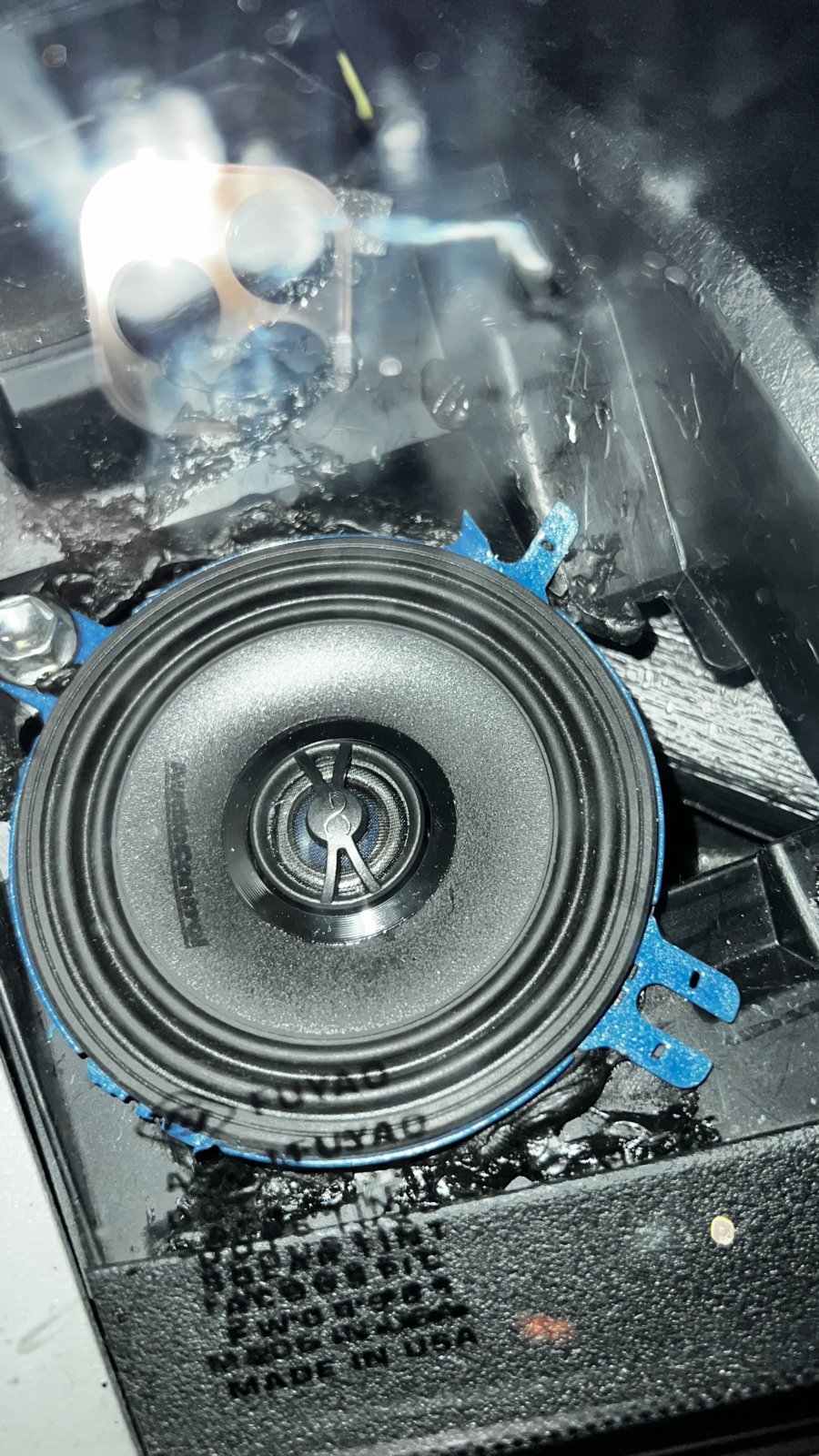

    I set the crossovers at 70 hz @ 24 db and high cut off at 700 free band pass or not sure if that’s what you call it I turn down the dbs until they where completely off and I ended up with some decent cohesiveness with my 3.5 AUDIO Control coaxials on the dashboard which are set at 450 hz all the way up to 20000khz.my sub is set at 80hz and I cleaned up or turned the eq down on the ranges over 100 hz so it’s now hitting the deeper notes mostly.
    I just did the tuning by ear and not using any RTA mic only the iPad app from audio control. So far I am very happy with the fuller mid bass although it is not highly powered to rattle the neighbors doors but rather more SQ. I’m feeding all the channels with a 5 Channel JL Audio XD 1000/5 V2so the Morel mid bass drivers are getting no more than 85 to 90 watts max even though they are rated at 2 ohms each
    where as the 3.5 mids are only getting like 65 watts and the Audison 10 inch sub is getting around 400 watts for me is louder than what I can handle so I’m planning to get the system properly tuned and then decide if I need more watts for the mid bass.

    Nice work!

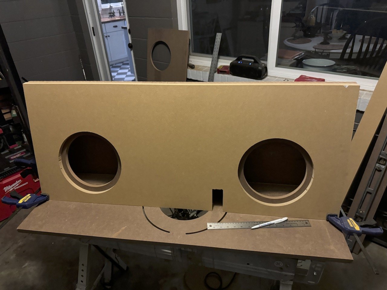

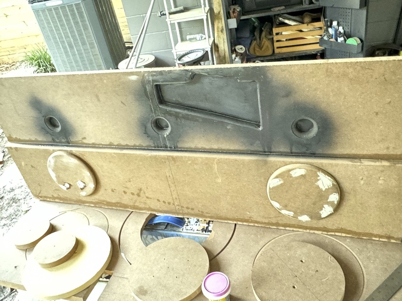

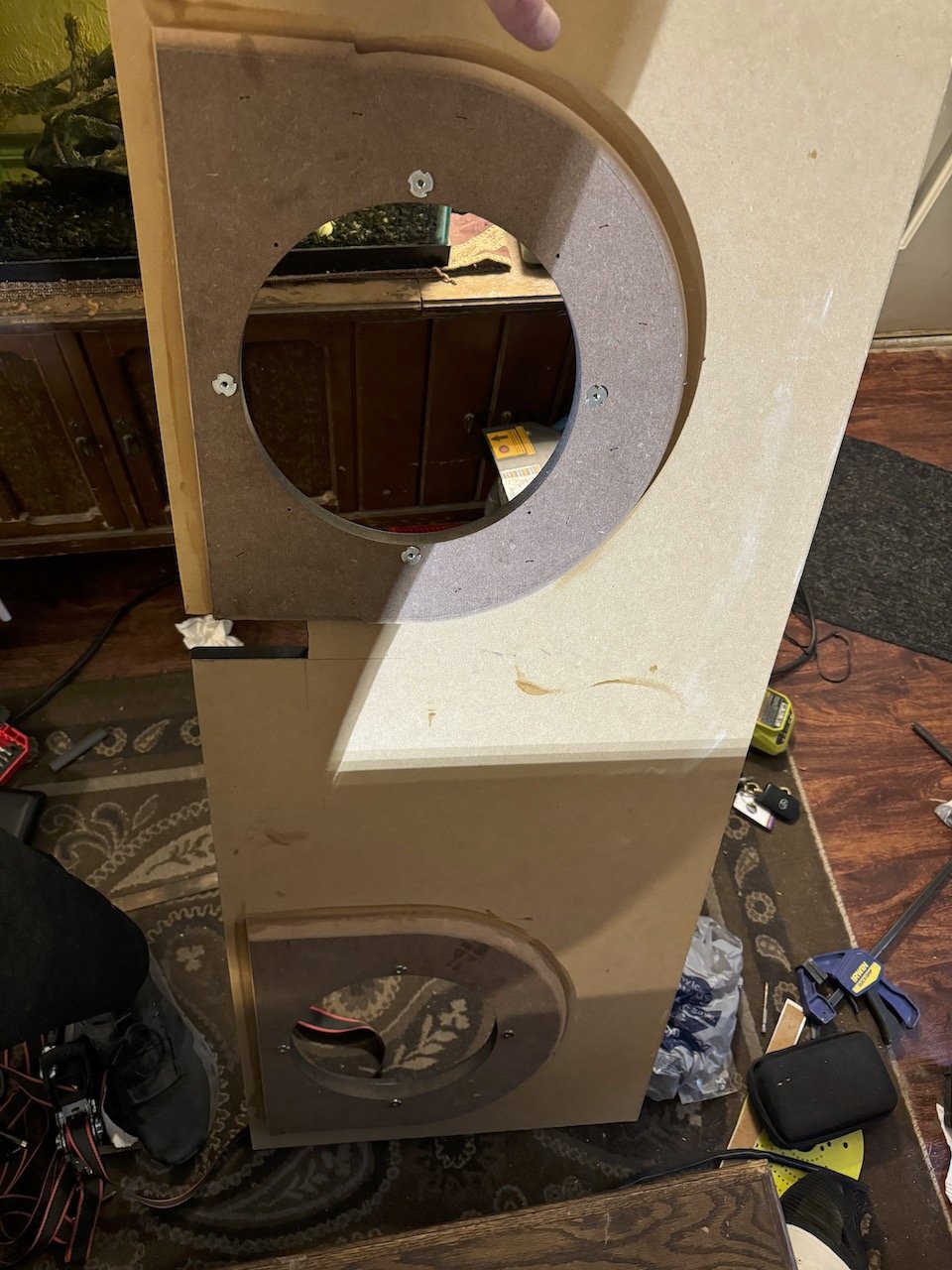

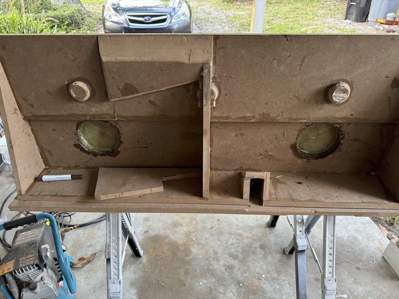

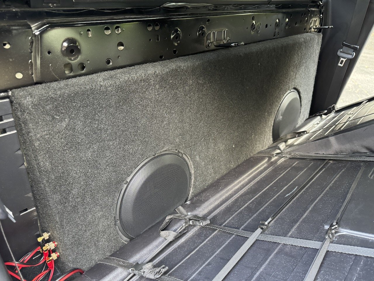

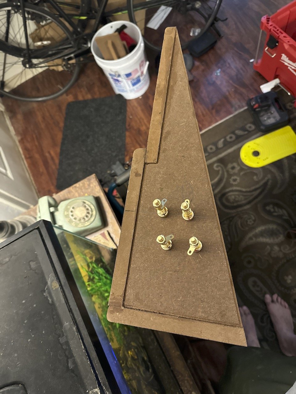

    So my goal was to build a sealed box with regular (non-shallow) subs, maximize volume, and also be able to fold my seats down and not remove the seat backs. Wanted a ported box, but the space it just not there. Many, many hours later..
    Crazy shaped back to fit around the hooks and window motor:
    Interior with the cut out for the seat bracket:
    Inside of baffle:Front:Profile:
    End product:
    Two JL 10 W1v3 4 ohm subwoofers from Crutchfield, volume was about .65 ft3 per subwoofer (so a tiny bit above recommended), 400 watts to each (guess I just voided my warranty...). I miscalculated and had to cut out the back to get the magnets to fit. I wound using a Bondo fiberglass kit for the cut-outs. Knowing what I do now, if I were to do it again I would use fiberglass much more of it, because the space is tight with 3/4 MDF (as Soundman mentioned previously). I also messed up thinking the grills would fit, so they got bent by the seats. Overall though, came out well.

    There are some really insane 8’s out there nowadays. 8’s can absolutely thump. A good 8” sub with the right enclosure and power won’t let you down.
