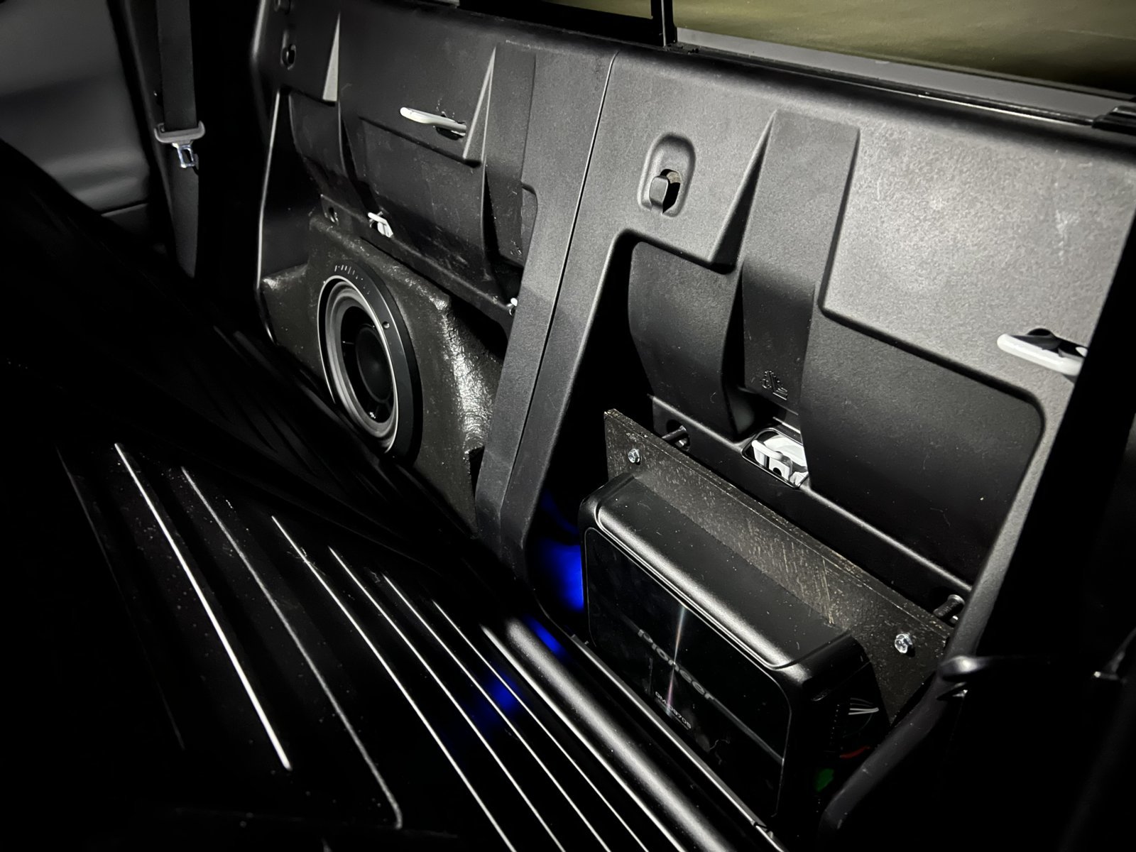

    Replaced all 6 stock speakers with 4 ohm kickers. Ran (x2) 9 conductor quickwire from head unit to amp/amp back to speaker harness. Made the enclosure myself and installed a Fosgate P3SD4 wired at 2ohms. Pioneer GM D9705 (Has speaker inputs to use instead of rcas so I could use stock head unit). Then added quick connect adapters to make disassembly easy if needed.

    Beautiful enclosure, fiberglass? How many cu ft does it come out to? Is that an 8? Love your setup, super clean!

    Yes it’s fiberglass over wood framing. 10” sub, no idea on cu/ft. Just wanted it to fit. thinking of buying the skar enclosure that wasn’t available when I built it. Will definitely have more than what I made.

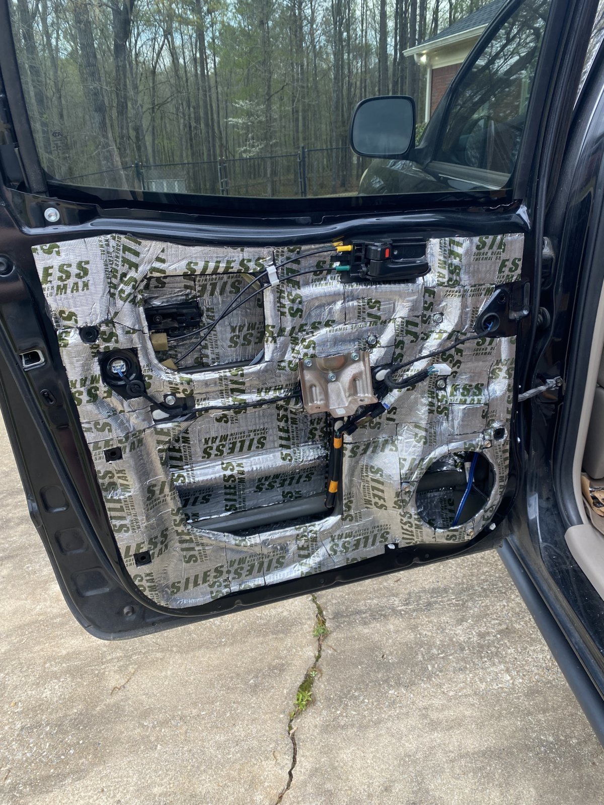

  15. May 24, 2024 at 7:47 PM
    #955
    azhiaziam
    azhiaziam Well-Known Member
    Feb 8, 2014
    #122554
    3,174
    The reef ca
    White 2023 trd off-road
  16. May 24, 2024 at 7:47 PM
    #956
    azhiaziam
    Feb 8, 2014
    #122554
    3,174
    The reef ca
    i looked that up earlier its about 450 bucks for 28 sheets is what they recommended and that's with there memorial day sale lol.

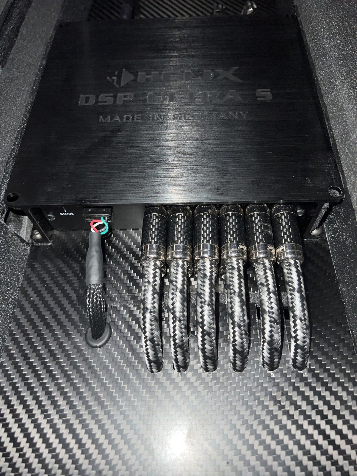

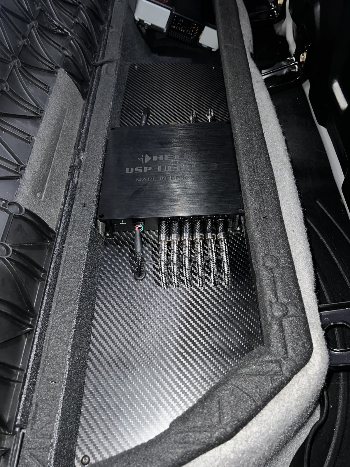

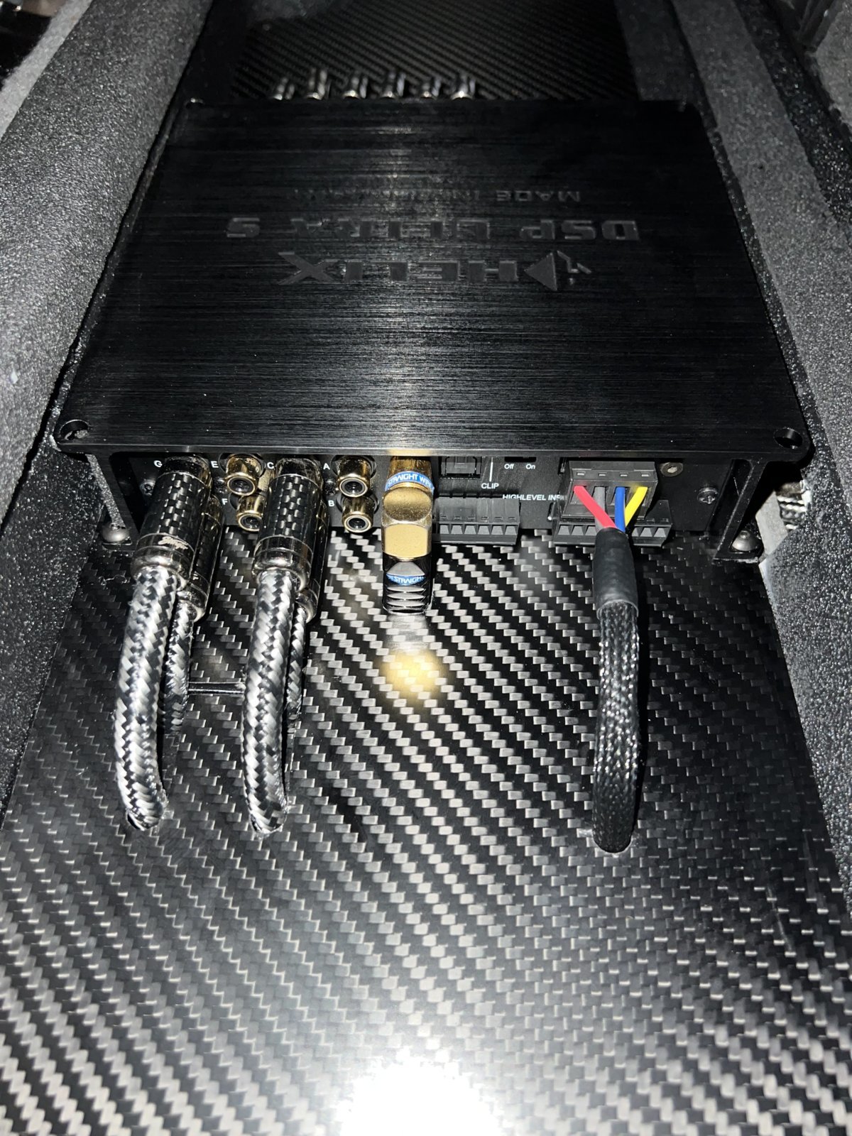

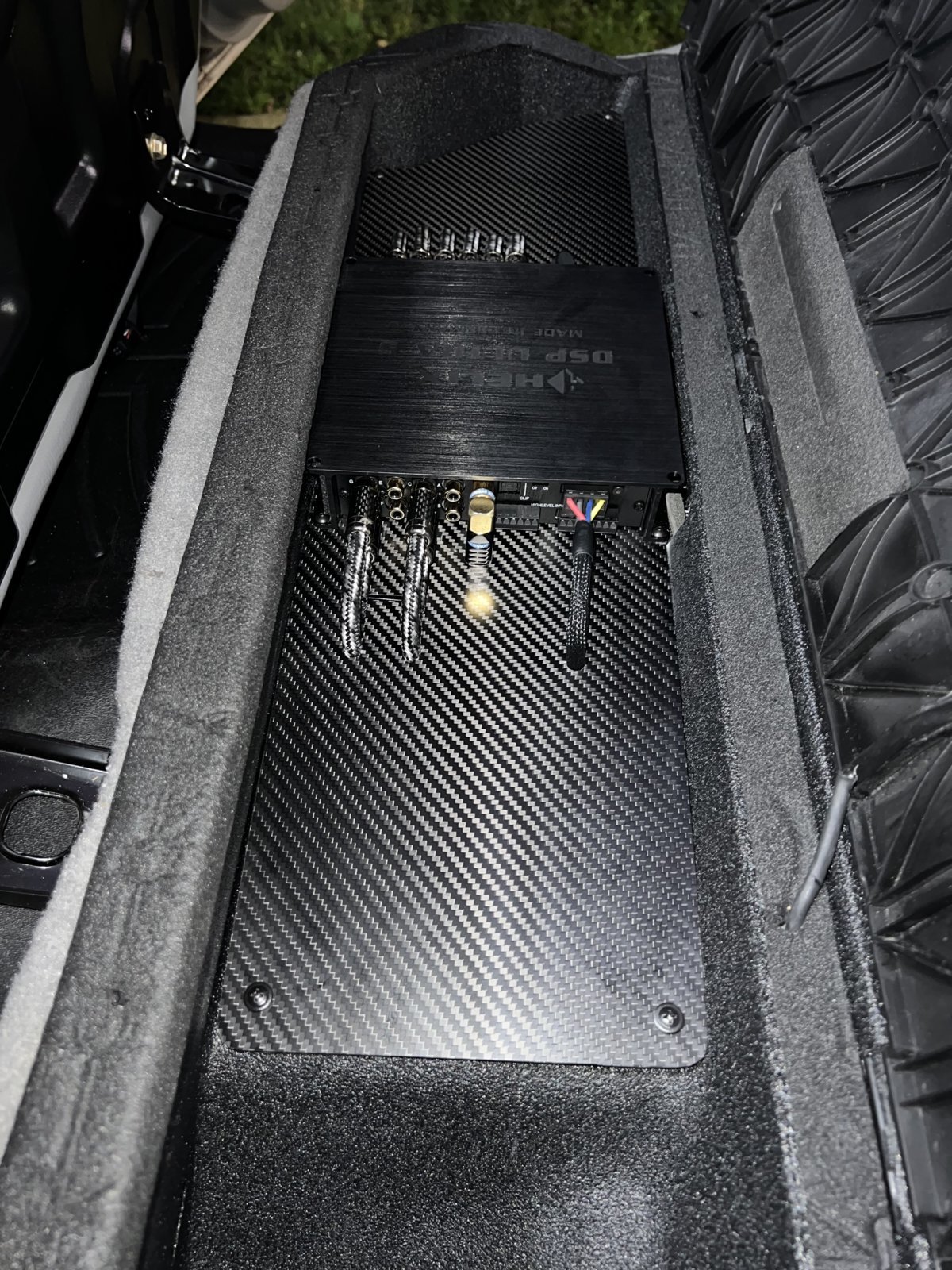

  20. May 27, 2024 at 7:57 PM
    #960
    NavyDiver72
    NavyDiver72 I DO ALL MY OWN STUNTS
    Mar 18, 2013
    #99967
    411
    Rick
    Millington, TN
    2006 DCLB TRD Sport PreRunner
    Any Mods? One. Maybe two, tops...
    Finished getting the amp for the front 8” sub and went a different route with the DSP. Getting close to finishing the build… for now
    :rofl::rofl::rofl::rofl::rofl::rofl::rofl::rofl:
    IMG_7646.jpg IMG_7647.jpg IMG_7648.jpg IMG_7649.jpg IMG_7650.jpg IMG_7651.jpg IMG_7653.jpg IMG_7652.jpg IMG_7653.jpg IMG_7654.jpg
