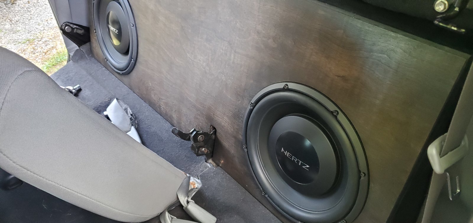

    Did you fiberglass an enclosure under the glovebox or something? I was considering this to fill my midbass, but went with JBL fuse pods under the seats instead.

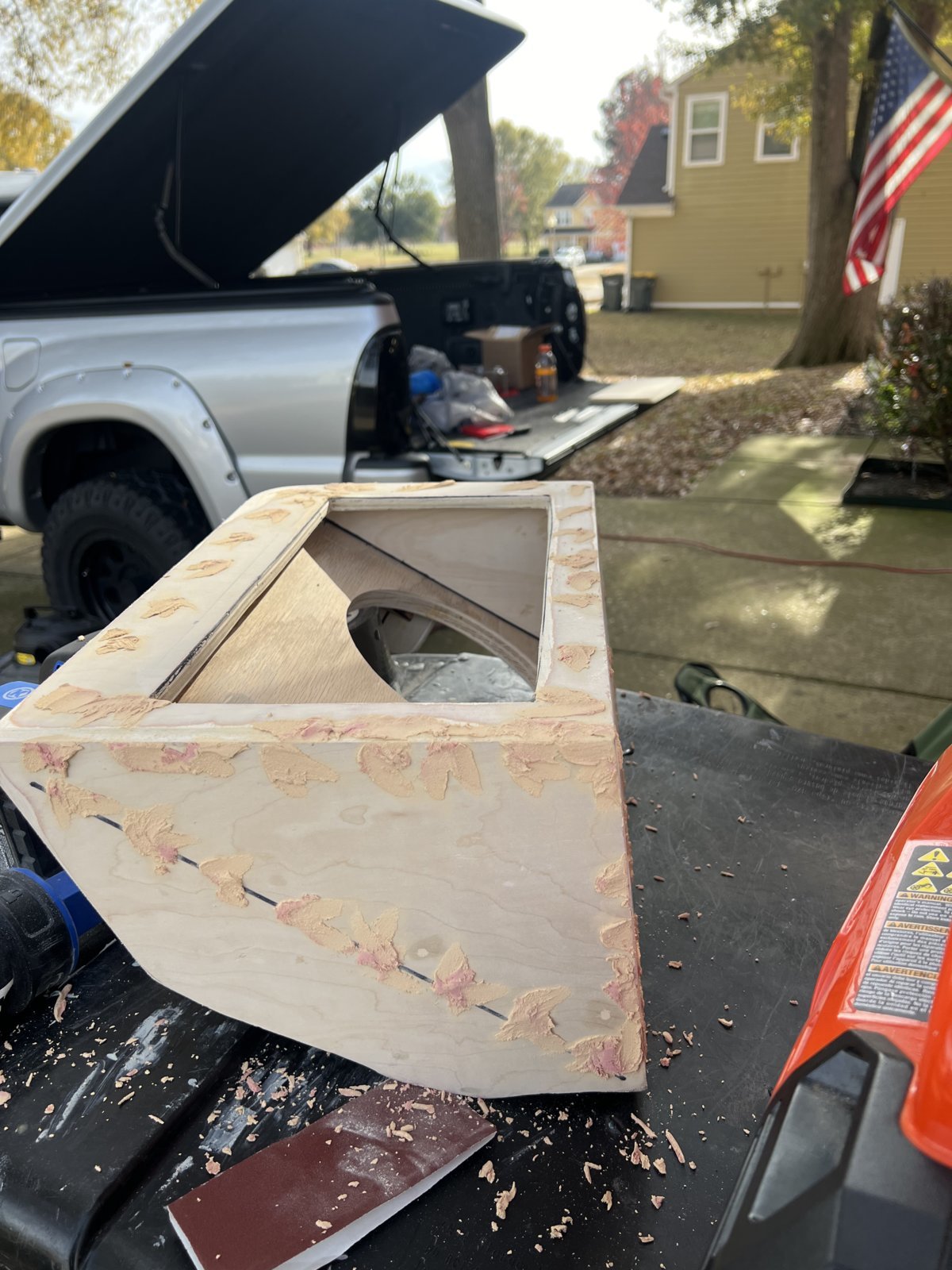

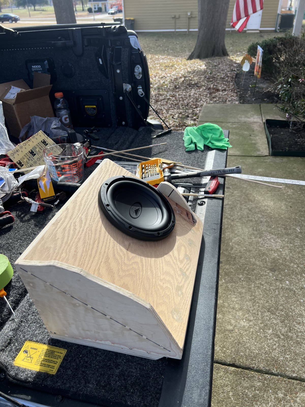

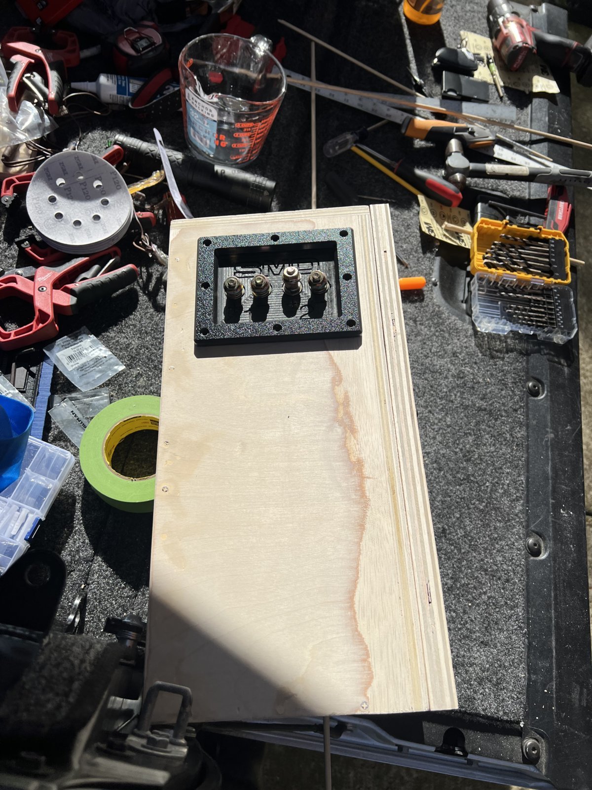

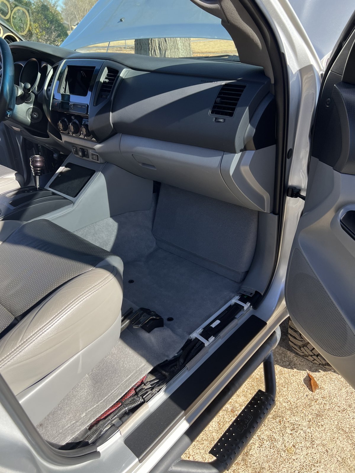

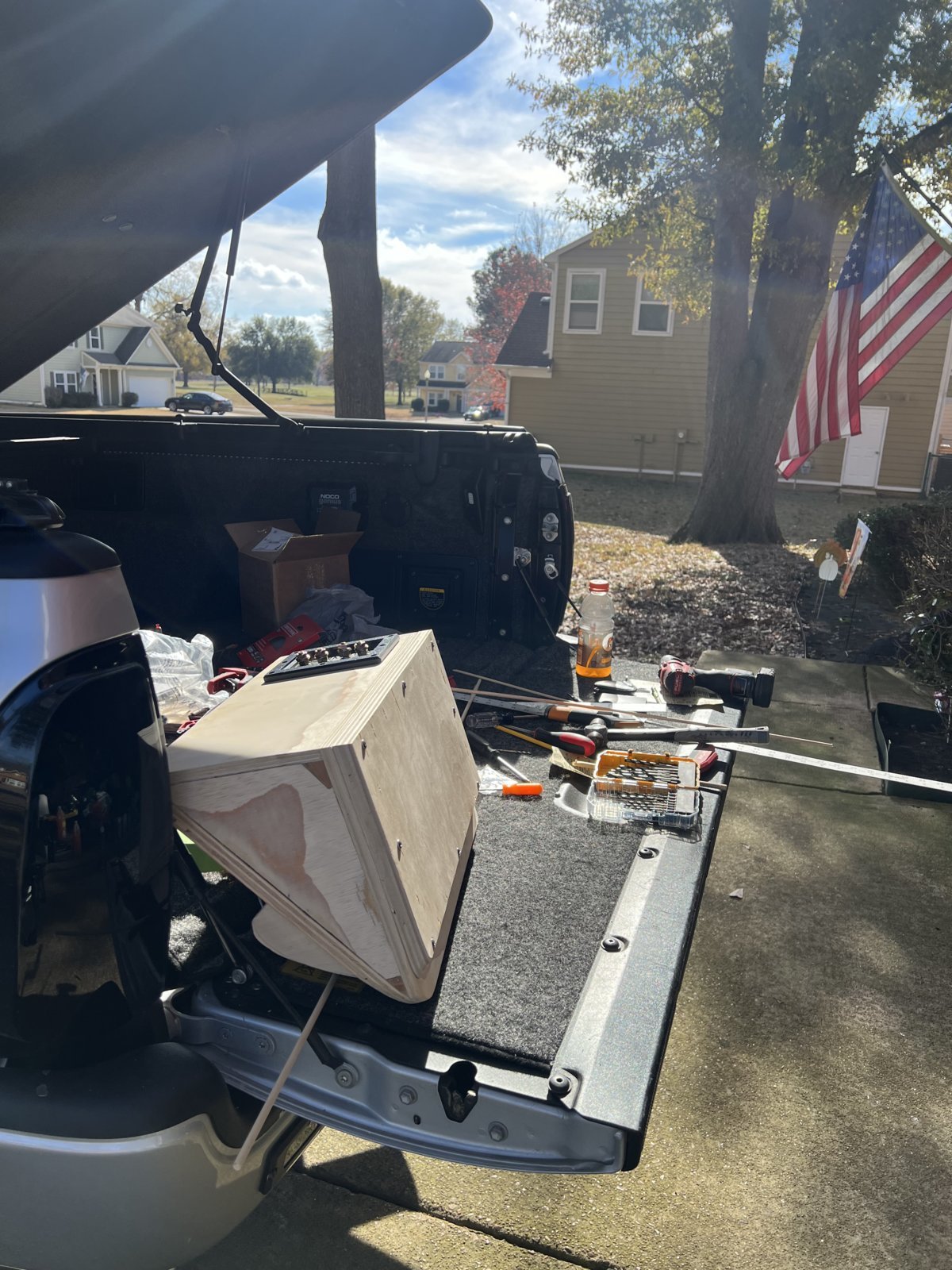

    I thought about fiberglass, but 13 ply Baltic Birch would be way stiffer and stronger IMHO, than anything I could have fabricated using fiberglass.
