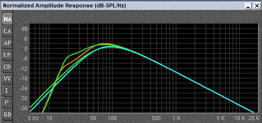

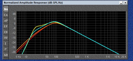

    I also don't know why you threw out a random driver... it doesn't even have a published decibel frequency response plot
    I did throw that one in bassbox rq with a guesstimate on the box dimensions.
    Yellow is ported performance with a single driver. Cyan is ported dual. The other two are sealed single and dual (single has slightly better low end response but ofc will be offset by +6db from the 2nd driver). Best case is single with port, yielding a -6dB point of roughly 20Hz from the box itself, so ya not bad, the others are 30Hz and 40Hz, respectively. The 2nd driver barely even makes up for its existence at 20Hz. My guess is a 10" sub's response is not that extended by a long shot though... leading to further reduction.
    https://loudspeakerdatabase.com/JL/10TW3-D4
    ^ if this site is to be believed (wild that driver and enclosure drop-off starts exactly where I said), we see similar results
    To your credit, the box is a bit larger that I thought at first, and I didn't realize we were in the $500/driver category. Looks like he will get solid performance 30Hz+, and even better performance (flatter response - less active tuning) if he drops one driver and ports it.
    PS. I hate a peak in the 80-120Hz band, so if no DSP, only crossover, probably best place to set it is 50-60Hz. But with all that combined, he's gonna lose quite a bit of power.

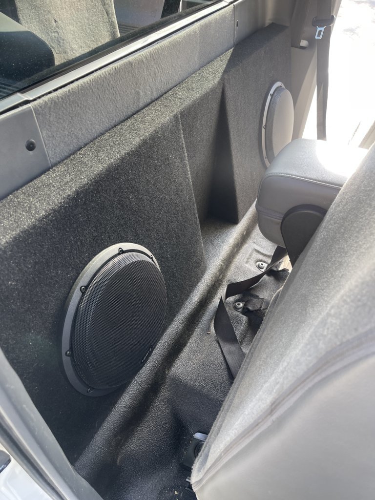

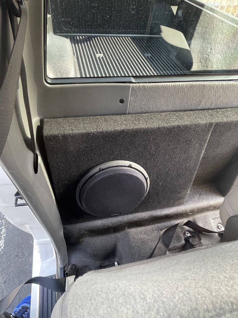

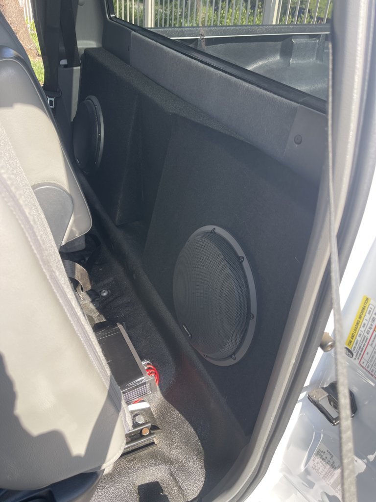

    All im going to say is it cranks, just got it back, even more so than my high dollar system....
    Went with
    cheap Recoil red1800.5 amp, $179 reg price & I paid $79
    980 watts going to the 2 subs, dont have it wired down to 1 ohm, no reason to work the amp that hard.
    220 watts going to ea driver.....
    Cdt 62-hd, running them active crossed over through the amp, not using supplied crossovers that came with speakers.
    2 Hertz mps 250 10" subs...
    Kenwood Exeleon dmx908s
    The box took up the entire width of the rear cab area...
    Sound pretty amazing for not having high-end equipment...
    CDT from my understanding you get more for the money due to dealer direct, cut-out the middle man...
    Yes, the subs weren't low-end...
    Happy with the sound & son is beyond stoked....
