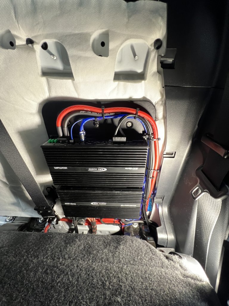

    This truck does have the factory 14", but can do the same with the 8"....
    I didnt replace the radio, really no replacement options right now....
    My amps are mounted on the rear wall behind the plastics where the factory POS jbl sub use to sit...

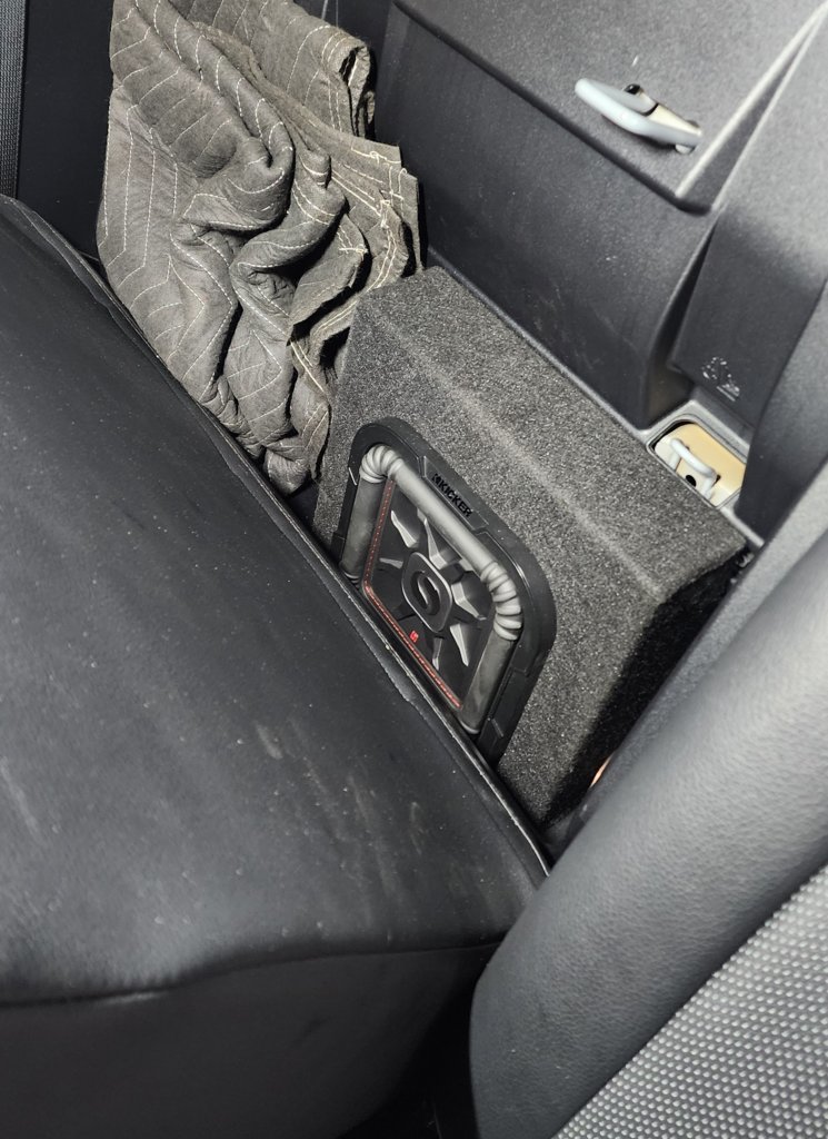

    Another Mr. Marv creation with suggested components. He is great to deal with and has a fast turn around for advice, whether or not you buy from him.
    The L7T8 in Marv's enclosure and the CXA4001give me all the bass I need with the Pioneer DMH-WC6600NEX headunit running the Kicker door speakers and Subaru dash tweeters.

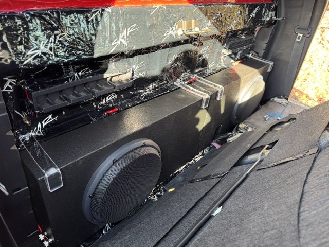

    So the ranger dual 10" box I posted in post 1053....
    We blew the back apart as the builder has the rear back offset so the back is 2 pieces going across...
    That joint blew apart...
    After the builder repaired the box & tossed in some re-inforcement braces, before reinstalling the box I added 2 lbs of Acousta Stuf Polyfill in the box cuz I was hoping for more & my son is liking the sound of my 12 tw3....
    Ougggggghhhhhhh my god, in this situation with these hertz mps250's, the subs performance is night & day difference, ide say 3x more impressive, sounds like a completely different system.....
    So I put 1 lb of the same stuff in my tacoma ground shaker box with the 12" tw3 & felt that it actually made things worse & not better....
    I feel that the tw3 performs so well when it comes to the boomy deep stuff, it actually took the punch away, not as loud, & also the deeper stuff also suffered...
    Maybe cuz the groundshaker 12 tw3 box is slightly to big for that driver, not sure...
    Needless to say I removed the poly fill from that enclosure but wow the ford ranger is stupid now, easily sounds like 2 12's to my ear...

    Did this fit in the cubby hole without any cutting? Are you happy with it?
  16. Jun 3, 2025 at 5:28 AM
    #1076
    HiterSixOne
    HiterSixOne Well-Known Member
    May 5, 2020
    #326883
    46
    2020 Sport
    It fits great in the passenger cuddy, but in the driver cubby it puts this sub face touching the cubby front wall. The passenger cubby is about an inch wider front to back than the driver.
    Im throughly enjoying it. Plenty of bass for me without disturbing someone in their house as I drive past.
    soundman98 and GRNT4R[QUOTED] like this.

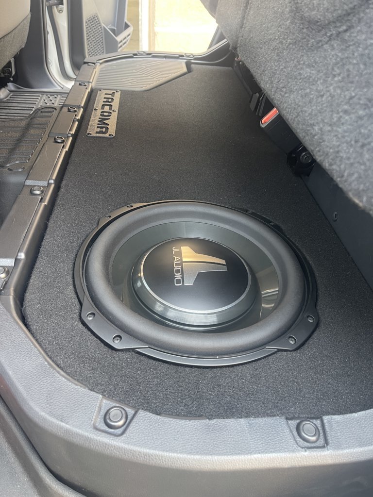

  18. Jun 6, 2025 at 7:05 PM
    #1078
    14baja
    14baja Well-Known Member
    Feb 15, 2017
    #210653
    60
    Denver
    15 TRD OR, Auto, Supercharged-totaled : ( Now in 04 TRD manual
    IMG_1638.jpg IMG_1642.jpg IMG_1641.jpg Finishing up a JL10 and platform going in back of 04 extra cab. Should be done tomorrow. IMG_1638.jpg IMG_1638.jpg IMG_1642.jpg IMG_1641.jpg
    lowmower, Pray4Mojo and soundman98 like this.
  19. Jun 7, 2025 at 3:54 PM
    #1079
    14baja
    Feb 15, 2017
    #210653
    60
    Denver
    All done!
    raptor2018, lowmower, Ptteddy and 5 others like this.
