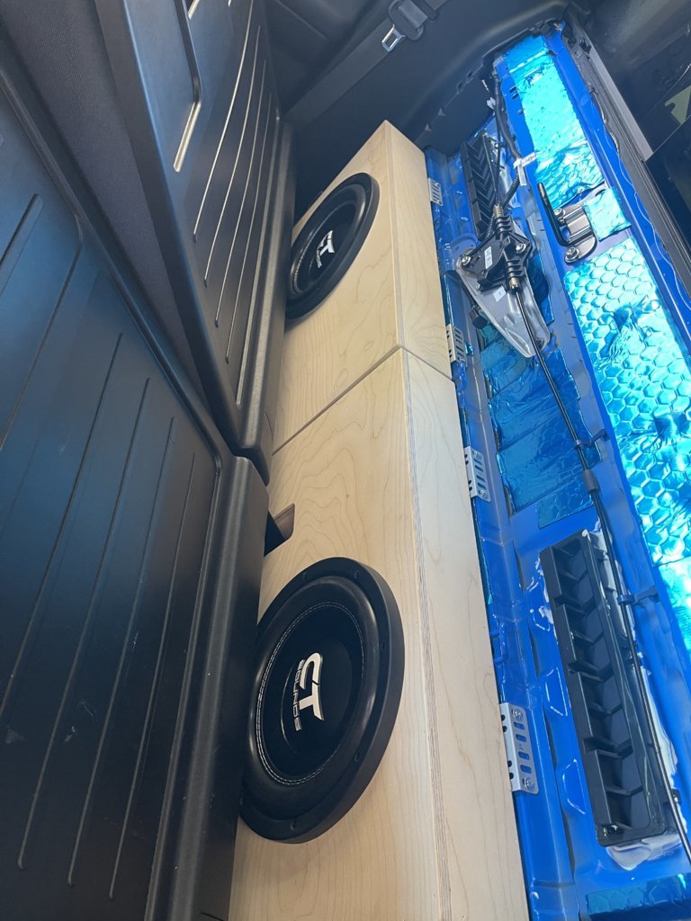

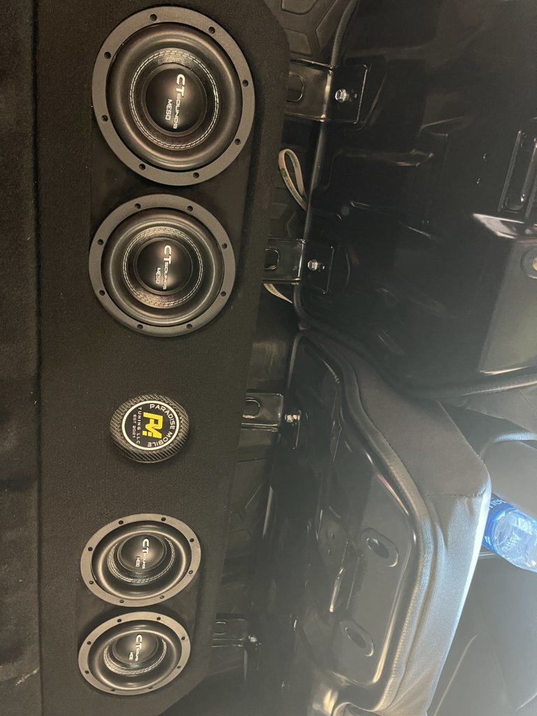

    Got 2 10” CT Sounds Hydro subs behind the rear seat. Sealed Enclosure done by mrmarv.

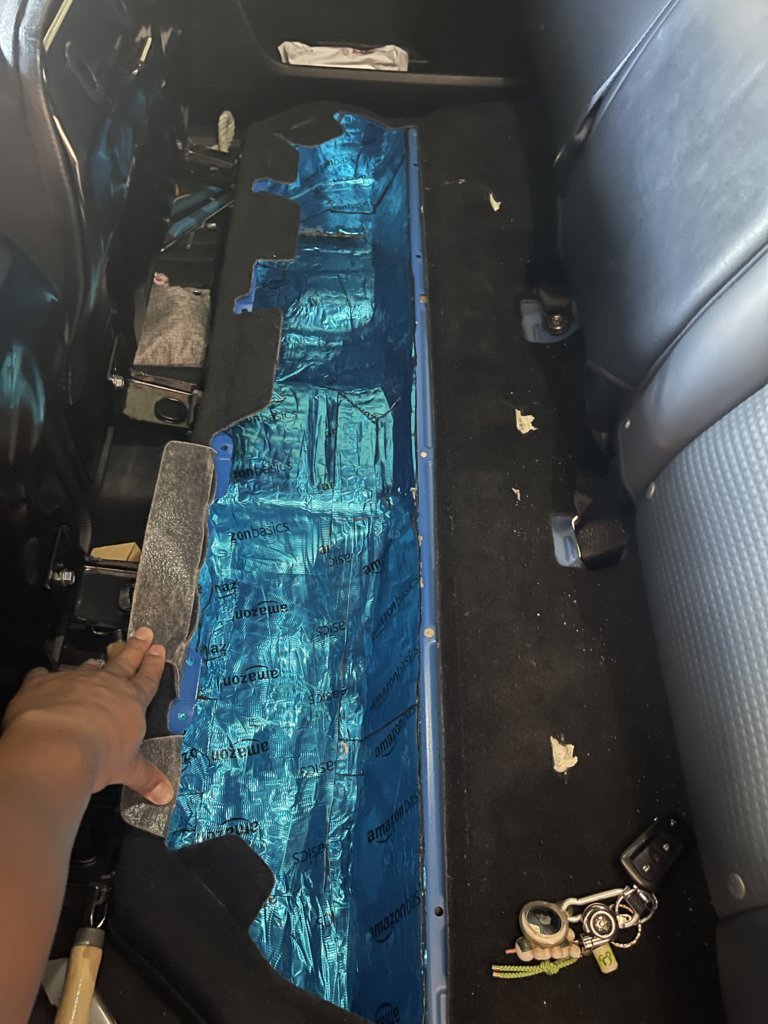

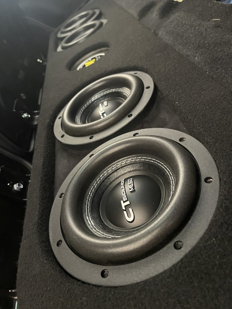

    And 4 6.5” CT Sounds Meso Subs under the rear seat. I removed the storage compartment and sealed the sheet metal holes toward the front of the cab with epoxy putty and the holes toward the rear with expandable foam and laid sound deadener. The baffle work was done custom by a local installer.
    Will be cleaning up behind the seat with carpeted boxes and and make things look more presentable. Over all I’m very happy with this setup!

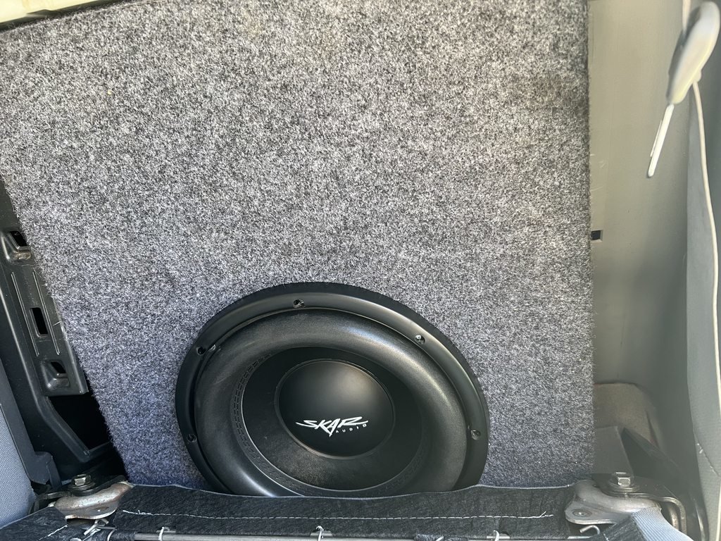

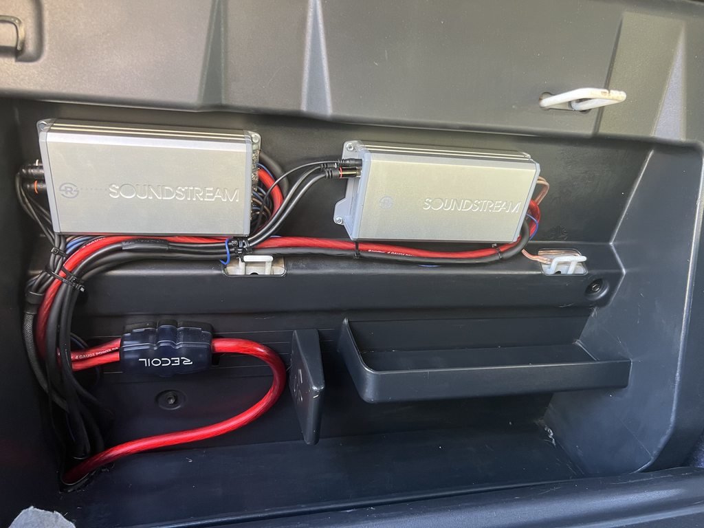

    Pretty basic install.

    Clean!

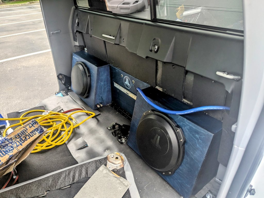

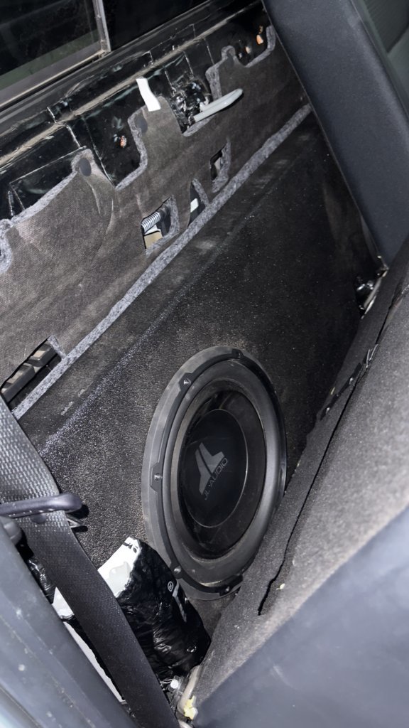

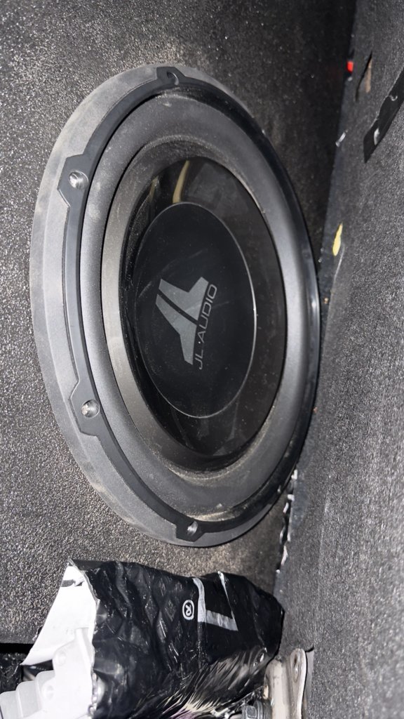

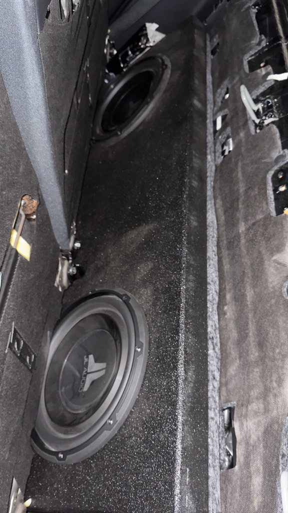

    I added 2 JL Audio W1v3 12inch subs,I’m deciding between cutting the back panels to install them partially above the box or just leave it the way it is

    My only challenge is re positioning the original JBL factory amp

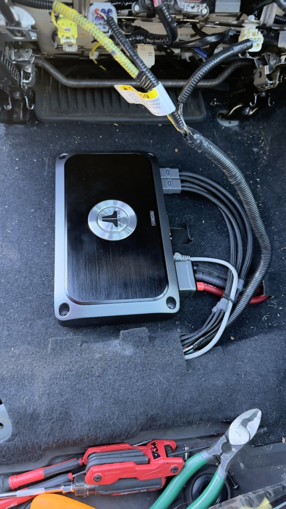

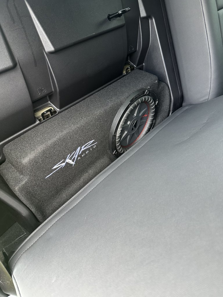

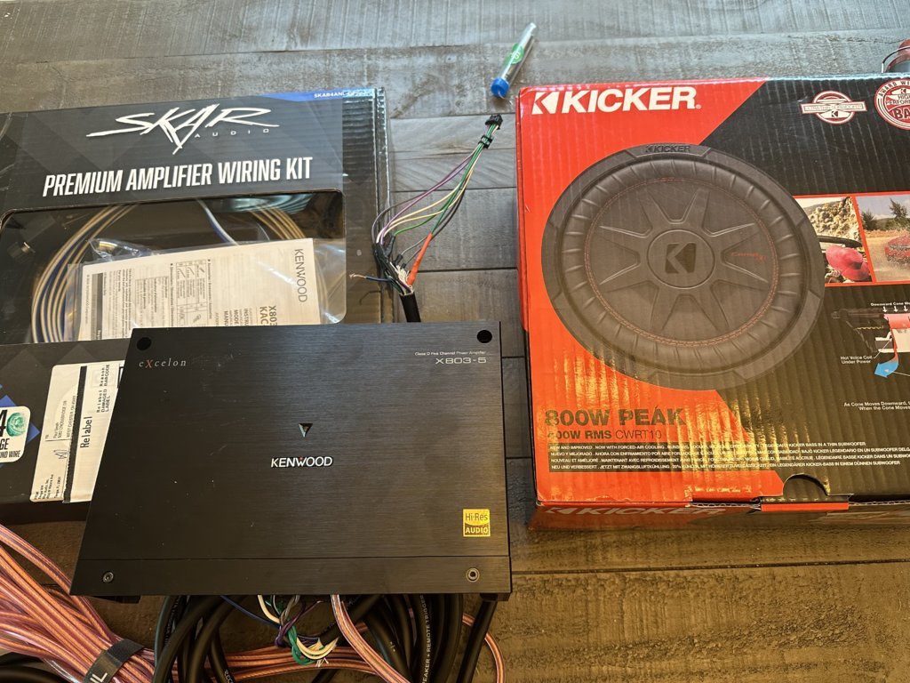

    Kenwood X803-5 1600 watt 5 channel amp with built in line level signal processing. Skar 10” sub box. Kicker CompRT10 10” dual voice coil 4 Ohm.

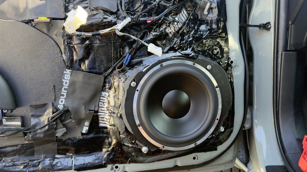

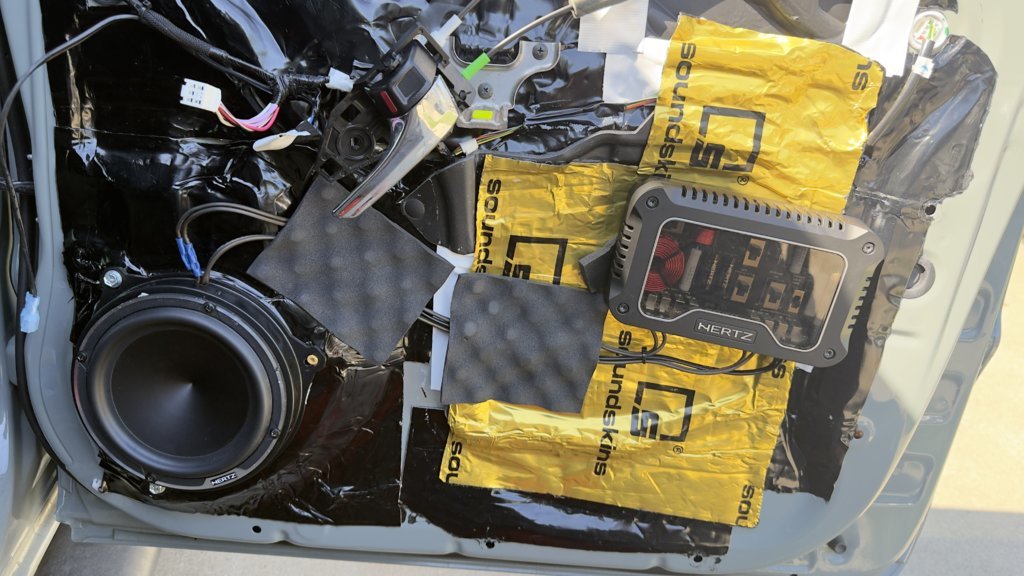

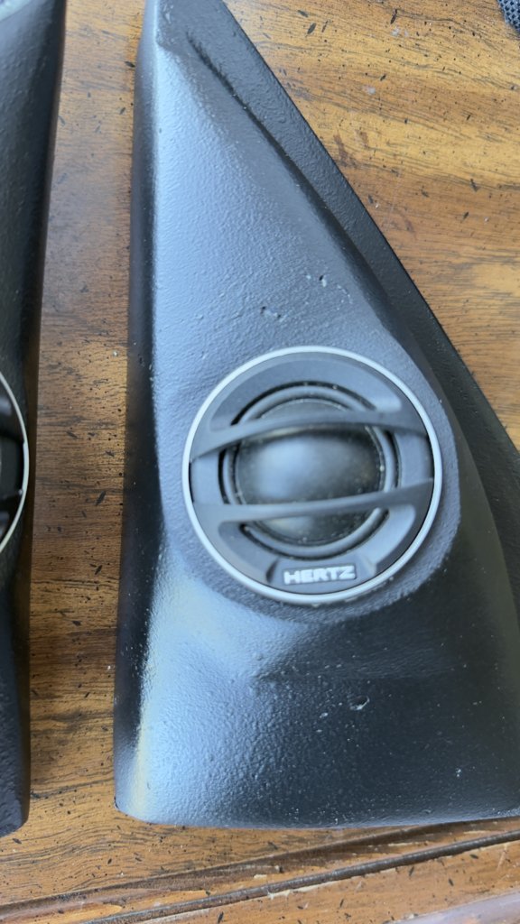

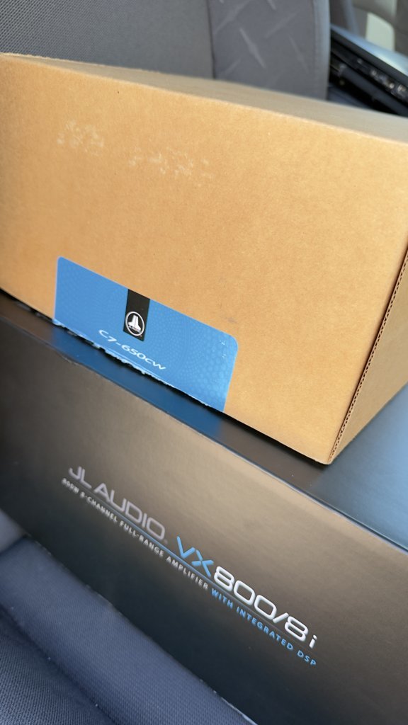

    After several months of getting different brands of equipment I was finally able to come across an 8 channel amp JL VX 800/8
    And the JL Audio C7 6.5 and C7 Tweeters so this new equipment will join the existing JL Audio VX 1000/5 and the Mille legend set currently installed on the rear doors with the passive crossovers.
    Since everything will be running active I will keep the Mille Legend tweeters at front mounted on the sail panels of the door and will remove the 9 inch morel mid bass to replace with the C7 6.5s the difference this time is that these C7s will be appropriately powered by bridging 4 channels of the VX amp.everyone I’ve met have talked wonders about the C7s. Why keeping the legend tweeters at front?IMO these are just a bit more smoother than the C7s and honestly I just like the way they look exposing the silky domes between the aluminum grills
    And if some noticed yes this will be my second set of C7s the first round I didn’t had the right amplifier to power them properly so I’m looking forward till the project is completed this time. I am maintaining a current set of C7 tweeters in the back doors these are there to stay since I cut the wholes on the rear doors panels they seat flush and I like the smooth grills.
    Since I added the 2 JL Audio Wv1 12 inch Subs my bass fills the cabin way fuller than 1 tw3 that I tested for a while so this will be the way to complete my system. A lot of support and guidance from Terry Q at Paradyme in Sacramento Ca throughout the process and special thanks to him all this is been possible as he is planning his retirement but still helping people tuning their vehicles he just has a developed ear after almost 45 years in the industry.

    what's with the brax graphic gl6?
    personally, i've demo'd a few of the jl midbasses, and i've never cared for them. i liked the hertz mid better, but still felt that there's better options out there.

    I love the hertz legends, I had them running passive and really liked the way they sounded
    So that will be the benchmark as you can see with the morel mid bass it might be hard to re adapt since it is pretty strong however I’ve heard the c7s in my friends truck properly tuned and powered with the VXI amp bridged and they really popped and I did like them quite a bit I am also planning to get the 3.5 inch C7s to replace the Mille legends currently in the dashboard. Worst case scenario I’ll bring back all the legends at some point if end up not liking the C7s lol!
    As for the Brax GL 6 they are waiting for another project on another vehicle

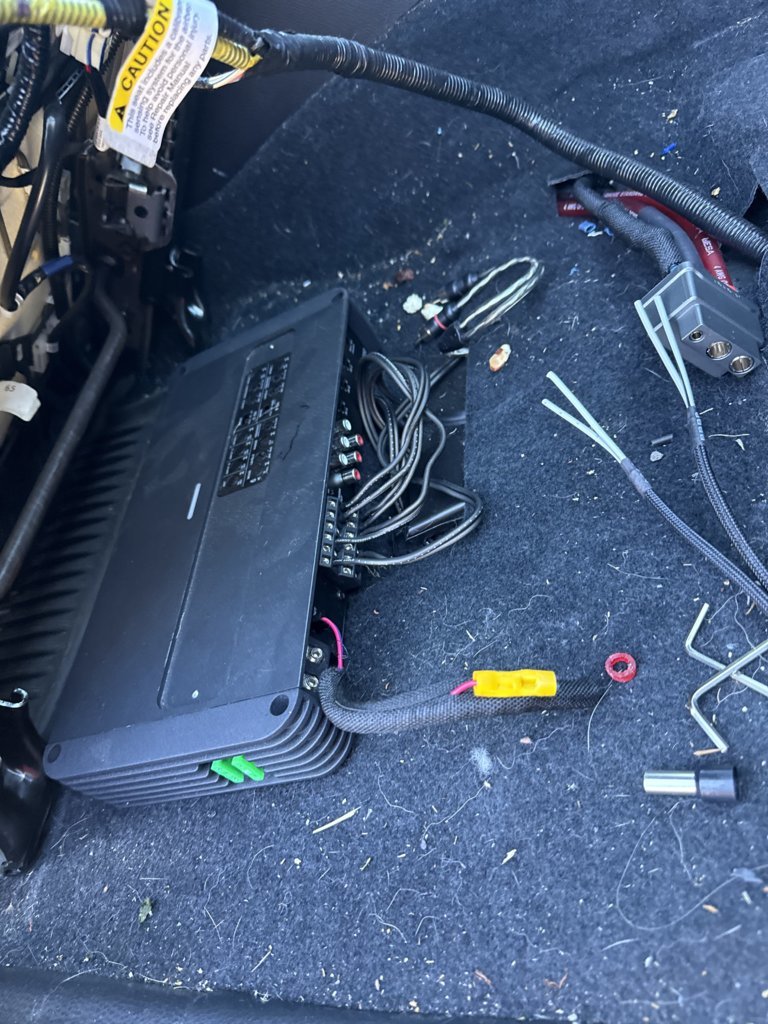

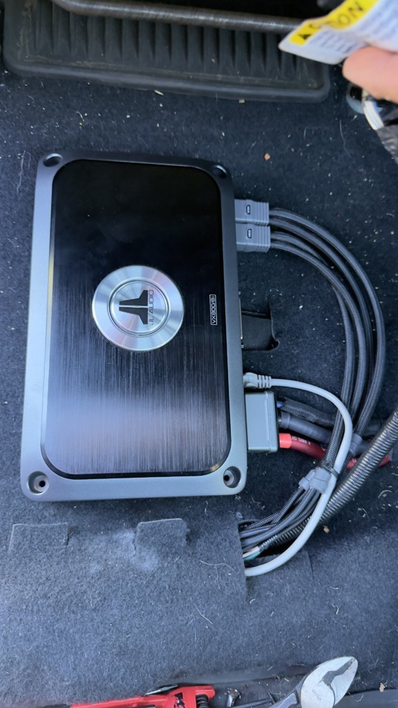

    For Goodness sake!! I wish y’all could listen to the way the VXI 800/8 amp brought up all the speakers alive!!! You can see in the picture the Audison 6.600! 6 channel amp if I was happy the way it sound before I can say I am way more satisfied with the sound coming out of this JL Audio 8 channel beast; there was no need to bridge the channels just 75 watts RMS per channel and the explosion in sound awoke!
    I have not tried the C7 speakers just yet probably next week lol as for now I just want to listen to the difference !!
    Had to connect the VXI 8 channel amp via RCA through output coming out of the VX10005 which is my main amp so had to set up both amps seperately. The people at JL audio customer service kindly told me my previous connection was wrong so after hours of frustration and not saving my work the right way I managed to get sound of the new amp and maintain the settings!
    At this point in time my amplifiers are not!
    They’re not even calibrated nor measured just yet so I can not wait to have the proper tuning completed by a good gentleman Terry and his magic ears he is a very well respected old school tuner I mean even people after paying thousands of dollars they still come to have Terry check their system so just can not wait at this point so will have to be patient for the next few days since O also had to order the JL audio VXI hub to facilitate tuning both amps without desconecting the amps so a bit more work and will be ready for final tunning! I apologize if I sound jerky whatever you want to name me but when sound starts making sense and you can tell the difference you just can not stop playing all your favorite tunes in extasy!! talk to you all soon

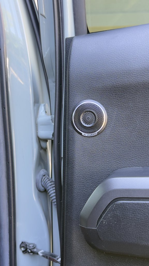

    Yes JL Audio C7s are in and yes I have the hertz legends in the rear doors!!! the thoughts ???
    I hear nice details from different songs I’ve heard before but I feel the precise details of different instruments!!
    I’m happy with the changes!! Oh yes I installed the grill covers they’re beautiful yes to me and no one will notice but I know they’re installed I with a good flash light I can show them through the factory speaker grills
