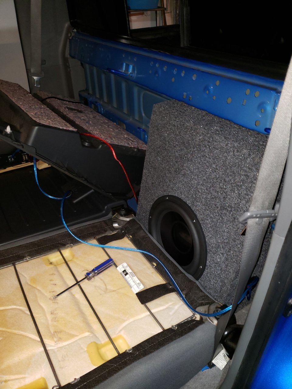

    $60 single subwoofee box from eBay. Dayton audio HO 10inch powered by a pioneer amp. Not booming bass, but certain songs the highs hit amazing..very clean sounding sub for the price.

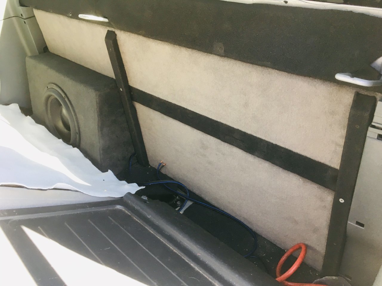

    Yea, loving the HO, went ported first and was boomy. The .70cuft enclosure took up most of the space behind the seat. Was suggested to use .35 cuft sealed box and was blown away. Flat response that blends with the front stage, perfectly.

    I believe the boomy part. It needs probably that much vent volume alone to even justify a ported enclosure.

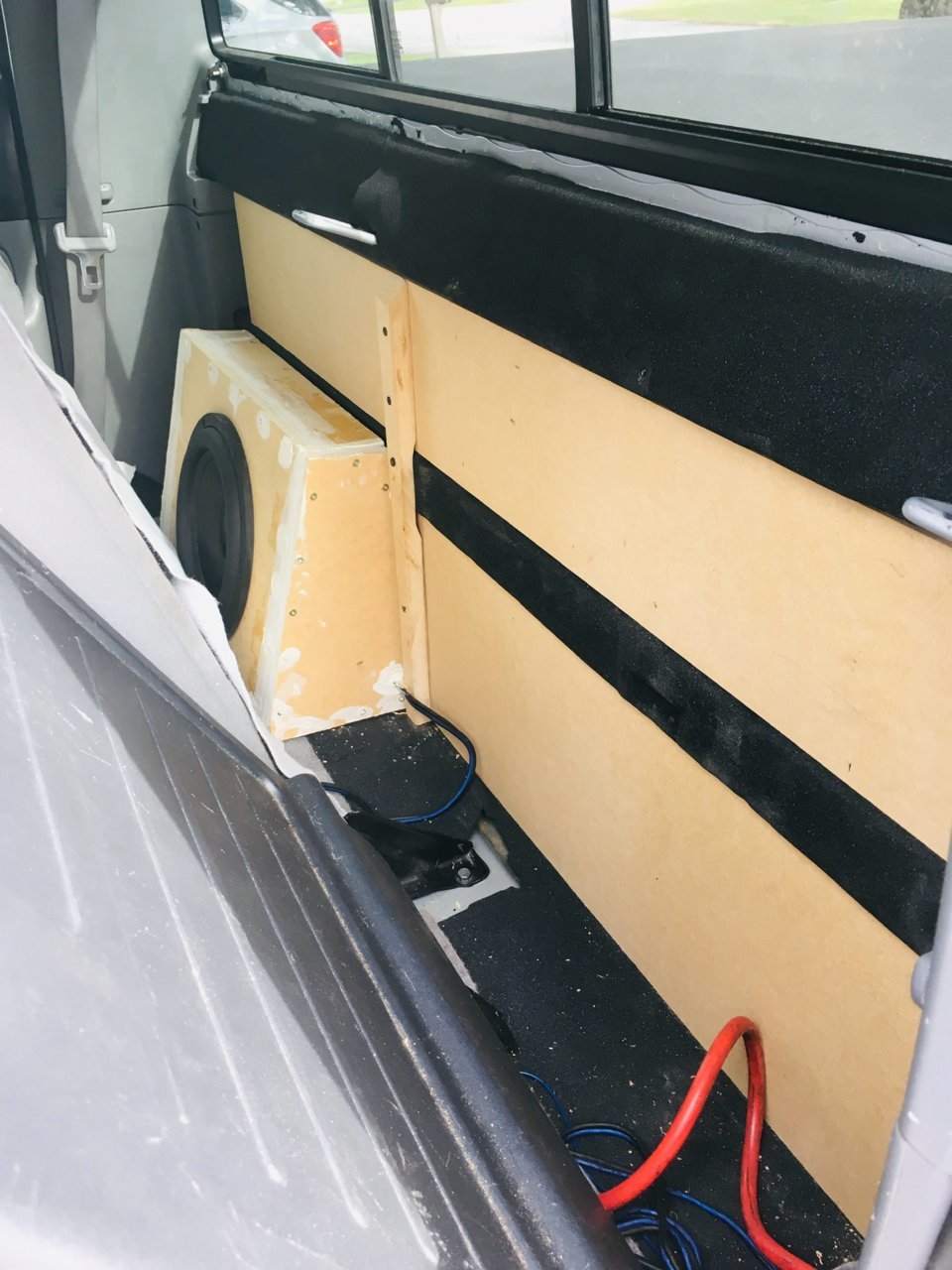

    I don't know this generation truck that well, but it looks to me like you rebuilt that back wall. What all's goin on there?

    CLD tiles then covered the back in ensolite. The black strip down the middle and on top are the exposed ensolite. Carpeted MDF and stuffed in between the cross braces. The black vertical pieces are covered with scrap ensolite and screwed into center cross brace to help hold the MDF, which is jammed in tight and probably wouldnt move.. but..

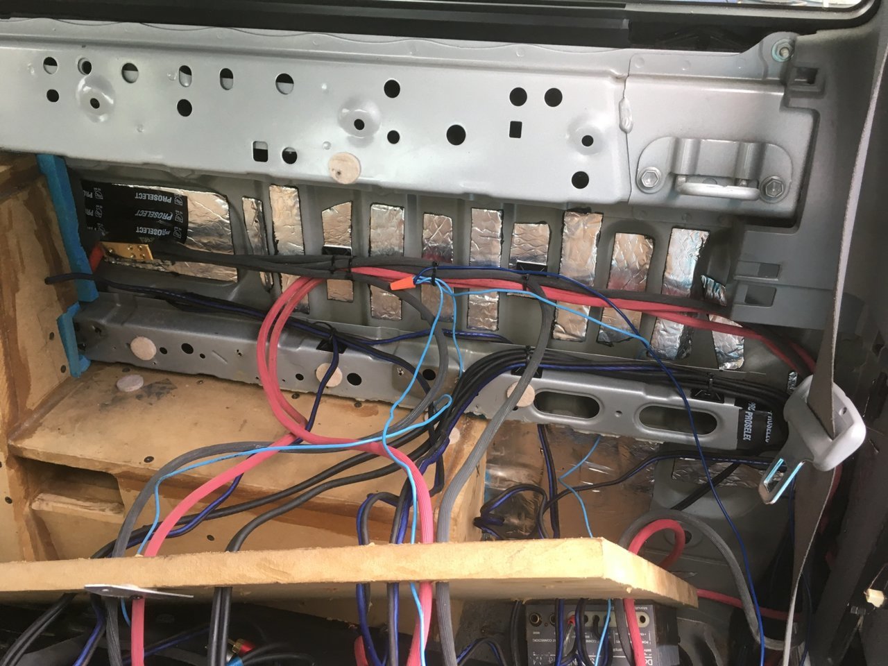

    Here you can see the epic fail. The wrap around slot port that was sticking out the side of the box. Drilled holes in MDF to hide wires behind amp rack. Used foam to help isolate box from back wall. Put it all together and chased rattles like a mofo. Have no idea why i saved the pic. I did learn alot and had fun doing it. Still messing around back there, with a plan to add another HO.

    No fail there at all. Except that one wire nut :rofl:
    Seriously, that's a lot of thought and effort. I love projects like this...try something, don't like it, try something else, learn some stuff along the way. Word up! :thumbsup:
    And mad props for dragging the vent outside the enclosure. Who does that?

    yea man, it’s alot of fun, still use wire nuts here and there lol, way better than sticky electrical tape until I found out about Tesa tape.
    Dragging the vent outside the box, this knucklehead was bound and determined to get that HO ported and in the truck. Spent many hours measuring, drawing sketches, scratching head. Finally figured out material list and made all the cuts. Went to put it together and it was all wrong lol
