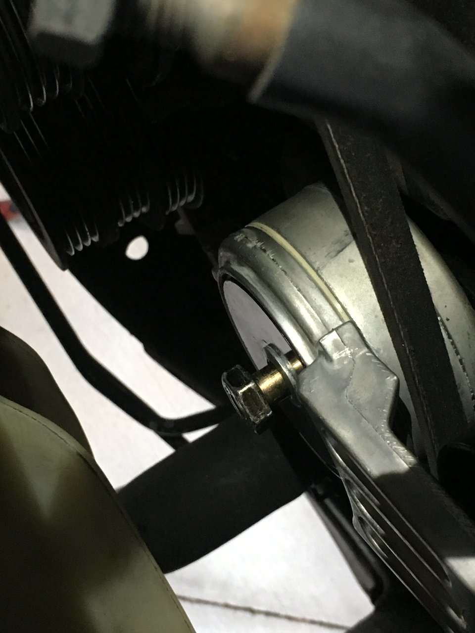

    Anybody else have a hard time getting that bottom bolt on the TRD dynamic tensioner to sit all the way? It’s gets real hard to tighten and it’s not wanting to go anymore. I looked in the hole and it’s metallic on the end so I know there’s no crud In there.

    The tensioner has a tab on the back side if I remember that has to line up with the block or the bolt will not thread correctly. Make sure it's lined up, DONT cross thread it, try the bolt before you put the tensioner on and make sure the belts are
    pre lined up, I think a belt threads in there somewhere before you completely tight it down,
    Jiggle the tensioner as you bolt it down

    I got it. I had to add a 10mm washer. But that bitch is still tight. I didn’t cross thread. It always stared easy and got super tight before bottoming out......I only have the Dayco belt now. I can get Gates belts at work. No problem.

    And you threaded the belt in there? Or you will have to loosen s it all up :))

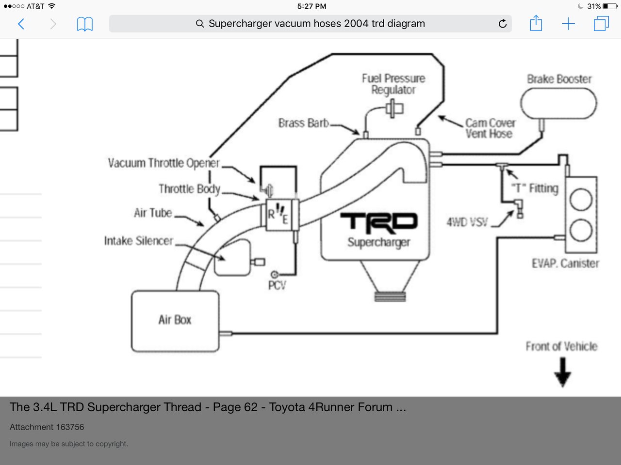

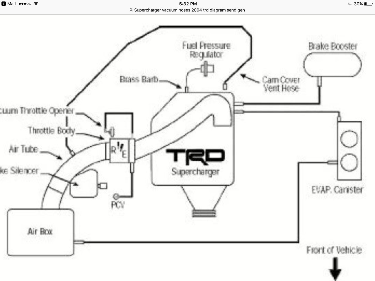

    I do. Trying to figure out where these vac lines go now. Directions aren’t real clear on it.

    Your year and model don't have a lot, google some photos if needed

    TRD S/C, ADS coilovers.
    Well that answered one question. Cap the air box silencer....now I don’t have a fuel pressure regulator so I cap the small barb on the back? And there’s one more small hose coming up from the back that I have no idea what to do with.
