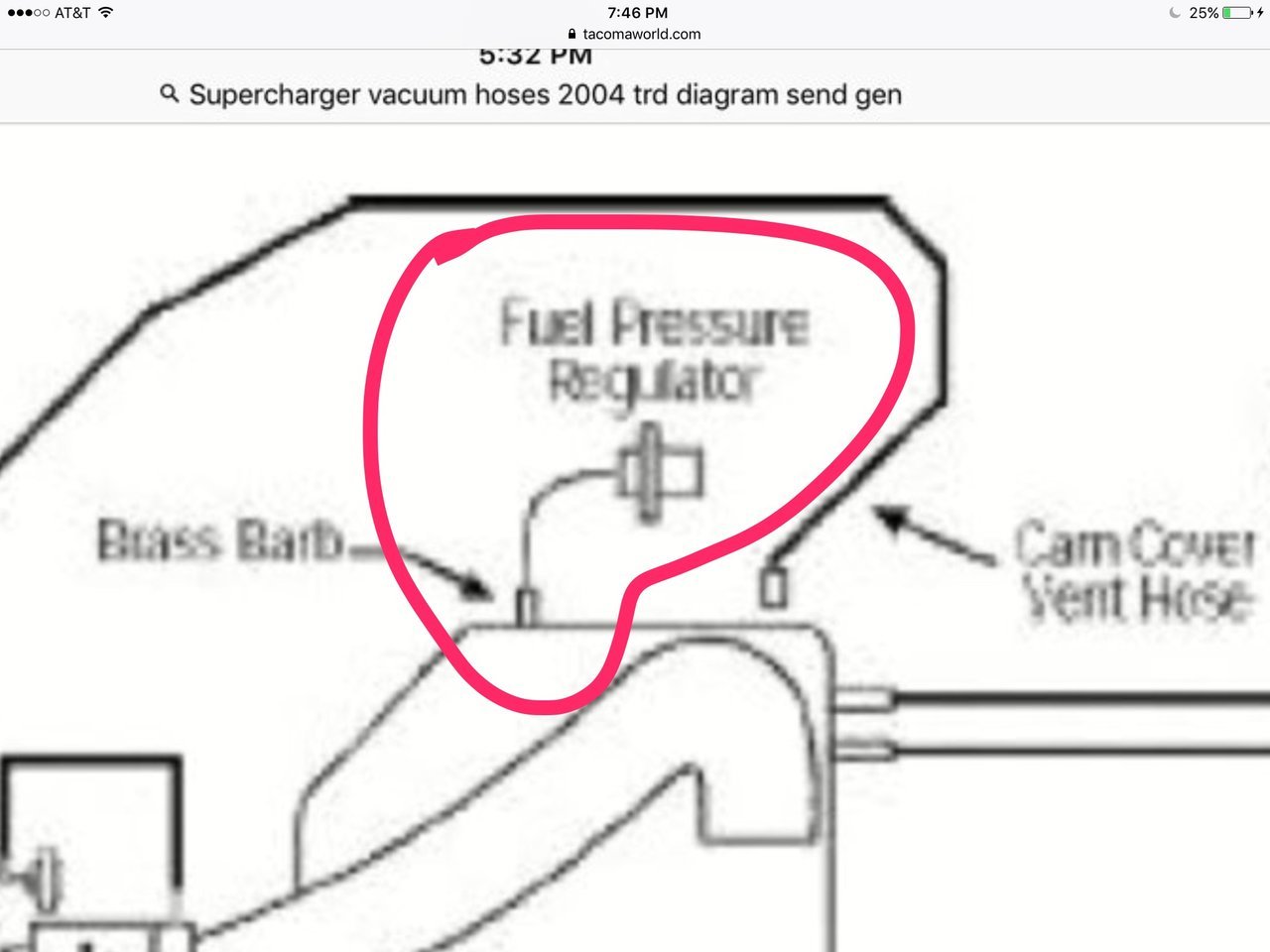

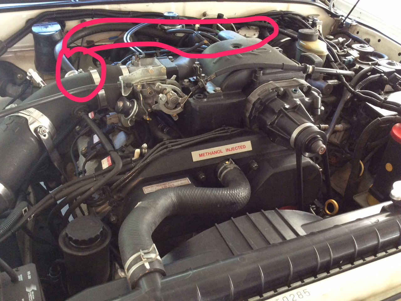

    I hoped the small vac line in the back to this. Pretty sure that’s the fuel regulator?
    It drive fine that I could tell with no problems.86C4C852-83F4-47F0-A5A9-7044849053DE.jpg

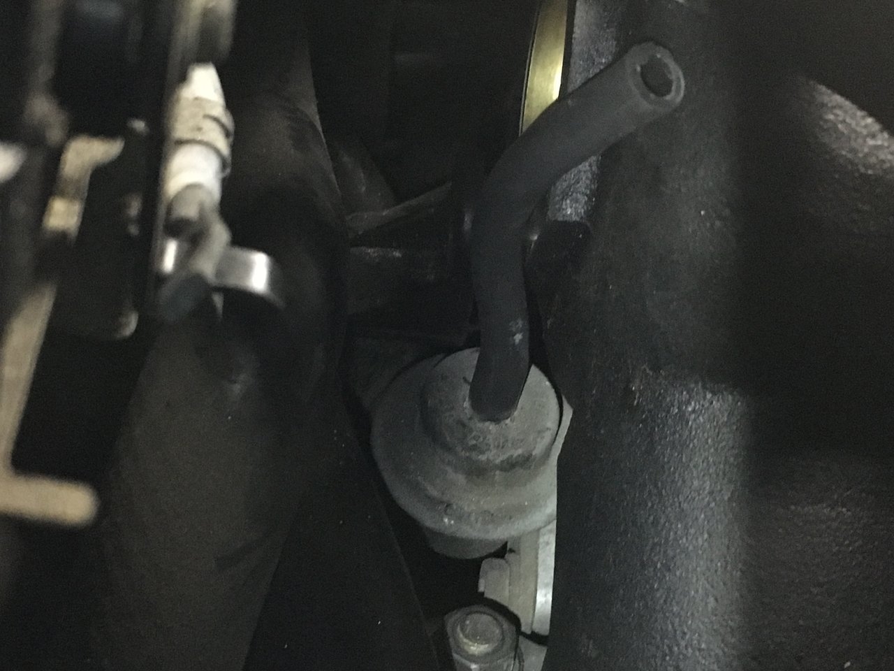

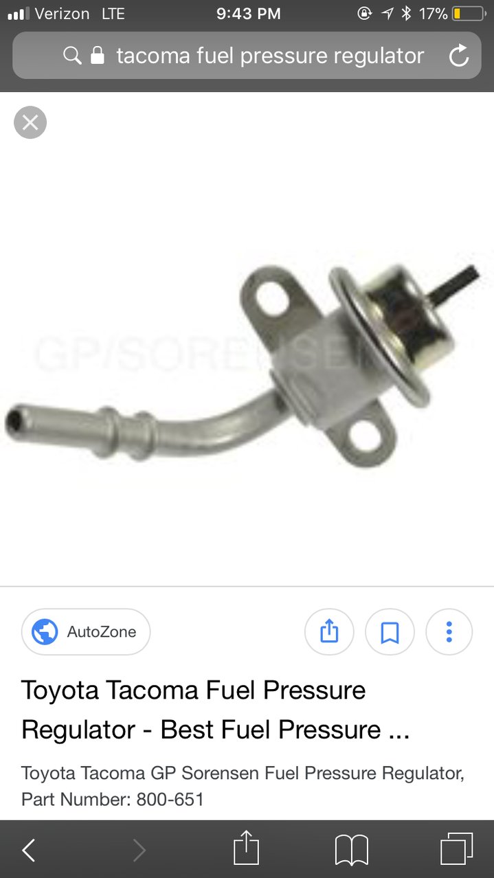

    My truck is older so not sure, can't tell if that vacuum or what, fuel regulator would have fuel going to it,
    So maybe not a fuel regulator

    It is. Toyota must have added it later on.

    Weird. Mine didn’t have any fuel coming out of it....it was hooked up to somewhere on the stock plenum.....
    Maybe someone else could chime in?

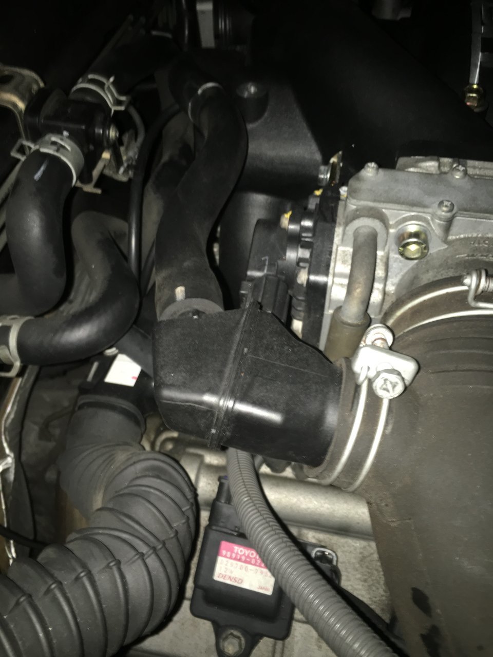

    Yeah. I took the stock little hose off because it was way too short and used a hose the kit come with to hook up to he barb on the back of the S/C

    The diagram shows it being hooked up but maybe it just for vacuum down the line
    for the fuel pump

    That is your Fuel Pressure Regulator. You need to make sure it is hooked up to the port on the back of your supercharger. This is a vacuum line, not a fuel line, so you will not have fuel coming out of it when you disconnect it. This vacuum line sends a signal to the FPR when under boost to increase the fuel pressure to help compensate for the added fuel demand from the boost.

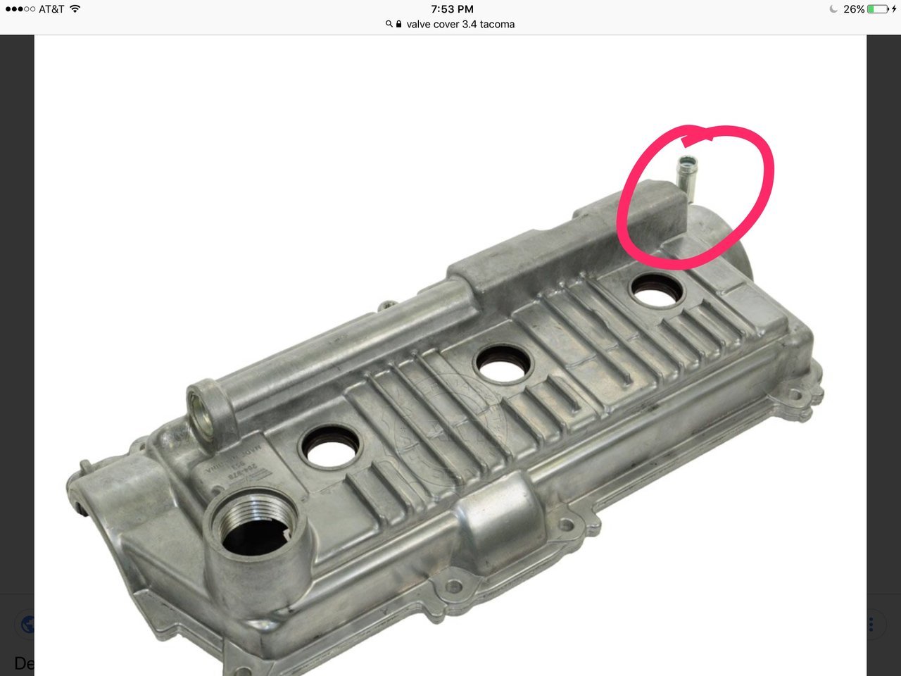

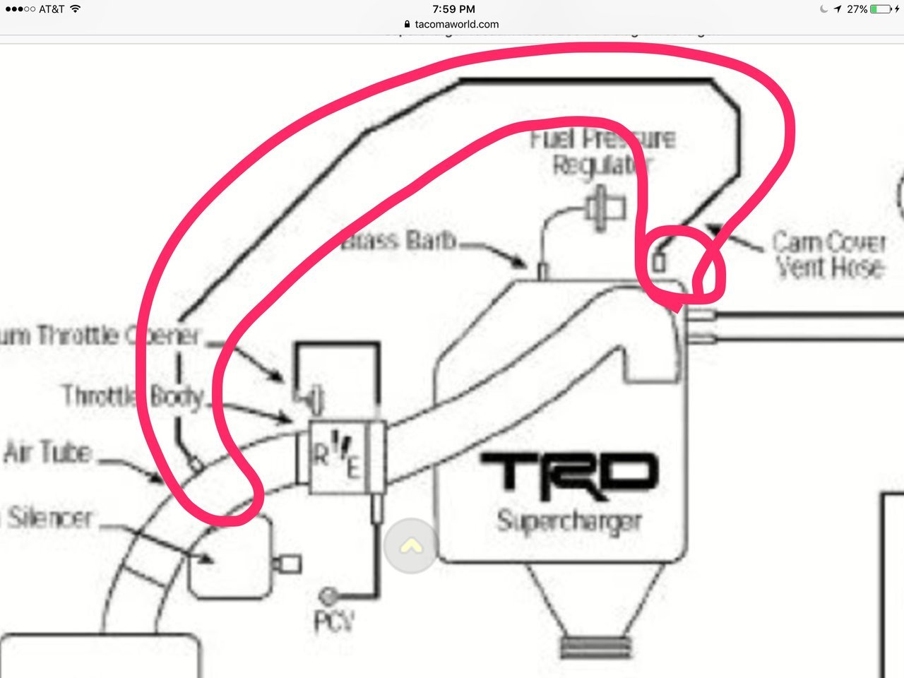

    Still don’t know what that cam cover vent hose is. The diagram shows it apart from the S/C....maybe I didn’t unhook it in the first place.

    Awesome, so I did the right thing. Everything seems to work fine. But I just took it on a short 10 min drive.

    I looked for the hose going to the intake tube. I don’t have one....I should mention that I have the electronic throttle body.

    Oh this is this thing. The diagram shows it further down the intake.94D043B6-7416-4EAE-8D78-B3A0B4CC5132.jpg

    The last thing is the throttle vac opener in the diagram. I capped that off. Pretty sure because I have the electronic throttle body I don’t need it.

    Ok good then, did you connect hose air intake tube to valve cover tube, or cam cover vent

    And did you install the one way check valve????
