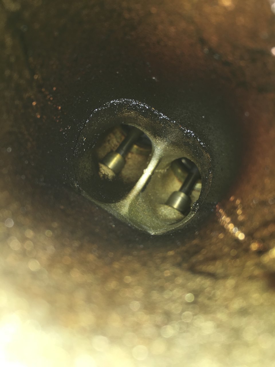

    If I do have ping its very little. I haven’t noticed it yet. I also got the MotorVac carbon cleaning service. To try to reduce any ping I’d get before I did the S/C
    Here’s a pic of one of the intake valves after I removed the plenum. It looks like it did a okay job of cleaning below the injectors.....I have no idea if this looks good or bad for 109000miles.....previous owner did not baby this thing at all.
