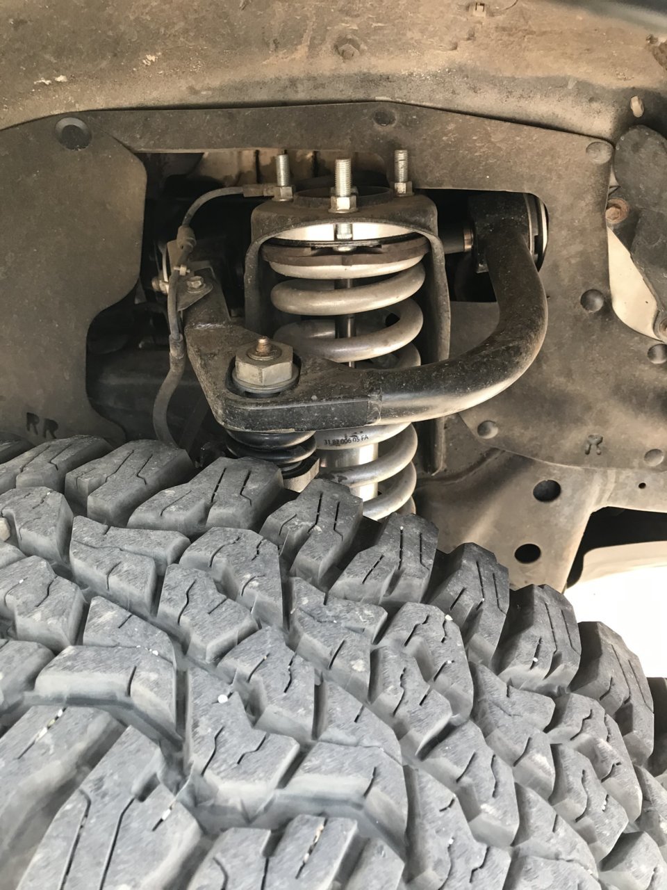

    Want to get some feed back on how people think my set up looks.

    4x4 or Prerunner? Front lift looks awful high for a 4wd, would be curious to know what your cv angles look like at that height (if you have them)

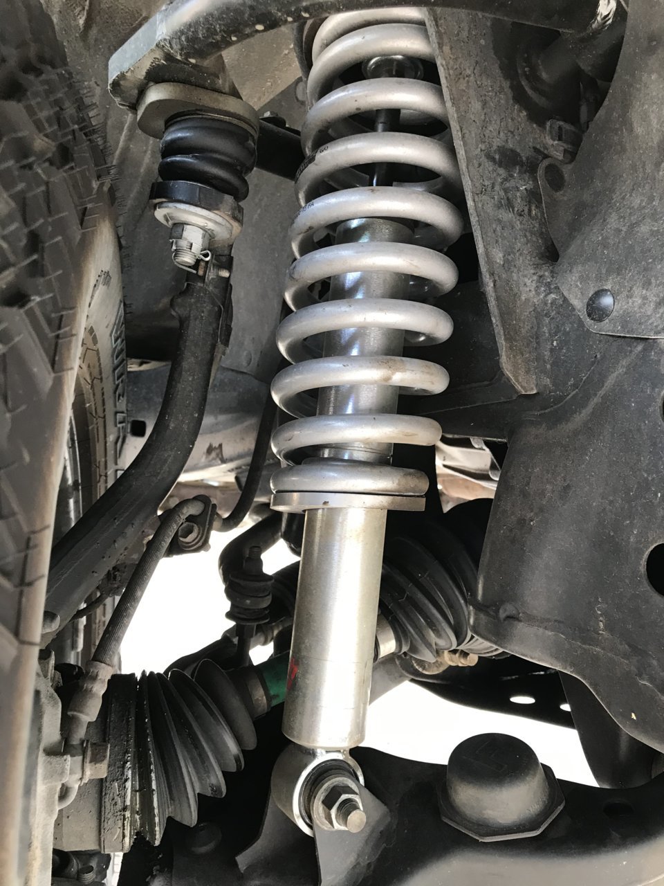

    Yes, it's a 2000 SR5 Limited Pickup 4x4 with rear lockers. And yes the cv angle drops very low to the tire. I have already replaced the boot once but I have noticed that the new one is already getting quite worn. What is the fix for that?

    Lower the front end lol. That's the best way IMO because high angles also compromise the integrity of the axles themselves (not just the boots). I went through so many blown boots before I lowered the front to 2" and they stopped.
    There are also high angle boots you can try, and even high angle CV axles that O'reilleys sells now. Or the boot slide mod

    Also here are some pics for reference.

    And yeah your CVs are wayyyy too angled, that's gonna have to come down to fix that

    Holy fucking shit (is what your cv axle boots are saying).
    Get rid of some lift.

    Gotcha, My coil overs are not adjustable though :notsure:

    Yeah, gonna have to get new springs for those shocks to bring it down. Something OME 881s or 882s would be good.

    Just pulling the spacer off the top of the shock will help

    true, I didn't notice the spacers. Those are what, 1/2" spacers? So they would be giving you 1" of lift...I would pull those off first and see where it sits.

    True I forgot didn't know that the top spacer came off
