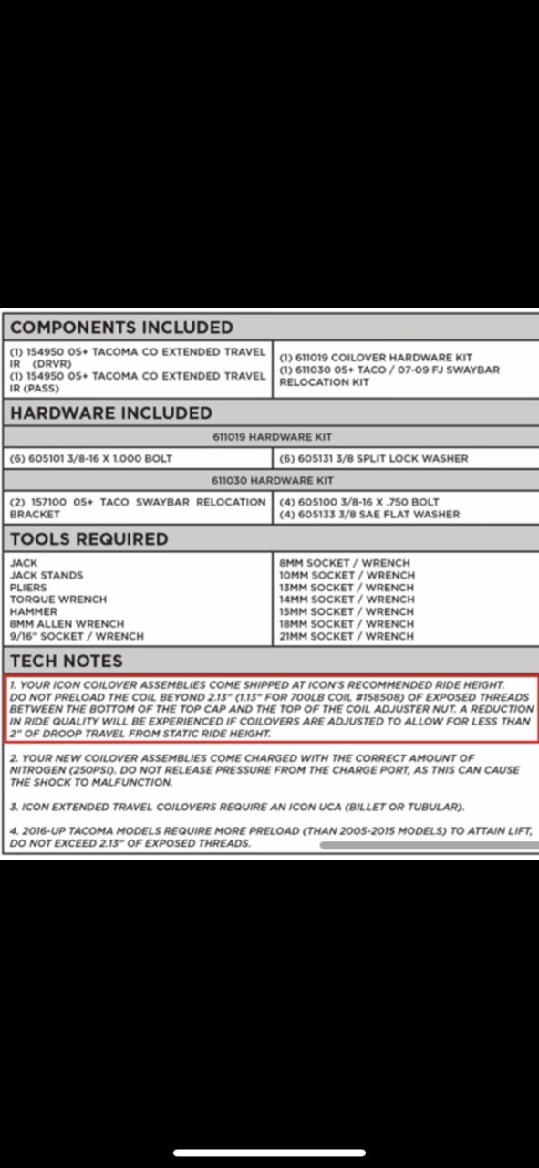

    Where are you guys on height of your coilovers and what size tires can you fit. I currently have it under 2” and some say it’s to high but I seen the tech specs and max is 2.13”. Have you guys had any issues with CV’s this high? I have 265/70/17 but I want to put 285/70/17 or a 295 with rubbing but don’t know how high of a tire I can go up on my 2013 Toyota Tacoma

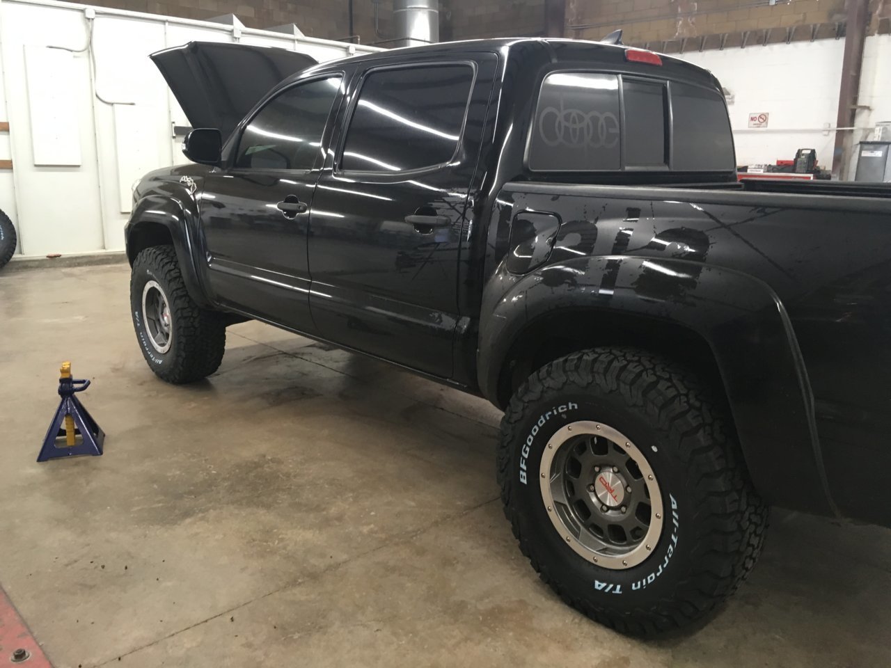

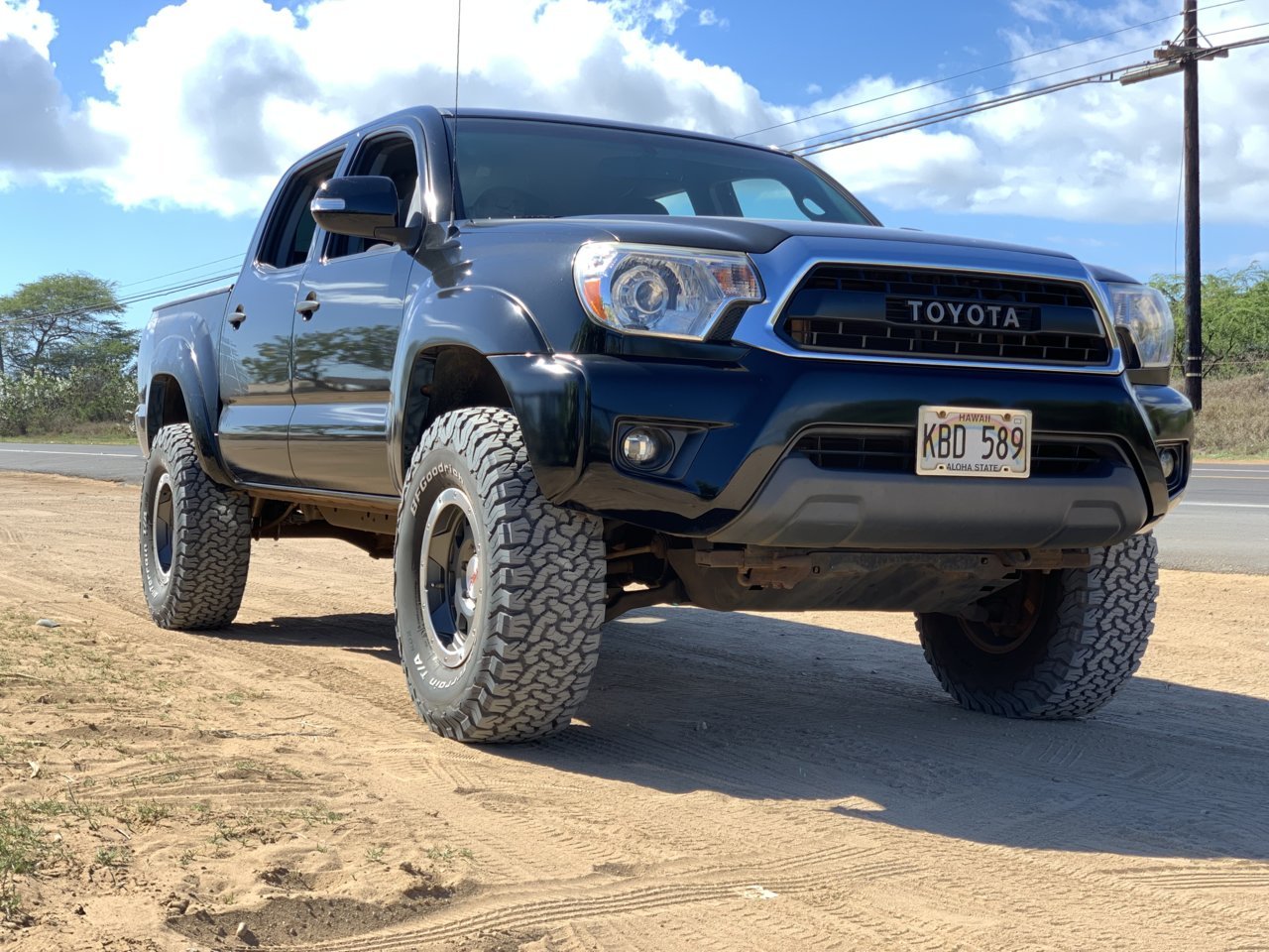

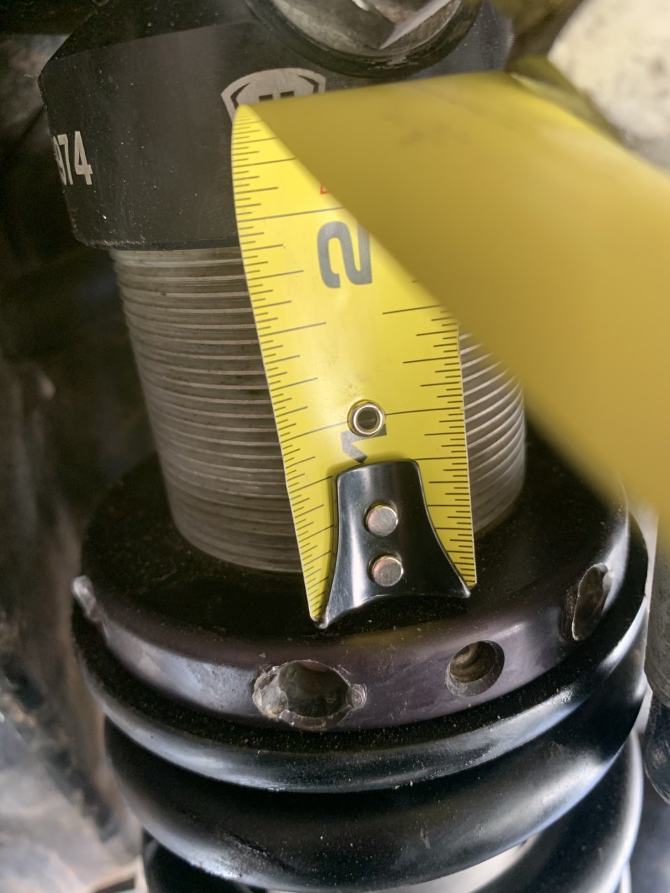

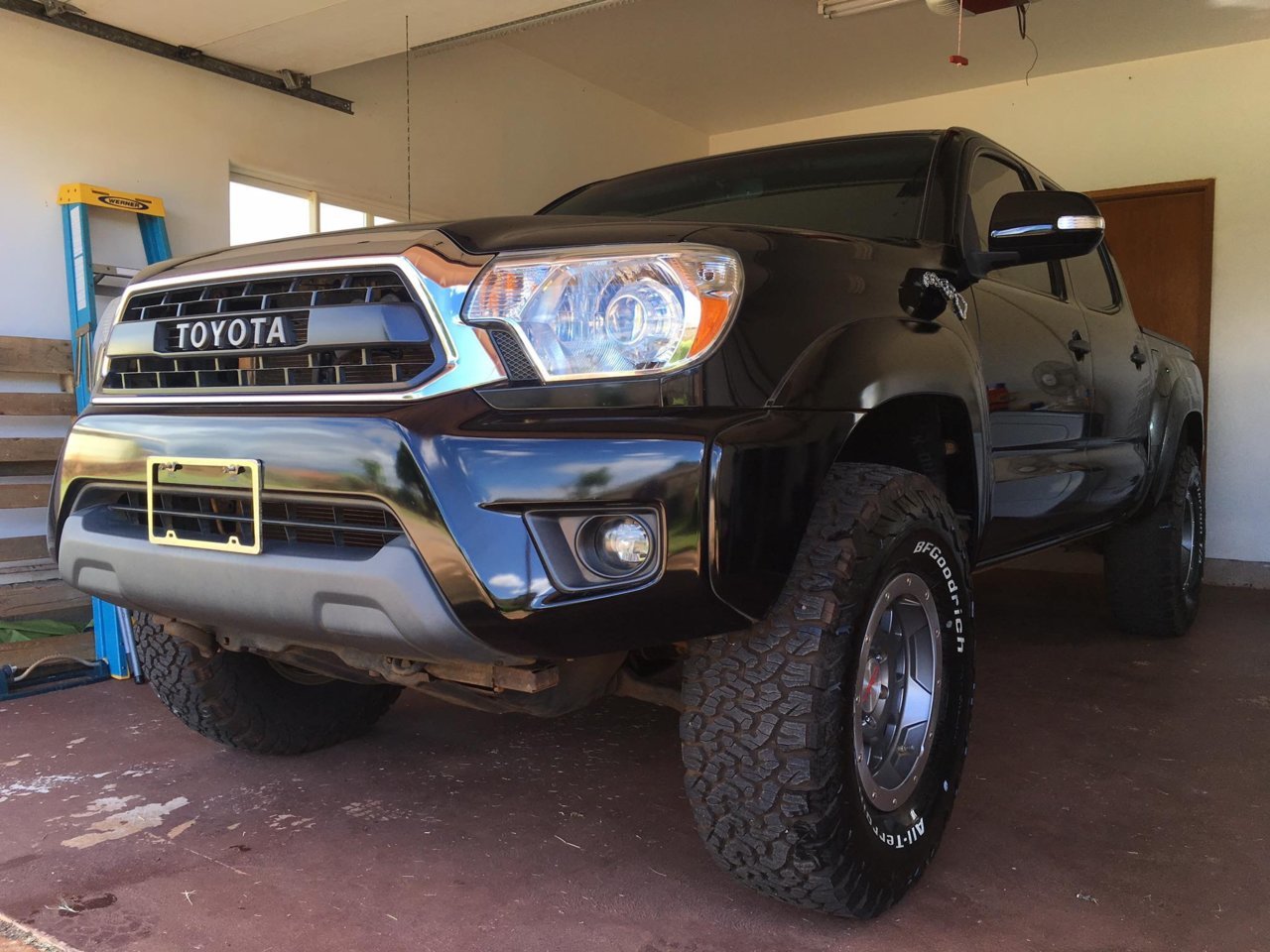

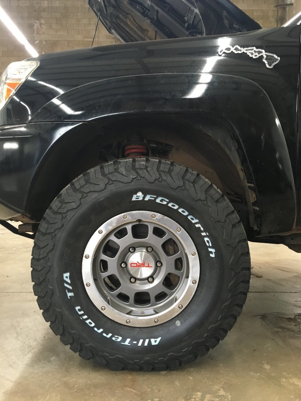

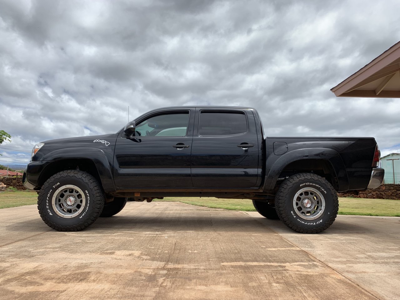

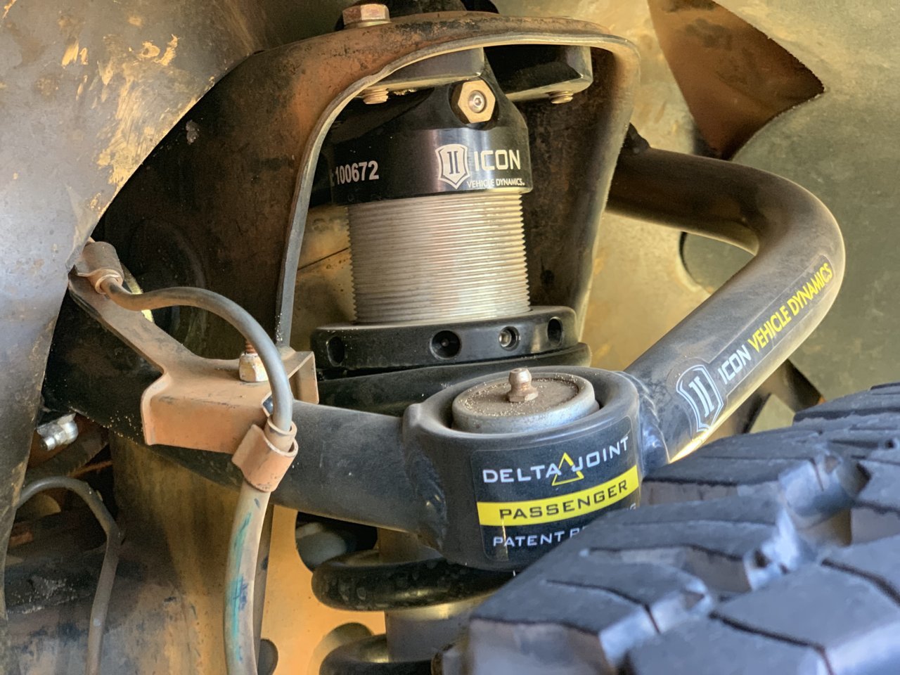

    The 1st suspension setup I had when I swapped out the Baja Bilstein’s was Icon 2.5 coilovers, RXT leaf pack on Option 1 and RXT rear shocks with remote resi’s. On the coilovers, I had it set to show 1.75” of threads on both the driver’s and passenger’s sides. I wanted the same amount of preload on both sides. That yielded me from center of hub to bottom of fender 23 3/8” driver’s and 23 1/2” passenger’s. It took a while for the rear to settle but it was ass high as expected. I can’t seem to find my initial measurements, but now it’s final settlement is 23 3/4” driver’s and 24 1/4” passenger’s. Here’s a couple pics within a couple months after install:

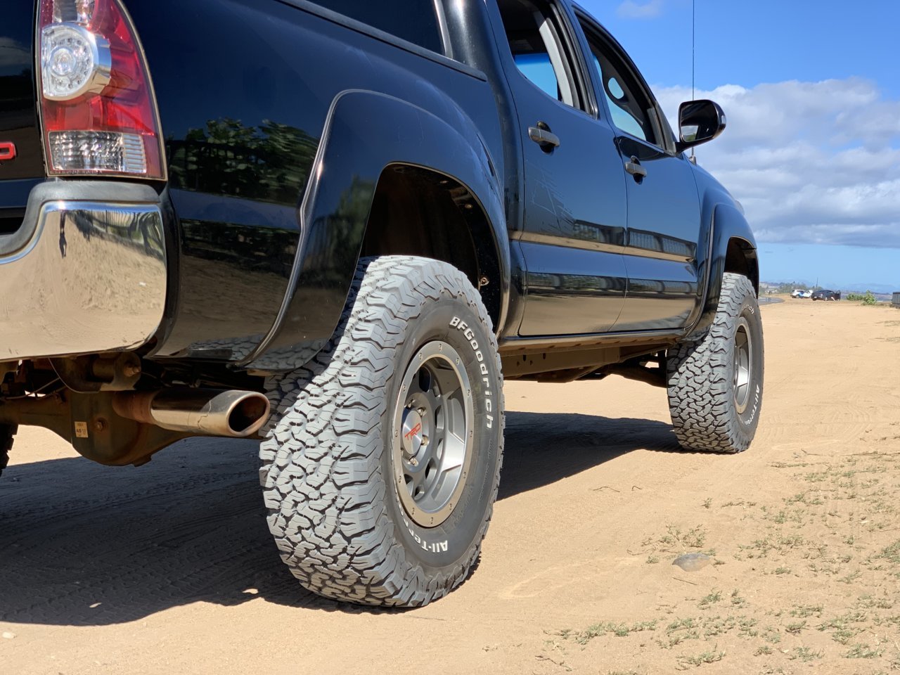

    Also, you mentioned about wanting to upsize your tires. I have 295/75R16 BFG TA KO2’s which I was able to fit when I had my stock Baja Bilstein’s. Regardless of “lift,” modifications are required: CMC, flattening of the pinch weld, trimming bottom corners of flares and trimming/replacing/removing the inner fender liners. Alignment plays a big role as well. Providing I don’t do any rock crawling. I drive on sand and dirt roads that have good dips. Only way to know where to trim regarding flares and liners, just take it offroad where you normally would go. Turn the wheel at full lock, forward and reverse, drive like you’re just learning to drive, take dips a little fast lol. Here’s proof for your pleasure(first 2 pics were when I first had it mounted, as you’ll notice my flares were not trimmed at the bottom yet):
    Regarding CV angles, they will be pointed down a bit but are still operable. I have a different setup now and it’s a fraction of an inch higher than the Icon’s, but my inner boots are not touching at ride height. That’s the main concern.

    You’ll likely still need to do a CMC. It might appear to be in the clear when turning the wheel side to side on flat ground, but there’s a good chance that’s where you’ll rub under compression and dips. And just make sure when you go for an alignment to have the tech increase the caster to get the tire away from the cab mount

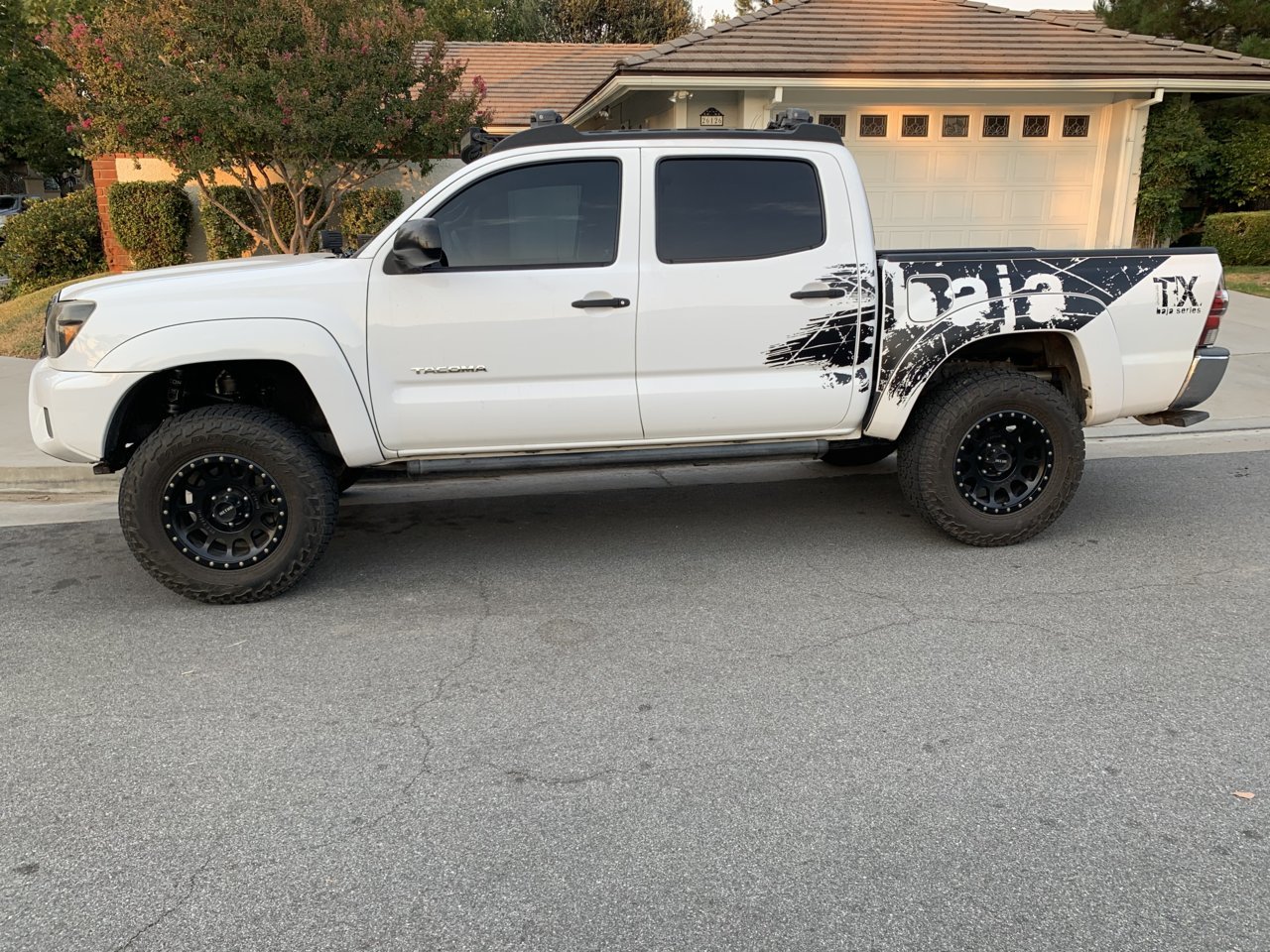

    Here’s what my truck looks like now with the new icons and leaf springs on 265/70/17
