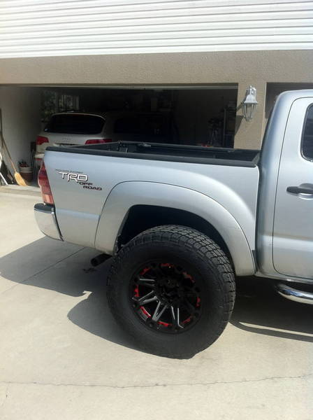

    Anyway, I purchased a 06 DC 4x4 TRD Off road, did some research on here and ordered up a 3" lift from toytec w/5100s, currently set to arrive on the 2nd of March *excited dance*. The wheels and tires came in yesterday (see pic below).

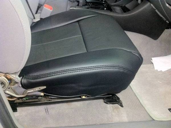

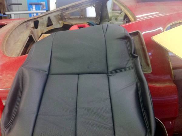

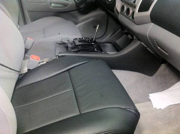

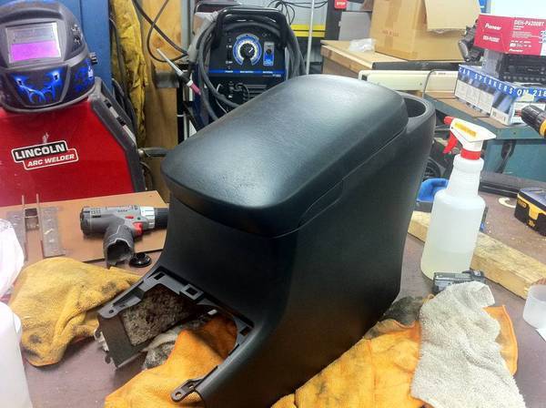

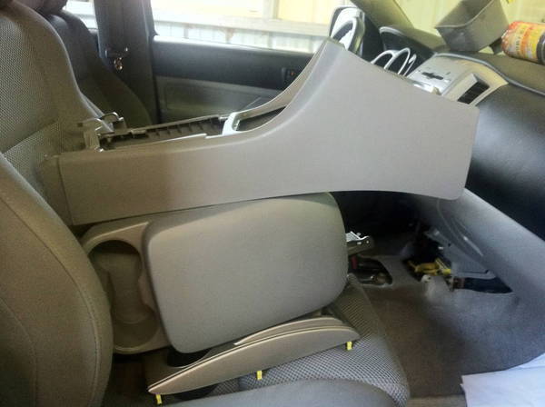

    I have big plans for this little rig; I started today with the color change in the cab from grey to black, this will be on select panels. A full Black leather seat kit (arrived today) Looks amazing! I pulled the center console out and some of the trim on the passenger side to do the color change, I got as far as 3 coats on the center console and had to quit painting. I then opened the leather kit and was able to get the bottom seat trim pulled off and installed the leather; looks, feels and smells awesome! I had to call it a day real early but not until I snapped a few teaser shots. Please enjoy and stay tuned.
    Last time this is going to look this way.
    Removed the center console, next step prep for dye
    One of the leather panels
    After 3 coats of dye
    Lower leather seat on, all trim removed
    Just threw it in there to get a glance at what it's going to look like, very happy so far.

    Nice wheels I haven't seen too many guys with jesters on here.

    So, you dyed the center console? Any chance you could elaborate on that?... On a different note, looking good :D

    What kind of paint are you using too?

    What did you use to dye the console? I need to redo my passenger dash, got scratched and removed paint/die..

    Thanks, yea they really caught my eye when I first saw them.
    I'm just using Duplicolor vinyl/plastic dye. Normally i'd have some mixed up at my local auto paint store to match exactly but This is pretty close to the shade of the leather seat covers so I went that route from Advance Auto Parts.
    Make sure you clean all impurity out of the panels with some mineral spirits and/or denatured alcohol which pulls all the chemicals out of the panel and leaves a good prep surface for the adhesive promotor, Dupli-color is what I'm using also this time around. Apply several coats...well just follow the directions on the cans after you prep the trim pieces and panels.

    i like the leather. katzkins? i painted some of my interior pieces with duplicolor vinyl and fabric. comes out good, but can wear. i did the controls on the doors and my double din surround. there were wear spots after a while. just wanted to give you a heads up. might wear on the center console armrest. none the less tho, looks good.

    Yes, and I've dyed plenty of panels in the past however this is the first time I'm using the Duplicolor. I wanted to give it a shot and see how it stacks up to the real stuff. I'm hoping that with the proper clean and prep it will keep. Oh, and the leather kit comes with a piece just for the armrest on the center console. :p

    ya, i did the proper prep and clean. the dye/paint didn't chip off or anything, it just faded to a dark charcoal in high traffic areas. hopefully it works out better for you. glad to hear that the armrest it getting leather as well. are you going to dye anything else?... say door panels, stereo/vent surround, lower dash piece where the 12v plugs are? just curious.

    What is this dye process? Never heard of it.

    LOL, you must have read my mind. I was typing while you were posting (see above response). But I think I'm going to have to have real dye color matched for those areas and use a gun. The vent areas are too adjacent to have colors not match exactly. You know?
    I haven't had any dyes fade on me yet (knock on wood) but like I said, that wasn't stuff out of a can, I'm just going to give this a go and see how it holds up. It's worth a shot if you know how much custom dye costs to mix up. :eek: LOL
