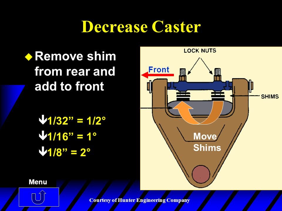

    Does the new UCA's move the tires outward?

    I forgot what Caster adjustment was. Been to long.
    Can shims be added?

    Shims for what

  11. Oct 30, 2021 at 5:53 AM

    Not sure what those are for but no shins are not needed

    I wasn't sure if your application, shims were needed. I guess not.
    I'm not sure how to word, what the shims are for. As a guess, inward and outward tilt of the wheel.

    Caster cant be directly adjusted, you have to adjust your camber to get the caster where you want it, which is done with the lower control arm bolts (eccentrics), or cam bolts as a lot of people on here refer to them

    Are their different way of adjusting caster from, front wheel drive, to 4wd, 2wd, AWD?
    I think this picture will show what I'm thinking about.

    That looks more like an old torsion bar setup from the pic. I'm not super familiar if there was anything special to do with those
