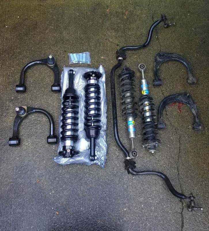

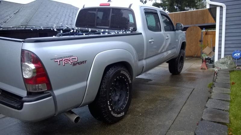

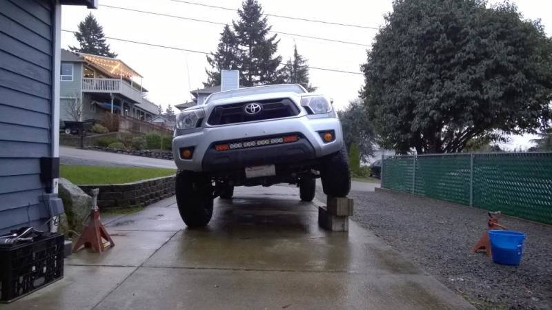

    Out with the old, in with the new. :) The Icon bits are significantly beefier than the old stuff.

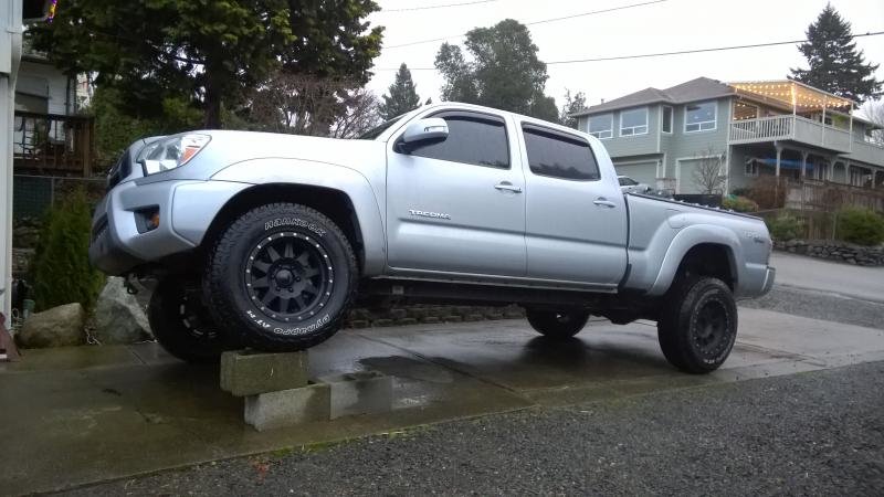

    Almost have the front suspension adjusted to where I want it. I'll let it settle for the week and then fine tune the stance this weekend.
    I live in suburbia, so I had to improvise when testing things out. :D
    The truck drives significantly better now, MUCH smoother. I tried it without the front sway bar in for a bit, but I didn't like how floaty it was, so I put it back in.

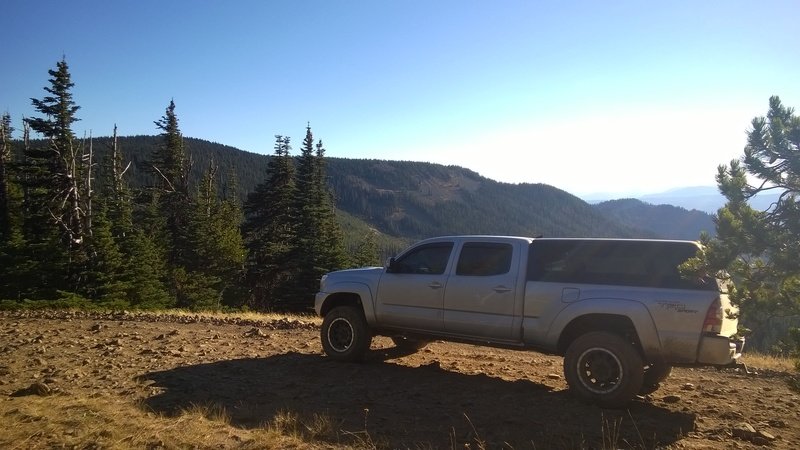

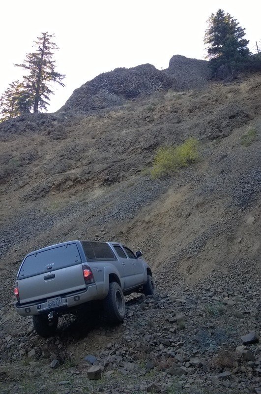

    The wife and I decided to go play in the snow this weekend. The truck did great.

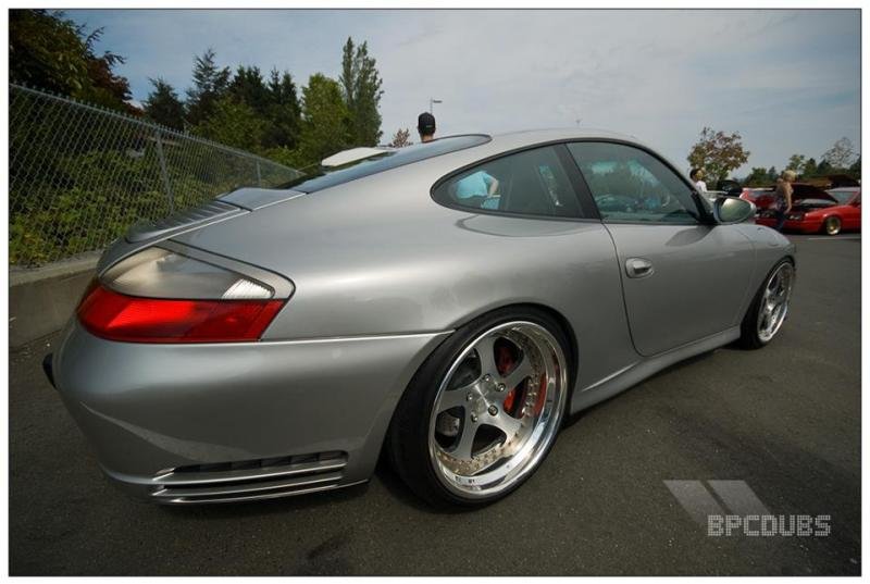

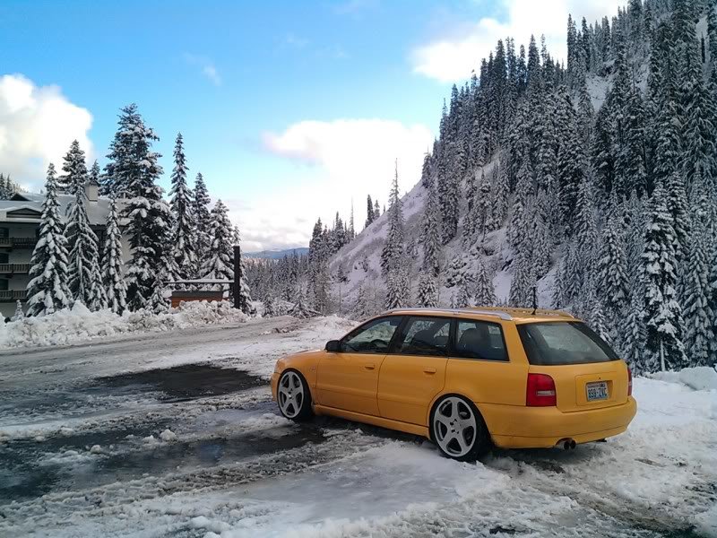

    Here's some of my old cars:
    MkII GLI:
    Steveo, I recognize your user name from Vortex. No, I'm not Dmoney, I bought the car from him.
    My old B6 A4:
    M Roadster:
    B5 S4:
    B5 Passat:
    Some more of the 911:

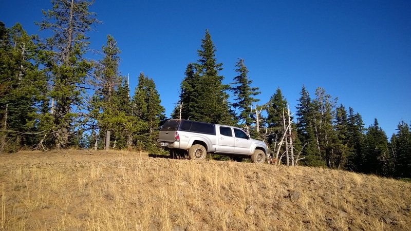

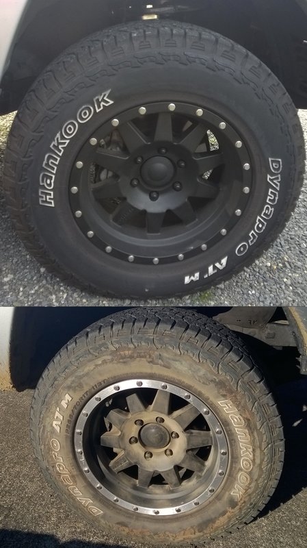

    Wow, been awhile since I updated this thread!

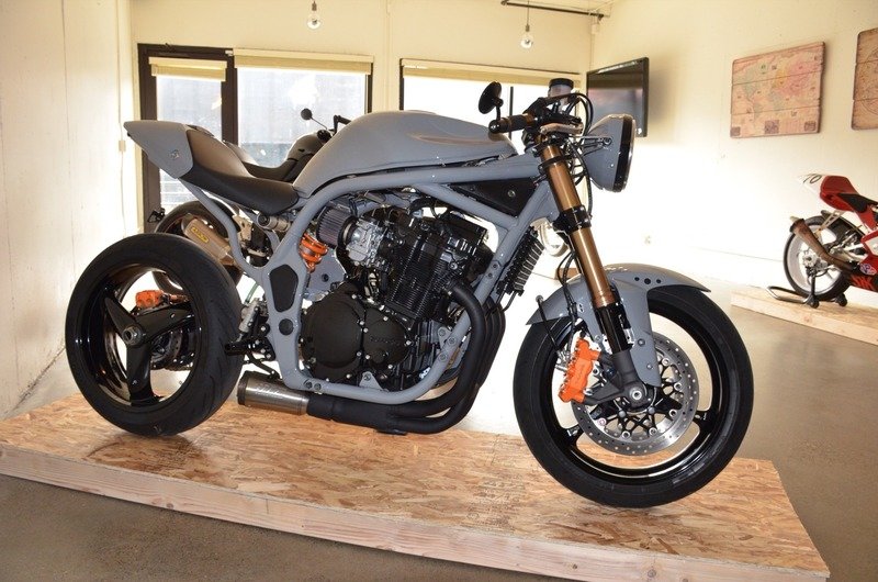

    I haven't done a whole lot to the truck since installing the Icon suspension (besides adding the canopy and debadging it), I've just been enjoying it for the most part (also, most of my spare money went into finishing up my project motorcycle).
    I haven't had as much fun with a vehicle as I've had with this truck in a really long time. There's nothing quite like getting out of the city and going and exploring the wilderness, which Washington has a lot of.
    However, one thing I've never liked about the Method wheels I have on the truck is the fact they're all black. So on Saturday I took a couple hours to grind the powdercoat off the lips and give them a brushed finish.
    (I probably should have taken the 'after' picture before I got them filthy on the trails yesterday...)

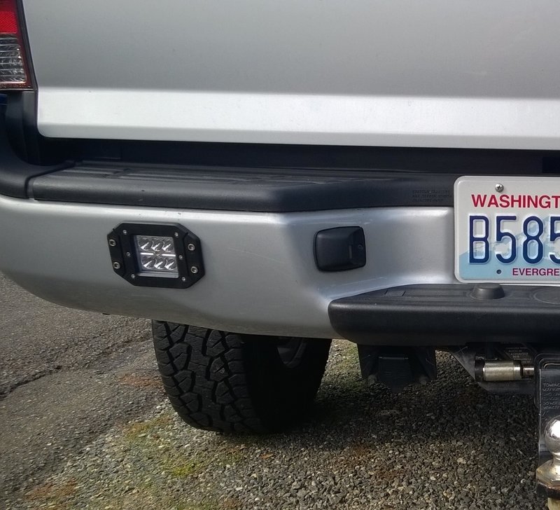

    Oh yeah, I also added some flush-mount LED lights on the rear bumper.

    How easy was it to cut out the bumper for those lights? Did you just use a dremel or something similar? I really want to do that to my truck because the reverse lights are shit.

    It wasn't too bad, just a little time consuming. It's definitely a great example of a time where you want to measure three times, cut once. I covered the rear bumper with two layers of masking tape, then made templates out of index cards. You need to be sure put the lights in the correct spot on the rear bumper or else you'll hit the trailer hitch (don't forget you need to get your hands in there to put the nuts on the bolts, too). Once I was sure I had the templates where I wanted them, I drilled a hole in each corner and used a jigsaw with a metal blade on it to cut it out. After that, I fine-tuned the fitment with a file. I drilled the holes to bolt them in as a last step. Then, I painted the cut edges with some touch-up paint to protect them from rust.
