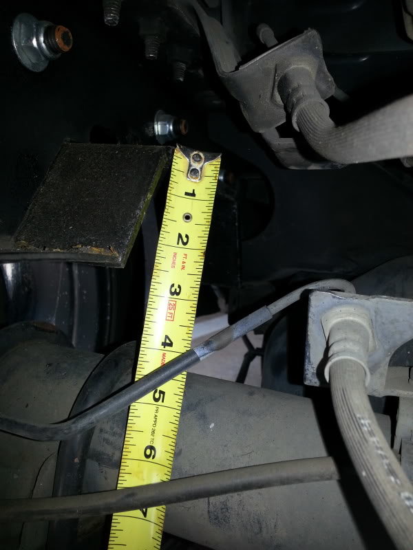

    Lmao classic. Thanks! I think I just got done running her through the wash! Chee catch you next time! Oh and finally measured clearance. Bout 4-1/2 inches clearance with the 2 inch blocks

    RAJAH!!!!!! Thanks maybe that really gives me a good idea of my clearance I'll prolly be like 2" of clearance after said and done hopefully with my drop shocks keep me from bottoming out so I'm low and smooth

    :O I want me that 1.5" clearance :D!!!

    well guys as soon as i get those blocks in ill only have 3-1/2 in clearance but thats plenty. The real test is throwing the bike in the back 450lbs or so!

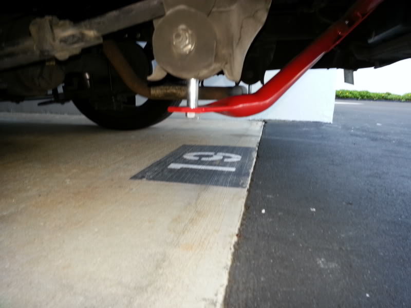

    So i was using these crappy bushings with my x brace which was working a little when i had it tight but when they were really tight they were squeaking insanely so, i just loosened them and forgot about it for a while. I found some steel spacers that fit around the bolt and allow me to attach the x brace solid and tighten it down. NOW i can feel it working. Gotta say tottally worth the 200 i spent on it. Huge improvement in handling, suprisngly better. Super stoked!!!!!

    w00t! Glad to hear it wasn't a waste of your time. That thing hangs really low... looks like it's lower than your tailpipe? Can it be adjusted to not hang so low?

    definately not, honestly if you guys find one on craigslist(rare!!!!) grab it cuz its an easy pretty much bolt up mod with a huge improvement. Nah its not that low i think its just the way the angle of the picture looks. Its the same height as it would be on an x runner, never scraped it yet, think the tail pipe is lower too. Its clear!

    i used the energy suspension sway bar end link bushings. kind of a rip off at oriley's (they're $30 or so) but it works.

    Yah i tried using those, mine were just the poly bushings from the same end links but when i tried to tighten em down i got all these creaky sounds every time id turn lol. i looked at the x runner and they got that bracket which is solid so i know theres no flex to it. I figured my steel spacers would be closer to that effect then the poly bushings. I feel it works way better now! I wanna get some spacers with a little more meat outside cuz these just fit right around the bolt, but im not in a rush, these are working extremely well!

    gotcha mines are absurdly tight rofl. i was able to find a bolt that was the perfect length too, so that helped.

    that extra squeekies is coming from the bolt up top. I had a peek at my leaf hangers/perch, there's some room for another bushing there but you will have to cut it down some for it to clear. but it's possible. also don't tighten it so much. I learned the hard way (was tearing up bushings left and right!!!) that your not supposed to tighten them so much or they will tear NASTY, enough where you have to buy new ones.

    That's why I like this steel spacer. I just cranked it down nice and tight and called it good metal on metal, no movement no flex, they are now one lol
