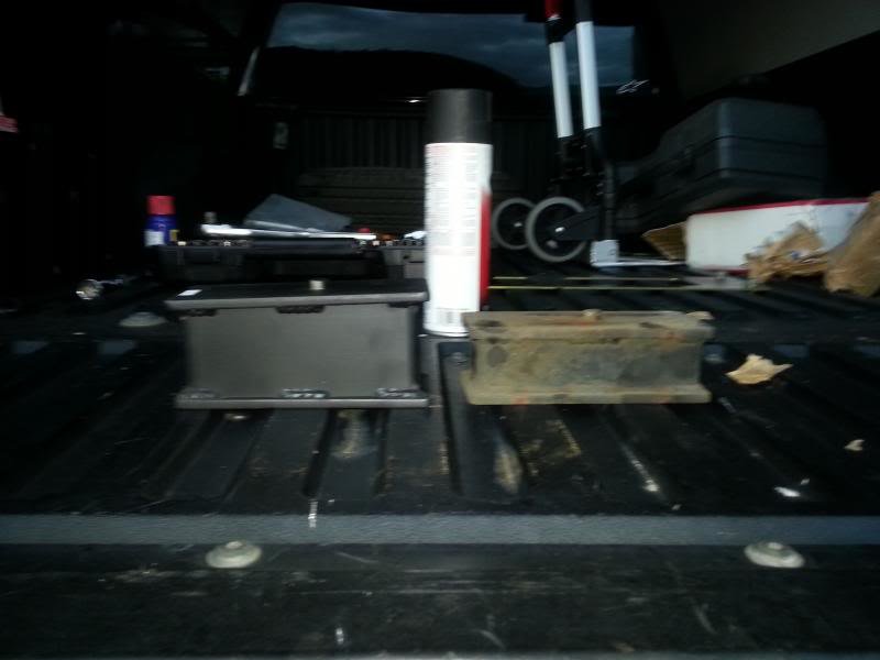

    3 inch beefed block tapered with offset pin and 2 inch beefed block with offset pin.
    New 3 inchers are in!
    yay leveled

    Beefed Taco 3" Lowering Blocks DJM 3" Front Lowering Kit Custom C-Notch Intermittent Wipers LED tail lights
    Nice! Going to need a full body shot though to see how she sits now (so I can see how my truck is going to look with 3" blocks as well :D ). Looks like your truck also has "rustybrakedrumatitis". I got some high temp paint to paint mine... I sure hope it lasts more than one winter, unlike the last time I tried painting drums :(

    lol i should paint mine too. just sprayed right on?

    That's the plan for me. I plan on grinding the rust off first, using some rust inhibitor on the rusty parts, then painting. My local parts store had VHT high temp paint... probably necessary since brakes can get hot. I guess time will tell if that's a good plan or not.
    BTW, I highly recommend buying some anti-seize from your local parts store and putting it on the surface where your wheels meet the brake drums. If you don't, the wheels may seize on. I literally had to use a baseball bat one time to remove the aluminum wheels on my last Tacoma because the aluminum bonded to the steel brake drums.

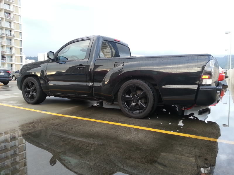

    Alright heres the final stance. Djm arms up front and 3 inch tapered beefed blocks with offset pins sitting on 4x4 leafs held down by 9/16 race grade u bolts. Leveling out instead of ass up has definately improved the look and ride. Im sitting 15-1/2 from center to bottom of fender all the way around except the passenger side rear which is maybe 3/8 higher give or take. Thanks to the infamous taco lean. But no big.

    Dayum 1" makes a hell of a difference i can totally see the difference looks great brah
    shit once I'm notch I will hit you up and we taking so photos chehooo!!! 4.5" blocks here we come
    i give it about 4 months before you gonna want to go lower:p
    I'm running 3" blocks with my 4x4 leafs sitting on bumpstops at 15 1/4" center to fender and id imagine it would sit lower if i was notched
    13 3/8" up front
