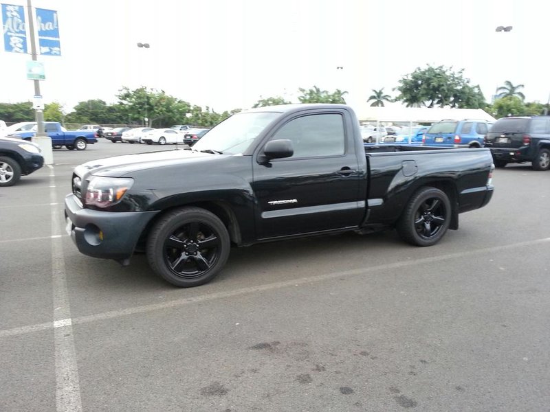

    i thought you was gonna get the djm?

    I got it but I used 4x4 leafs in thr back and 2 inch blocks plus qa1s instead of using the djm c notch. No notch so maybe next thing will be helper bags for when I put ny bike in the back!

    I went low cheeeheee. Now just need my satoshi grill to be finished and shell be stylin.

    Looking great.
    I'd like to drop mine a bit, but not that far.
    Eventually I'll probably do 4x4 leafs and 1/2" spindle spacers.

    DO IT!!!! Im actually very happy with it. The ride seems to have improved with the alignment and the x runner bilsteins. I was due for new shocks so that is probably a big factor on the better ride and feel.

    Its absically 3" all the way around. i didnt take measurements on the back cuz i was tired after the blocks which were the final step. But the front measured from wheel center to bottom of fender is bout 16 1/2. I believe it was 191/2 befoore the control arms were installed. Ill check the back tomorrow.
