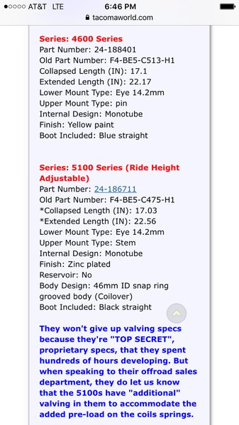

    this is the Rancho kit

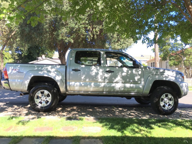

    Simple OME/884/AAL lift. 32” WP’s
    Came out perfect.

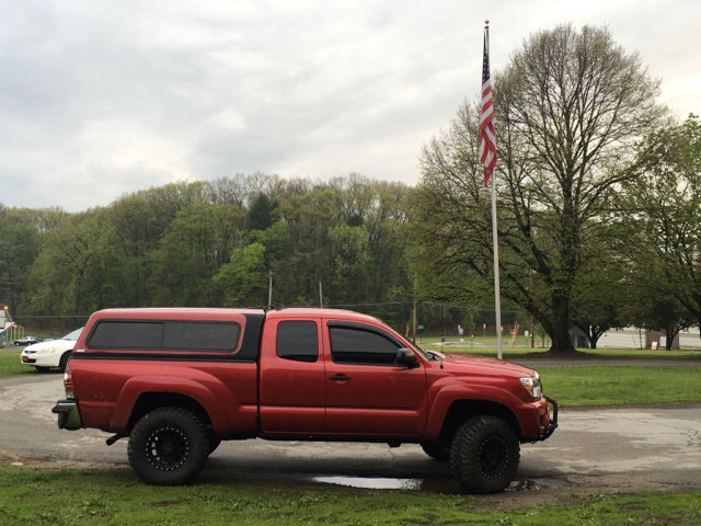

    Just had my ome kit installed about 2 weeks ago and love the ride..off-road capabilities seem defend went on a charity off-road ride with a bunch of jeeps and the taco did great.
    3in ome lift with darka rear leaf pack mounted one method wheels and 285/75/16 bfg km2's
