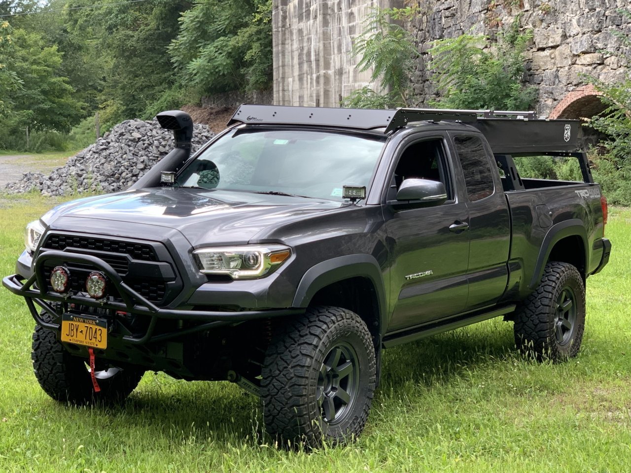

    IMG_0506.jpg My 2cents. Built a 2017 ACLB OR, did 4.88 with OV tune. Used tf out of it on and off. Was pleased with highway and off roading

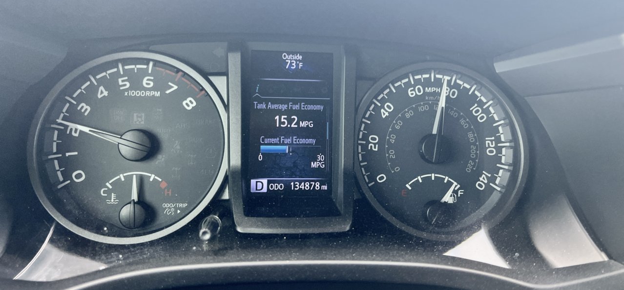

  16. Aug 3, 2023 at 3:10 AM
    #36
    ClassyTacos
    ClassyTacos National Treasure 3, Times a ticking Nickolas
    Sep 26, 2019
    #306325
    1,912
    Papalote
    Florida
    2017 TRD Sport 4x4
    Stockish
    Pics of the Comanche please. Always wanted to build one back in my XJ days.
    Thank you.
    Thank you.
    I wanted to mention. Those gear ratio charts are more or less kind of an estimate, at least form my experience. They usually reflect a certain speed anywhere form 55 -65 I think is common. I always end up being lower then listed.
    Here is a pic I took the other day on the highway with the 37s. This is me cruising with my foot on the gas lightly to maintain speed no incline.
    Its 80 on the GPS 76ish in the pic, 2100ish RPMS.
