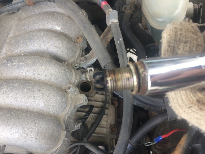

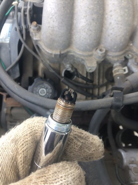

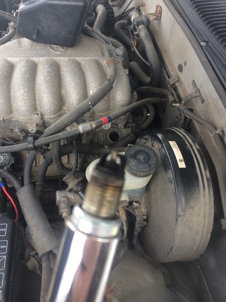

    Pulled coils and plugs and switched the around problem did not follow coil

    New NHL plugs
    Sorry auto correct
    Ngk plugs
    No NHL players were hurt in this test lol

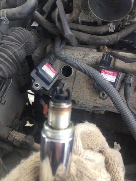

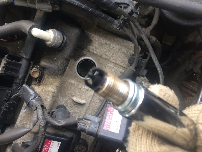

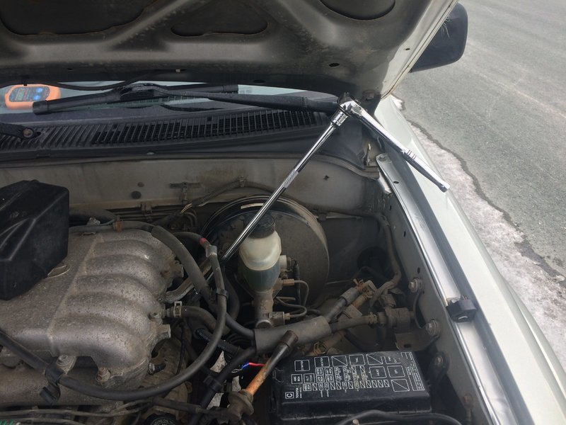

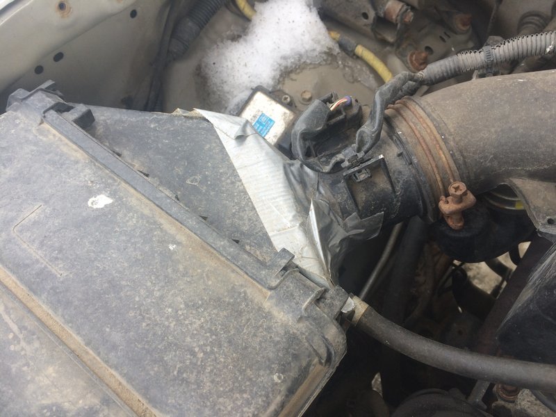

    With that extension I could change plugs from across the street !
    All plugs looked the same
    It's a fuel problem ? How do I check fuel ?
