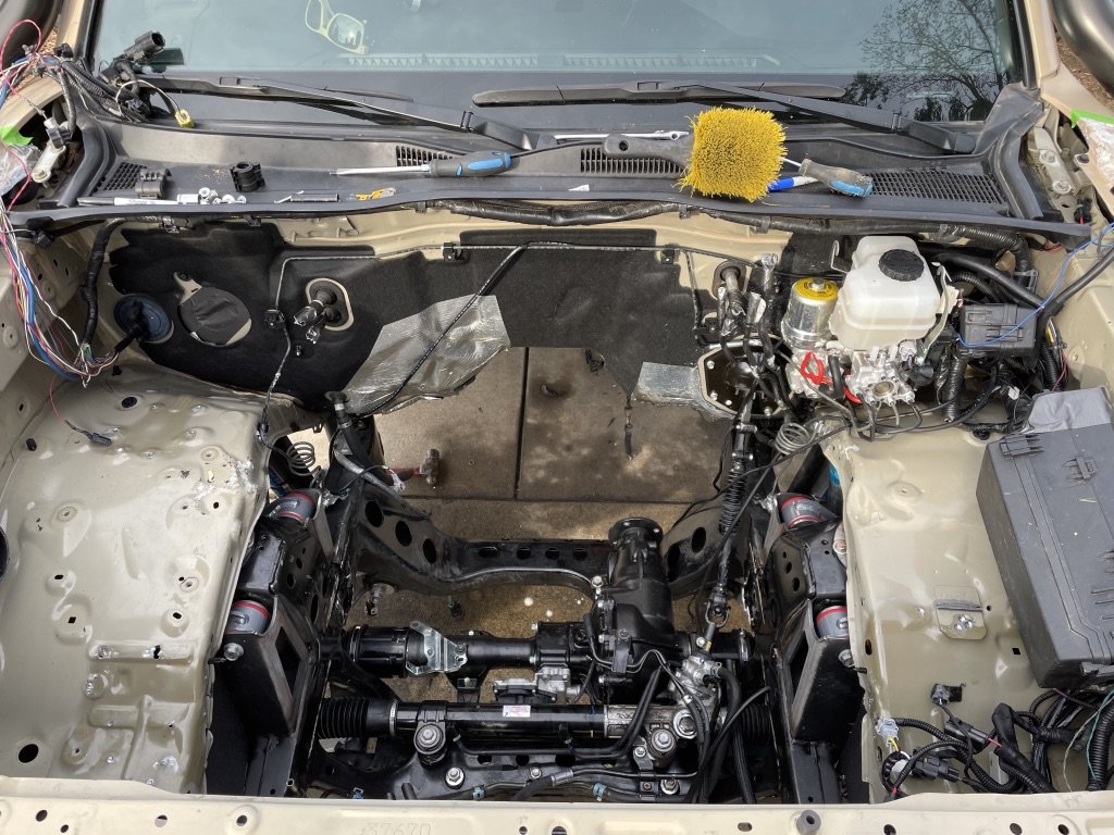

    They do make a custom harness for $1400. That was my big concern but according to my guy its no biggie. I am with you its not an easy process but having a garage that has experience is the way to go. That and its not an overnight process.

    Your dog chews on the screwdriver handle too? Haha.

    Maxxis Razr 35's Fox 2.5 DSCs BD Everything Evil MFG third brake light & roof bar w/6xLP6s Dual Sp9100s Blaze Built molle panels and dual SP9100 Mounting set up Lil B's Bumper and sliders Tons of other goodies Designing a custom Prerunner style bed cage with through bed shock towers. Designing custom front 18" long travel for 37s, will be cutting out my entire inner fender skirts and relocating all electronics/ items mounted to them.
    Dang that's a ton of responses, and I'm not going to try to quote them all, thanks for interacting though!
    First off, this is a 3rd gen, and others with 3rd gens will probably want to see it one day when I'm building parts for these to swap motors.
    Secondly, I do motorsports harnessing, tuning, and design work professionally. I am probably going to be running a Motec computer and display. If I have to I will separate all of the body control stuff, and probably will disable airbags all together anyways. THIS WILL BE A TOY!!!! I understand the undertaking that it is.
    Also, yes, I do want the ford 10 speed transmission. Have you driven a new F150 with one? they rip, and always keep you perfectly in your torque band, just what you want for going fast and quick acceleration.
    Yes it will be a ton of work, but I will also document it all and will most definatly offer the Fab parts premade to the
    Finally, just because the number of motor swaps happening isn't overwhelming doesn't mean that it isn't happening, and it absolutely does not mean that it shouldn't happen. Yes, I only know a handful of guys doing motor swaps on 3rd gens, but I have seen probably a hundred motor swaps in my time of racing and offroading. It is very common for those deep into the car community. Also, someone mentioned a HEMI swap jeep? We did one at one of my old shops... it was sweet.
    Thanks for everyone who is still like "F*** it, lets see it happen" Thats what I like to hear haha
