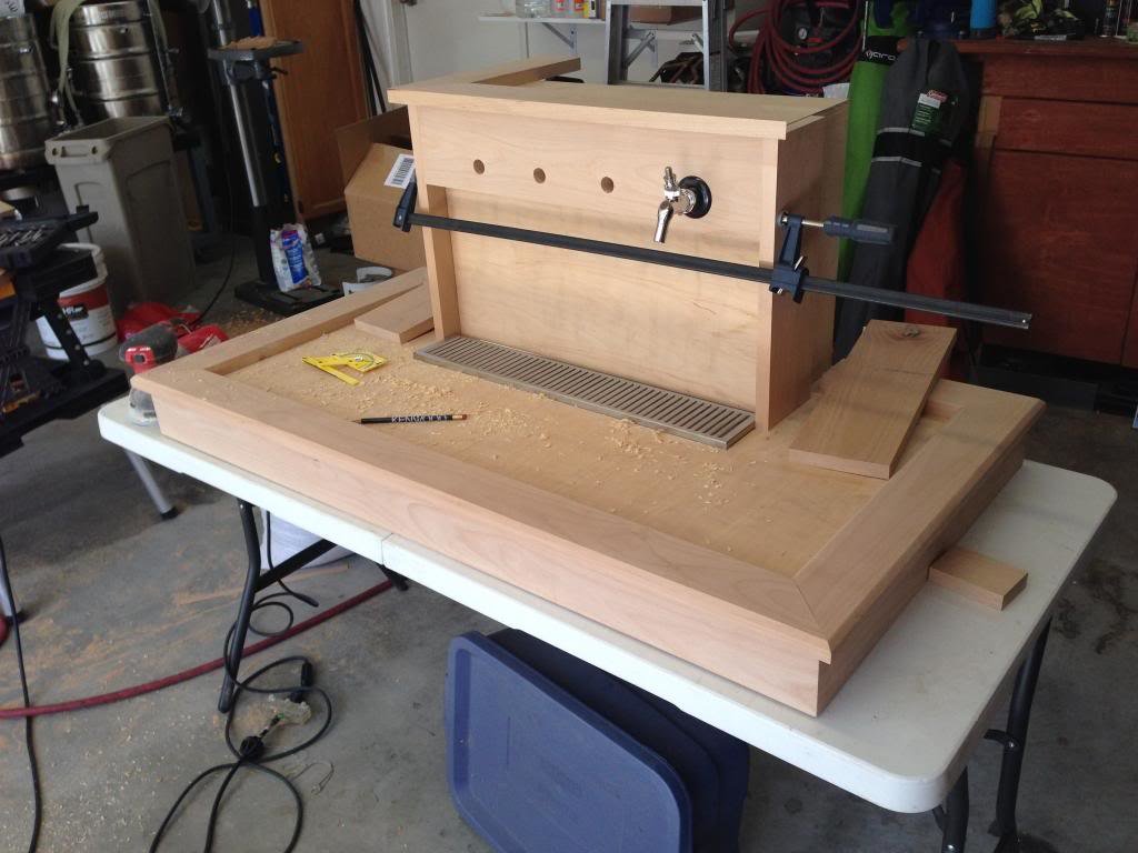

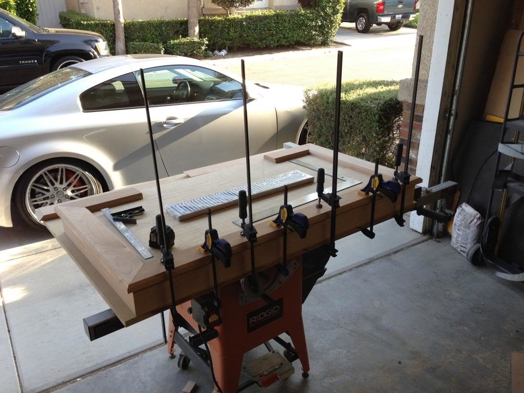

    Mod list... Well, my paint is factory.

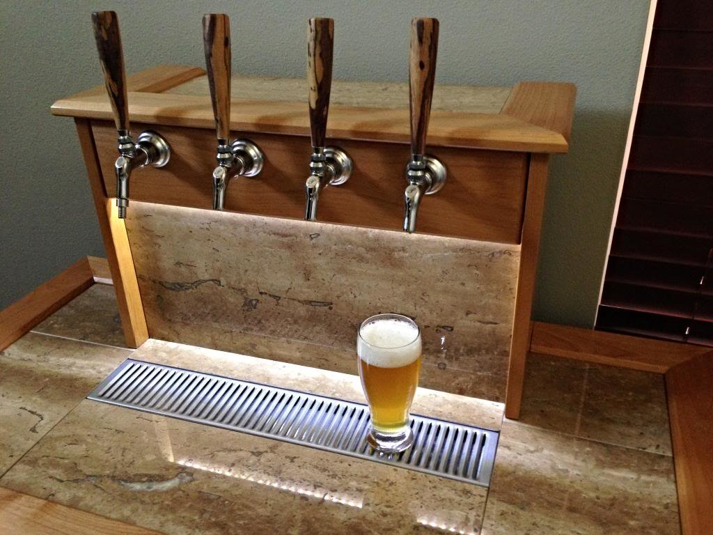

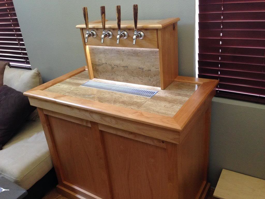

    Here's my 4 tap Keezer
    Natural finish Alder with Mexican Noche Vein Cut Travertine:

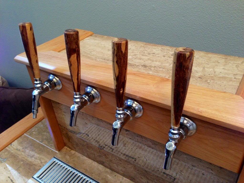

    I turned the handles from a hardwood called Tigre Caspi:
    062c0468-8b96-4976-9edd-c5bd1519bf96_zps_28837a3817042e8066dc9a2c4e399bc2c316c097.jpg

    That's artwork. Wow.

    No, art has no practical use. That's straight pornography! Very nice, El Taco...

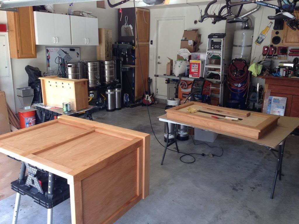

    Here is my keezer I built in 2012.

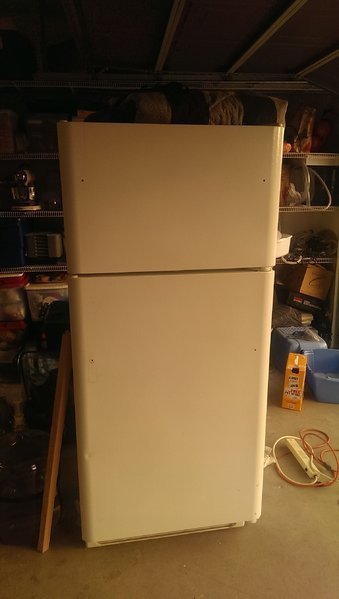

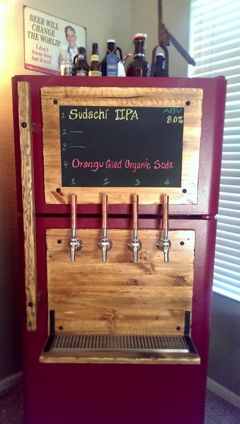

    Not a keezer but here's my upright

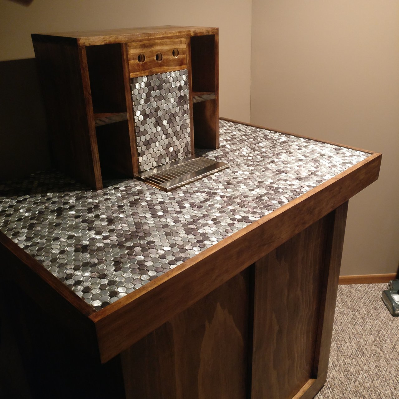

    Here is mine

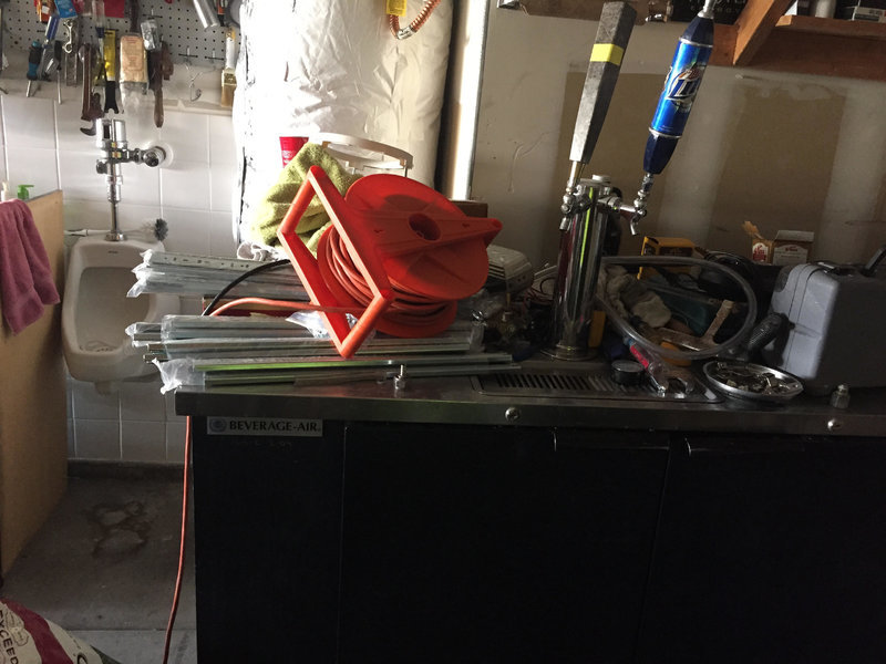

    you fancy ey!
    double kegger, courtesy of Caesars Entertainment!... its not miller, I was in the process of making the handle. left side is the first granite tap handle!
    ps; yes I have a urinal in my garage. :)

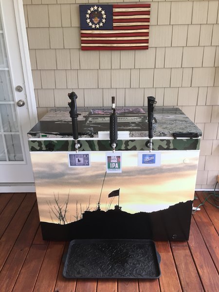

    I made this a few years ago. Had it custom vinyl wrapped by a local sign shop. Absolutely love it.

    Absolutely gorgeous.

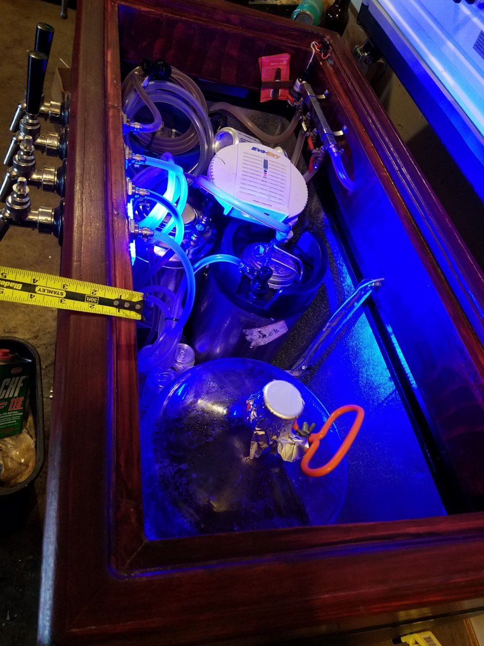

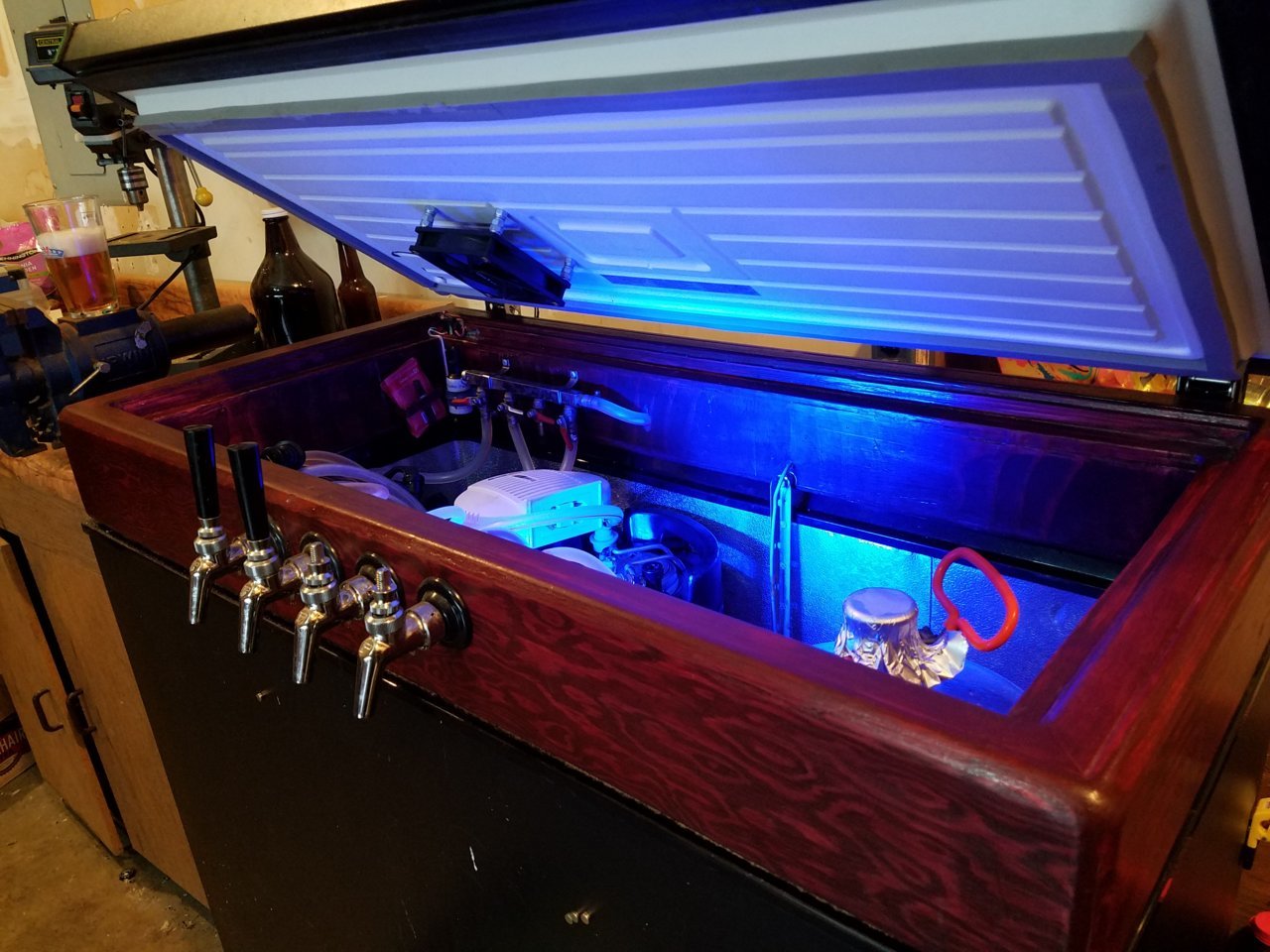

    I used 2" foam board buried inside the wood collar. Just thin plywood on inside wall and bottom, poplar for face and routed in place trim pieces to make the lower lid sealing surface and up to the top. It was a lot more work getting two seals to line up for the lid but its pretty f'n sweet! in back left corner is a door switch, NC controls the fan and NO controls the inside LED.

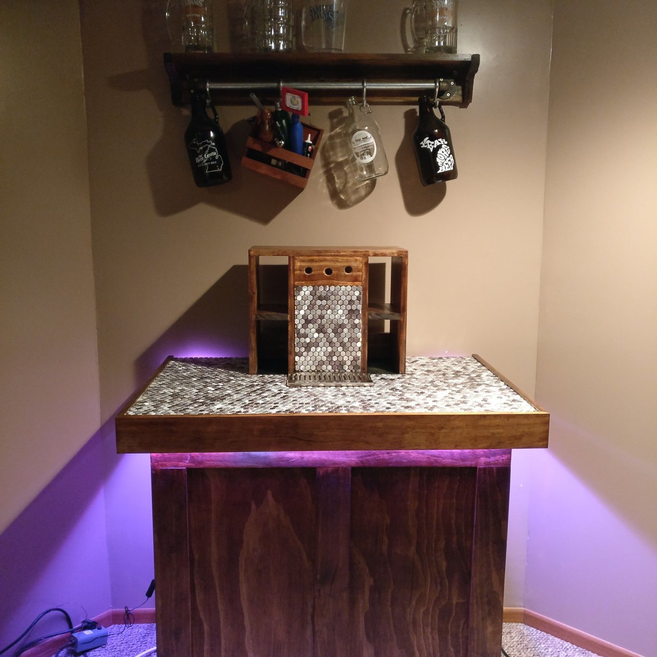

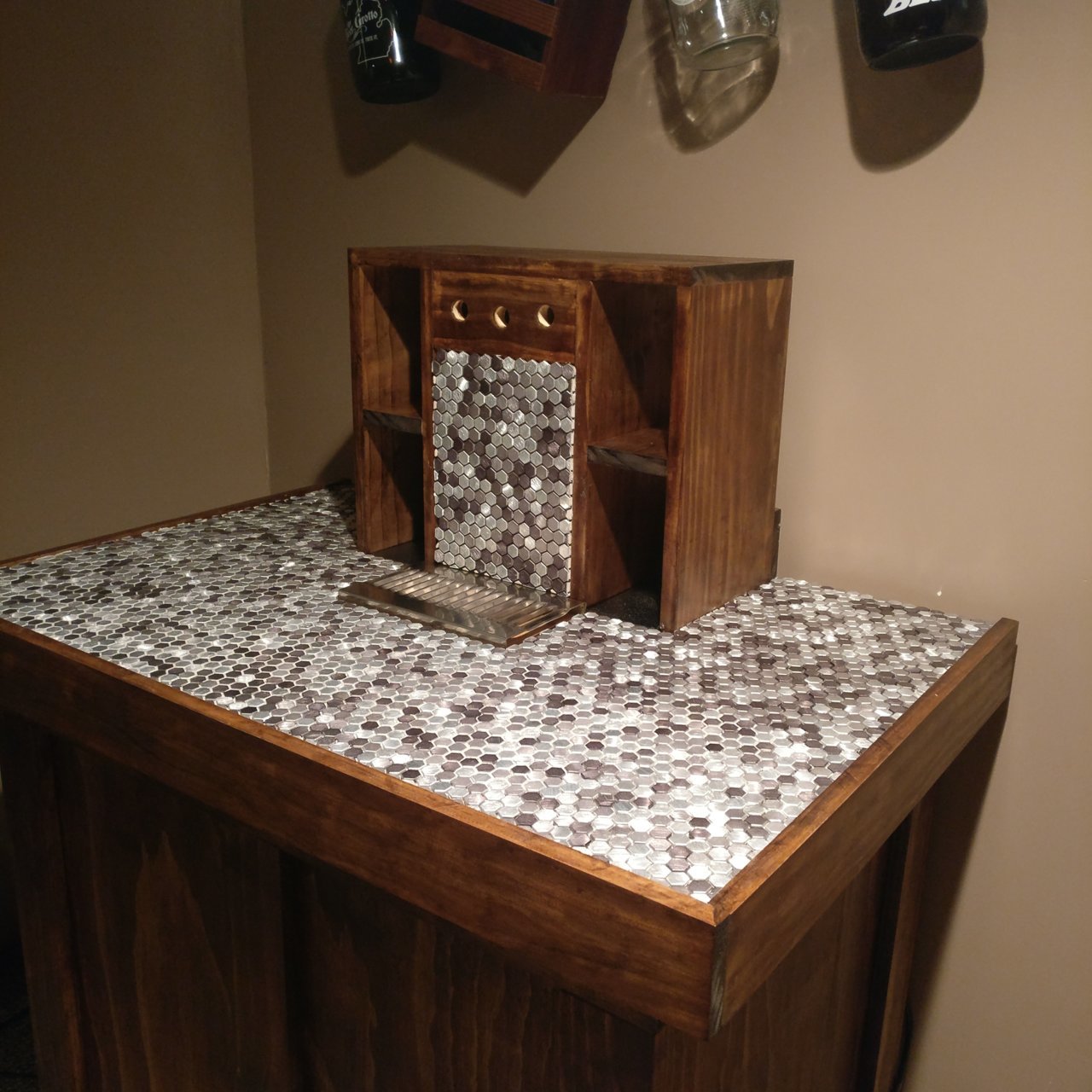

    Thread revival to keep it going and seeing everyone's builds. Here's mine....
    IMG_20190128_210924.jpg IMG_20190128_210938.jpg IMG_20190128_211223.jpg IMG_20190128_211151.jpg
    Irish Stout in secondary to break it in!
