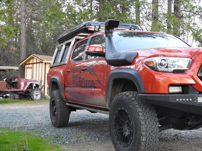

    Here's mine, went from the best top to softtopper and fit and seal is much better on the softopper!
    Also working on an over softopper aluminum bed rack that should be available soon.

    Is the rack pictured a prototype? Availability for 2nd fitment? If so I'm very interested!

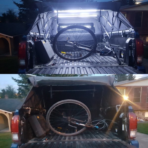

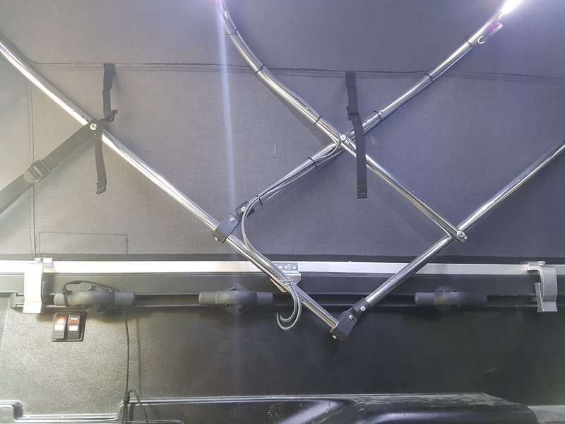

    I also installed bed lighting this weekend. Major difference! IMG_20170410_202611.jpg

    Details on the lighting? Im still trying to decide the best option to add more lighting to my bed. I already have LEDs under the bed rails, but I wanna add something else across the ceiling of the topper like you have.

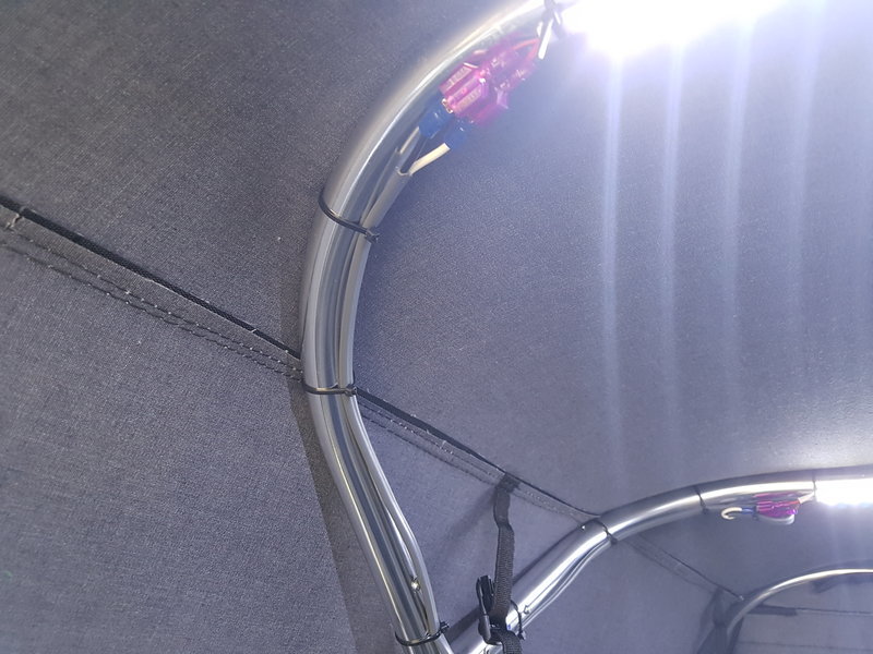

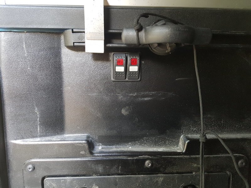

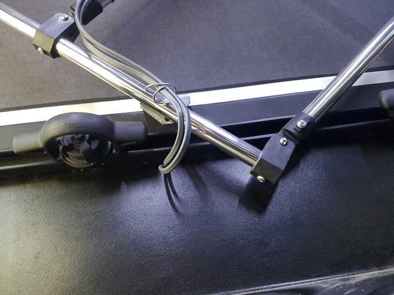

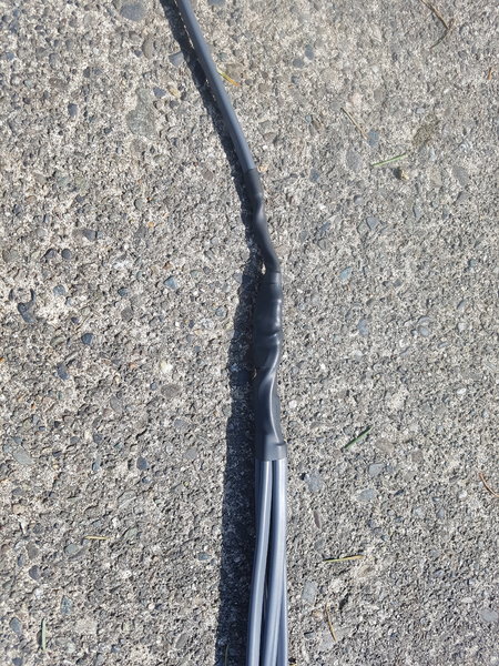

    I used 16ga jacketed wire, run from an auxiliary fuse box in my engine bay to a switch I cut into the side of the box. From the switch I used the same wire and split it into 4 different runs, 2 going to the softopper 1 going to each side of the bed for the rail lighting. I soldered the joint of those wires and shrink wrapped them like hell. (2 layers over each solder joint, then covered all of it with 2 more layers.) From there I made sure the runs that are zap strapped to the rails of the canopy had enough room to flex when it was raised or lowered, and would not pinch on anything.
    One thing I'm not super happy about is the fact that ilthe zap straps create ridges on the canvas. I'm planning on getting some 3M double sided foam tape to hold the lights to the rails.
    20170411_110828.jpg 20170411_110842.jpg 20170411_110849.jpg 20170411_110906.jpg 20170409_141934.jpg 20170411_110927.jpg

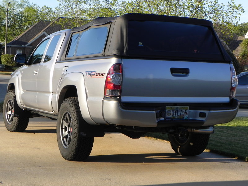

    New addition last weekend. Thanks to Kloverz158.

    Gotcha. Thanks for the reply.
    I think I'm going to use something similar to these for mine - [​IMG]
