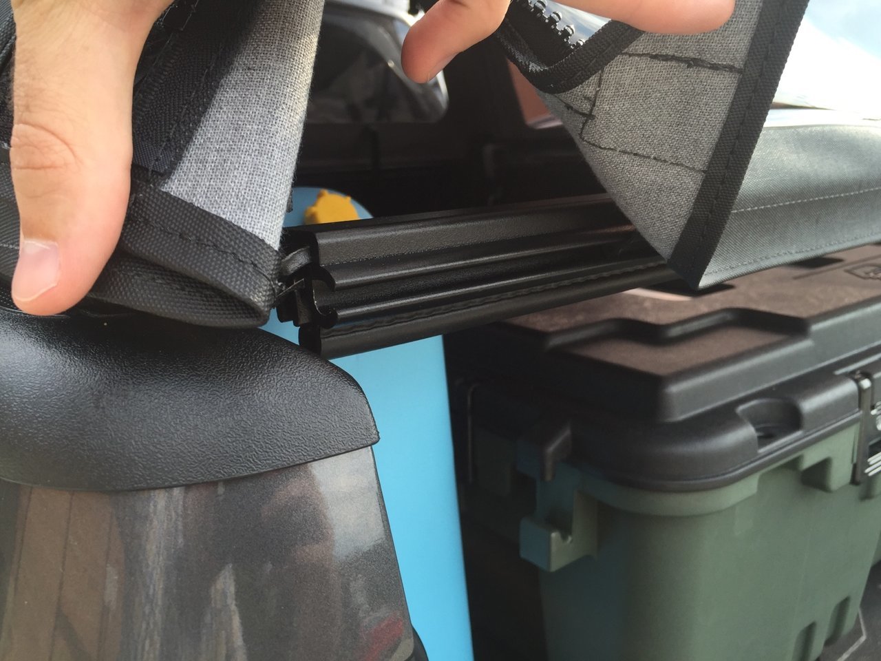

    Not a 3rd gen but they haven't changed that damn bar, took me a good half hour to figure out which end was up. Mine isn't on the truck at the moment but a bunch of Google-fu found me this, maybe it'll help?

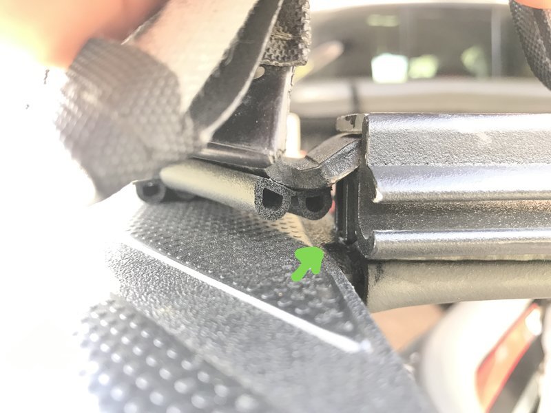

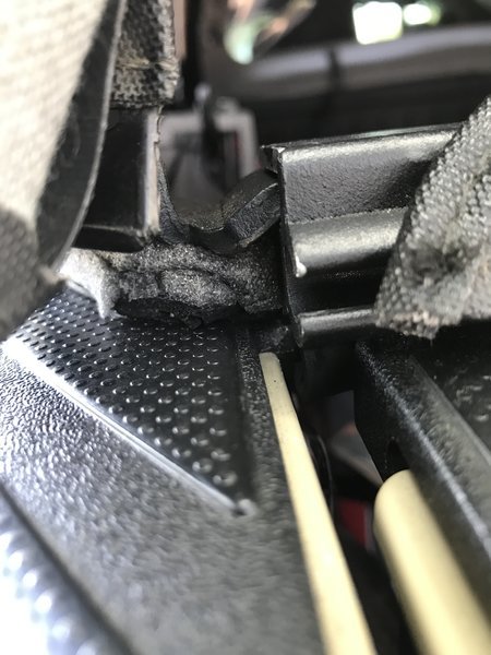

    Thanks for that pic, so basically that's how I have mine set up but it seems that the bar is a bit too wide sometimes I have to fight to set it in and scratches my bed caps, I don't care, yea I know it's a truck so I may just have to trim some plastic off, and if anyone ask yes, I replaced the weather striping it comes withIMG_1367.jpgIMG_1369.jpg

    Is there any room on the passenger side to move the whole setup over a quarter inch?

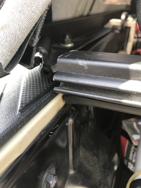

    Nope it's pretty much the same, I guess it's supposed to sit on top of the plastic side rail. I came up with a solution for the mean time, I stuck some foam under where the bar snaps in, that way it raises the rail and it's easier. The foam isn't really noticeable with the flap down, I may swap the foam for a black piece of rubber of some sortIMG_1374.jpg
