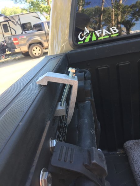

    Just got back to camp to see the damage in the light. For anyone who doesn't believe I installed this correctly, Here's what the bolts look like... in case you can't tell, it's bent as fuck. 3 of the 4 look like this.

    The 16's have different clamps? I figured they would be the same.

    These are the Bestop clamps, not the actual softtopper brand. I know the two are different styles and I think the softopper ones are better from what others have said

    Wow that's some unbelievable power. Mother nature can be a bitch sometimes. I'm getting another set of clamps for sure

    I recommend it highly. I don't think I'll be able to fix my rails so I'll have to order new rails and will probably order two sets. Add an extra clamp on each side and then add two clamps on the Velcro

    I know 2nd gens have the rail up near the cab as opposed to the 3rd gens but what I did for extra security is get a piece of aluminum flat that spans the front bed rail and 3 small clamps from Home Depot and after velcroing down the window by the cab just lay the aluminum flat down over the little flap and clamp that shit down real good against the velcro. And 3rd gens can add the extra bed rail up near the cab like 2nd gens by my understanding. It makes for a good extra security point. I've taken my truck up to 95+ w/ the Bestop (albeit maybe not gusting winds anywhere over 25mph) and have never had the slightest issue. I also clamped the side rails down as tight as possible but just prior to the bolts starting to deform.

    Ya after this incident I'm considering ordering the 3rd rail for the cab side in the bed and doing something similar as well. I called Bestop and it sounds like I'll get everything damaged replaced under warranty. I'll find out shortly.
