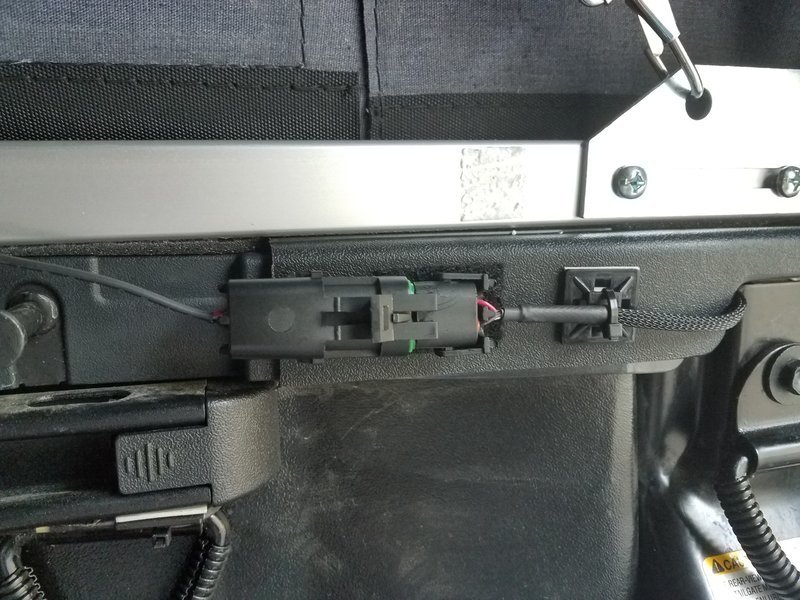

    I posted a link to the lights I used. They are wired into the bed rail lights so they come on when the tailgate is opened. They are on a pin switch. Theres a ton of different DIY write ups on here on how to do bed lights. Follow one of those then add these lights into the circuit as well.
    The wiring is ran through the Supertop frame. I drilled a small hole next to each light to bring the wire outta the frame to the light. The lights themselve's are just zip tied to each crossbar. This was the only way of mounting them with no issues because of the snap Bestop uses.
    I ran the harness up to the front corner of the bed where it is connected to the bed rail lights via a Delphi Weatherpack plug.

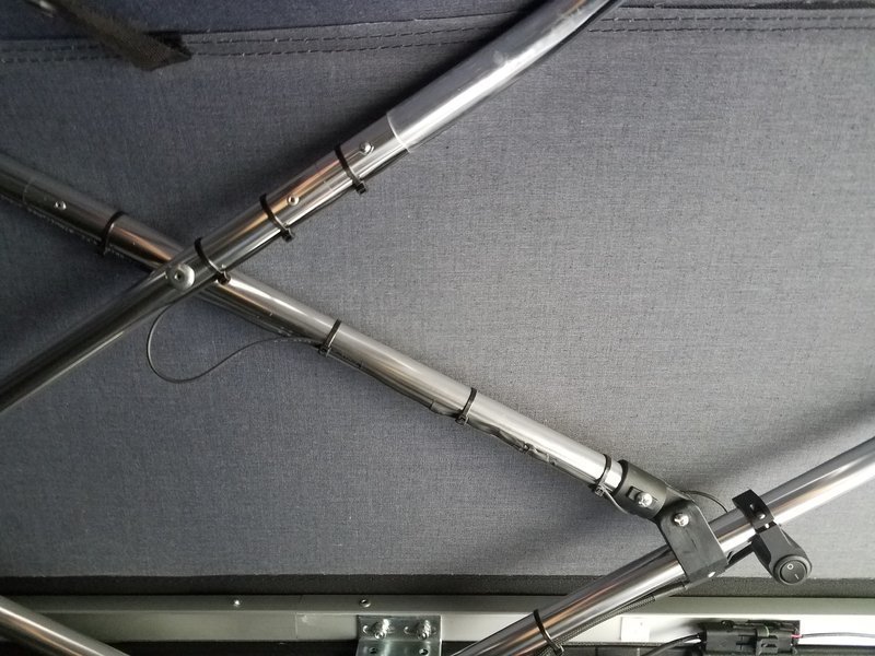

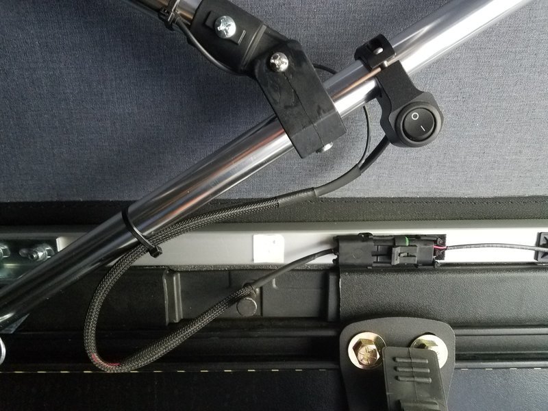

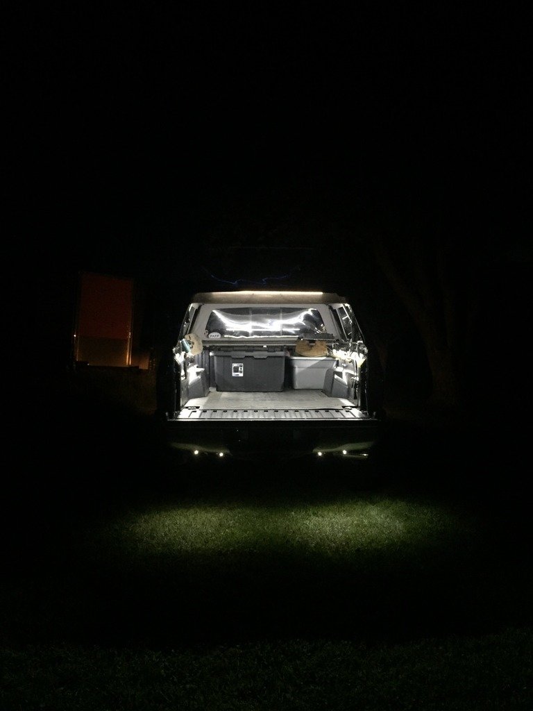

    Installed some lights from @mattgecko. The bed lights turn on with a tailgate mounted pin switch and have a second switch to turn them off manually. The Softopper lights have their own switch mounted on the tubing for when I'm camping in the back.

    Man that is so sexy! :drool: I am gonna have to order mine on Monday now like I said from @mattgecko

    Those turned out nice. I wish the Supertop had smooth rails like the Softopper. It would make mounting the lights on the crossbars cake, just like yours are.
    I like the switch holder, any details?
    dilbert[QUOTED] and Sleipnir like this.

    It's a motorcycle switch for a 7/8" handlebar. The picture on Amazon shows a different switch than what I was sent, but that's the one I ordered.
    https://www.amazon.com/gp/product/B01DFBH6LQ/ref=oh_aui_detailpage_o05_s00?ie=UTF8&psc=1

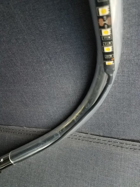

    I used clear shrink tubing to hold the lights on the Softopper tubing. Something similar may work with the supertop.
    https://www.amazon.com/gp/product/B003ICY2H4/ref=oh_aui_detailpage_o09_s00?ie=UTF8&psc=1

    I ended up using an aluminum led strip for mine and a few zip ties.
    Thanks for the link! I knew I saw those switch holders somewhere but couldn't remember what they were.

    Thanks! I spent more time on the plans for this than actually doing the install. I think I bought and returned 3 switches before I got one that I liked. I just installed the Softopper Saturday, so I haven't even camped in it yet. :anonymous:

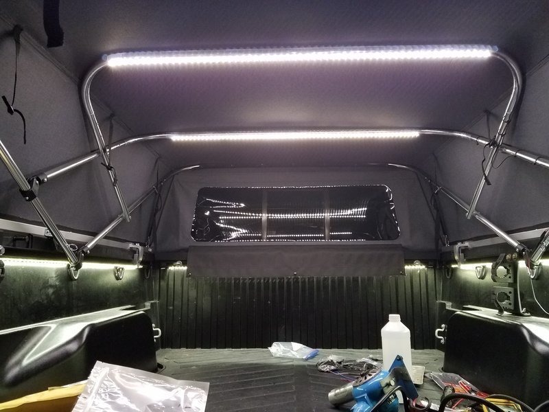

    Even if you don't sleep in it regularly, it is damn nice to have some light in the bed for loading/unloading things at night.
    I typically sleep in mine when I solo camp and it's great being able to see at night when you gotta get up and piss or when it's raining and you don't wanna sit in the dark.
    I ordered a dimmer for mine that has an RF wireless remote as well -
    https://www.superbrightleds.com/mor...d-dimmer-wireless-rf-remote-8-amps/3145/6309/ -
    That way I have some control of how bright they are.

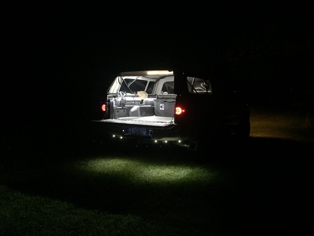

    I finished up my lighting tonight. The 3rd topper light showed finally after fighting with the Ebay seller and the RF wireless dimmer showed up today as well. -
