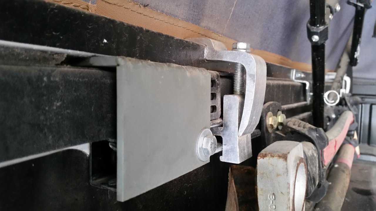

    I just went out and took some pics for anyone interested! They're called Hauler Racks and their website is VERY frustrating haha http://www.haulerracks.com/
    I made these crossbars out of some aluminum flat stock from home depot and they are just bolt on with rivnuts. The quickfists are also mounted on the crossbars with rivnuts.
    I cut the rack down to fit snug over the topper.
    I bought a second set of softopper clamps so that I could mount it.

    That looks good, I never thought about notching the softopper rails

    Lol never meant to make people jeoulous. It'S not as clean in person I think. I never notched the bars

    What do you have under your rails? Foam strip or something harder?

    Yup just foam weather stripping.
