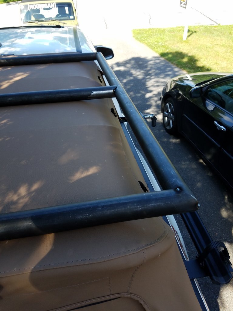

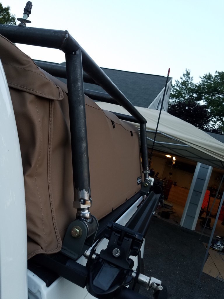

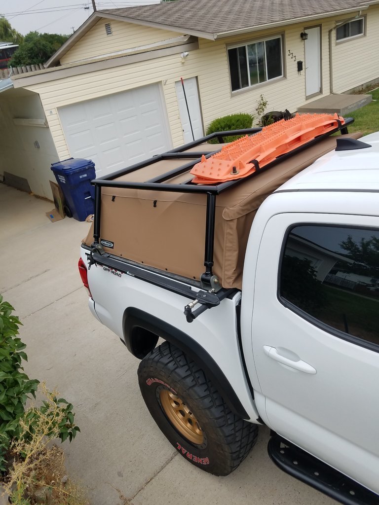

    I built my rack to rotate over. So I pull 2 bolts and it flips over so I can fold down the softopper. Or I can just remove 4 bolts and completely take the rack off. I made it for the ease of removing.

    Thanks! It has been a really fun build. So I believe Allpro and SOS make theirs to be able to fold inside the rack, BUT they don't sit flush over the topper. They have a decent gap.
    That could be a possibility to unpin the pivot and lower it but I'm not positive as I've never tried it.
    I understand your point as I would have to remove the roof top tent prior to folding over. I don't trust rotating close to 300lbs onto the 2 legs. Or I could gusset the legs in certain areas just to be safe.

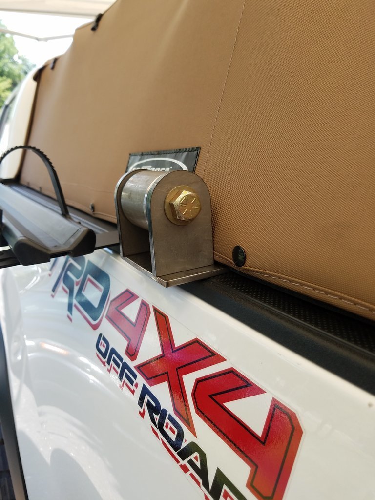

    I made a folder with just pictures of the rack lol. I get asked quite a bit I got tired of trying to go back through my build haha. The L-brackets should be 4"x5" and it will give plenty of room. I made them 4"x4" and it was a little too tight but I made it work. I made the brackets while my truck was getting regeared and didn't measure it correctly while it was gone.

    Awesome, thanks!
    I plan to use 1.5" x .095 wall DOM for my rack (because I have a bunch left over from my baja bug days). So I think I can make it work.
    Also, because that is what I have for bending dies on both my tube benders. Never got around to any bigger dies than 1.5".
