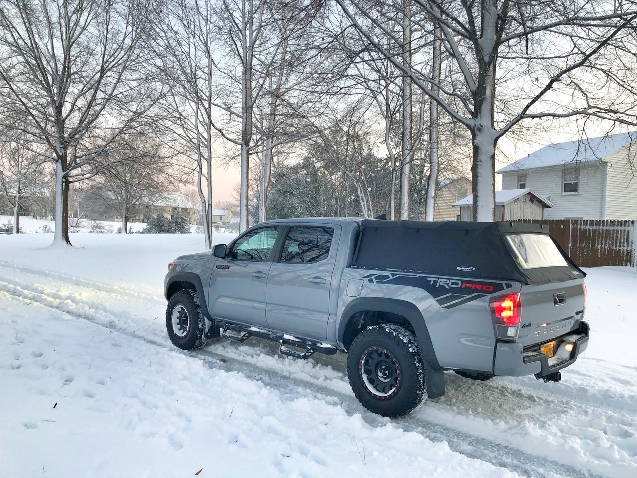

    Held up fine with the cold and snow last week

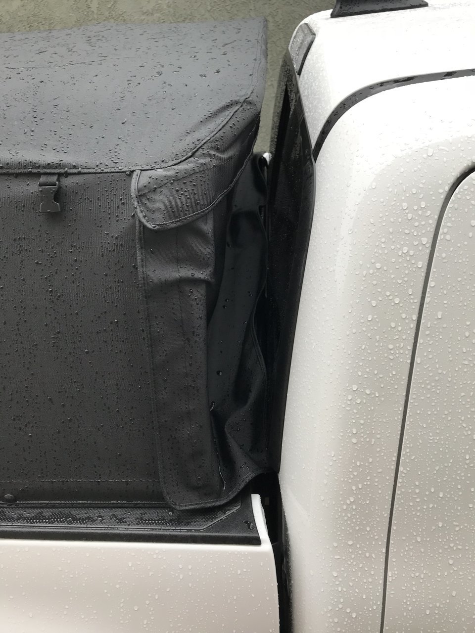

    Does this happen to anyone else? Seems like it’s getting sucked in by some negative pressure. Maybe need to get the gap closer?

    cool stickers and a baseball card With clothes pin, sounds awesome ! wicked
    mine did until I put Velcro on the inside bed rail area..... all fixed
    22.OR: Velcro
    1. Locate the bag of 14” velcro strips.
    2. Place 2 strips of velcro onto the front of the
    truck bed, near the edges of the window
    panel, while lining them up with the velcro on the flap of the front window panel.
    3. Wipe clean the selected surface of the front truck bed, remove the protective film from
    the sticky side and firmly press the velcro onto the vehicle.
    4. Line up the front window panel velcro and press it securely onto the installed Velcro
    Sev[QUOTED] and lesterb315 like this.
