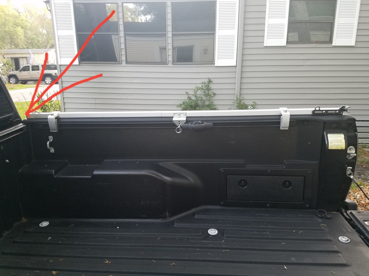

    Mind sending me some pictures of where you put the putty? I guess That seals better than silicone or that RTV stuff??

    I chose the puddy because it is super sticky but easily removable. It is already gone in the pic since I took the rails off my truck, but it put it where the arrow points to. Big chunk molded on the rail going around the truck bed corner. That's where, with the topper, the back flaps meet the side flaps and water trickled in right there.20180415_103440.jpg

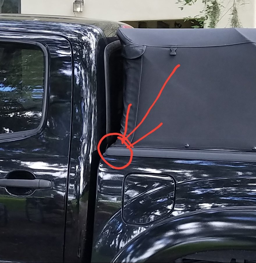

    So you put it under the soft topper rails and in the gap between the front portion of the truck bed and side portions?

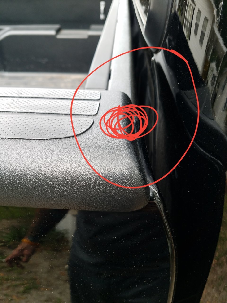

    Not under but I put it against the softopper rails, and filling up the gap between the tails and the end of the truck bed. Thats where usually a puddle of rain gets created and dripps down the corner..20180415_134327.jpg
