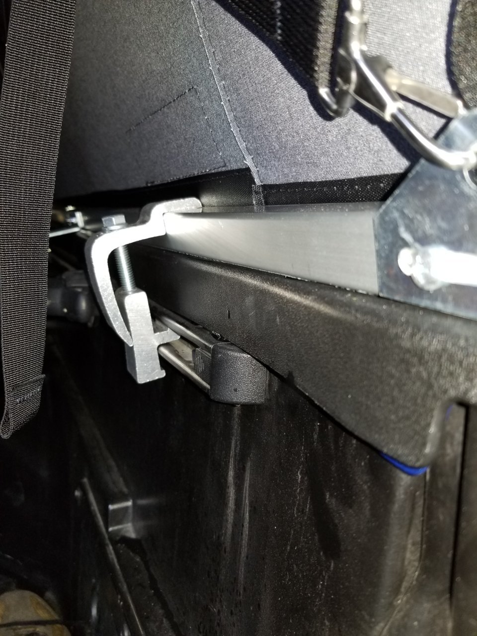

    Ill get a picture of it later. Maybe I'm getting them to tight. Im using utility rack mounts.
  4. Aug 16, 2018 at 6:21 AM
    #3484
    Chief Taco
    Chief Taco Tacomasaurus Rex
    May 11, 2017
    #218736
    190
    Nicholas
    Indianapolis, Indiana
    2016 TRD OR DCSB
    Mobtown Offroad IFS Aluminum Skidplate Low-Range Rear Diff Mod Softopper Reaper pattern custom car grills President Johhny III CB
    So i i measured them at 1/2" all the way loke the directions said but they keep pulling in
  5. Aug 16, 2018 at 7:06 AM
    #3485
    slowlane
    slowlane Well-Known Member
    May 7, 2014
    #129313
    3,543
    AZ
    16 double cab MGM
    i wonder if the fabric is on too tight when its buttoned and its pulling up on the rail? at the pivot point on the middle of the rail, is the locking pin on the top, middle, or bottom setting?
    mine is in the middle.
  6. Aug 16, 2018 at 7:09 AM
    #3486
    Chief Taco
    May 11, 2017
    #218736
    190
    Nicholas
    2016 TRD OR DCSB
    I think i figured it out. The foam adhesive seal that came on it just peeled right off. The adhesion to the track was no good. So it just slides around. Gorilla glue to the rescue!
    Spare Parts likes this.
  7. Aug 16, 2018 at 7:17 AM
    #3487
    slowlane
    May 7, 2014
    #129313
    3,543
    AZ
    16 double cab MGM
    also, can you push the bottom part of the clamp more into the utility track? looks like its not seated all the way into the utility track.
    fmrjeep likes this.

    This is what my problem was initially. Make sure that the clamp is all the way in the track or you end up with a weird angle on the clamp.

    hopefully @Chief Taco read this before using gorilla glue.
  12. Aug 16, 2018 at 8:08 PM
    #3492
    MolonLabeTaco
    MolonLabeTaco Well-Known Member
    Jan 30, 2018
    #242953
    2,786
    Dude
    N. Texas
    '12 DC 4x4 OR
    Your clamp isn't clamping correctly. Like these other guys, I had that issue @ first.
  13. Aug 17, 2018 at 4:43 AM
    #3493
    Chief Taco
    May 11, 2017
    #218736
    190
    Nicholas
    2016 TRD OR DCSB
    I went to napa baught a roll of topper weather stripping. Then i peeled all the old stripping off cleaned well applied new and it is solid now. Those clamps were like that because as you tightened with the weather stripping sliding it would just pull the whole rail with it. Even tight i could grab the rail and it would slide back and forth. But with a new piece of weather stripping it seems to be cured

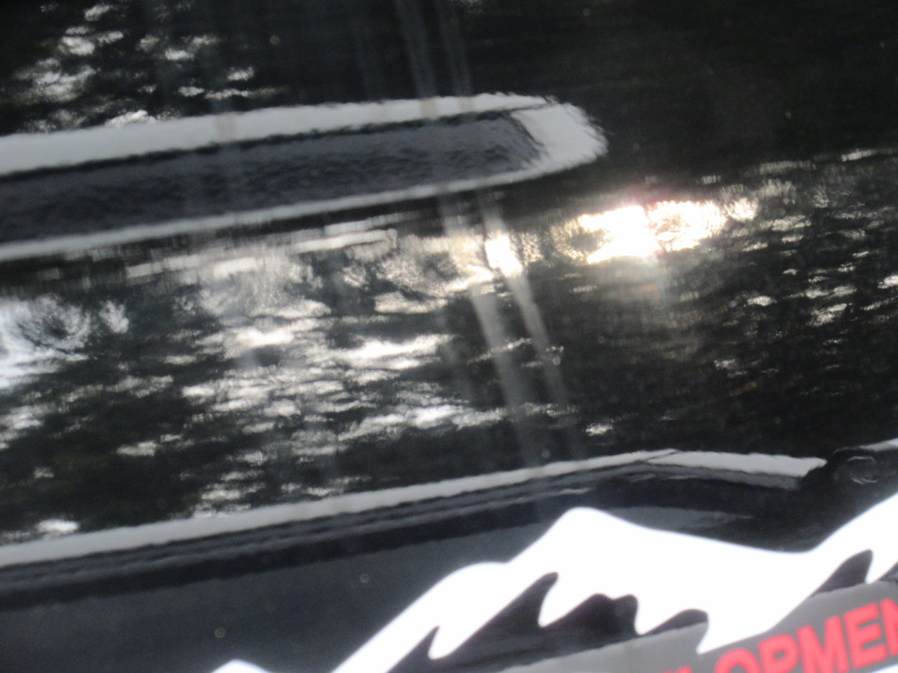

    I've had my Softopper for 2 years now and I'm pretty satisfied with it.
    One small "problem"
    Anybody getting streaks on your bedsides and tailgate where water runs off the top??
    My truck is black and it seems to happen after I wash the truck before drying and after it rains.
    Every rain storm ,I get marks from the water.
    I hit it with detailer and it comes off, but the streaking is noticeable and requires constant wipe downs.
    Crappy pic with the glare, but you can see the streaks...

    Same on my white truck. I don't mind.
    bucktales likes this.
  16. Aug 17, 2018 at 2:18 PM
    #3496
    bucktales
    bucktales *Retired* curmudgeon
    Oct 3, 2012
    #88243
    7,778
    Litchfield County Ct.
    2012 TRD Sport AC / 2014 FJC/ 1972 Rally Nova
    I keep up with it, but that sounds logical to me.
    Shows up on black, of course.
    Remind me not to get another black vehicle. (this is my 5th)
    DoorDing likes this.
