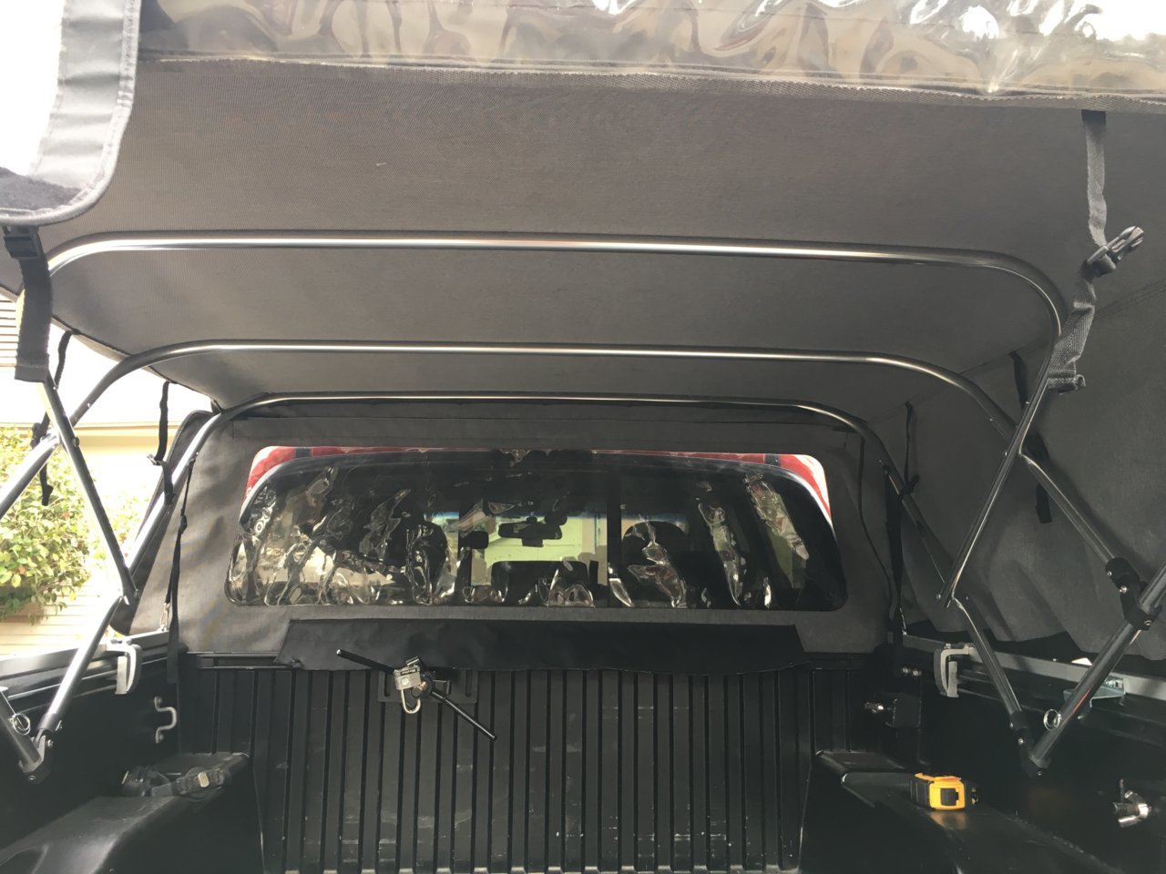

    Yeah that's exactly what i'm saying. Also the frame has 1 additional snap (2nd one in from the tailgate) which the canvas does not have... I'm thinking I really got hosed...

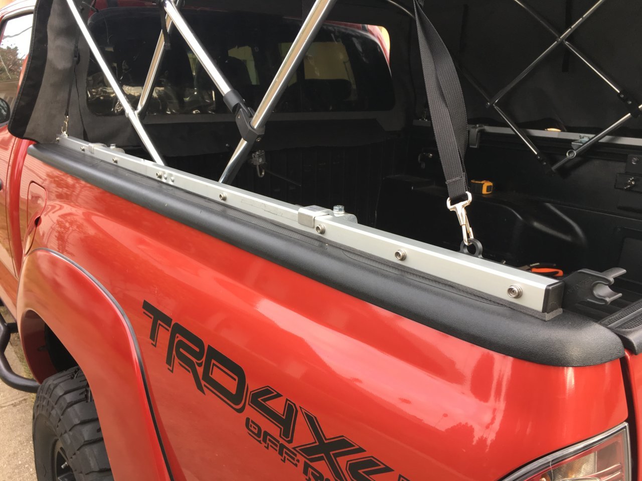

    Here are some shots from the inside.

    Long bed top and frame with short bed rails? :notsure:
    I hope they get you straightened out.

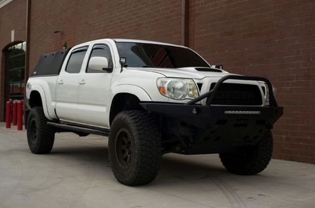

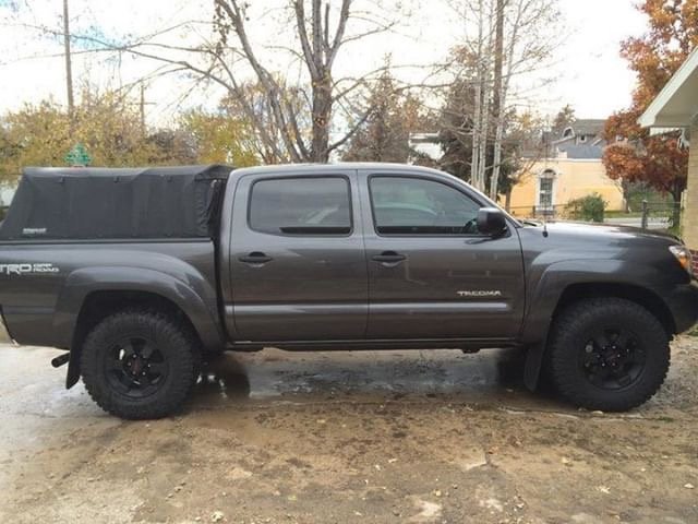

    Here's two pictures the kid just sent me. Hes saying that he's installed the same ST on (2) other 2nd gen DC SB trucks. The white one is his, the MCM is his buddies.

    That white one is a DCLB for sure.
    Look at the distance between the cab and the rear tires.

    yeah the white one is a long bed the MCM is a short bed. Both the pictures the topper is tight though. it almost looks like the frame is built for a long bed (as it was probably purchased for his white LB) but the actual canvas looks like its built for a completely different truck. Too loose between snaps and even looks pretty loose around the braces when its up.

    Those rails look nothing like my ST rails. Did they change from channels to tube square in recent years?

    Here are the measurements. To me it’s obvious that the bed rails are for a different application then the frame & canvas. Which is probably the worse case scenereo...
    I’ll let you guys know what softopper says.
    Canvas
    First snap to last nap - 61 1/2”
    Between each snap - 10 1/4”
    Cross bar - cross bar - 63”
    7 snaps
    Frame
    First snap to last snap - 58 1/4”
    Between each snap - 9 1/2”
    Front of to back of rail - 60 1/2”
    8 snaps
