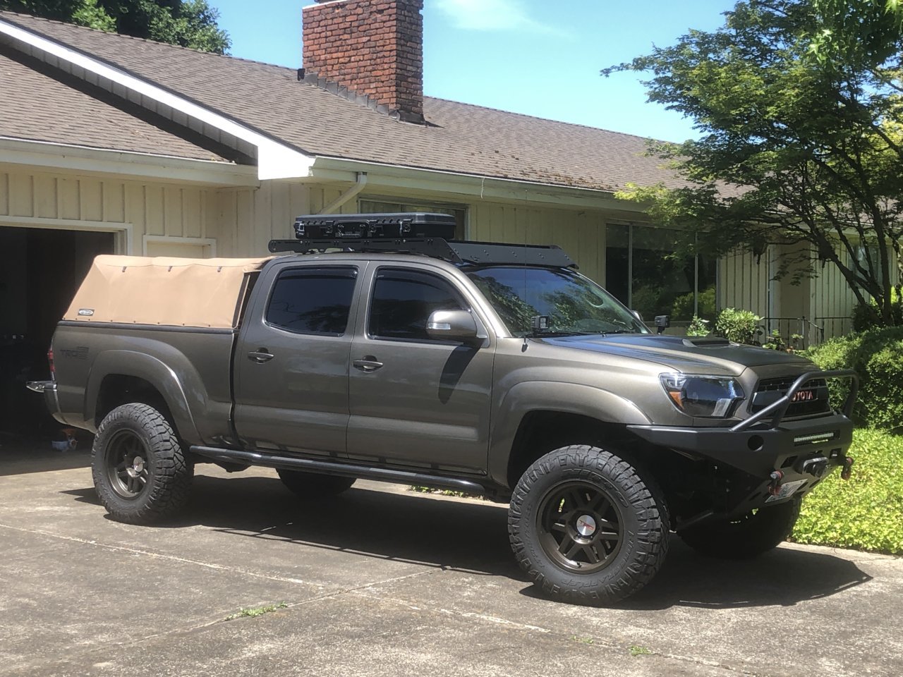

    I did not see this option on Soft toppers web sight. Did you have this made yourself?
    Thanks,
    Dan
    Mine installed

    Truck looks great! I don't know if it's on their website. Back when I placed the order I did it over the phone. Try giving them a call and asking if it's still available.

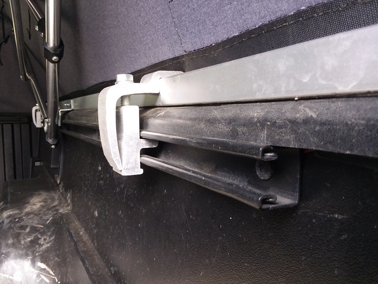

    Hey man, I just noticed this when someone else quoted your post. I don't think your clamps are installed right. The "nub" should click into the top part of the track and yours is canted at an angle and not engaging. That's easy to do by accident.
    This is correct:
